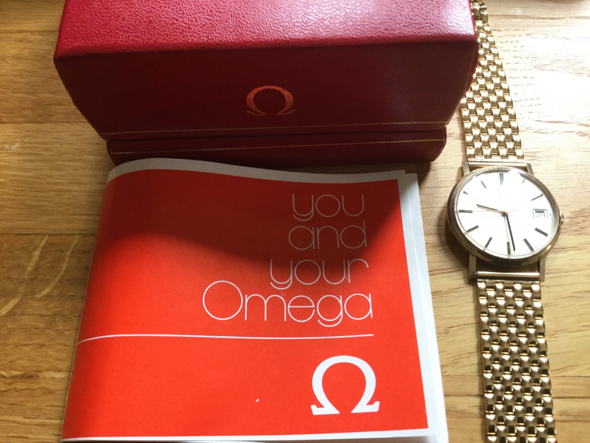

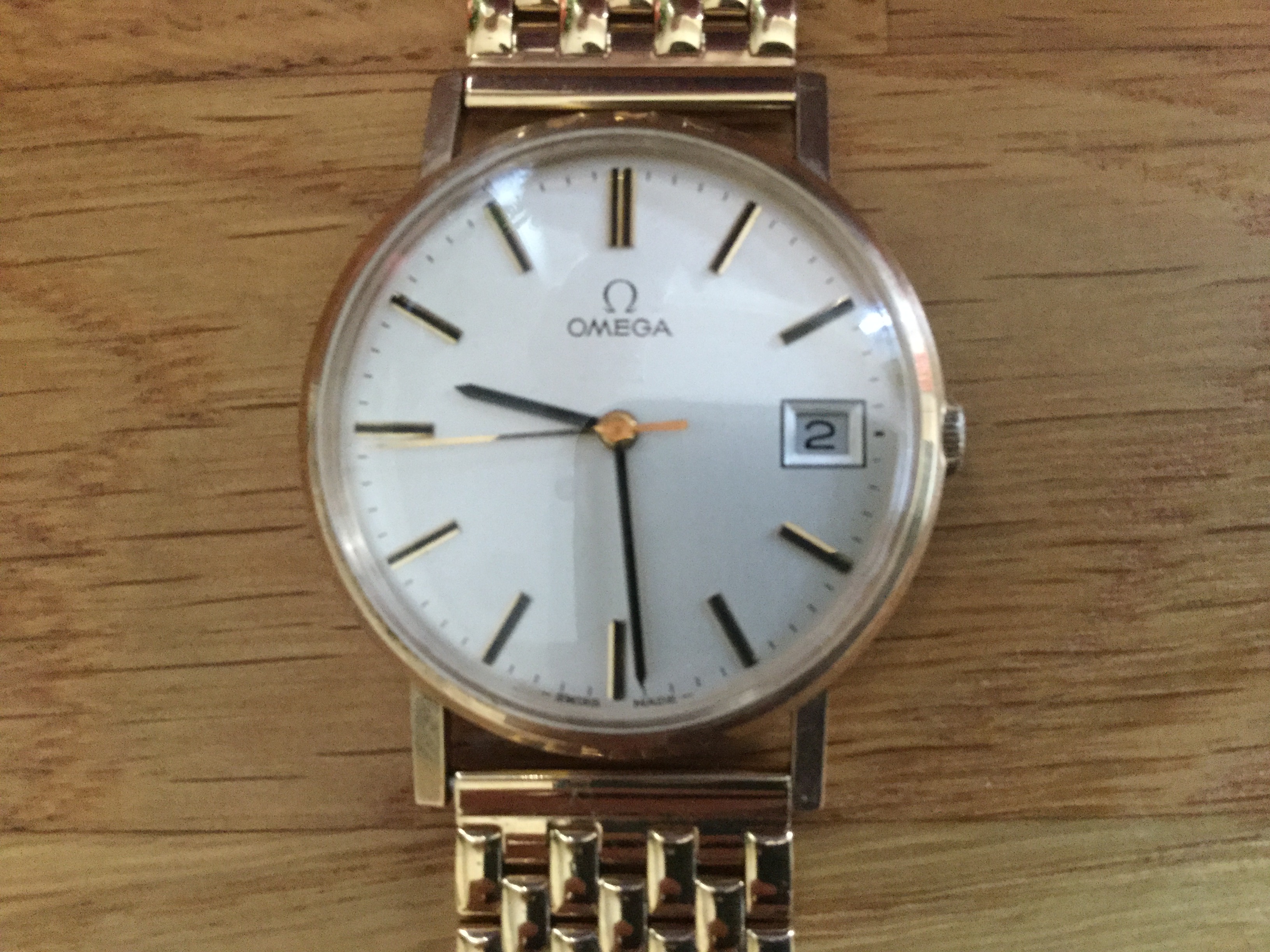

    I have owned this watch since the sudden death of my father in 1979. I have no information other than it has an inscription on the back saying it was presented to him for 37 years of service. I think this would have been around 1977. The strap is not the original. I remember my mother saying it was a ‘gold’ watch but I have no idea if this is true or not.
    My eldest son (who didn’t inherit my brains) is due shortly to become a medical consultant in the NHS. My father would have been so very, very proud. I thought I would give him the watch to say a heartfelt well done.
    I’m scared (and can’t really afford) to pay hundreds of pounds on an official OMEGA service if the watch has no real value and am wondering can someone tell me anything about this particular watch, the model, likely value etc.
    My grateful thanks in advance.
    Laura

    Hi there. No need to send the watch to Omega. Find a competent watchmaker in your area and you'll be fine. If you tell us where you reside many times a member can recommend someone near you. Should run you about $150-$200 US for a full service barring the need for replacement parts. In order for us to help you with additional information such as model/reference and case metal composition you'd have to provide pictures of the back of the watch and the inside of the caseback. Also the back of the bracelet/clasp as there should be hallmarks there if solid gold.
    These 70's Omegas are not highly collectible (yet) but it's a wonderful heirloom to pass on to your son. Cheers.

    Thank you for your helpful reply. I will endeavour to open the back of the watch and report back. There are no hallmarks... so the watch is, as you suggest, gold coloured and not a piece of any financial value. I live in South East England so will find a reputable watch repairer to give it a look over. At the moment I don’t even know if it’s a self or manual wind. Doh! The second hand is moving but I don’t know it that’s the shake I gave it or twiddling with the winder.

    It won't be an automatic as it would say so on the dial. It has to be either a manual or a quartz movement. If you carefully try winding it a little way and it keeps going for a while, it's a manual, which nowadays seems more likely for a presentation watch but in the 70s quartz was "cool". Personally I would take it to a jeweller to open it and find out. An awful lot of watches get posted here with gouges across the back where someone has tried to open them and slipped...:(

    If the case back is gold that indicates it is gold. A steel case back indicates gold filled/plated. I think a really nice leather strap would make it much more contemporary and wearable. Simon Freese is an excellent option for servicing in the UK

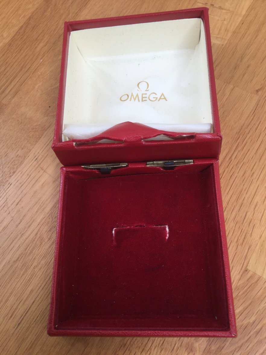

    My husband had, before receiving this reply (with the servicing recommendation), already taken it to a local watch and clock repairer. He has previously worked at J W Bensons in Old Bond Street in the west end of London and also Garrards the Crown Jewellers in Regent Street so we feel it is in safe hands. He’s said it is 9 carat on stainless steel. It was very dirty inside when opened apparently.
    Meanwhile I’m going to try and repair the box... the lid having become detached from the base. It’s also missing the internal watch stand which is sad but not something I can easily remedy I don’t think.
