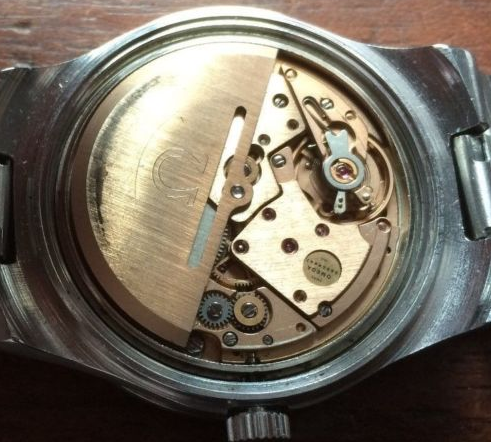

  3. JimInOz Melbourne Australia Jul 30, 2017
    15,476
    32,319
    This is the first thing you check when looking at a watch. This one has a wobbly rotor and some hack work to the left side end links.

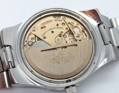

    This one has the same issue.
    Don't look at watches because they are shiny, look for the hidden traps and money pits. Only then look at the aesthetic implications.
