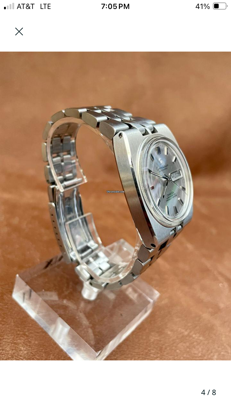

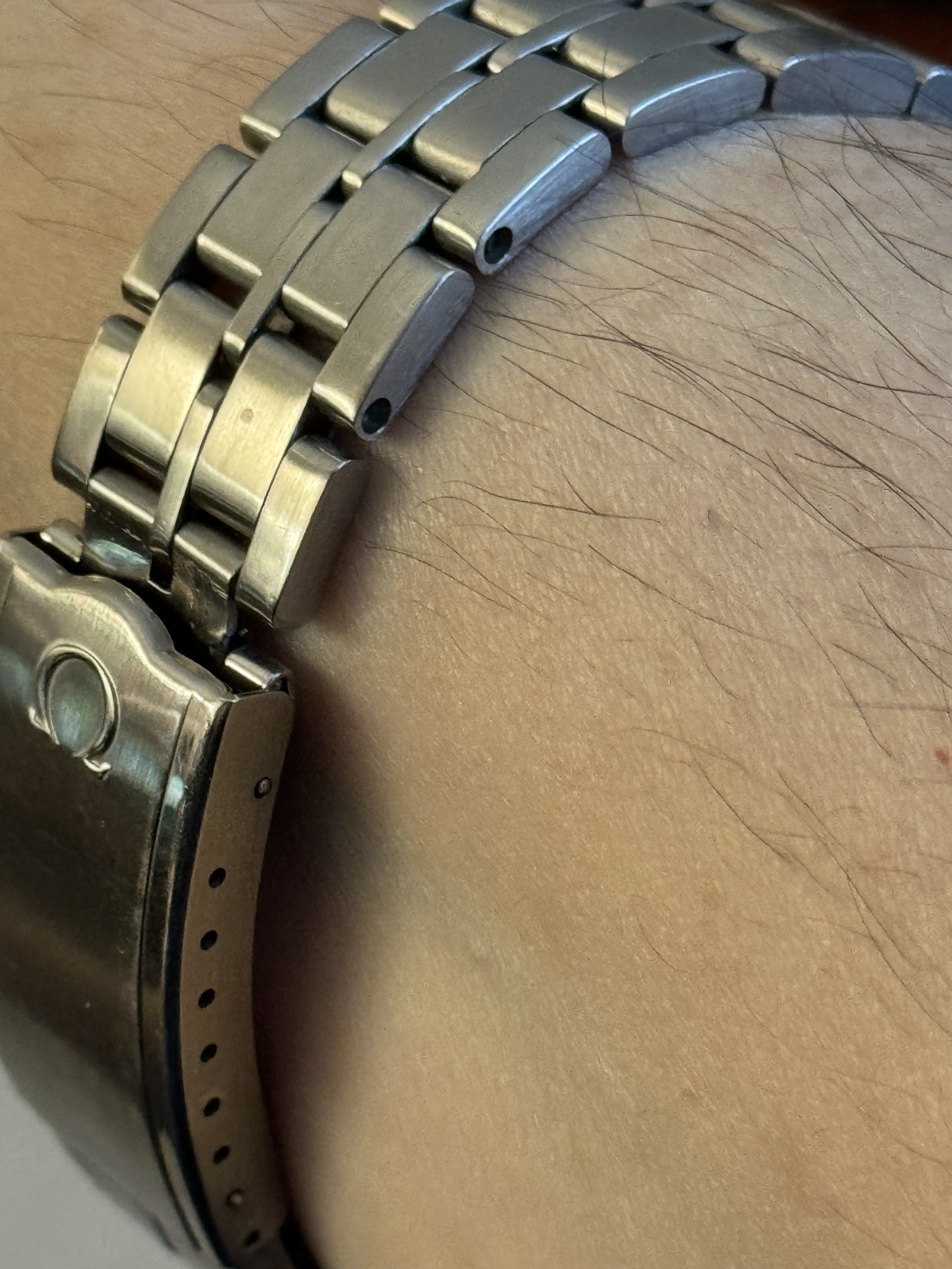

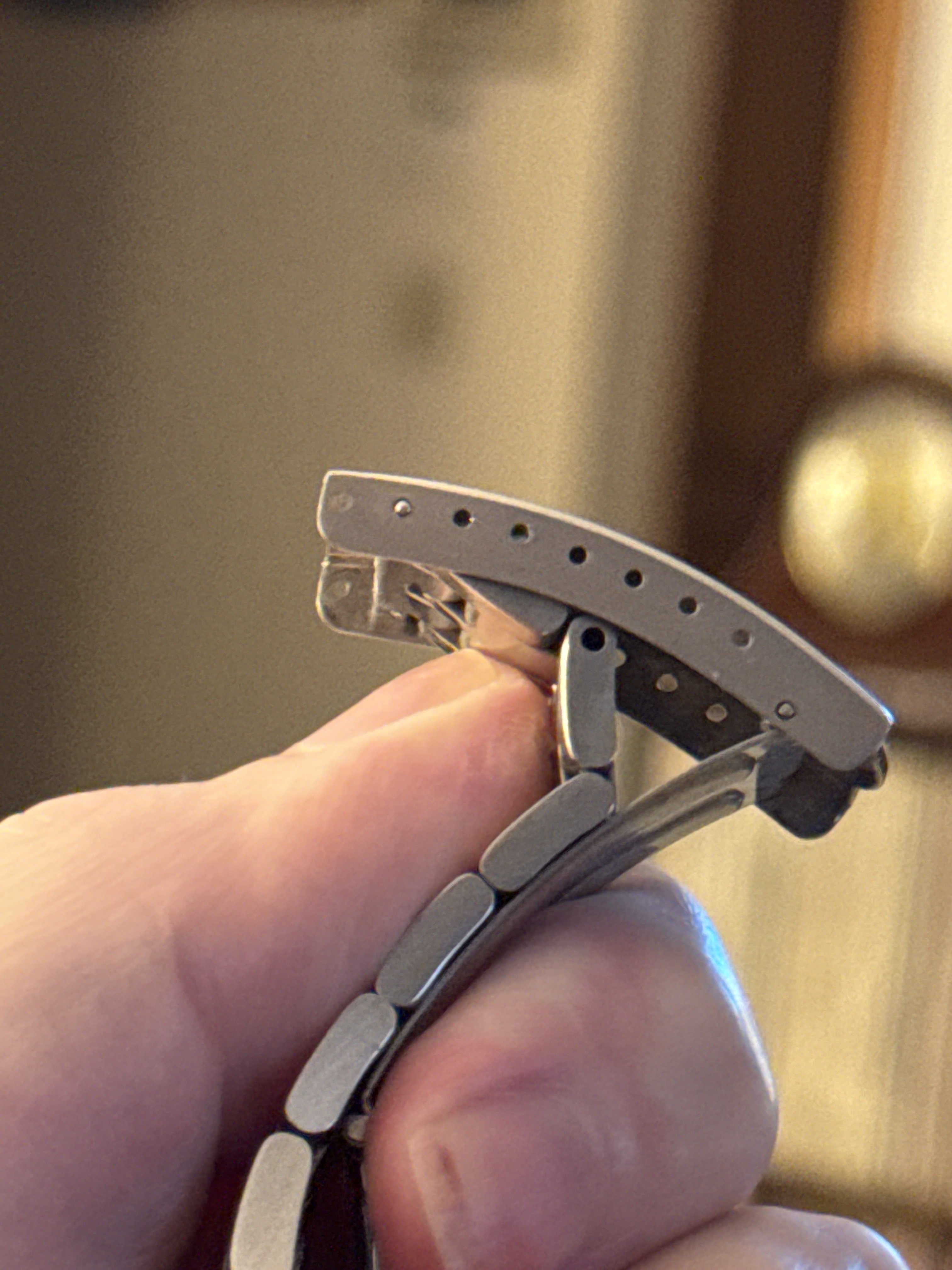

Do my eyes deceive me or is the bracelet attached to the clasp on the last hole? Or was that before you got the bracelet to the smallest size? Have a jeweler move it closer to the center of the clasp for you. (I don’t advise doing it yourself unless you like hunting for spring bars.)
Here’s mine for reference, on the second-to-largest adjustment.

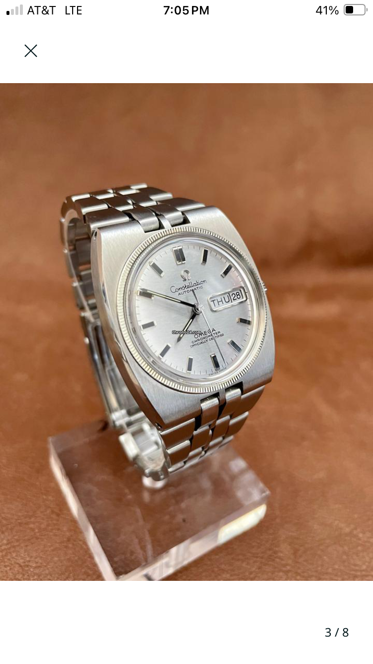

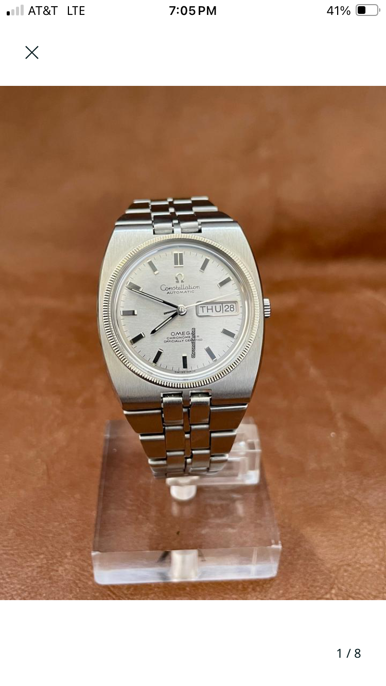

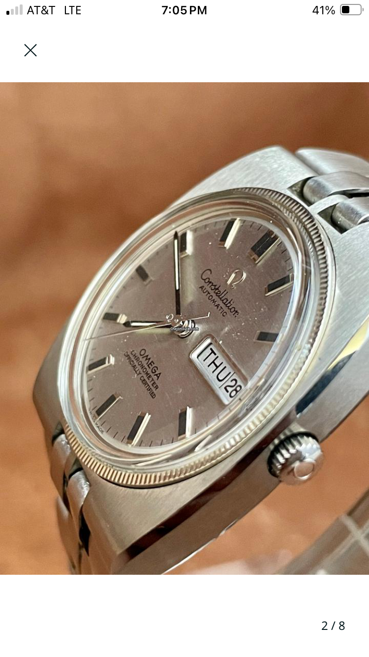

Looks like Ch24 photos from the listing.

It also looks to me like there’s at least one removable link on the 12:00 side of the bracelet.
Again, mine for reference.

Judging from the pictures - of a Chrono24 listing of a watch you might have acquired - you have some holes in the claps you can use to shorten the bracelet. It is a quick and painless procedure you can do even with a wooden toothpick and a bit of patience.

There are two ways to shorten such a strap:
- You screw off the normally two extra links.
- You put the spring bar in the clasp at the smallest position.
If these both do not help, its the wrong watch for you!
I do not recommend to destroy the value of the watch by brutally cutting further links.

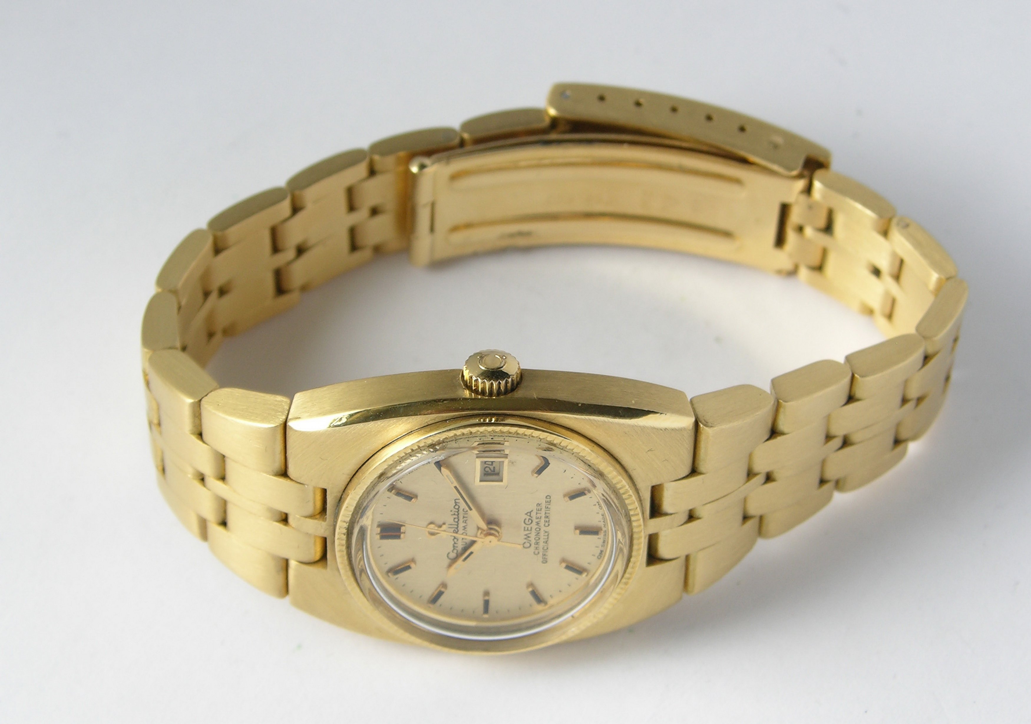

When you have such a small wrist, better wear the ladies version of this watch 568.014 (att.)
