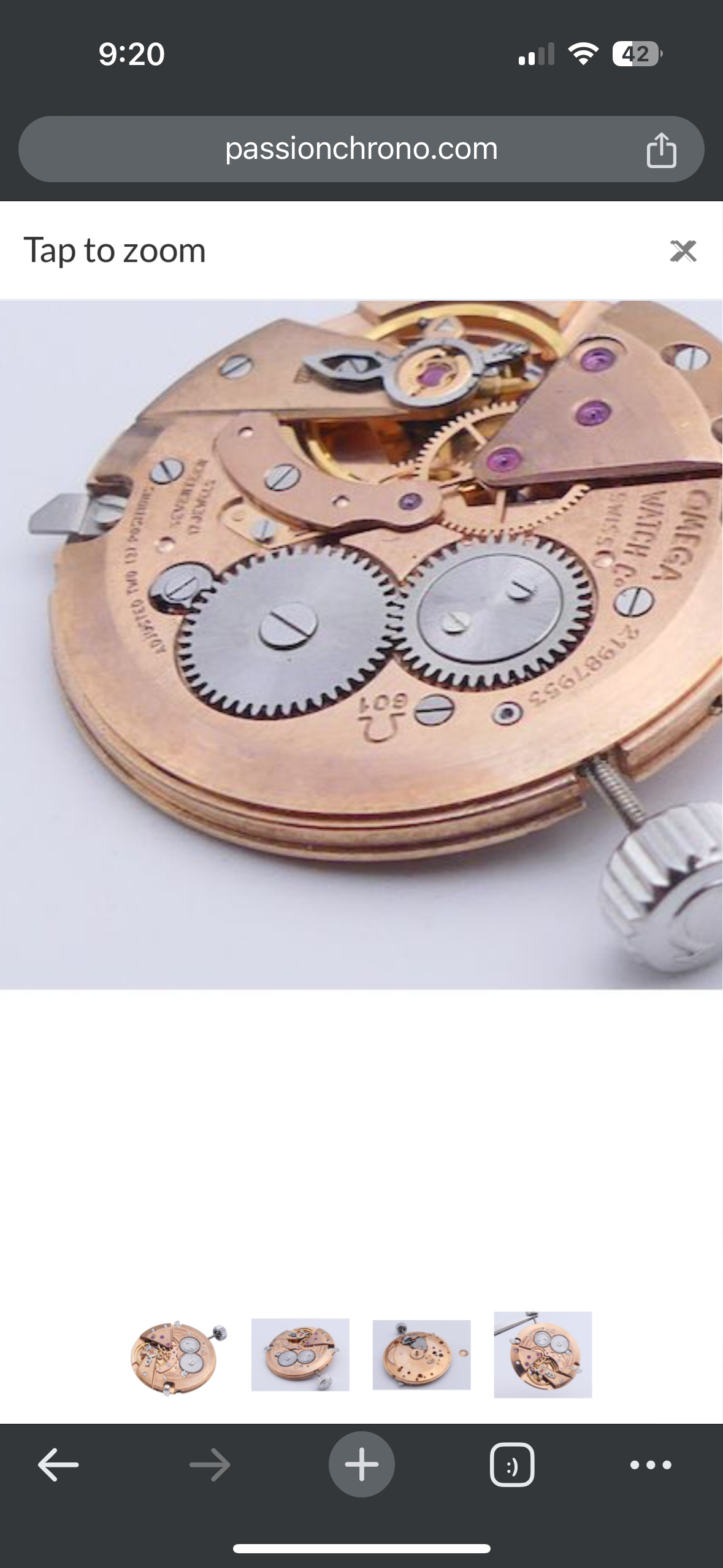

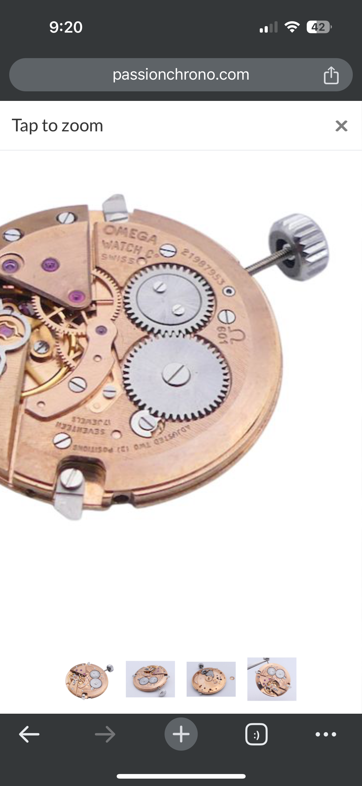

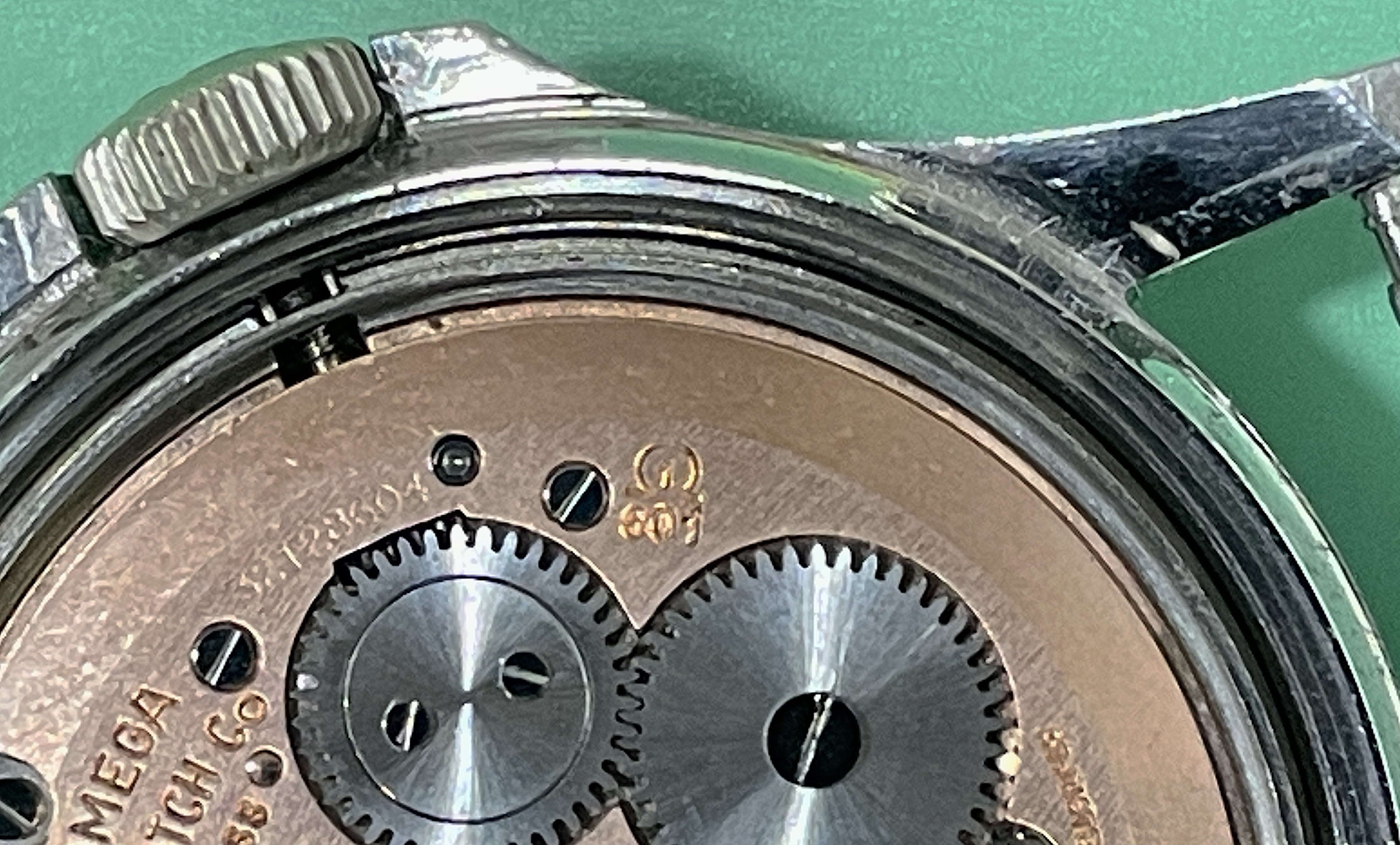

This poped up in the ebay thread, and I had a question regarding the movement. Links to ebay but I've also included the pic of the cal, as well as two photos of the reference cal
Omega Geneve Admiralty 135.015 Cal 601 in steel going no reserve, nice sharp example
https://www.ebay.com/itm/235678492137
Question for the experts on this one.
Clearly the movement should be a 601, and from what I see, it looks identical to reference photos, with one thing I'm having a hard time rextifyinf.
I see pretty clearly that this admirals "601" looks stamped "501", a much older auto movement.
Maybe I'm not reading right but I've attached some images to explain
The photo from the listing, the first digit looks like a 5 to me. I figured, could be a trick of the light, but when I looked at reference movements (attached) the top of the six, much more visible in the reference photos, is clearly rounded at the top of fhw 6, while the photo of the admiral's "6" (looks like 5 toe) is clearly flat on the top, and the angle down from the top is clearly slanted.
Additionally, the omega signature above the movement caliber has a 1 stamp.
If I'm stupid, call me out, I know enough to know that seems inconsistent, but I'd not be shocked if there's some backstory there...
Slight update, checked numerous serial guides, both manual and database, and they concluded that serial number was indeed produces in 1970which is appropriate for the watch, but the 501 was only produces from mid fifties to the very early 60s

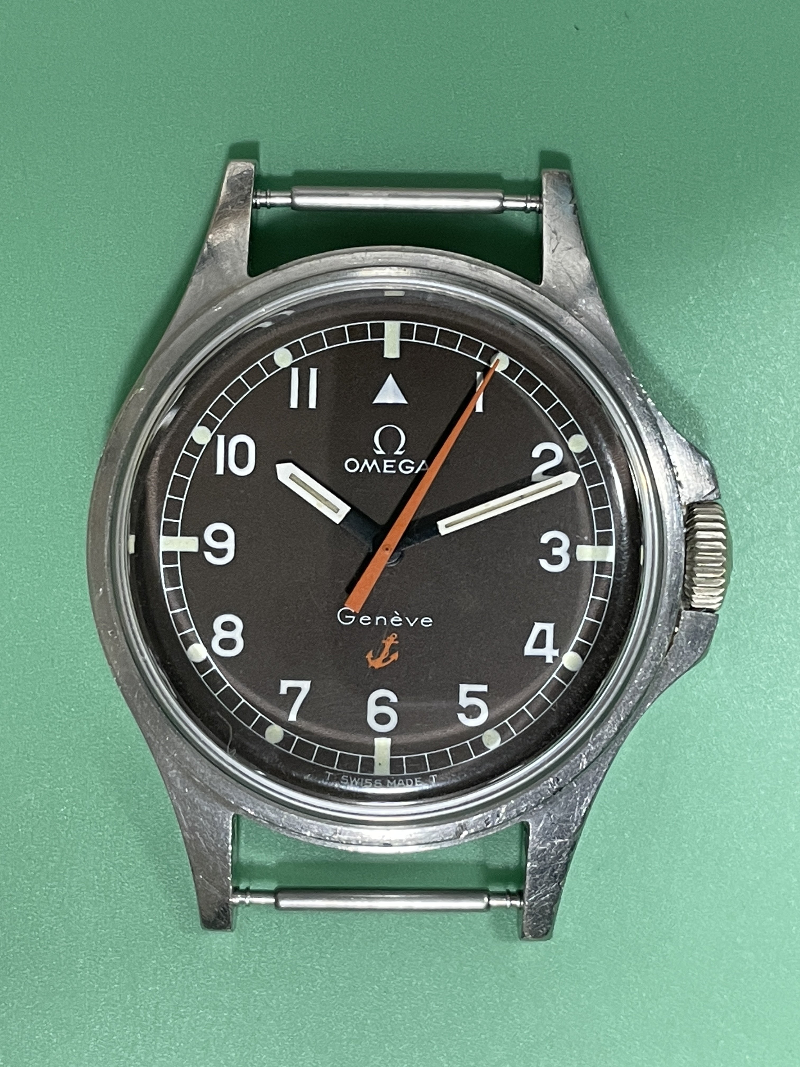

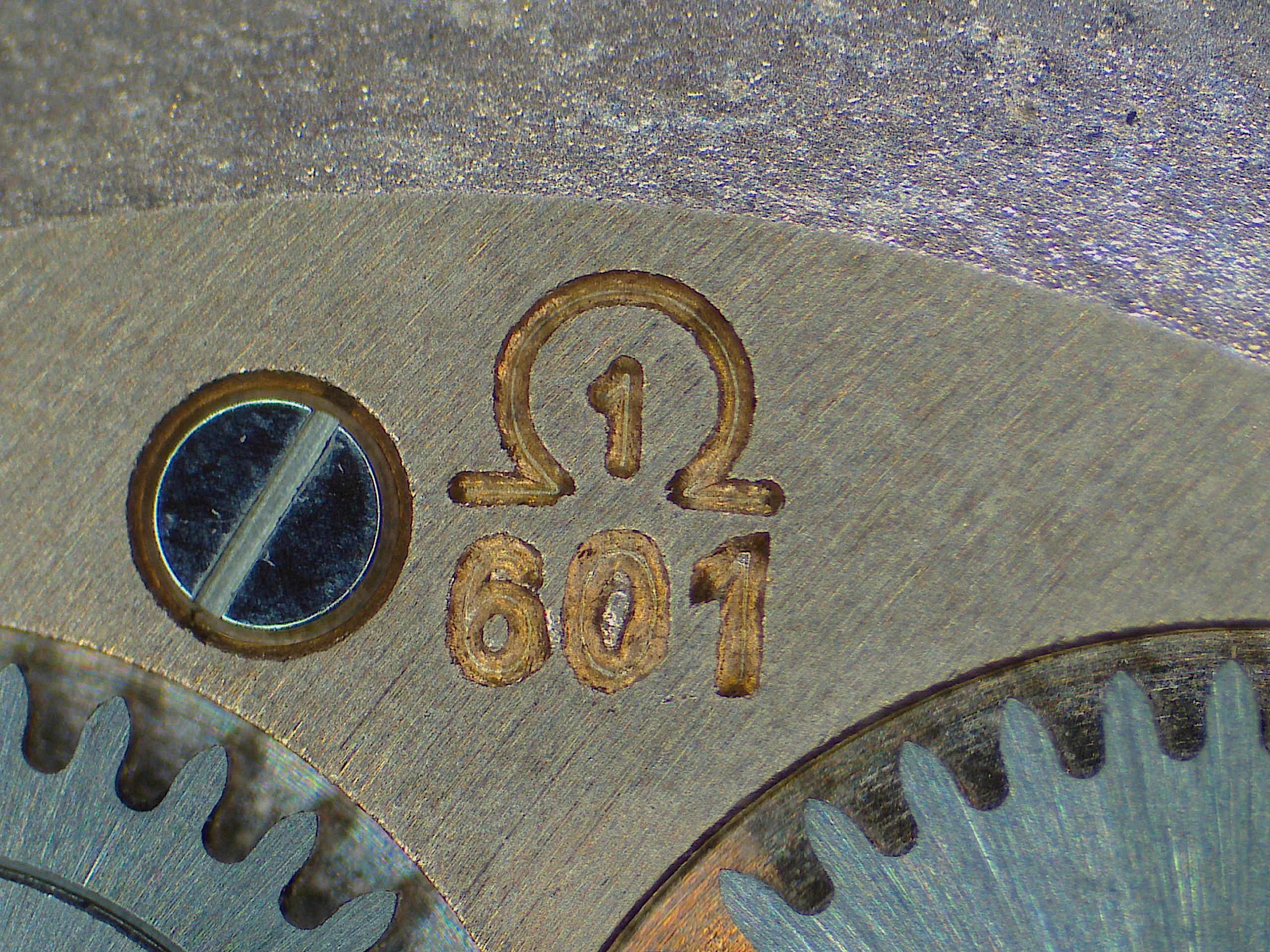

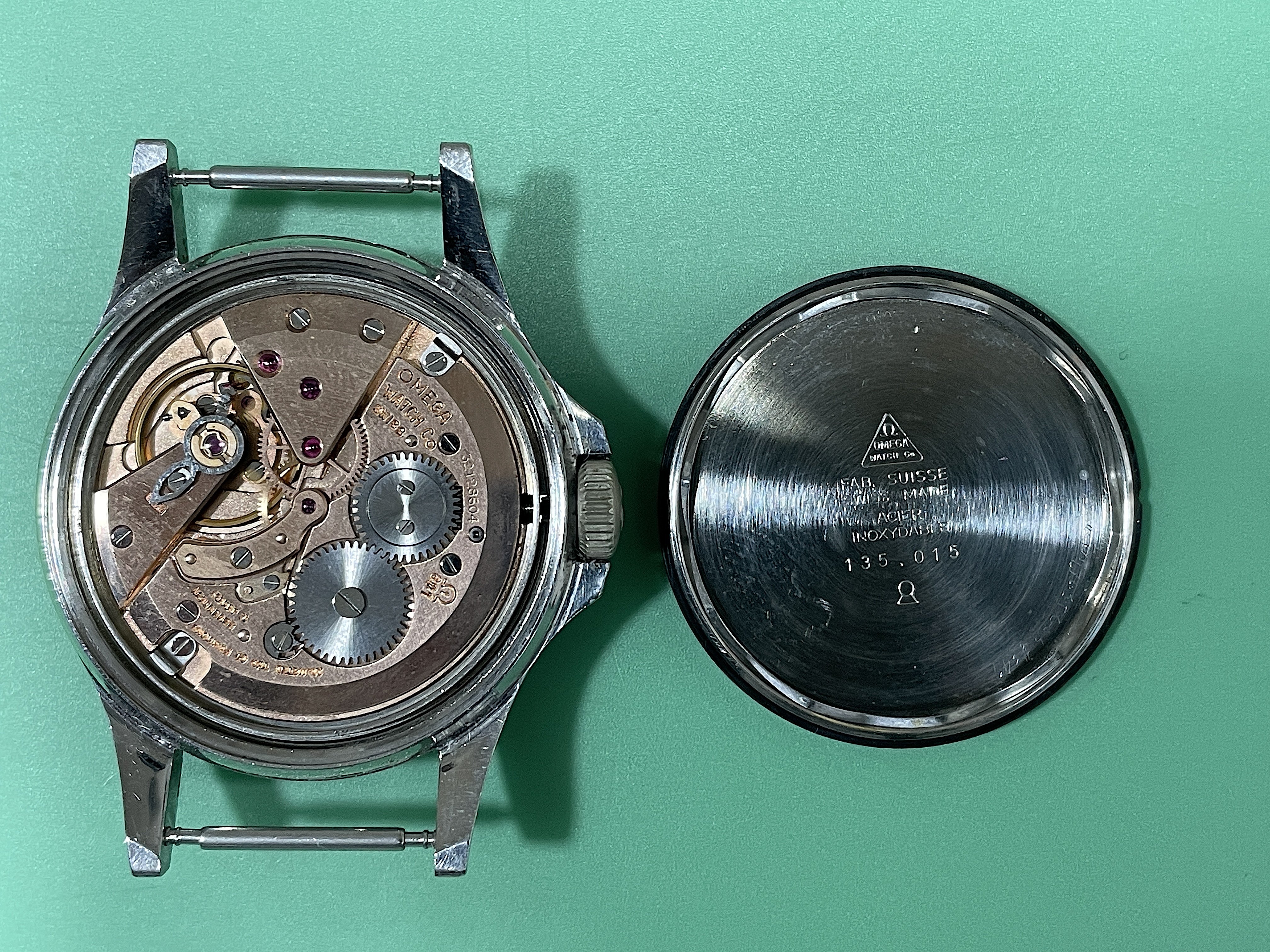

It's just a bad engraving, maybe a bump on the pantograph or engraver when it was being done.
Here's mine, shows the same marks so the engraver was probably on the fritz.
907
3,818
501 is an automatic movement anyway. I think that's a nice watch, and the stamping issue makes it unique in my opinion.

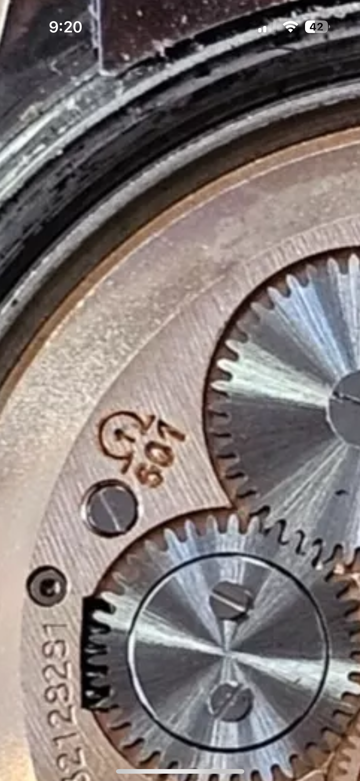

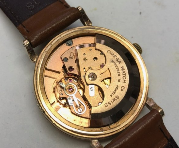

Where on a 501 movement would it be stamped? Is that in the same place as the watch you are looking at?
907
3,818
Using another member's photo from this thread, but the quick answer is no:

Thanks guys. I knew the movement looked correct, escapement, bridges. Are the cal numbers hand engraved?
No, they are mechanically engraved.
As @X350 XJR said, mechanically/machine engraved.
Not to AP VC PP standard though.
