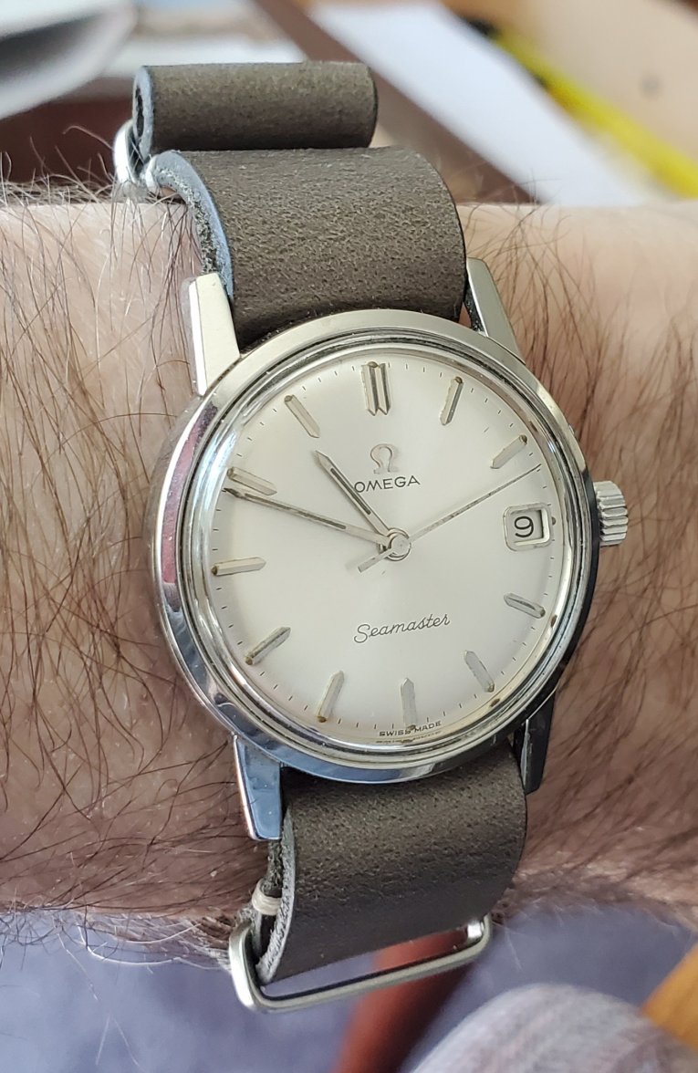

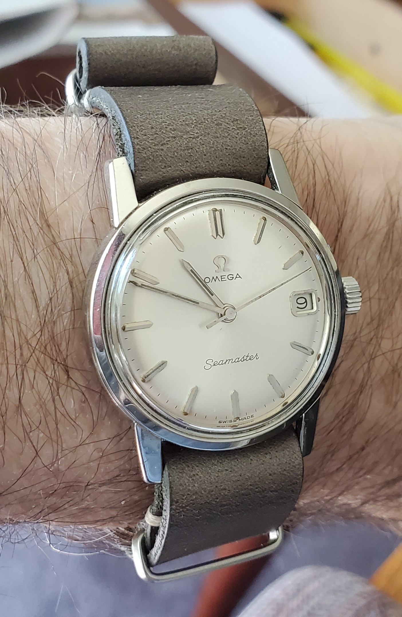

The case has been pretty heavily polished and I'd say that the back has been machined down - likely to remove engraving. Patina on a dial is a matter of personal preference but this one falls more towards severe damage in my opinion. All 3 issues would make this a no go for me. I think you can do better for that price. Here us one I bought face to face on kijiji this past year for the same price. The case is polished but the dial is intact, as was the seamonster caseback.

Welcome @FarmYard - agreed with the above, it’s a little toasty. If you love the looks of it- then try to negotiate it down to something more sane.
For reference- here is a nice example of a slightly patina’d Seamaster for very reasonable money in the classifieds here.
https://omegaforums.net/threads/omega-seamaster-600-ref-135-011-serviced-450.124315/
The seller for this Seamaster 600 is from Canada, which makes this even better, as the OP would avoid the import duty and taxes.

Thanks for the input everyone. This explains why it's been up for sale for approximately 6 months. They do have some pretty clean stuff with nice faces that tend to go pretty quickly.
amcclell that is a very nice looking one.
