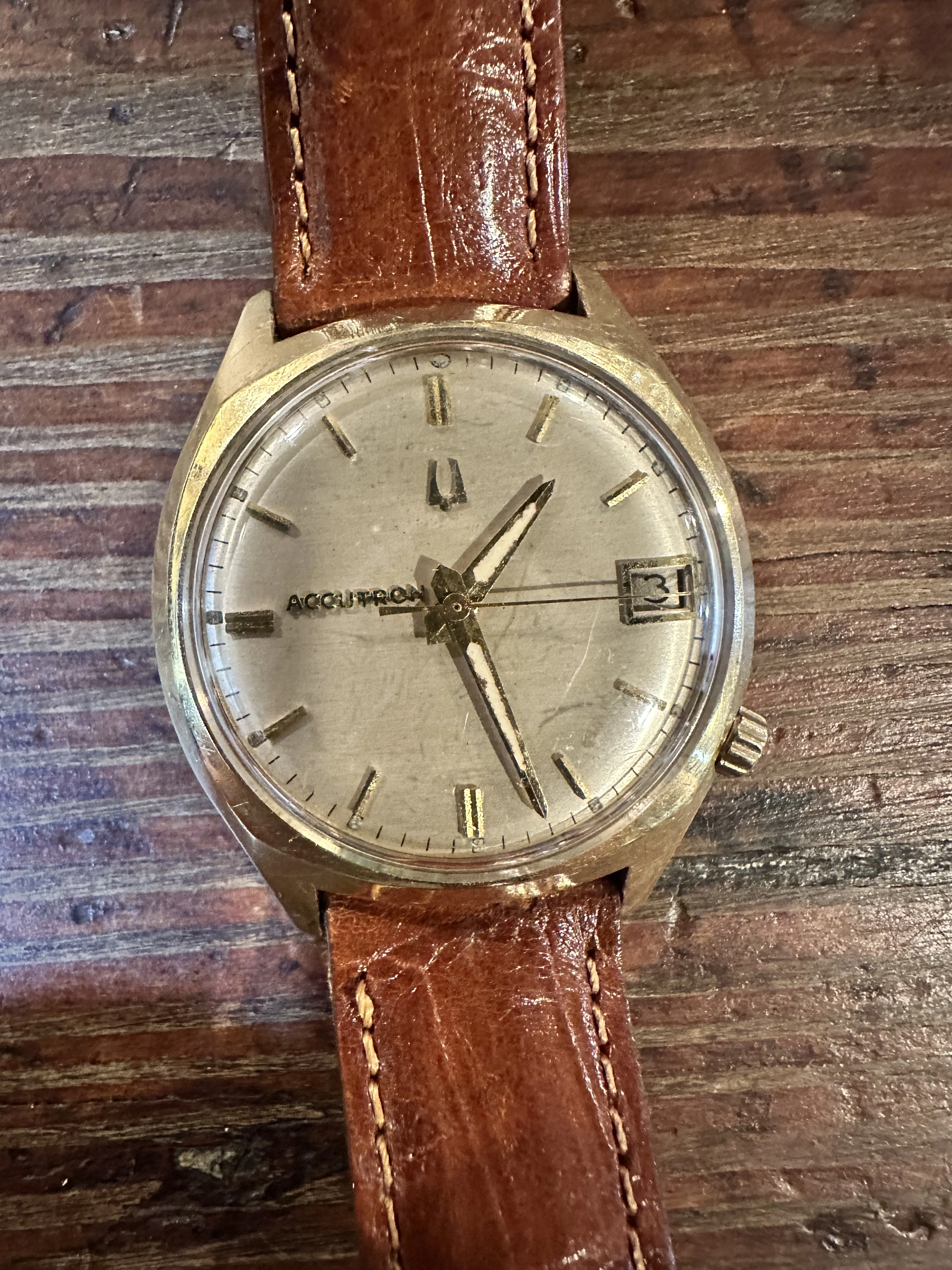

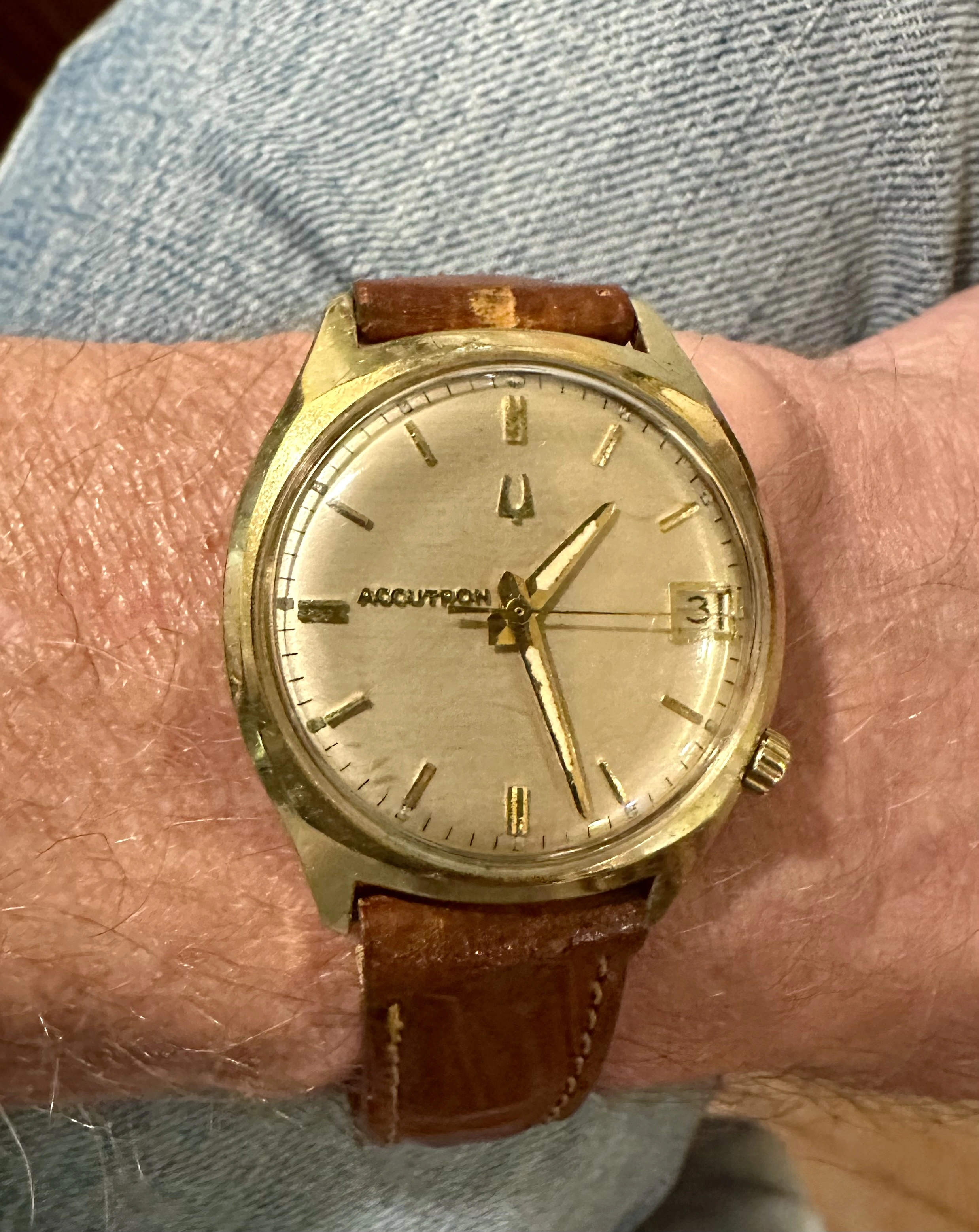

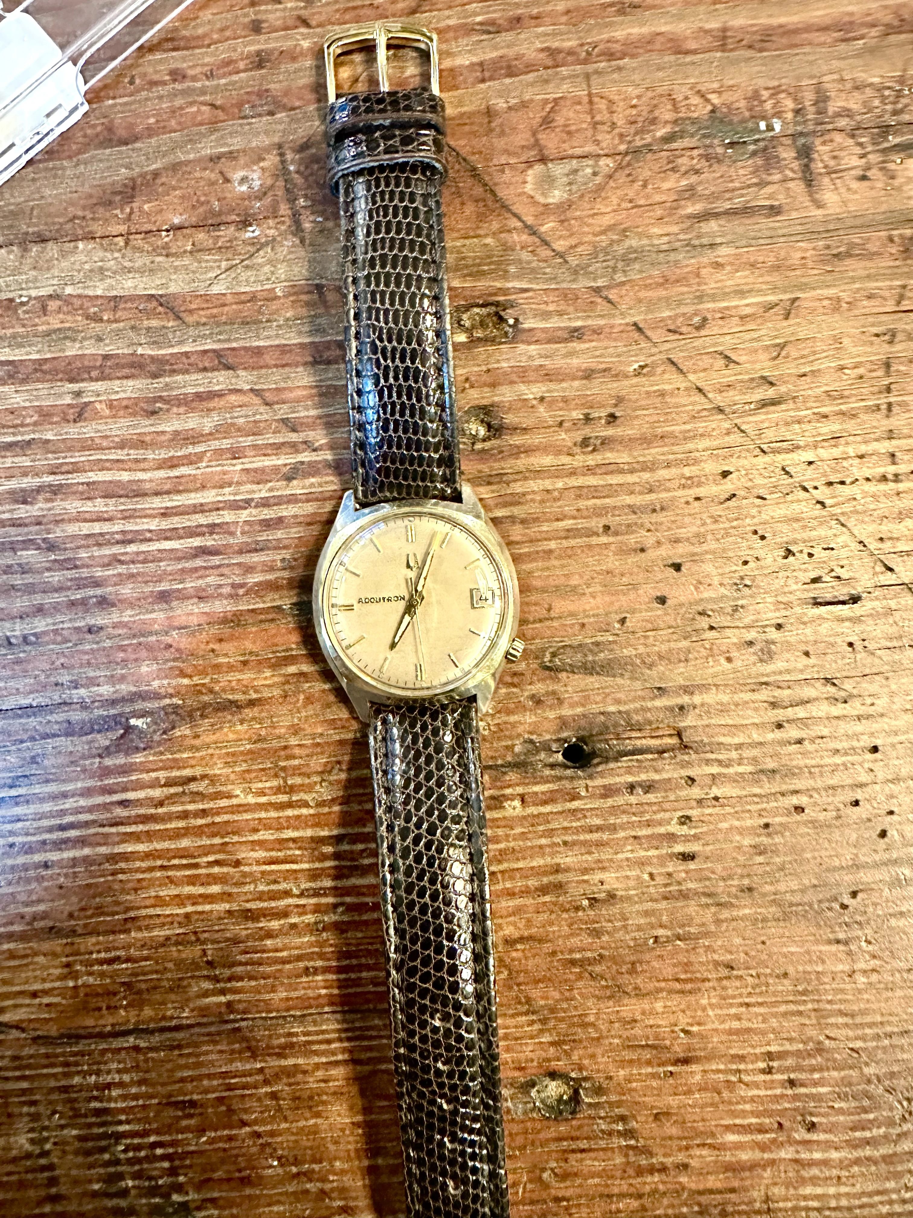

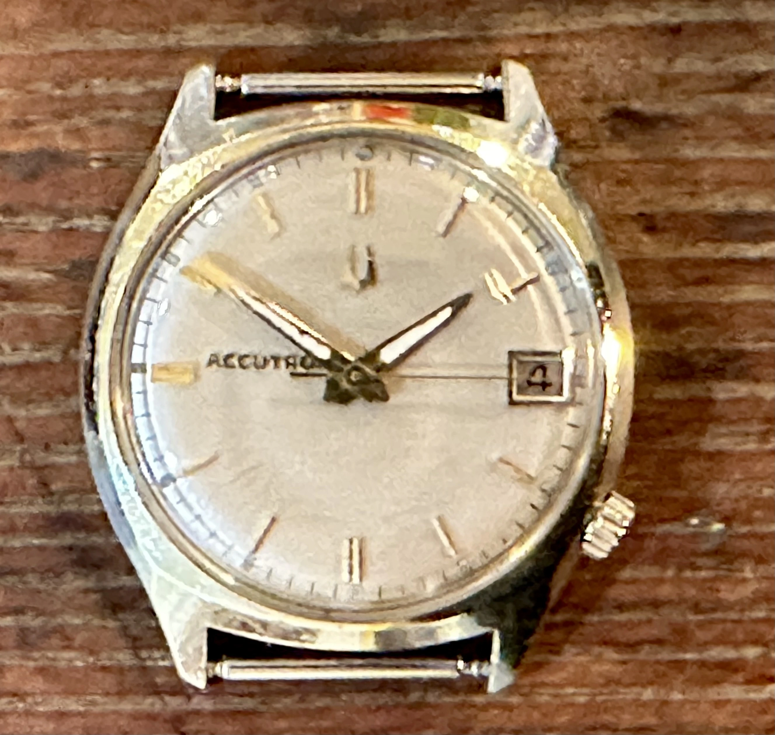

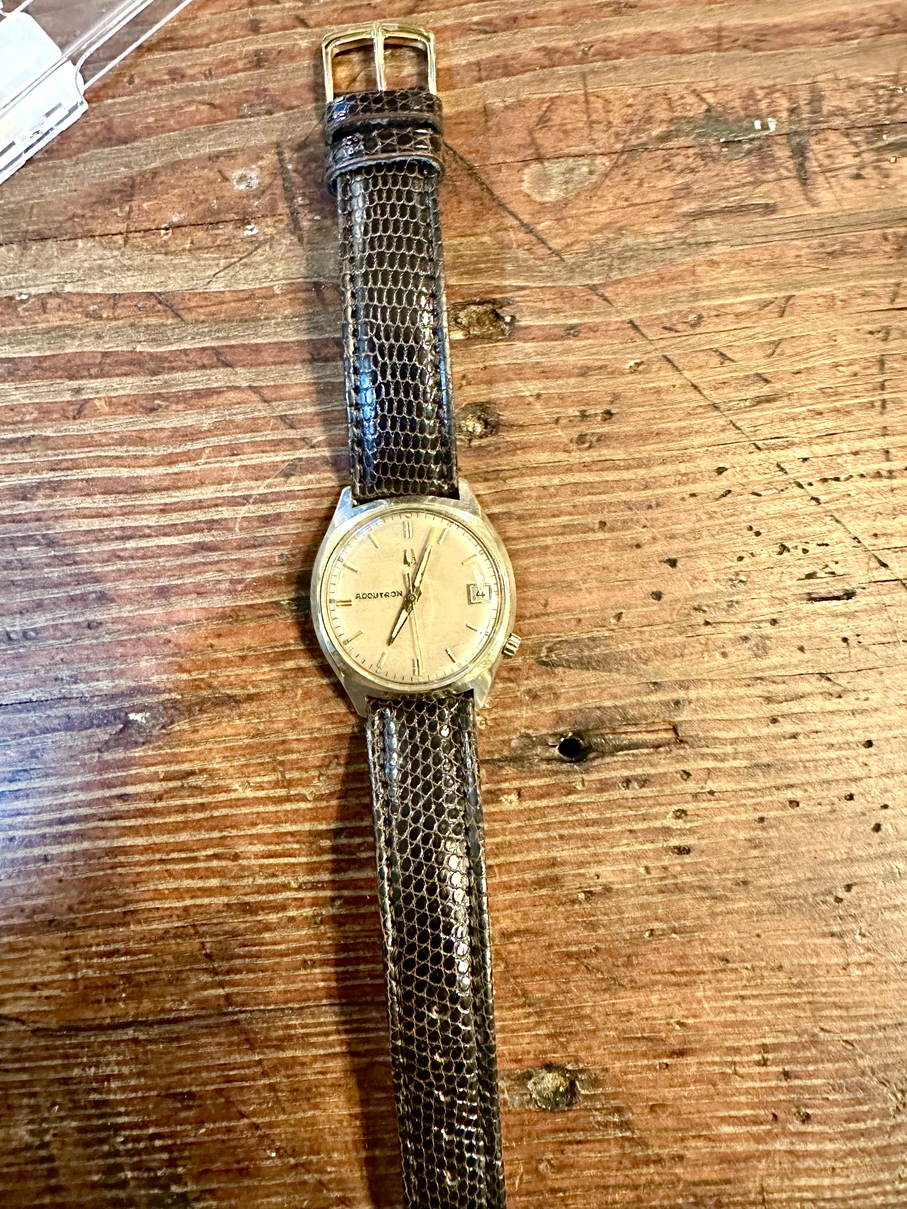

Ran into an 81 year old neighbor who works leather who at a city council meeting last night. I asked him if he did watch straps and he said “no, but are you interested in an Accutron”. The answer was obviously yes. We met tonight at his place. Turns out he was a UHF VHF radio operator on the USS Decatur, USS Topeka, and USS Boston (with a stint on the USS Bang submarine) the mid 60s to 1970 in the Vietnam era. He bought this Accutron on the USS Decatur because he needed the accuracy in his job. He wore and used it is every day. He has no one to leave it to and he wanted me to have it. He tried to give it to me and I refused. All I had in my pocket was $100. He smiled and said “just love and care for it”. Helluva find…and 10k gold case was the icing. We are getting back together to look at his war and carrier pictures and records. I’m stoked as much by the story behind the watch as I am the watch. Now I’ve got to find a battery. This one has been serviced at some point by Bulova according to him. I’ll get pictures. Great evening with a guy who could tell stories all night.

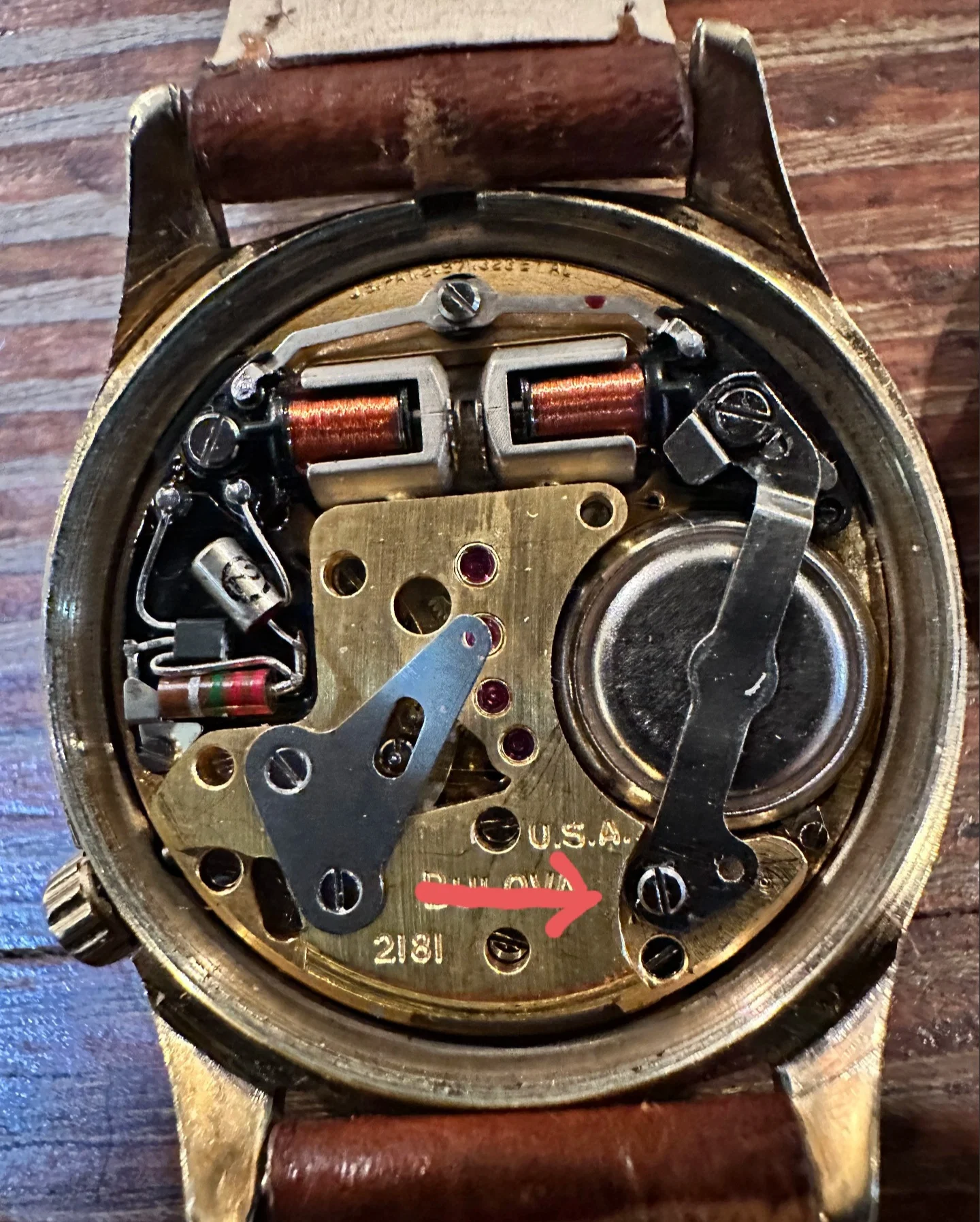

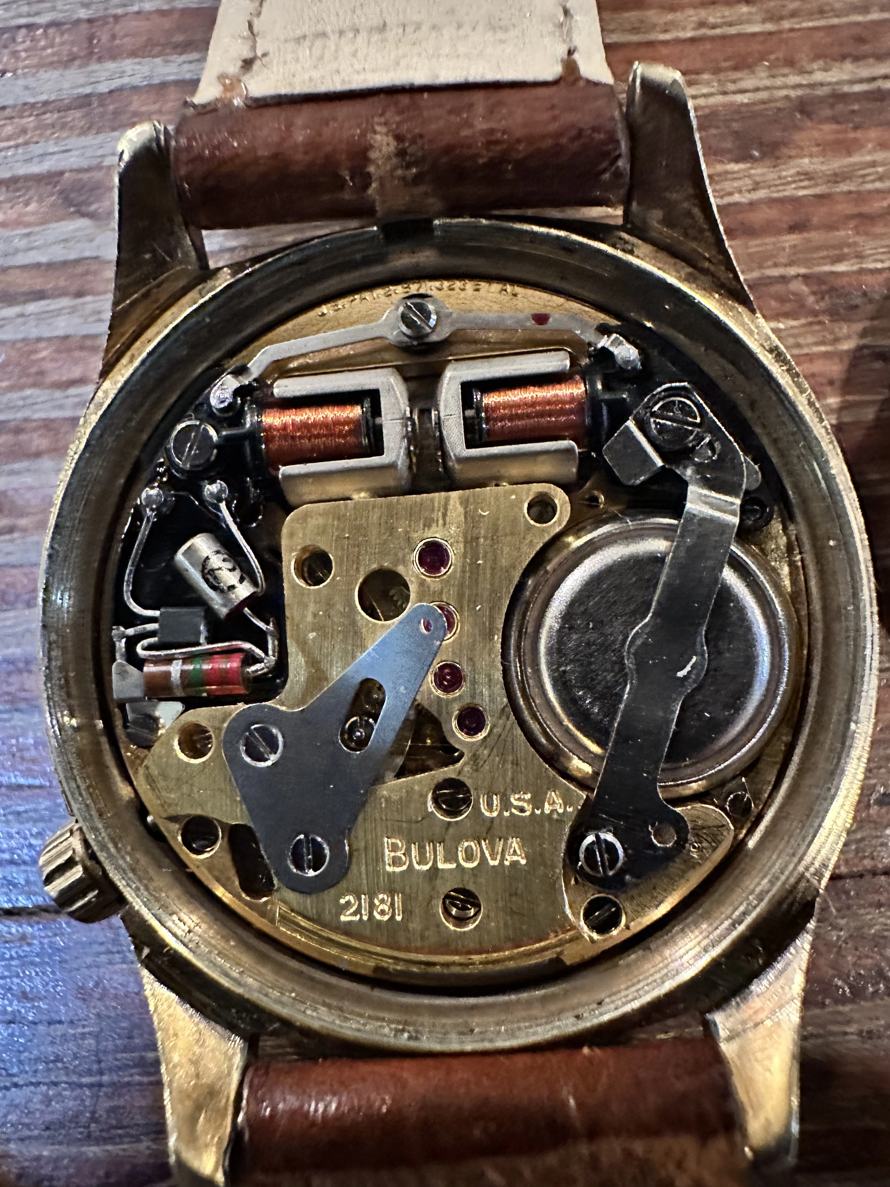

Great story and a nice watch to boot. If you haven't already, I'd suggest removing the old battery.

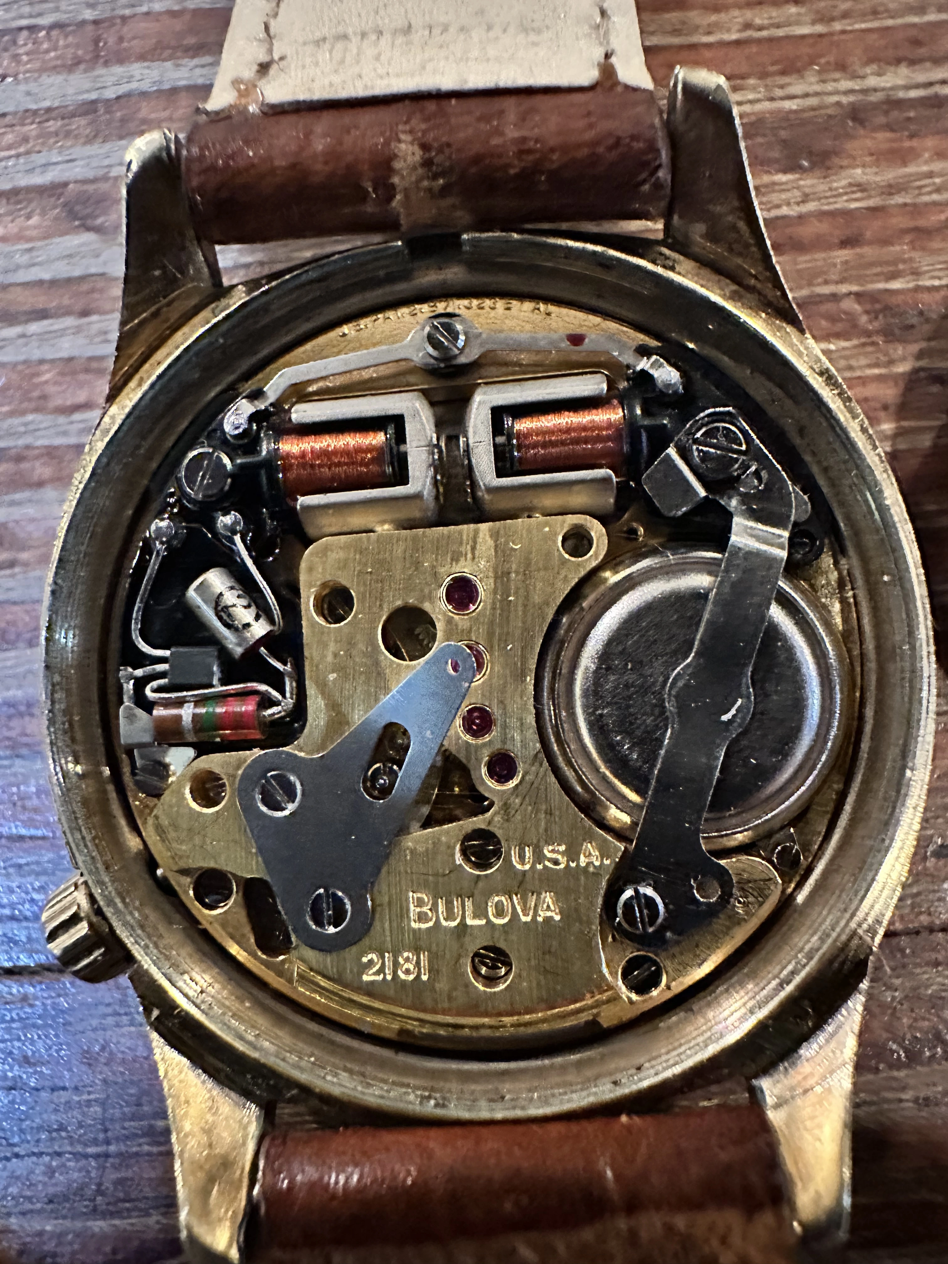

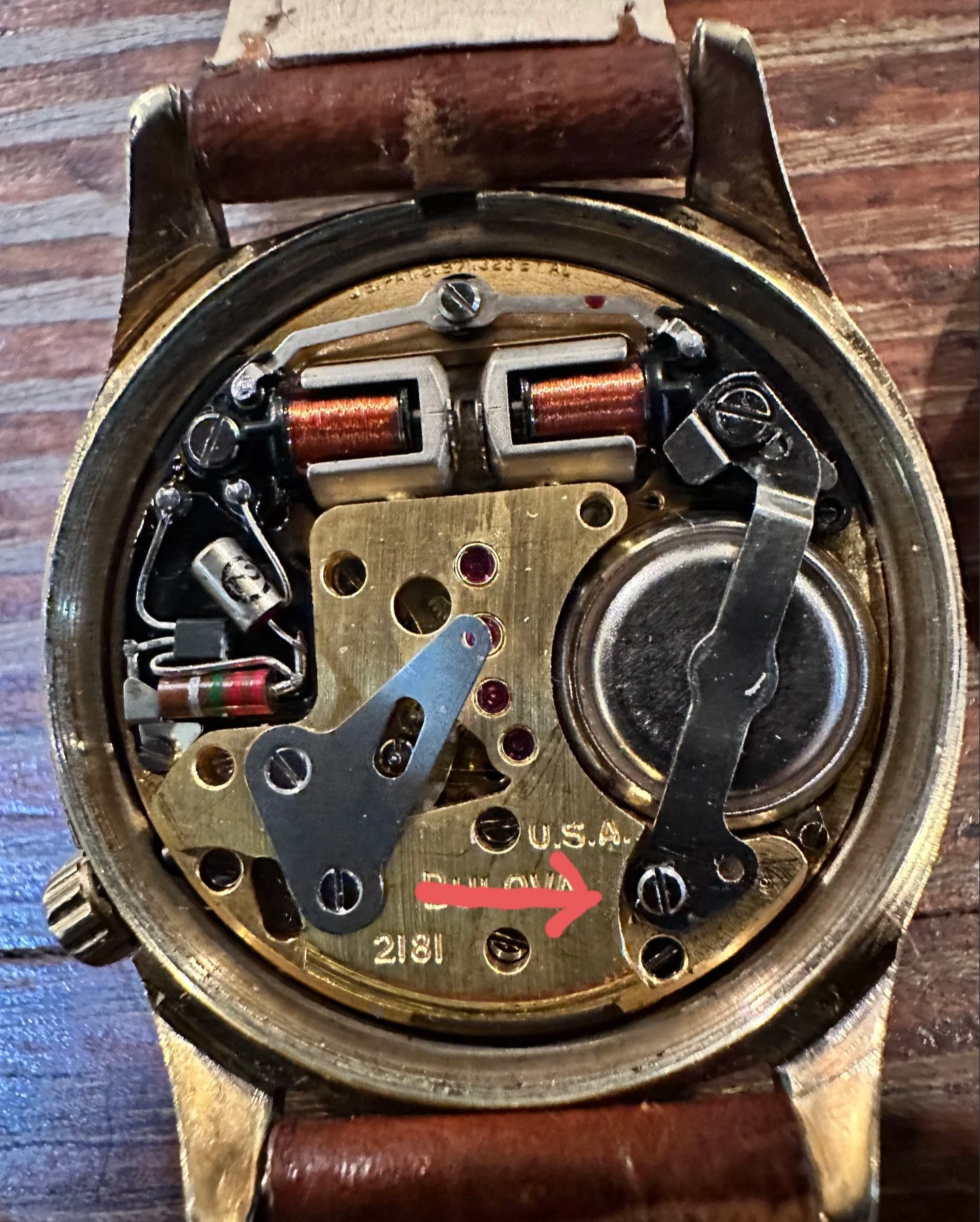

I’ll remove it tomorrow. I’ll have to fetch my very small screw drive set. As I understand it, the screw has to be loosened and the arm will pivot out of the way for the removal. Is that correct?
800
2,412
Yes, this screw needs to be loosened, then the retention arm can be moved. It's probably one of two batteries, depending if it was converted over (forget offhand what the original ones were, think the converted ones were 1.35)
They're not tough to replace, just need to be mindful. Also, once you replace the battery, you'll might need to move the watch back and forth holding it palm up to get the pawls to re-engage and start the second hand moving again.
Been a while since I replaced a battery on one so going from memory on this. Good luck and look forward to the update.

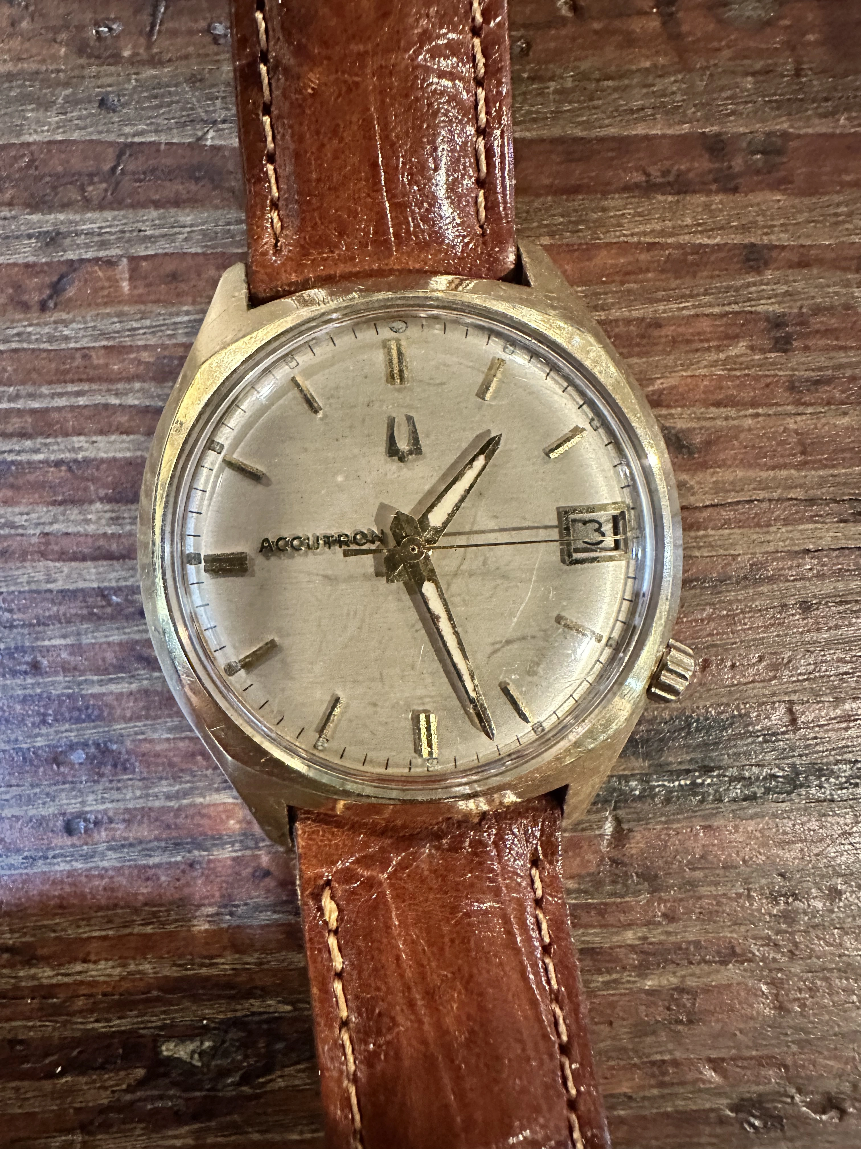

Light polish and polywatch complete. New battery today (and the difficult choice on a watch strap, always complicated by trying to figure color and texture from the internet)

As Vinz Clortho correctly showed the 344 battery goes positive side down.
But (and I don’t mean to be a Debby Downer) … if the watch has not had a service recently (last 3-5 years) I STRONGLY recommend that it be serviced before running it for more than a few test minutes.
These movements have the ability to eat themselves alive. The Accutron motor is stronger than a mechanical watch movement.
A mechanical watch will run until its lubricants dry and gum up. The watch will (probably) stop before any mechanical damage is done to the movement.
Not so with the Accutron. The motor has enough torque to push the train past the point of dry gummy lubricants to excessive bearing surface wear/failure. Restoration then becomes expensive.
As Waltesefalcon recommends, check with RobB for service.

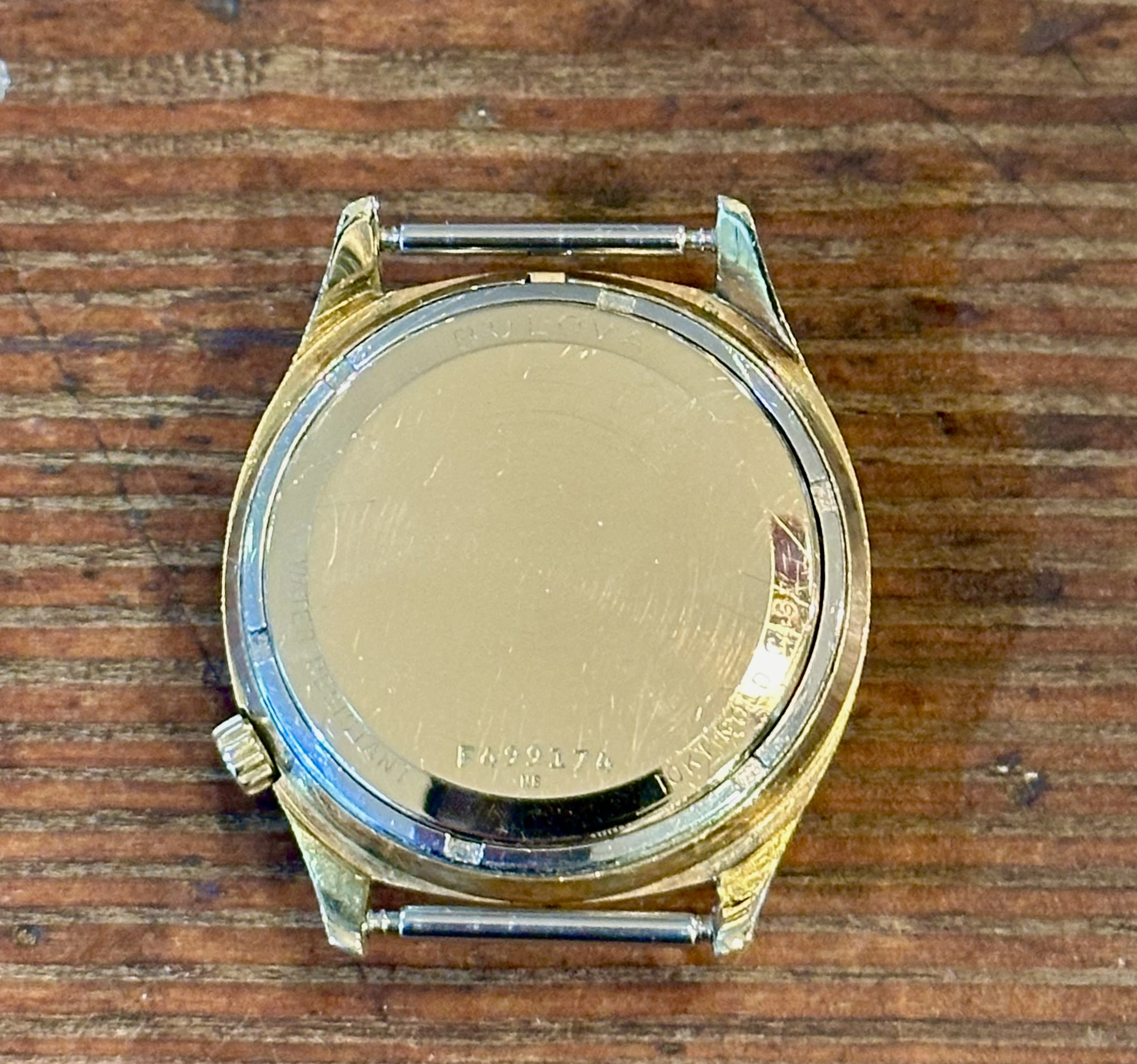

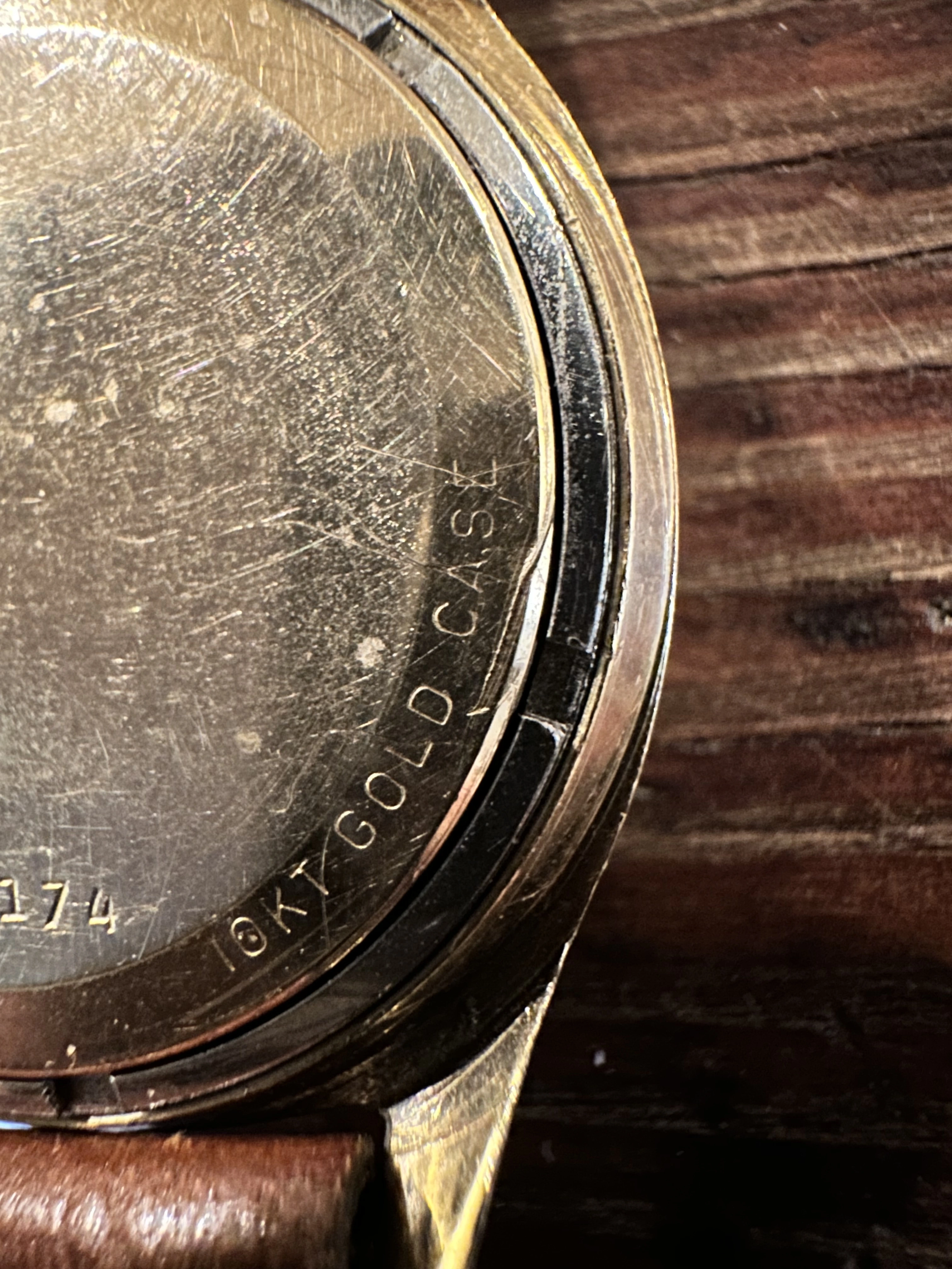

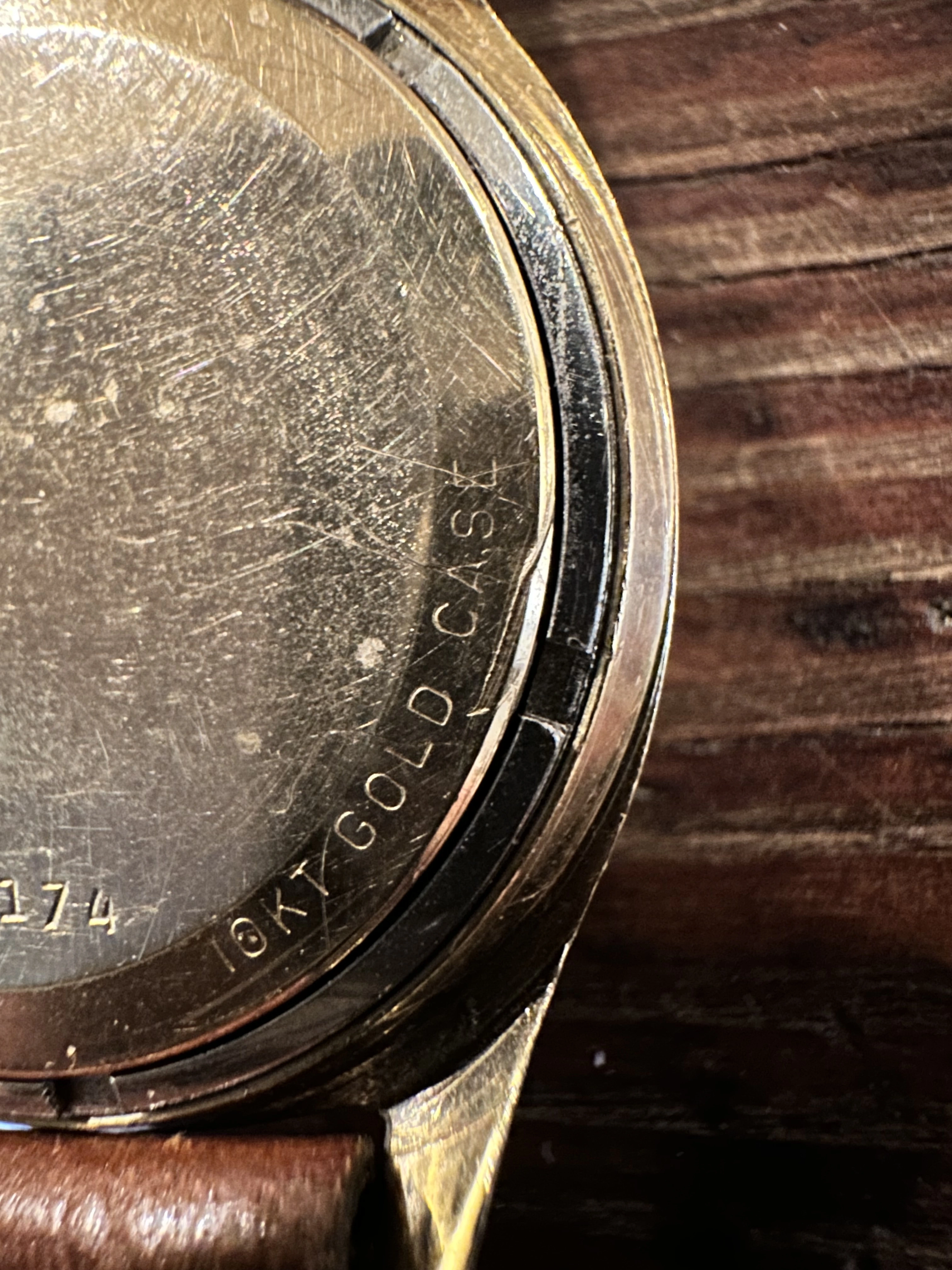

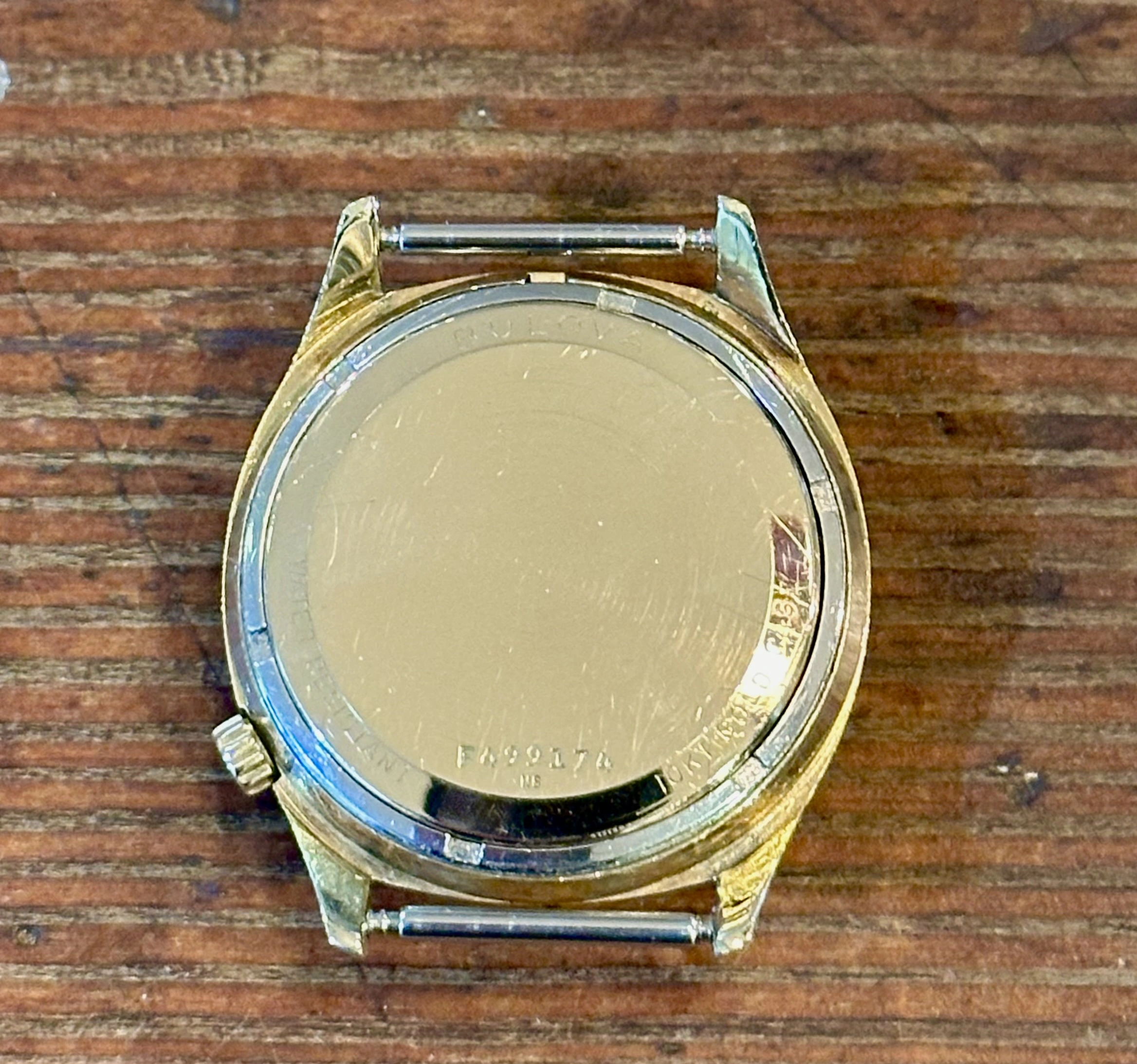

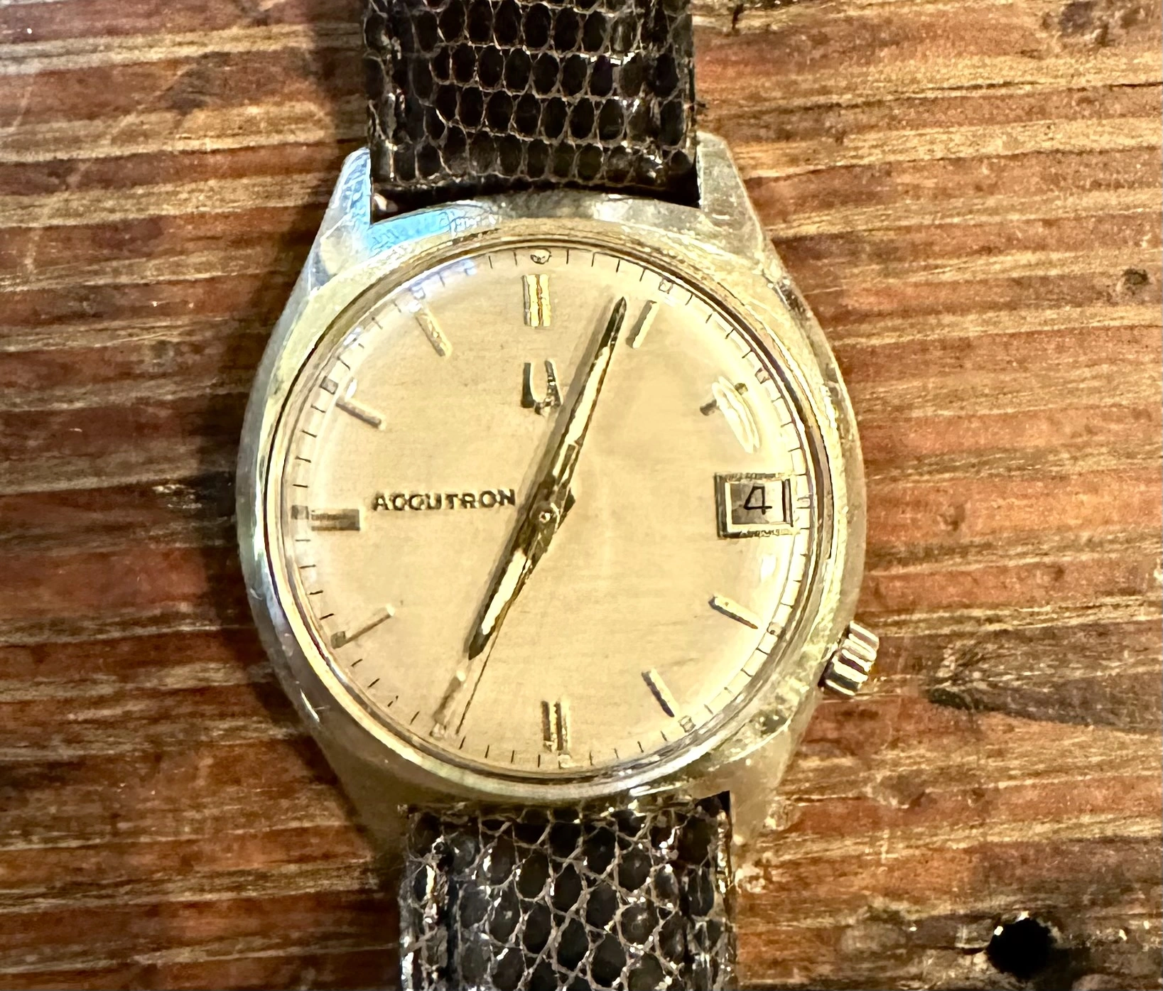

Another thing. Looking at the photo of the case back beneath the serial number, what two digits are stamped there? Looks like M8?
M8 is Bulova’s code for 1968, M for 1960s, 8 for 1968.
If the case, movement and case back are all original then your watch was manufactured in 1968, not 1964 as the thread title indicates.
Not that it makes any difference to you. Still a great watch and a great story.

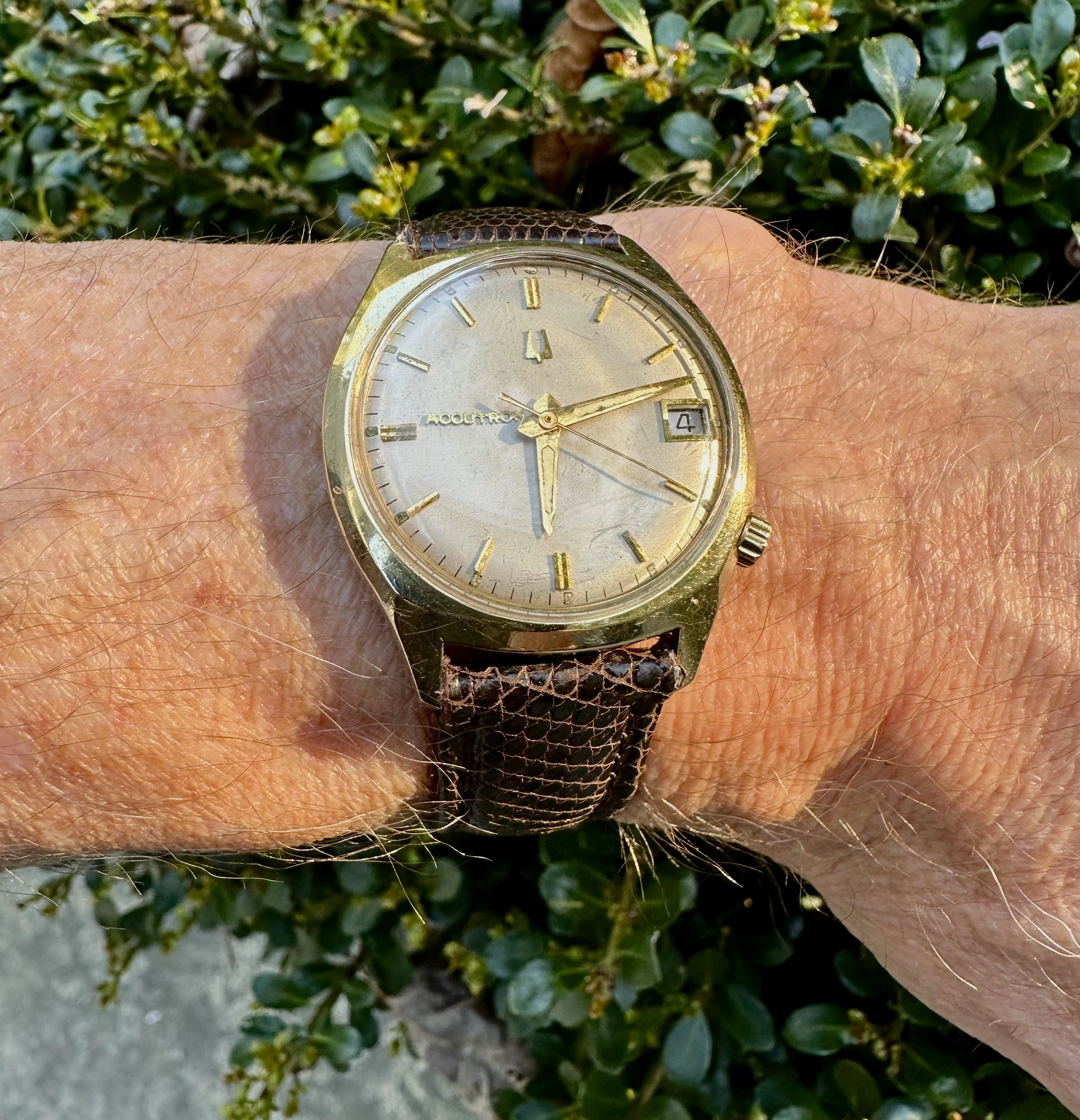

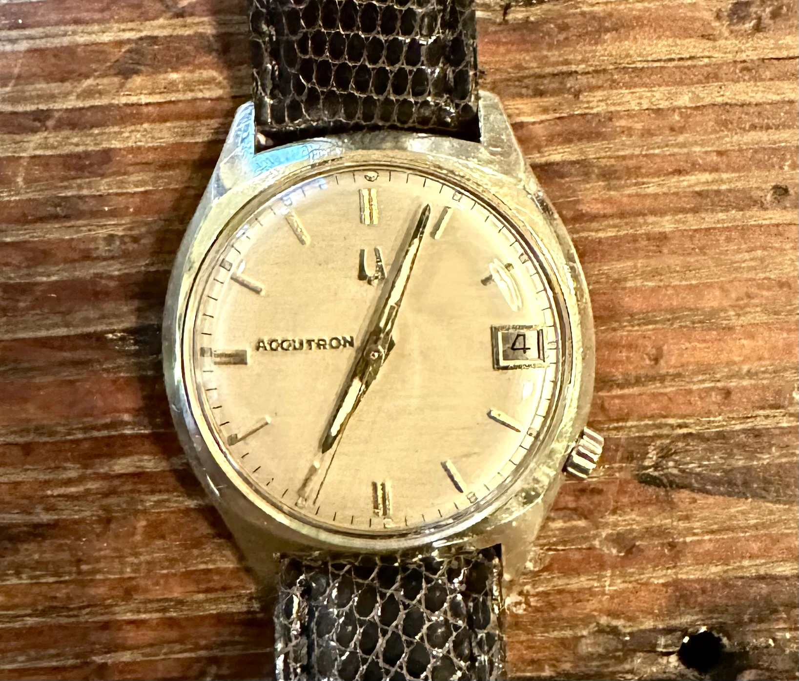

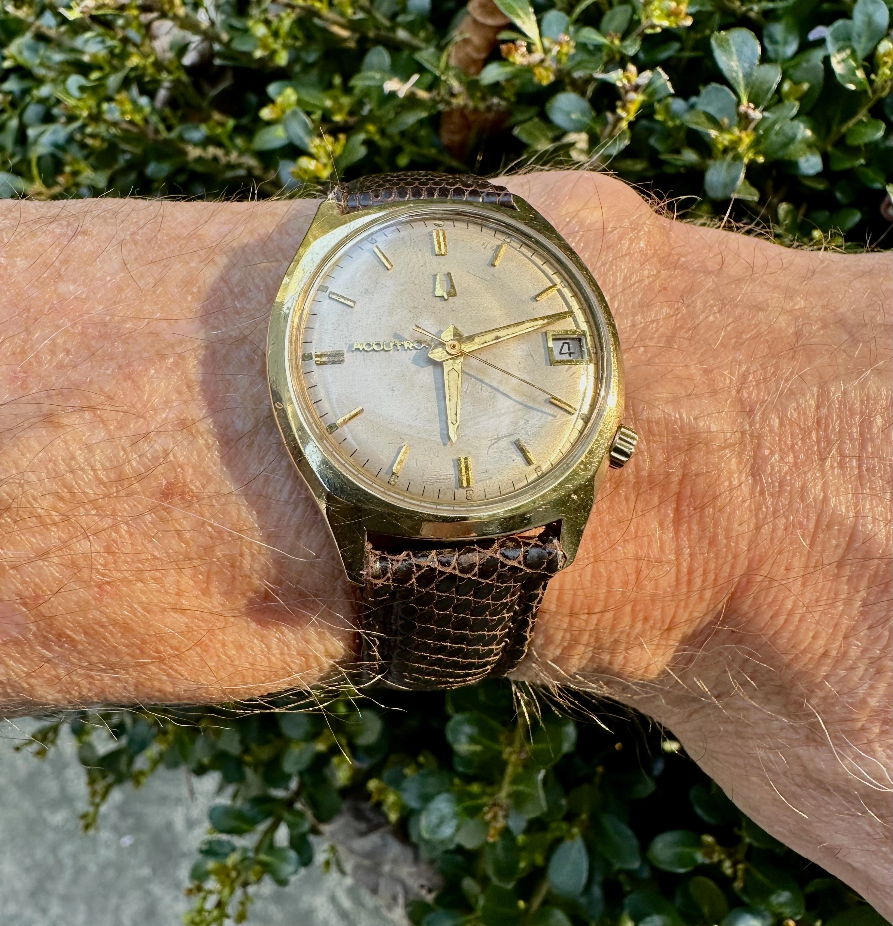

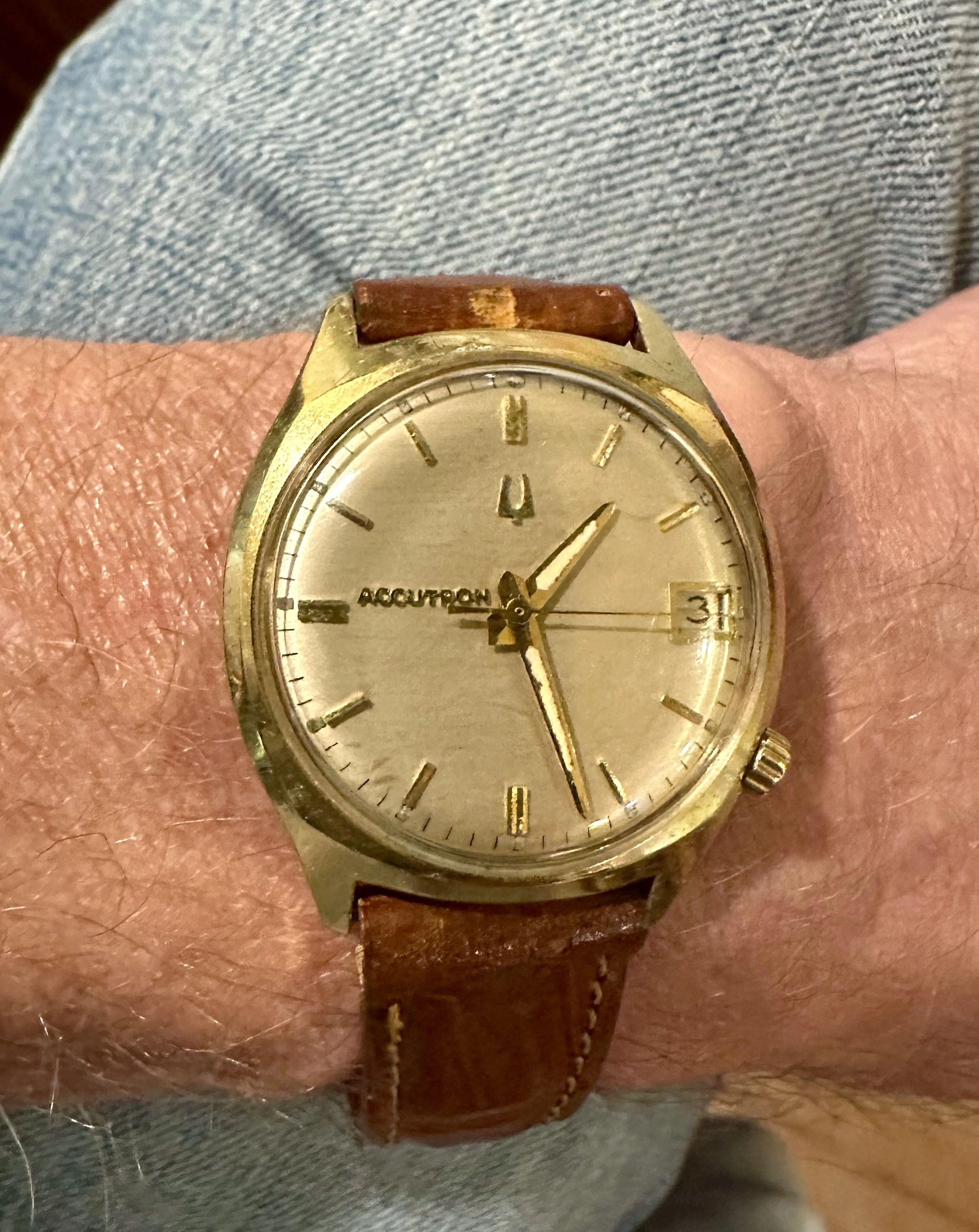

Local older jeweler had the battery. Not a shop I have frequented as he sends off watches to be serviced and his prices tend to be on the higher end. The watch is humming well. He was very impressed both inside and out of the watch. He, too, was a Vietnam vet and he also is supportive of police officers (I was in uniform coming off work). He had some nice watch bands as well. I picked up this Hadley Roma Tegu Lizard strap. Priced at $155.00. He looked at me and said that’s not your price. The man charged me $50 for the battery and the strap. I told him it wasn’t enough but he wouldn’t hear of it. He was way too nice. Anyway, here is the watch on that lizard strap.
The date code on the back of the watch doesn’t match the story, but I know the story is accurate. He had way too many details and stories around his use of the watch. He did send it in to Bulova at some point for a service after his stint in the service. From what I can research, Bulova would make changes if needed. It may have been recased or had a different back installed. He said he bought it in 1967. My original quick research had it at 1964. Nonetheless, it’s a great watch with provenance and we are getting together to look at his pics and service record. I’ll see if he has any pics of him wearing the watch on board one of the Destroyers or submarine. Again, the story is what intrigues me. I keep it updated as more info comes in.

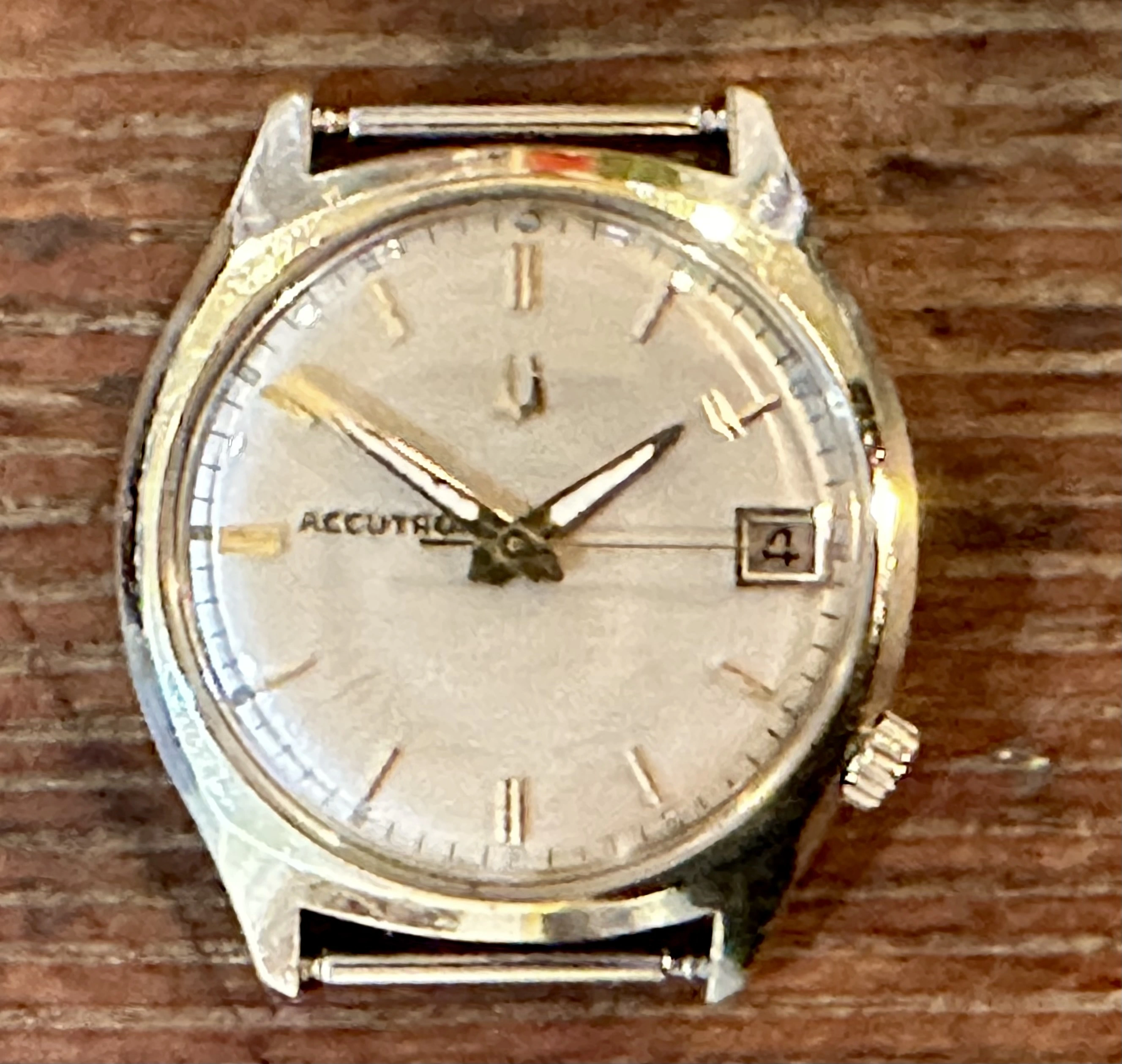

This watch has admittedly sent me down a rabbit hole. The owner purchased in 1967. That is the first year of the 218 (2181) movement. Notable is the crown at the 4 o’clock position, date at 3 and “Accutron” at the 9 o’clock position. Most Accutrons have the name at the 12 or 6. So, best I can tell , this is an early 218 Accutron with transitional asymmetrical dial….and my research says that these dial variants were Vietnam-era dials available in PXs for purchase.

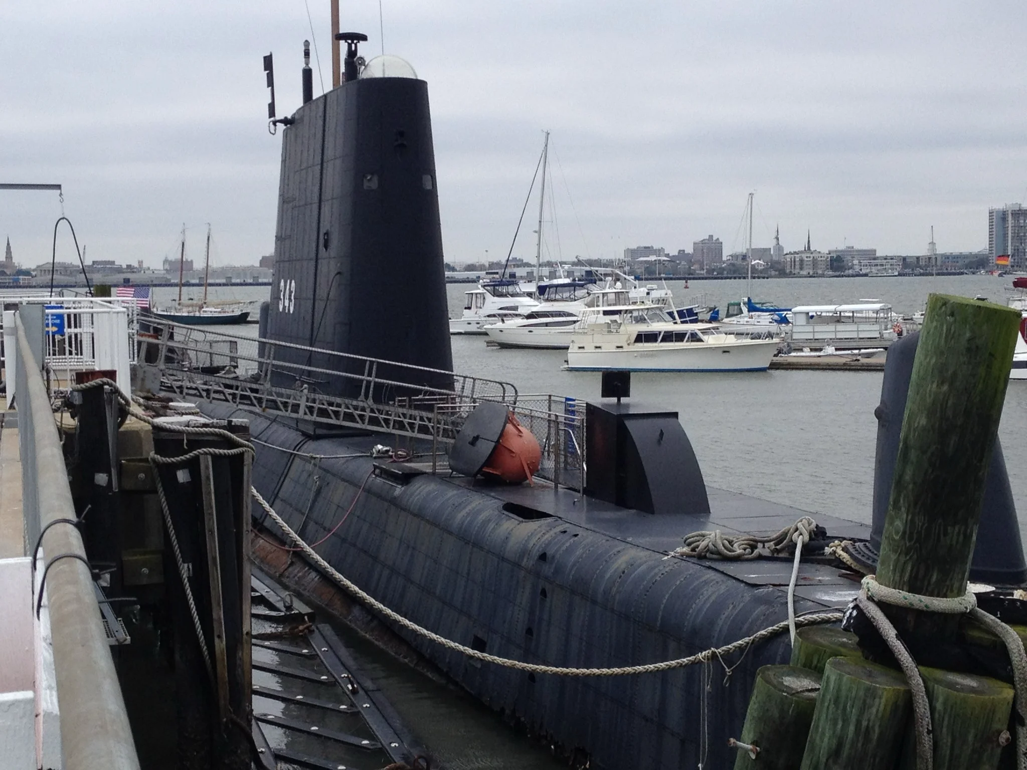

Side note, one of the guys in my Marksman/Shooting club was on the USS Clagmore (SS 343), not sure if it's the exact same sub layout but they were serving together around the same time.
