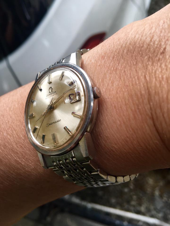

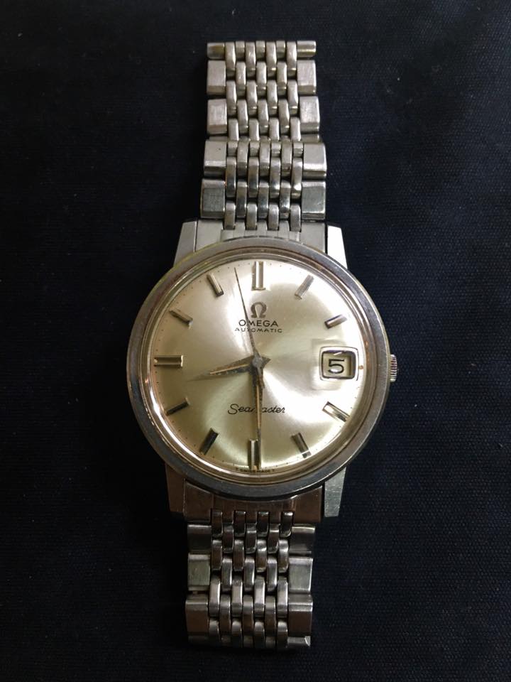

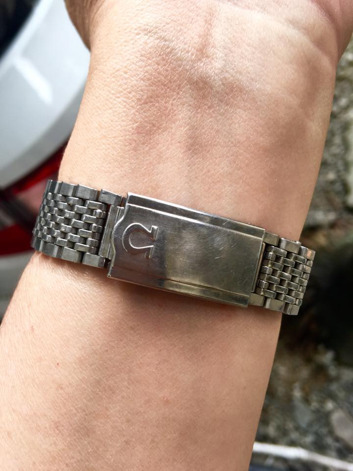

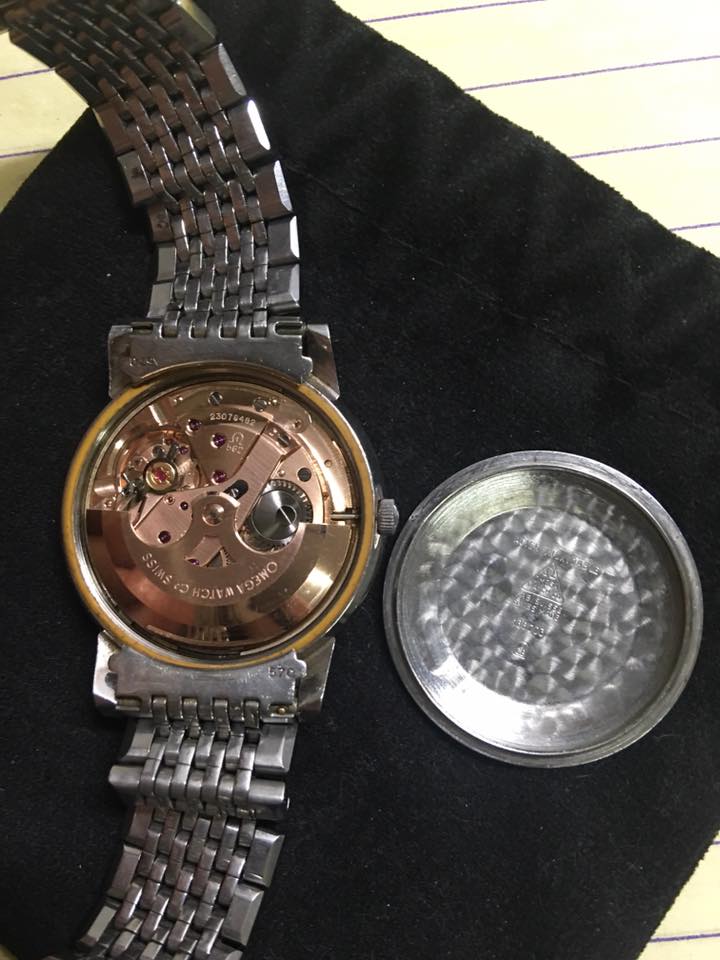

    Hello,
    A seller is selling this 1966 Omega Seamaster for around 450 USD. I haven't owned an omega yet so I am beginner at spotting fakes or franken watches. Would greatly appreciate any information you can give me(i.e. whether it is authentic, replaced parts, dial redone, etc..). Thank you in advance 27973467_1566482153466496_3786176564801167386_n.jpg 28056064_1566482220133156_5394694892742089292_n.jpg 28058773_1566482150133163_984033452664082339_n.jpg
    28167731_1566482283466483_2555996258235701519_n.jpg 28168554_1566482223466489_5382546600767618562_n.jpg

    Looks good IMO, price seems reasonable!
    Clean movement, original condition dial, good case edges, nice bracelet
    Good luck!

    Nice 166.003! I'd try to bargain down to 400, but it's a nice piece nonetheless.

    Reasonable price, but that movement will desperately need a service, looking at the gasket :)

    Hi Con, just for learning: Could you please explain whats the matter with the gasket?

    Omega used to use yellow gaskets for their watches in the sixties; having one in a watch now means that unless it has been replaced with another yellow one (not very common), the watch has never been serviced or has been serviced without changing gaskets.
    That movement looks very, very nice btw ::love::

    Thats was I was thinking, very clean and shiny...

    I just talked to the seller. According to him, the watch was serviced last year.
