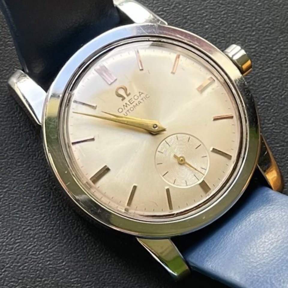

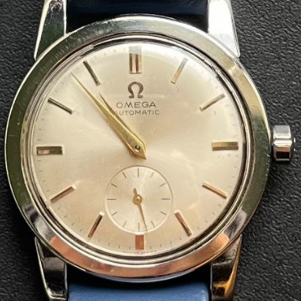

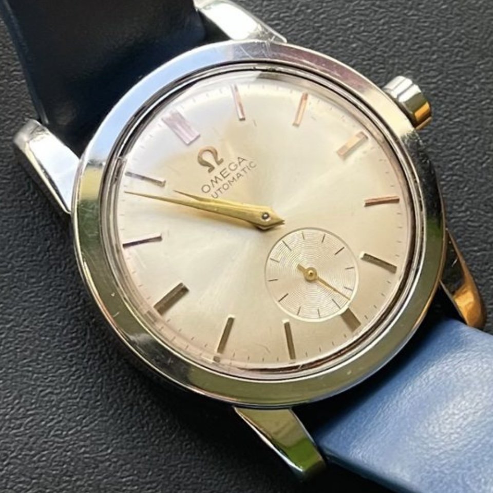

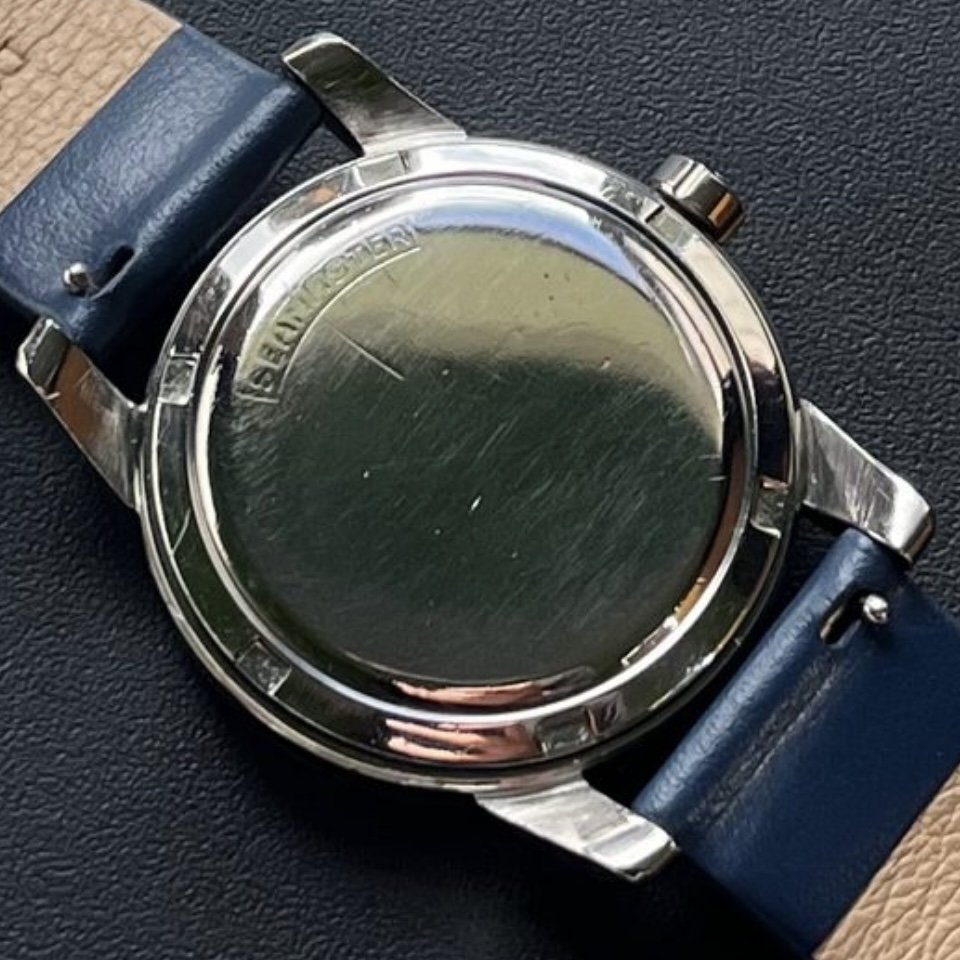

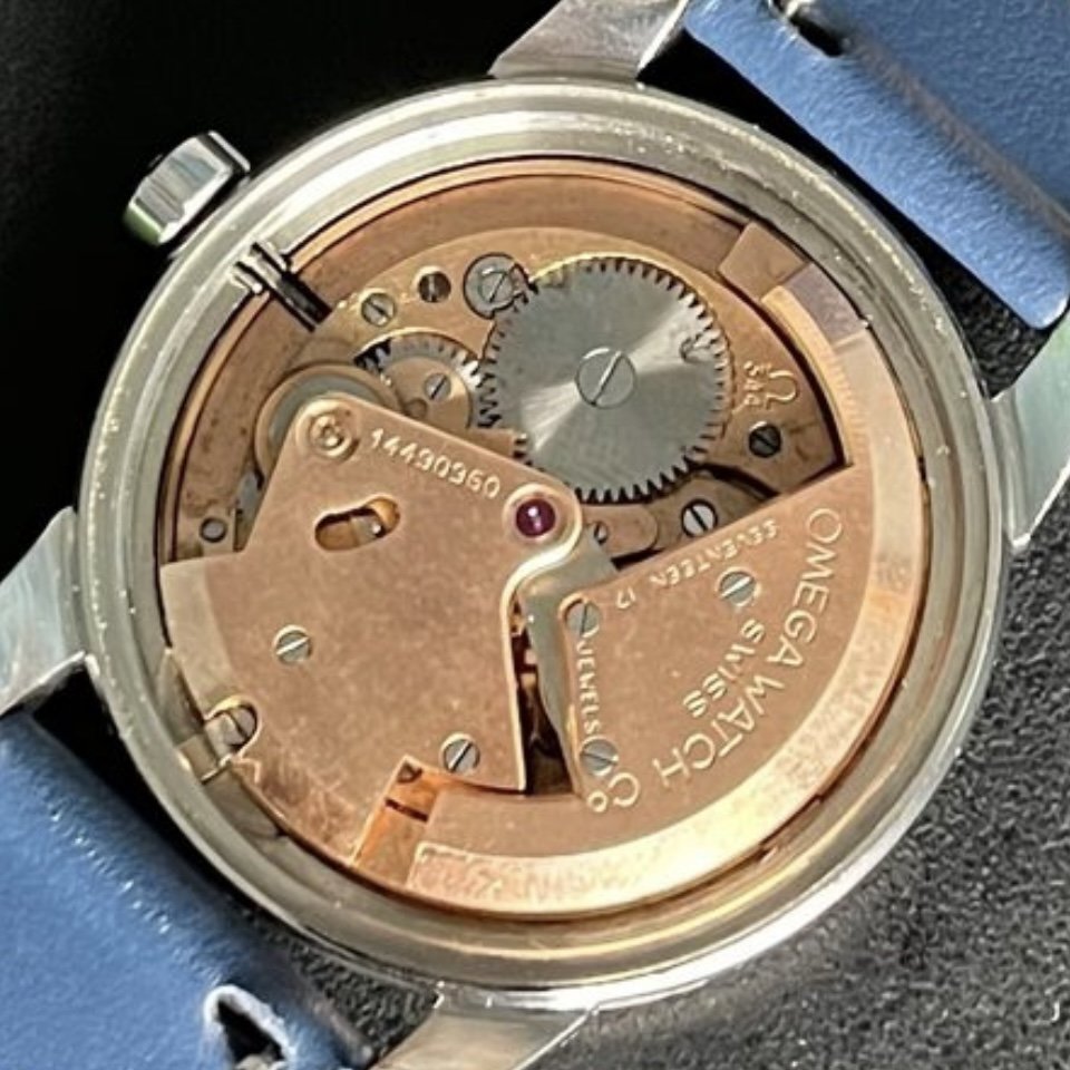

I just have a quick question about this 2576 from 1954 that's come up for auction.

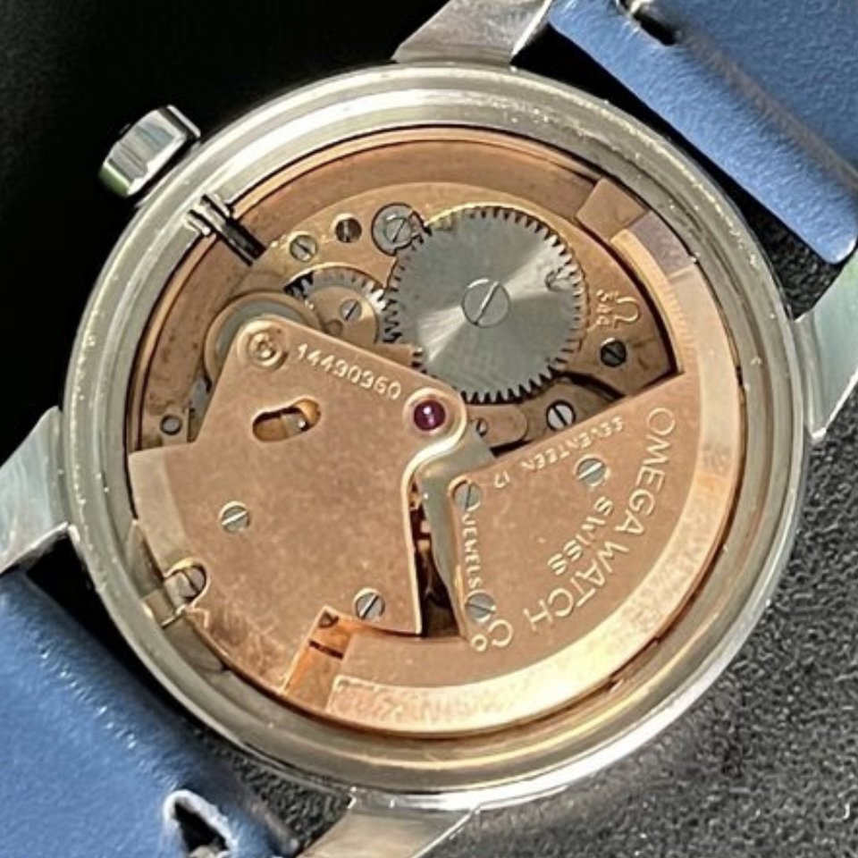

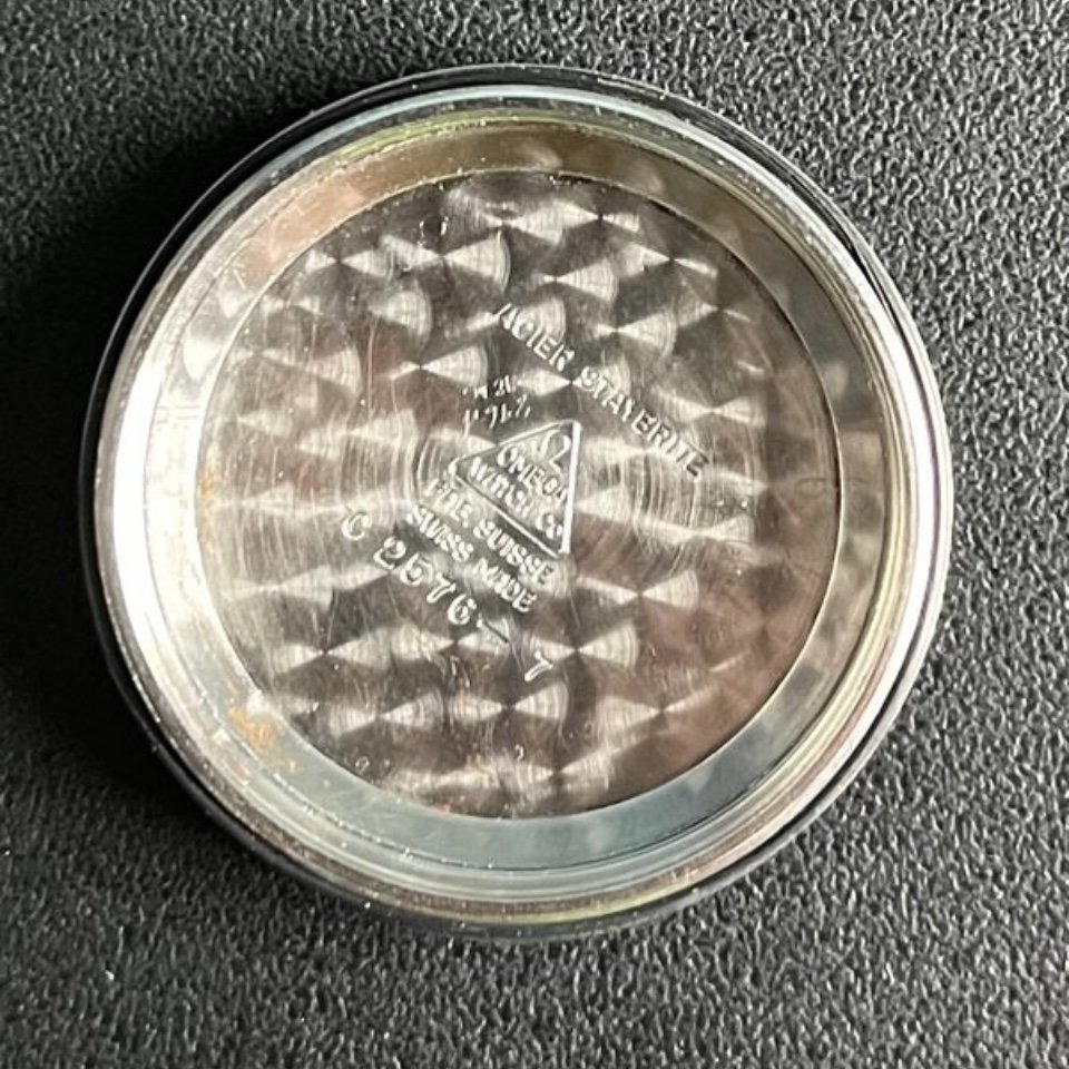

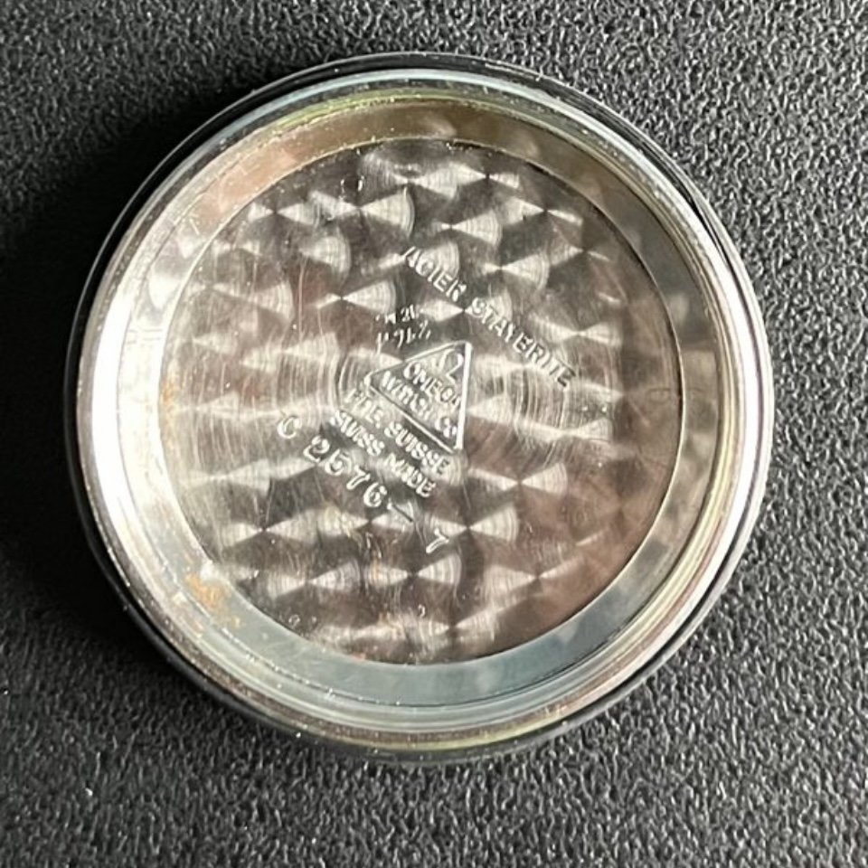

Its case and movement check out (a 2576 with a 344 heart) but wouldn't an example this late in the ref. production (144.. serial - 1954) finally have had the word 'Seamaster' printed on the dial? The case back has the Seamaster designation just not the dial. Which makes my inexperienced head get slightly suspicious...
Any help setting my ignorance straight would be greatly appreciated.
Greetings from the South Pacific!
3,596
13,553
You’re right - and also it looks like a sunburst finish, which didn’t exist at that time. I find it hard to assess the dial from those pics, but it’s either a redial or a service dial.
1,586
6,837
Interesting, @Dan S why do you find the case problematic?
A closer look at the Seamaster script on the caseback makes pretty clear that the sharpness has regrettably disappeared from this one...
