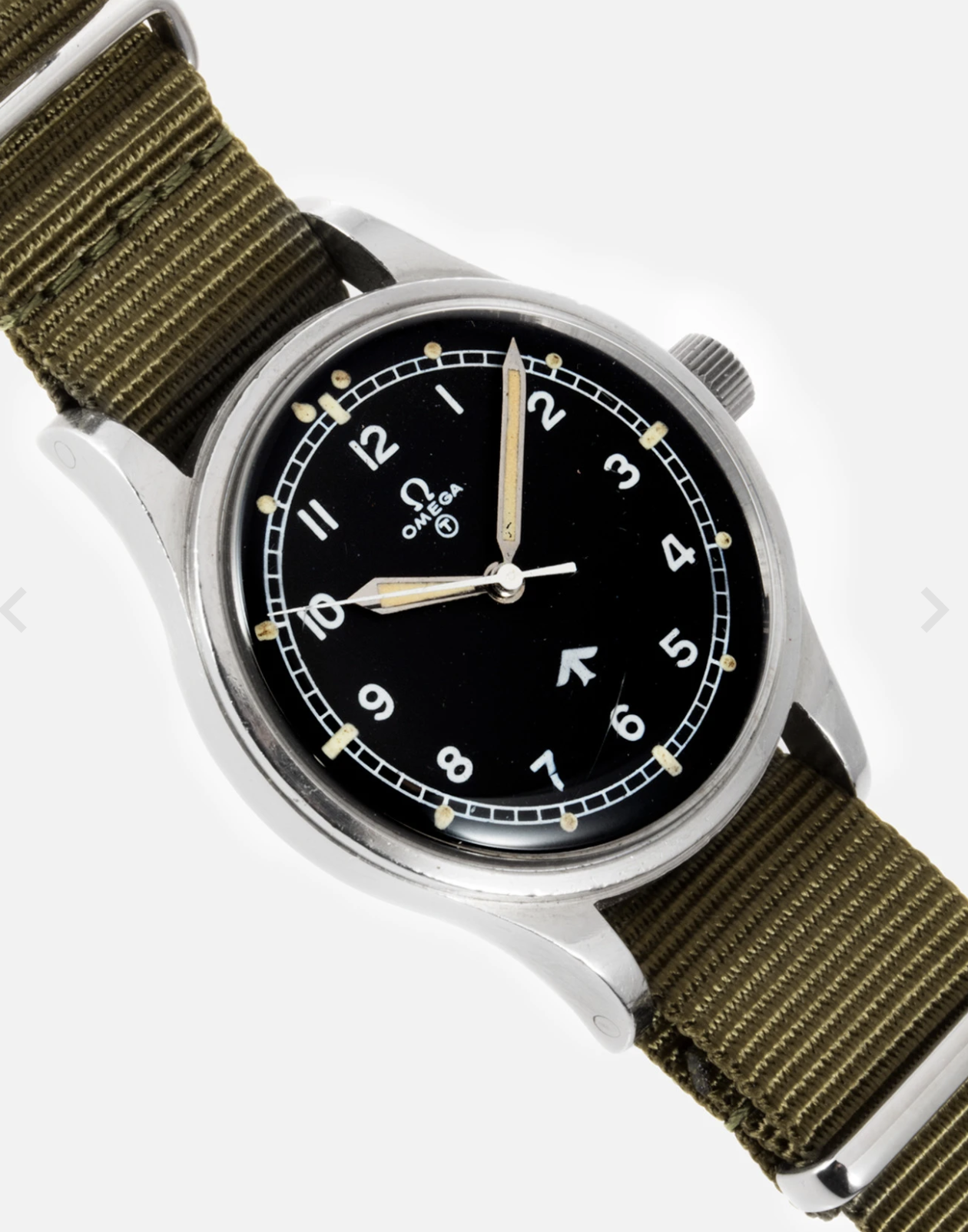

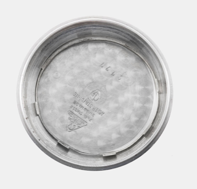

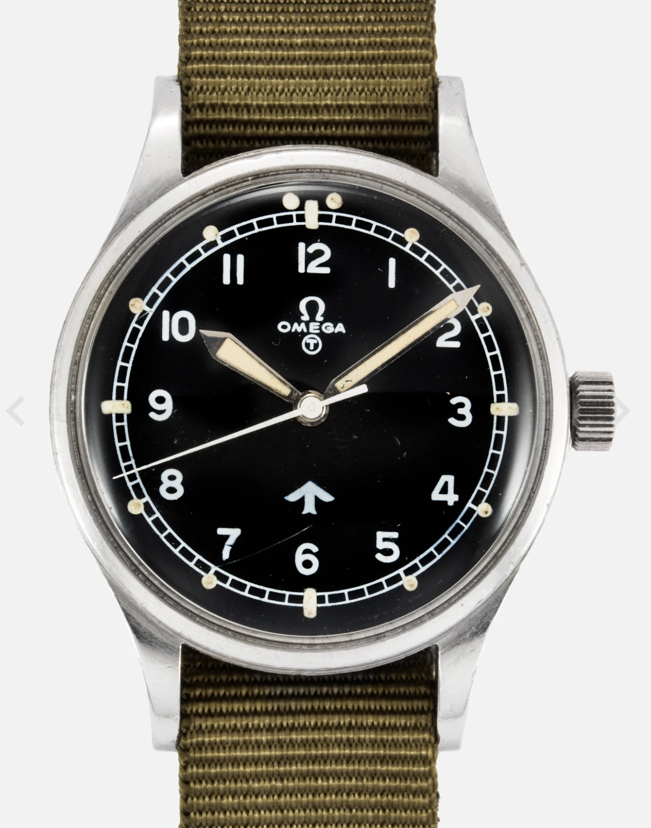

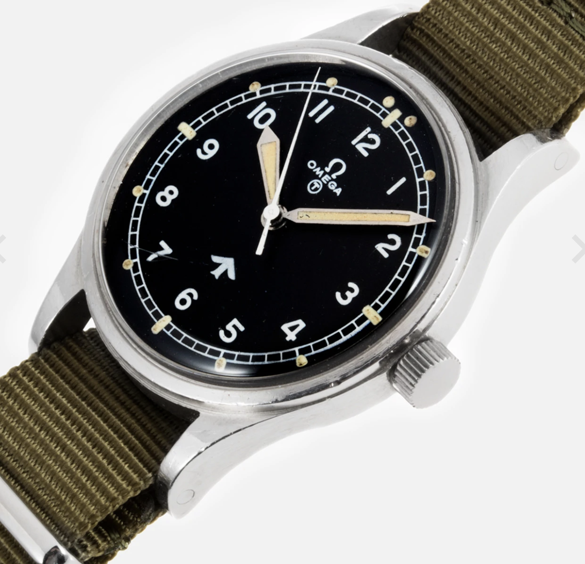

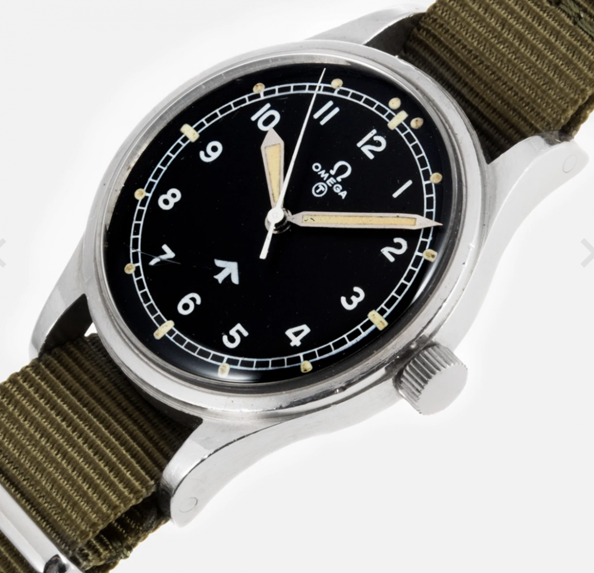

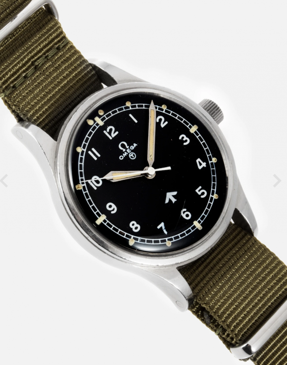

Hi - i'm fairly new to vintage/military watches, am interested in buying a 53 fat arrow but looking for some expert advice - for example is this one genuine? I've seen a few with a serial number over 10000 but I thought that only 5,900 were ever produced? Also thought the font on the serial number looked a bit different to other ones I've seen? Thanks so much!

Font ok. 5900 produced. Numbers you see are for every issued mil. Watch 1953 from all manufacturers. Yours is issued late in 1953, so number is high.kind regards. Achim

sorry thanks all for your help! so sounds legit aside from replacement crown and relumed dial

Sir,

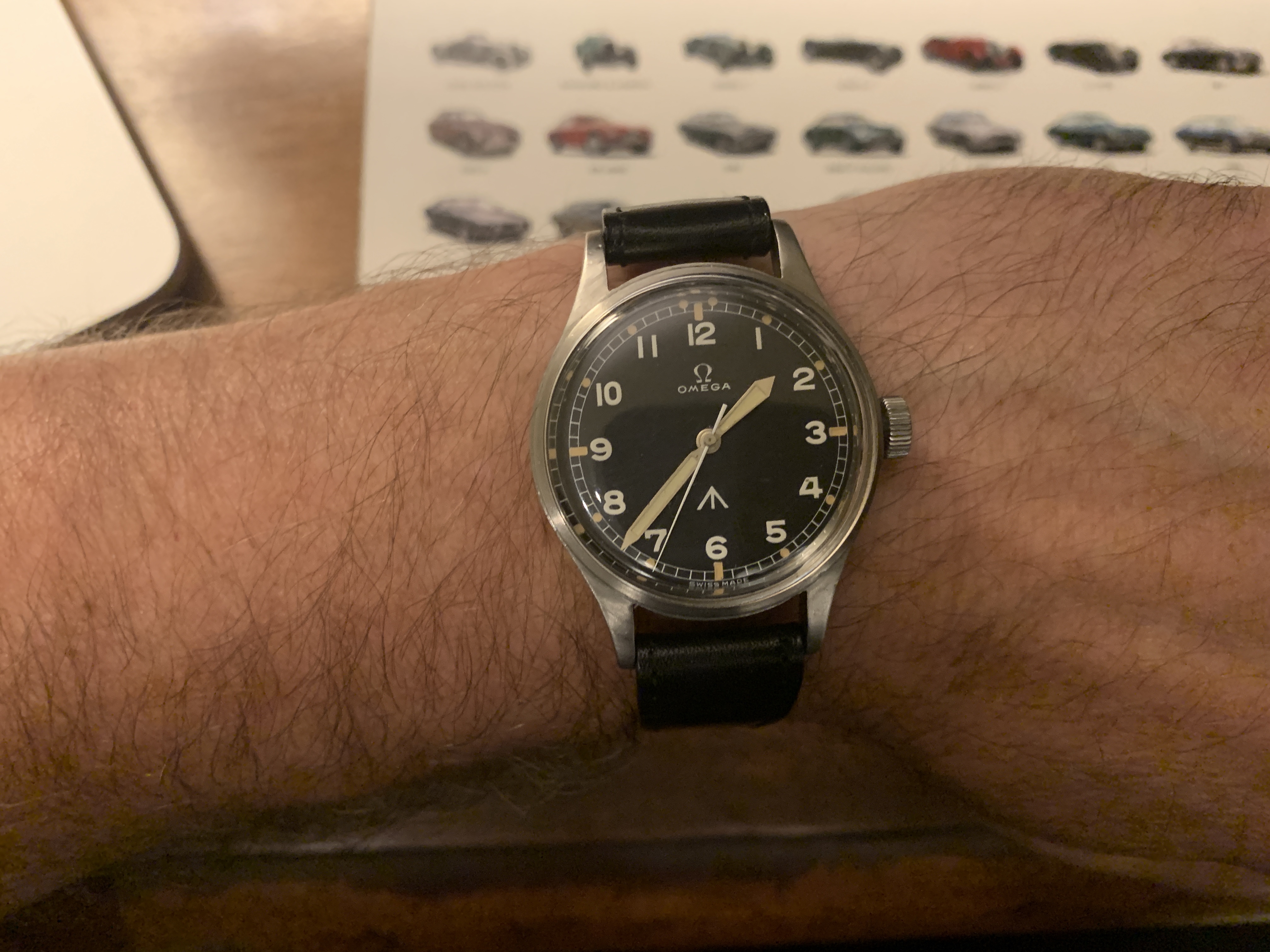

Very nice thin arrow ‘53.
On this Fat arrow-concur with above
plus:
Appears heavily polished
Support:
1. Number on higher end but not
Sequential from 0-so OK
2. Lume on hands and hour plots
deteriorate with age and
should appear same if applied at
same time.
Prices on these CK-2777-1 vary considerably with a nice original selling at last Watches of Knightsbridge auction for £1800 to Chrono 24 at over 7000
US for an adequate copy.
Would always buy the seller!
MWR is aware of trouble registering. Hopefully it will be addressed shortly.
They have excellent thread going on the 53 fat arrow currently.
Good luck! S
