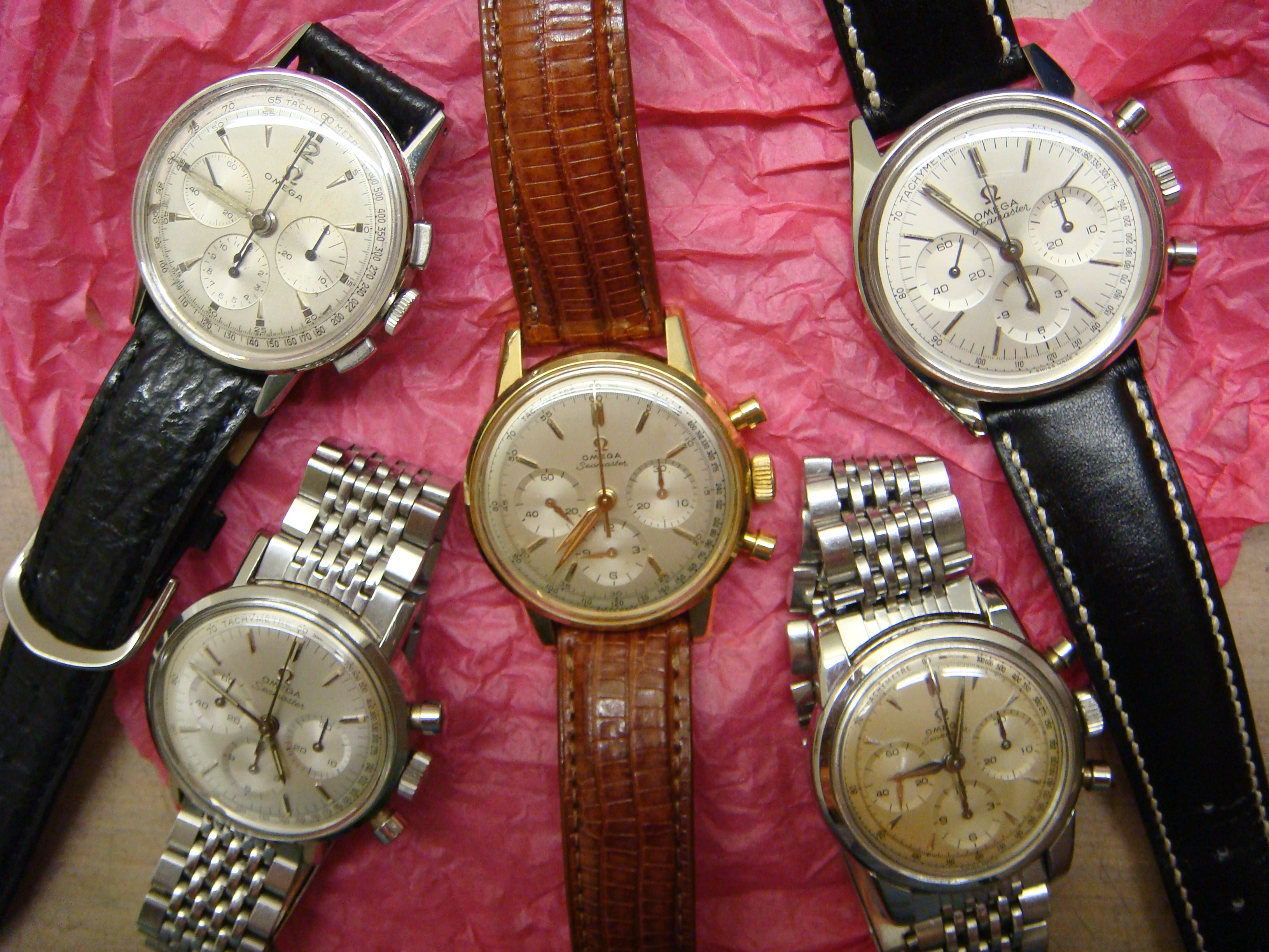

    The experts will need to chime in, but I have a lot of doubts about that watch. Maybe it's a different reference, but take a look at mine from 1953 (acquired from a well known and very knowledgeable vintage Omega guy); it is on the far upper left. Just a totally different watch. DSC04351.JPG

    Is that a reference 145.018 over on the upper right? If so...Dibs!:thumbsup:

    That one is gone. Just have the other four. Sorry.

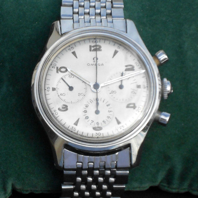

  11. calalum May 23, 2016
    1,472
    7,719
    And here is a better pic which I just found on my computer. The watch should look like this. Omega 1953 Chrono.3.JPG

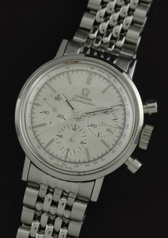

    Oh, one other thing: I found this image online of a Seamaster 321 with what appears to be black lume on the hands. Only one I've seen like this. Seem legit? I quite like the look.
  13. IMB May 23, 2016
    5
    Holy cats, that's gorgeous!

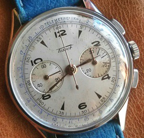

  14. Vitezi May 23, 2016
    3,098
    13,457
    The three brands inside SSIH (Tissot, Lemania and Omega) often shared chronograph dial styles. Although I do not have an example of an Omega, I do have two different examples of a two-register chronograph from Tissot with a similar printed dial as yours. These are based on Lemania's C27.4 movement.
