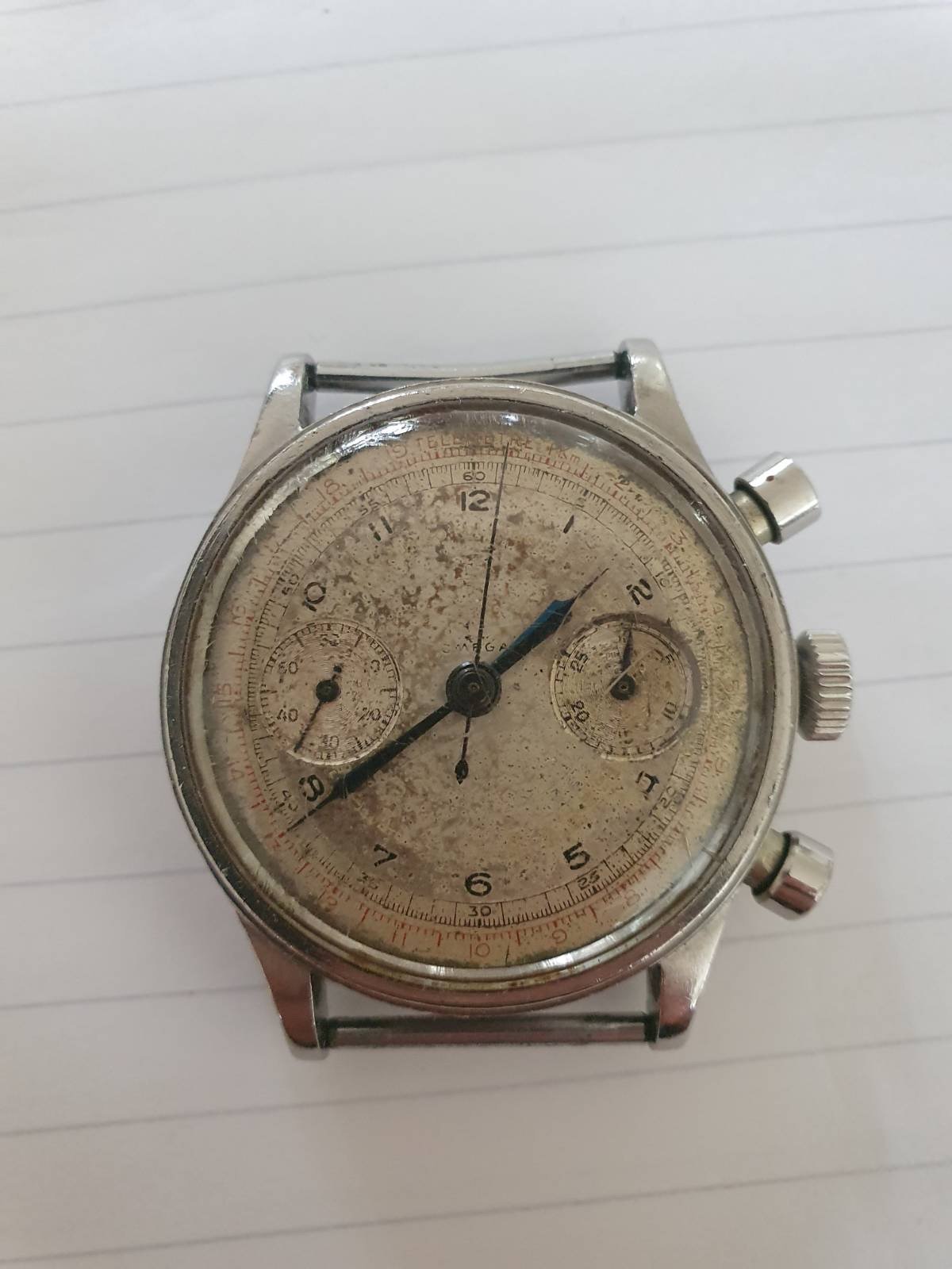

This was my late grandfathers chronometer. He was an aeronautical engineer during ww2. I suspect 1940’s? I bought my own as a link to him recently choosing the Omega aqua terra Worldtimer.
I thought it would be an idea to restore this one. Firstly can anyone tell me anything about it and any advice on restoring?

Hello and welcome,
Firstly what you have is a chronograph and not a chronometer. A chronograph has a timer/stopwatch function ( which yours has ) and a chronometer is a watch with a consistently high accuracy.
Anyway, what you have looks to be late 30's early 40's and judging from the relative size of the pushers I'd hazard a guess that it is a cal 33,3 ref CK2077
Can you show more pictures of the watch and case please? And also measure it across the diameter without the crown, I'd expect about 37mm? If it's more like 33mm then you will have a cal 28.9 ref CK 2076
Either way it should have a screw back steel case and these are highly collectable references.
edit: I'm not sure- the bezel looks different to both 2076/2077, so more pictures are a must and if you are able to safely open it pictures of the inside case back and movement would be extremely helpful
The dial condition is very poor, so what are you hoping to achieve with the restoration?

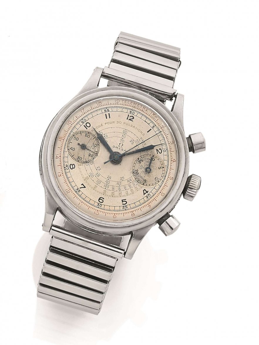

The dial probably originally looked something like this one (which also shows some aging):

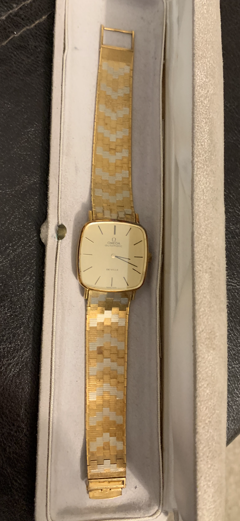

I have actually just come back from there and interestingly, my mother then brought out her own fathers watch which is also an Omega. I took a photo which I have attached just in case you know anything about this also?

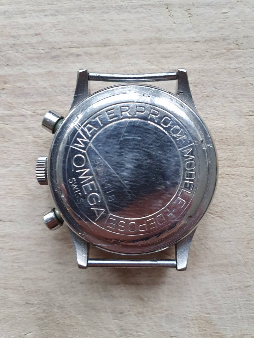

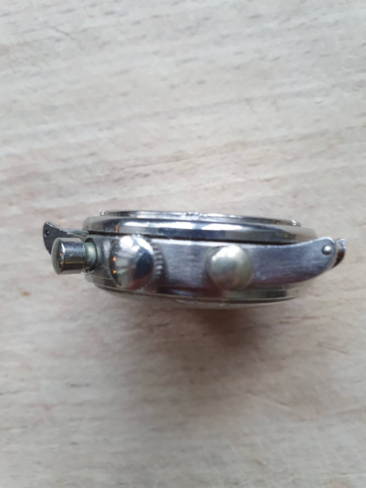

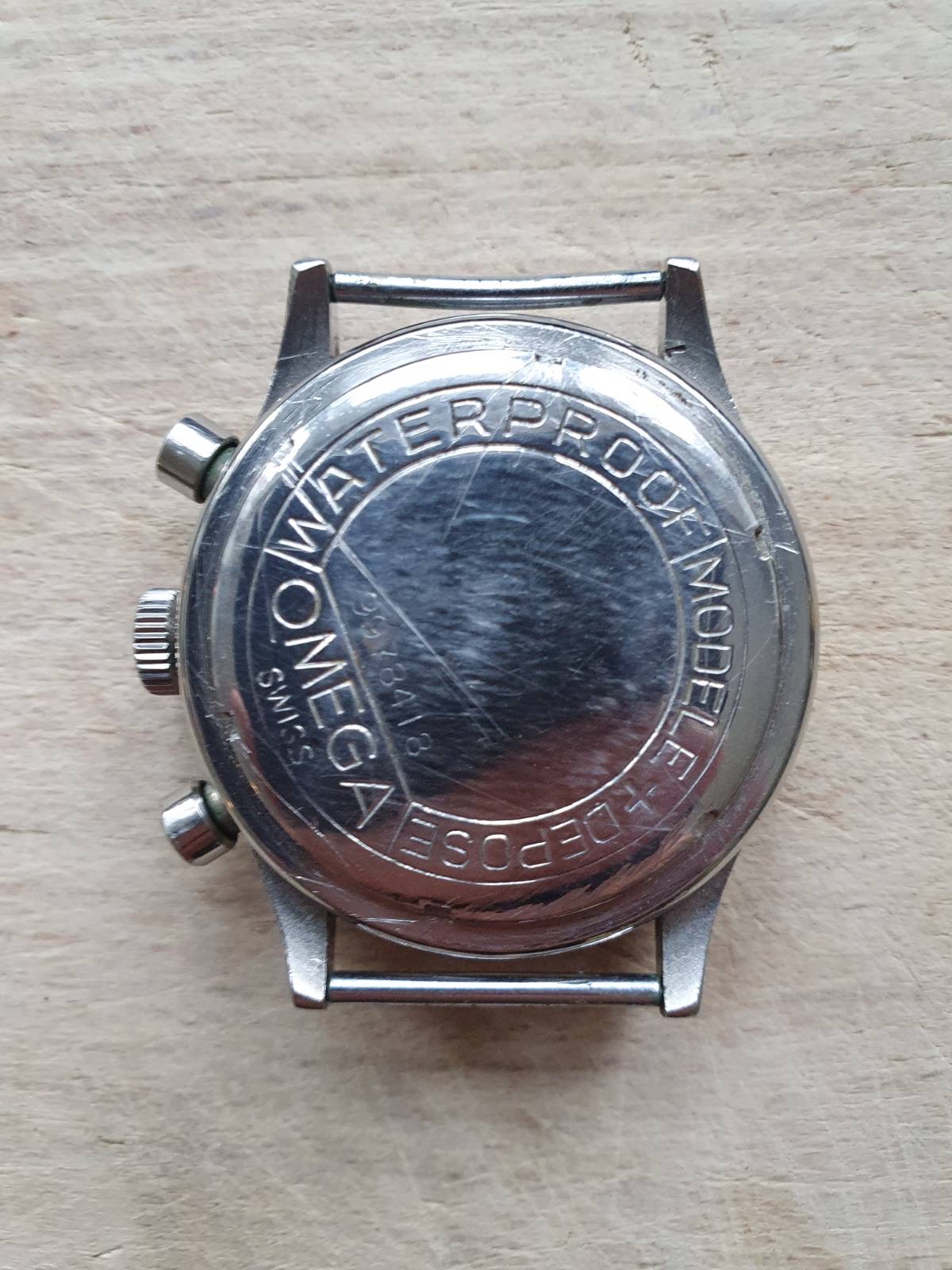

Hi,
Thanks again - The watch is 37mm across as you expected. Some additional photos:
160
435
Putting in the reference number, it appears this watches year is 1943
8,141
36,659
Yes, that's indeed a CK 2077 with a cal 33.3, so well done there. As to the age I'd say you are certainly in the right ball park, however using the movement serial number and not the case back number will give you a better idea.

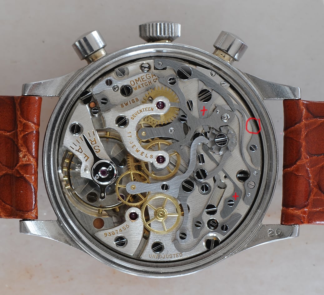

It's also missing a part, right Erich?

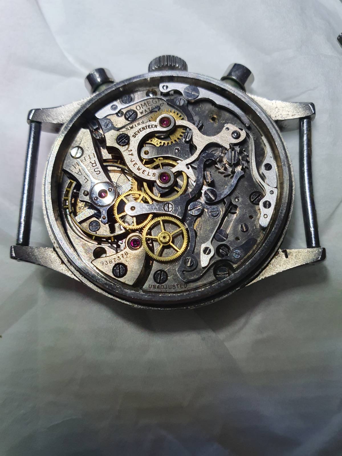

Chris, there are more issues... 2 parts are missing and one spring is broken.
See photo below, I have marked the missing parts with + and the broken spring with a circle in red.
