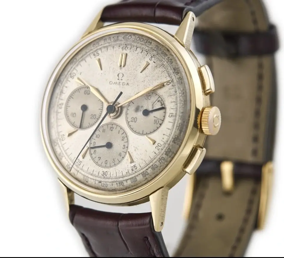

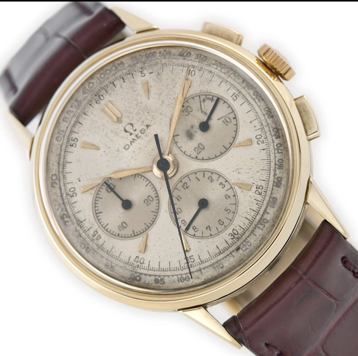

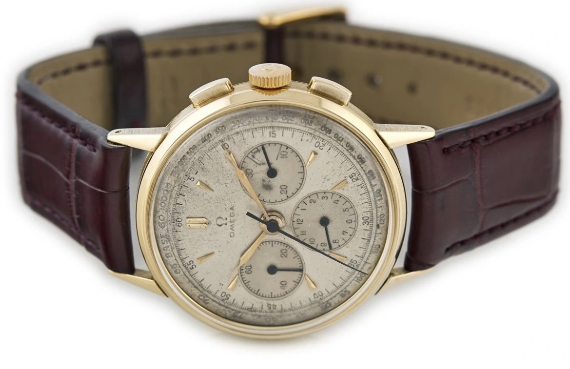

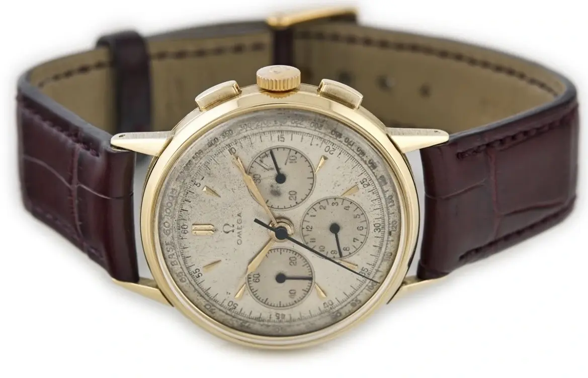

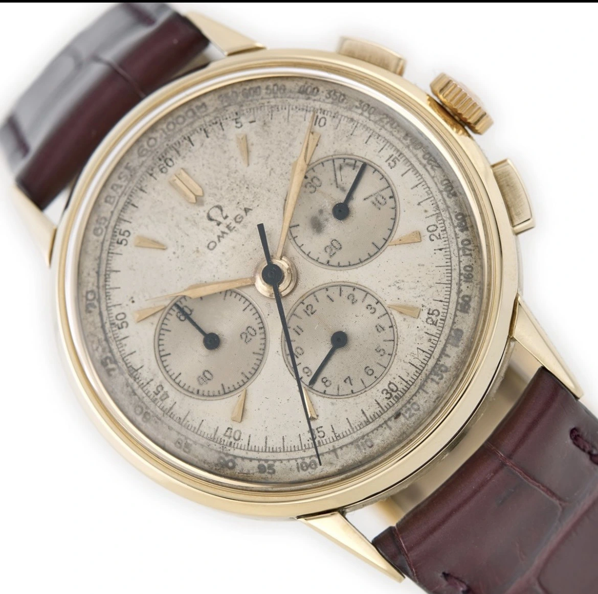

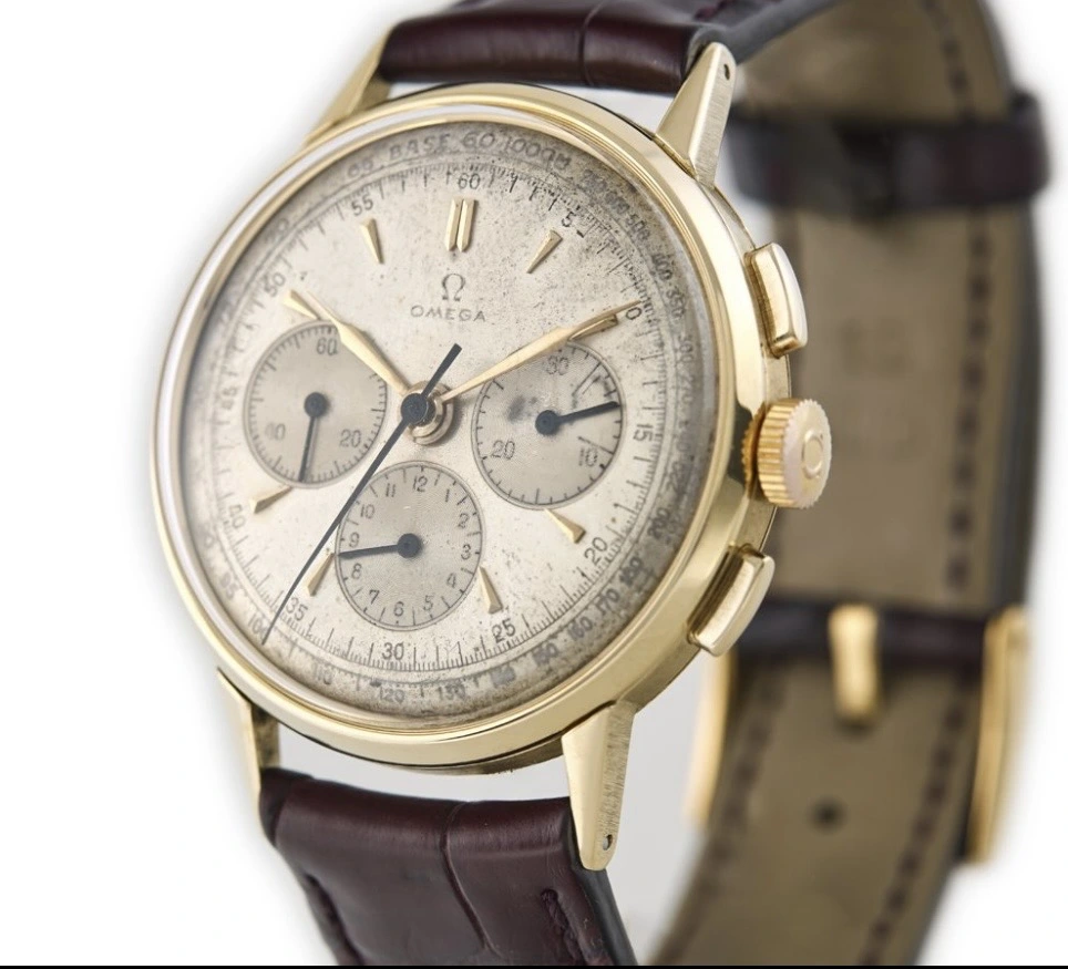

Hi All, I wondering if members here may be able to give me some advice and thoughts. I’m keen to purchase a late 1940’s - 1950’s 18ct yellow gold 321 Calibre Omega chronograph. In researching I have come across a seemingly respectable dealer selling a 1948 timepiece. It’s untouched and the face/watch has not been restored (my preferred option). It’s been serviced and in running order. It also presents with a document of authenticity. It’s has a replacement Omega crown. And the strap is not original to the watch, but is Omega. The timepiece is offered at £6350. However, here’s my confusion. Running the case and movement serial numbers through the Omega database, the year of manufacture is showing 1944, not 48? And the case & movement numbers are different? Is this typical in older time pieces? Also, examining the movement, I can’t see any ‘321’ engraving? Is this typical for this movement age? Or is there something more going on here? And finally, the price? Does £6350 sound reasonable? Apologies for bombarding everyone with all these questions, but I’m new to this Omega vintage research and very cautious! Photos attached. Many thanks in advance. Alex

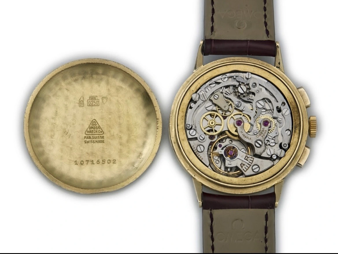

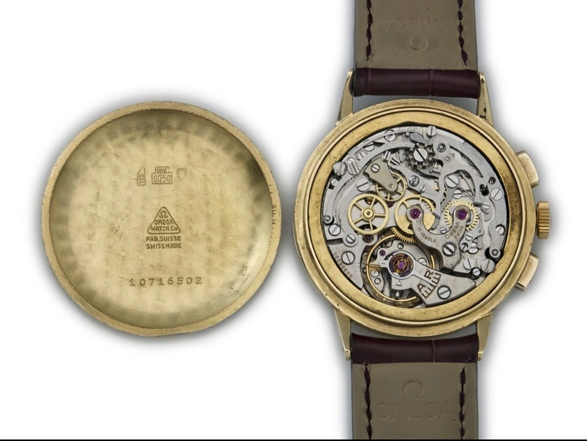

The movement serial suggests 1945. Movement and caseback numbers are not expected to be the same. Regarding price, you will ultimately need to do your own research using auction sales, but one thing I will add is that the dial is usually considered to be nearly half the value of the watch, and this dial has some major flaws that most people will find unappealing. Obviously you want an original dial, but if you are going to spend real money on a watch, I would think you would want a more attractive dial.

Thanks Dan, that’s really helpful. I’m rapidly discovering the vintage Omega market is a challenging one! I’ve found a few 40’s/50’s chronographs for sale. Some look pristine and ‘new’. The faces look like they’ve had full restorations? Does this detract from the long-term value of the watch? I guess it’s about trying to strike a balance. I prefer some patina, but I’m struggling with how much is acceptable? It’s all about personal taste, I suppose? But I don’t want to spend thousands, only to discover later that I’ve over-paid. I’m London, UK based. Can anyone recommend or suggest reputable outlets that are recognised as ‘safe’ sales? Many thanks.

If you use the search function on cal 321, you will find threads that will help you. I do think there are better examples with fewer issues out there and patience is your friend. This dial is too far gone for a dress watch despite its relatively even patina. I also think that the movement should show that 321 as other examples have it. I own a bunch of gold chronographs and I’d pass on this one.

Yes, a repainted dial completely destroys the collectible value. But this dial is too far gone for me, especially the damage on the minute totalizer sub-dial. The rest of the damage (water damage and fading around the perimeter) might be tolerable depending on personal taste, but it's pretty significant and dramatically impacts value. I certainly would not pay a premium to buy a watch like this from a dealer.

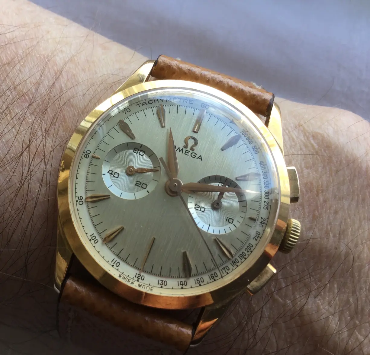

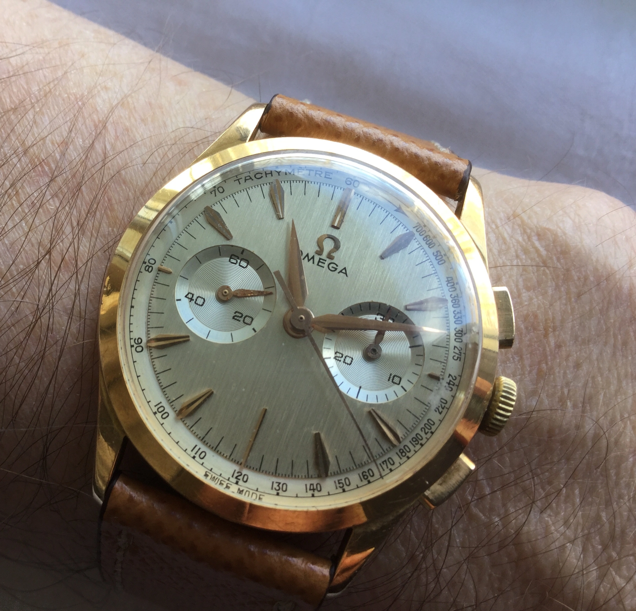

Here is my cal 320 - a little later than your target date range.

The 2872/ cal 320 was just an example of how some good dials do survive with these pushers. ( but you might notice that the subdial hands have suffered somewhat.
