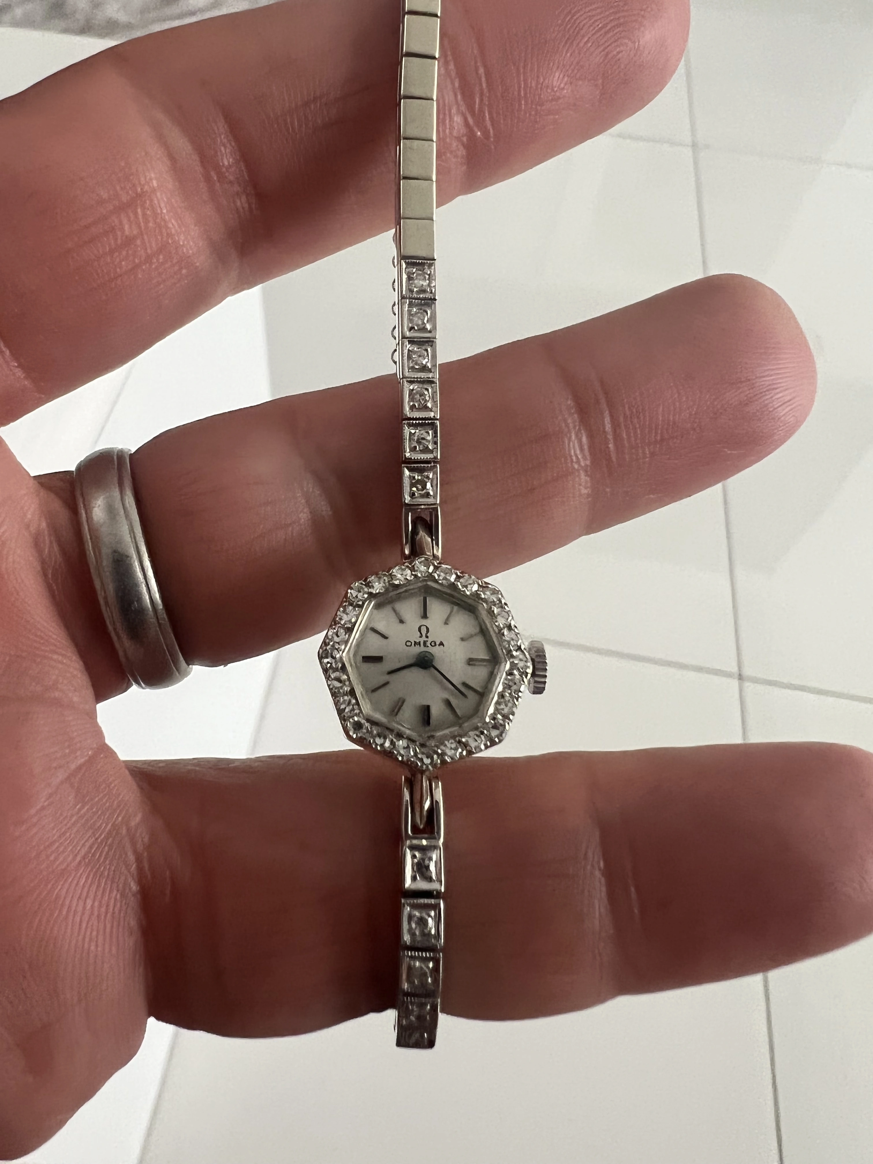

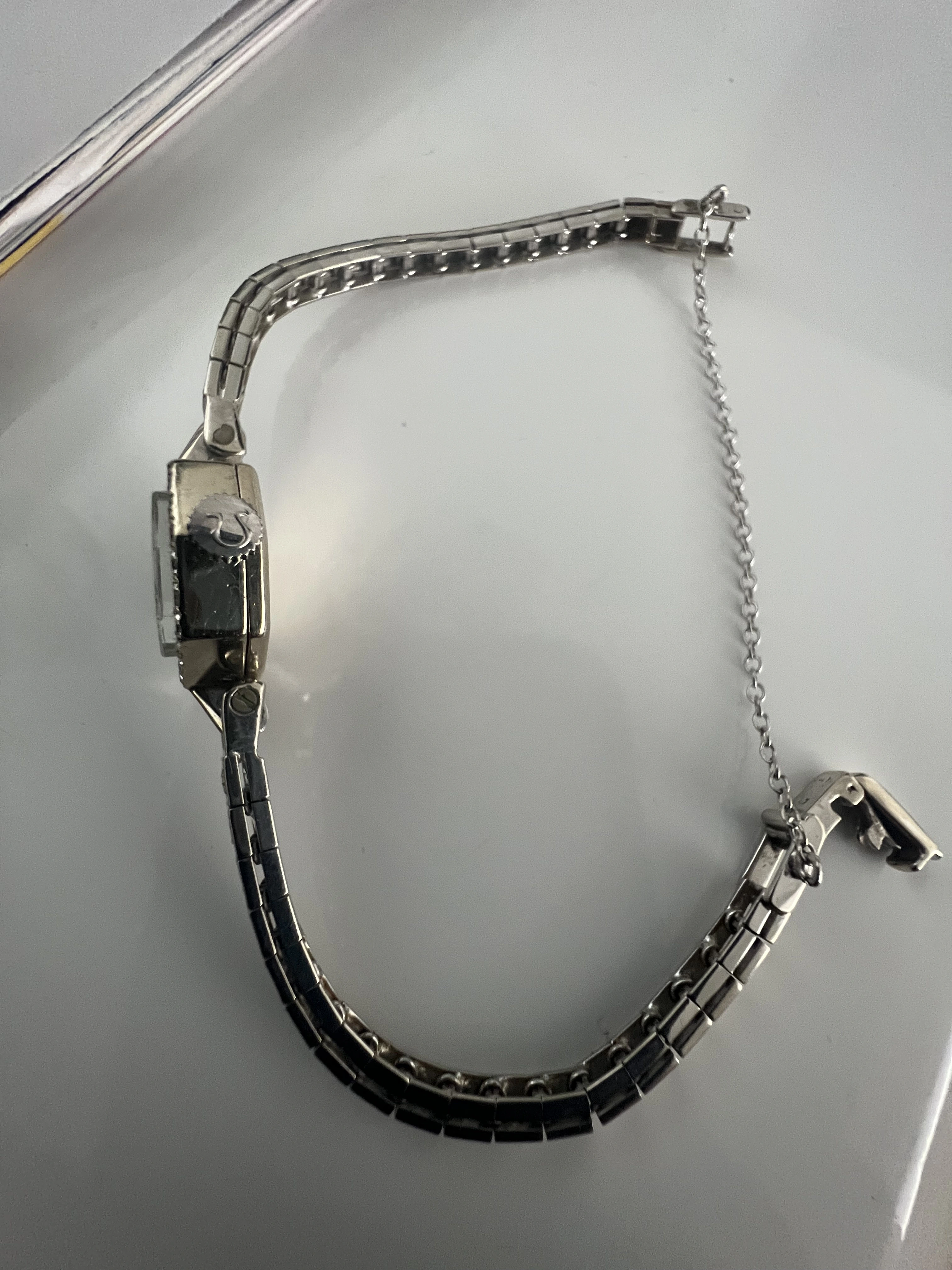

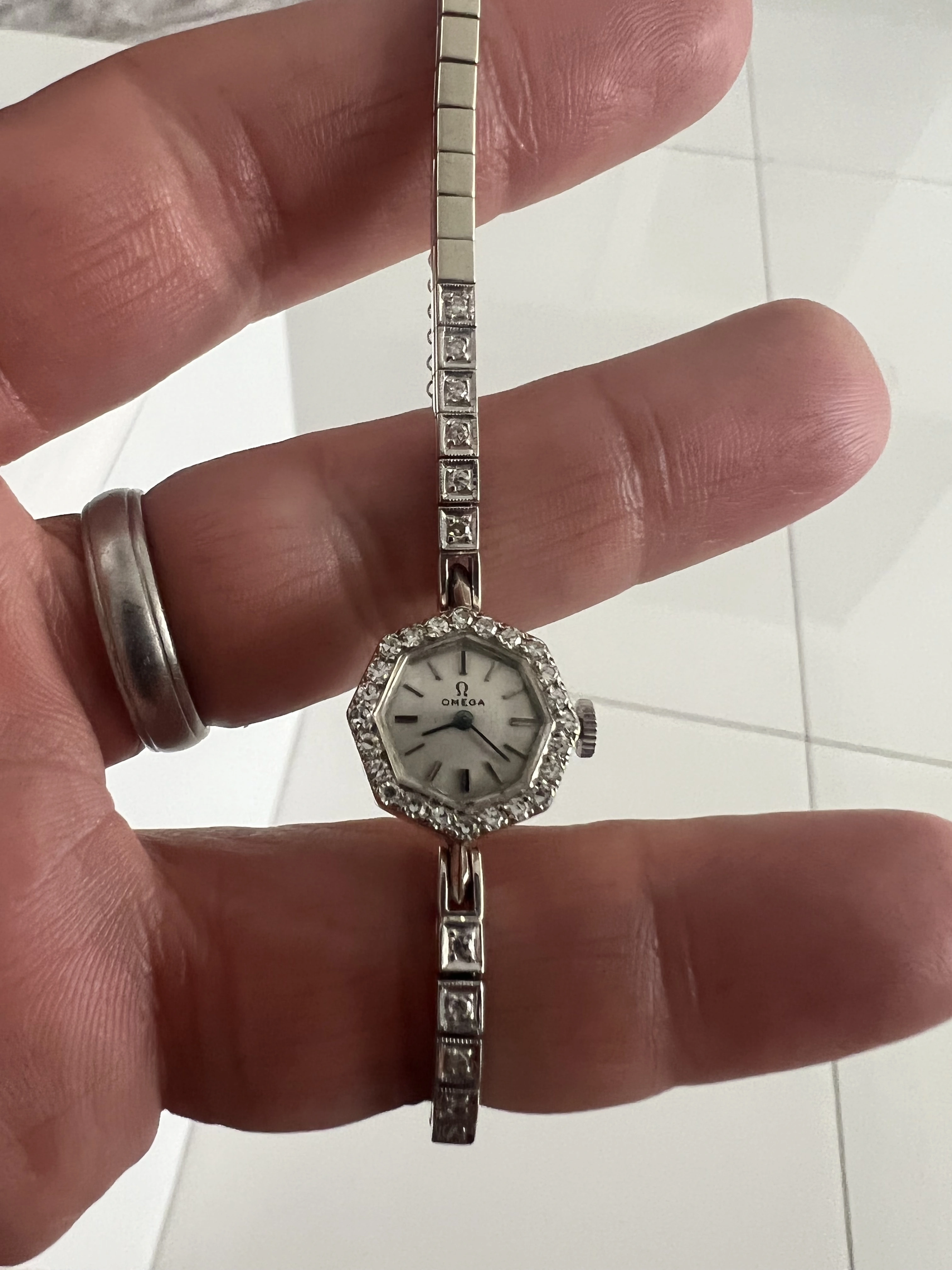

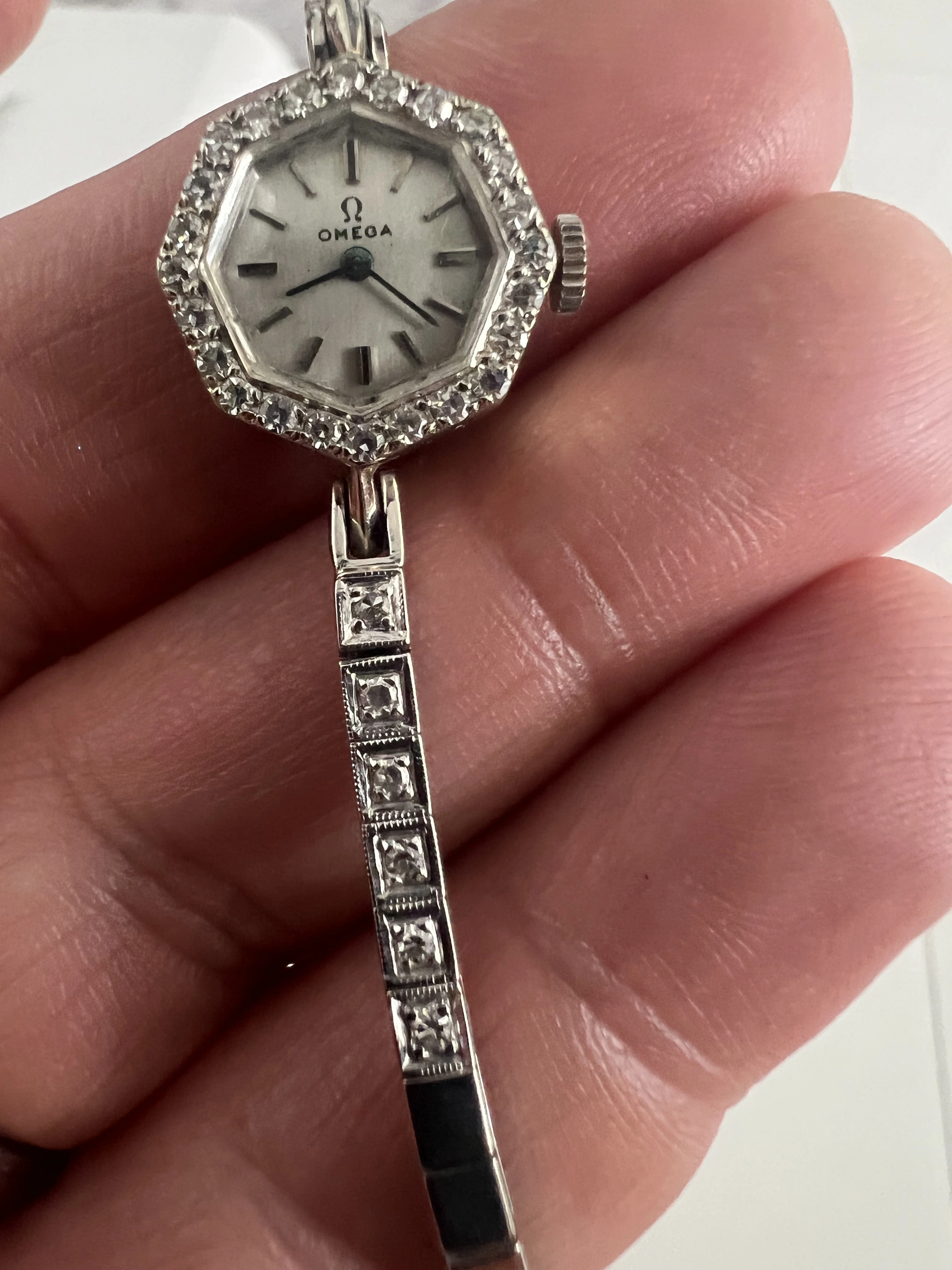

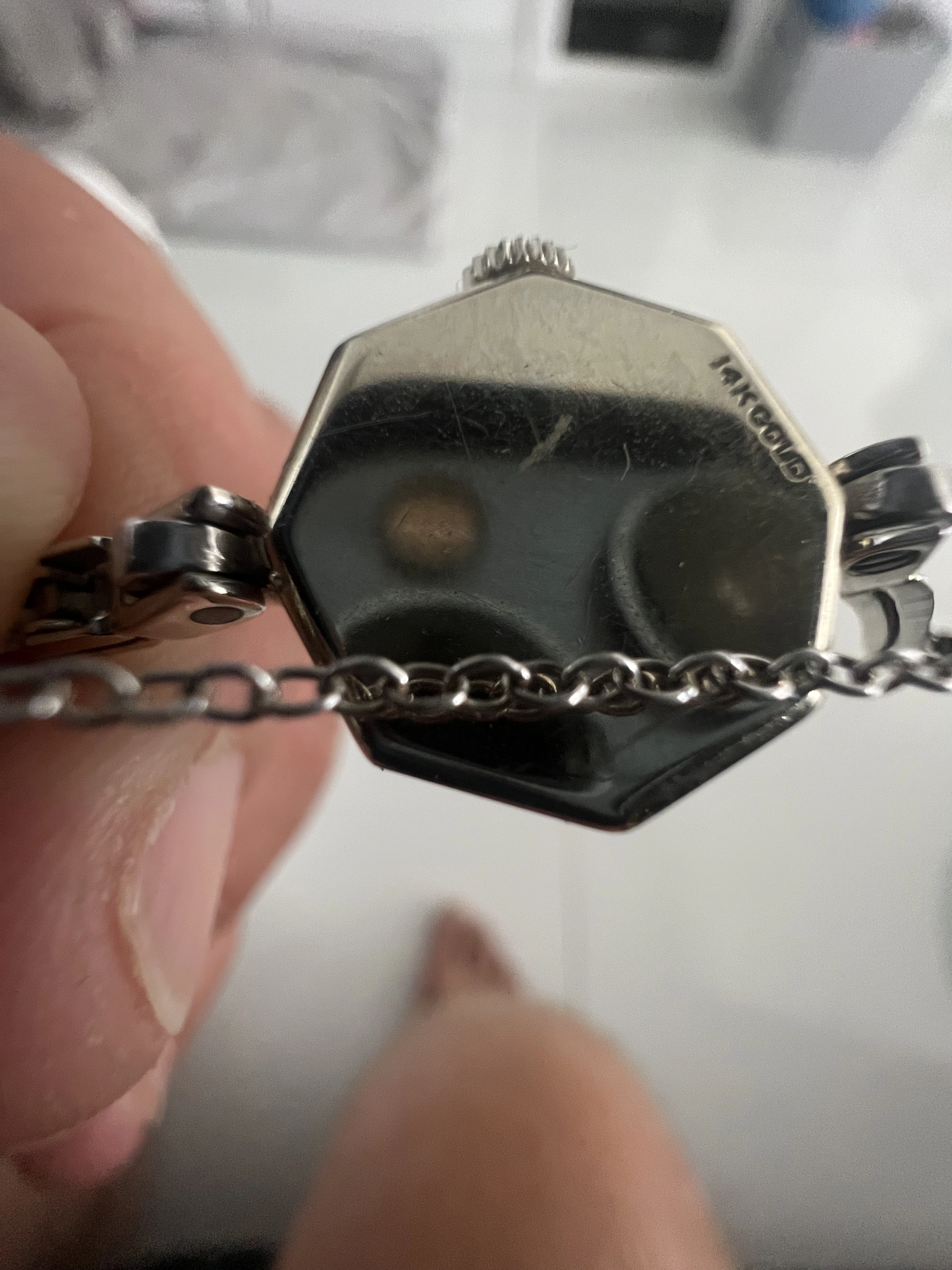

Good evening

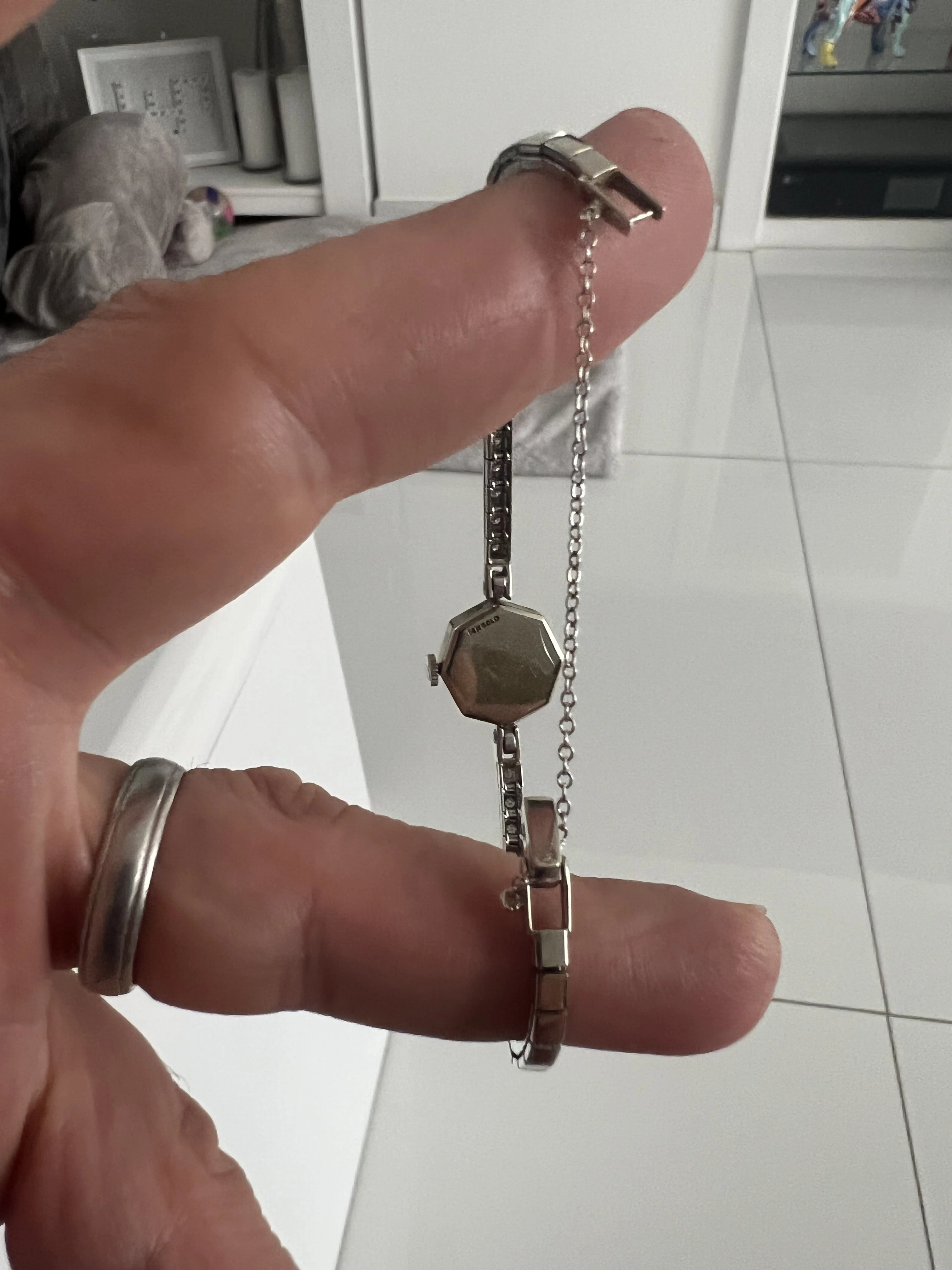

Wonder if anyone has got any idea on this omega which I have owned for 18 years
Tiny watch which has been to omega to try to find out information on it but they had no joy
It was classed as an original omega by them but they could not identify it
Any help would be most appreciated
Woody
18,840
39,182

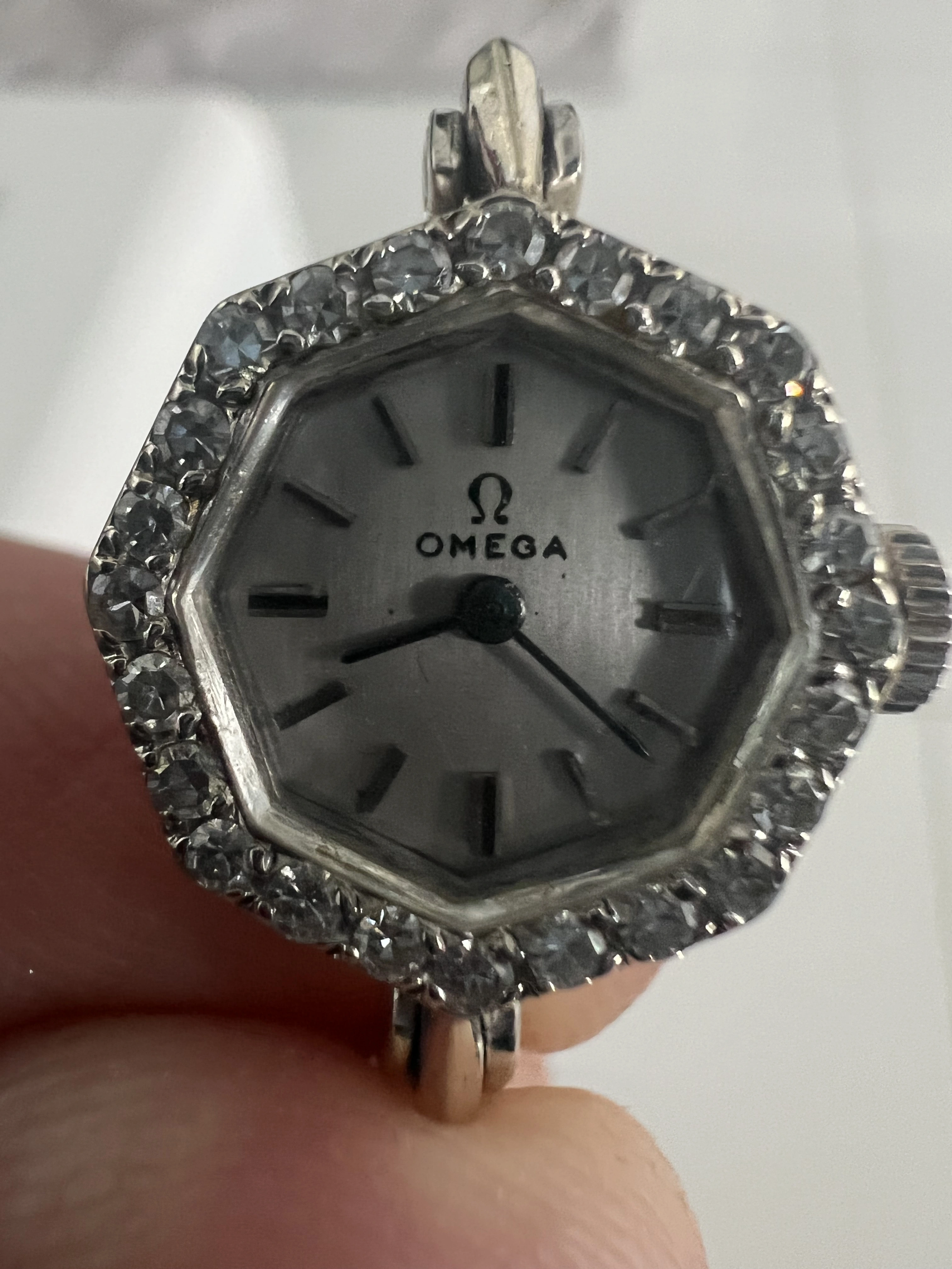

The only way to confirm the identity is to open the watch (remove the caseback) and take good clear photos of the movement and the inside of the caseback. Then we can offer more information.
At the moment, it's probably an American cased ladies Omega cocktail watch from approximately 1950 +/- a few years.

The Omega is certainly not 30s vintage! More likely 1960s! Need to se the mechanism (movement) in the case, and a picture of the inside of the case back.

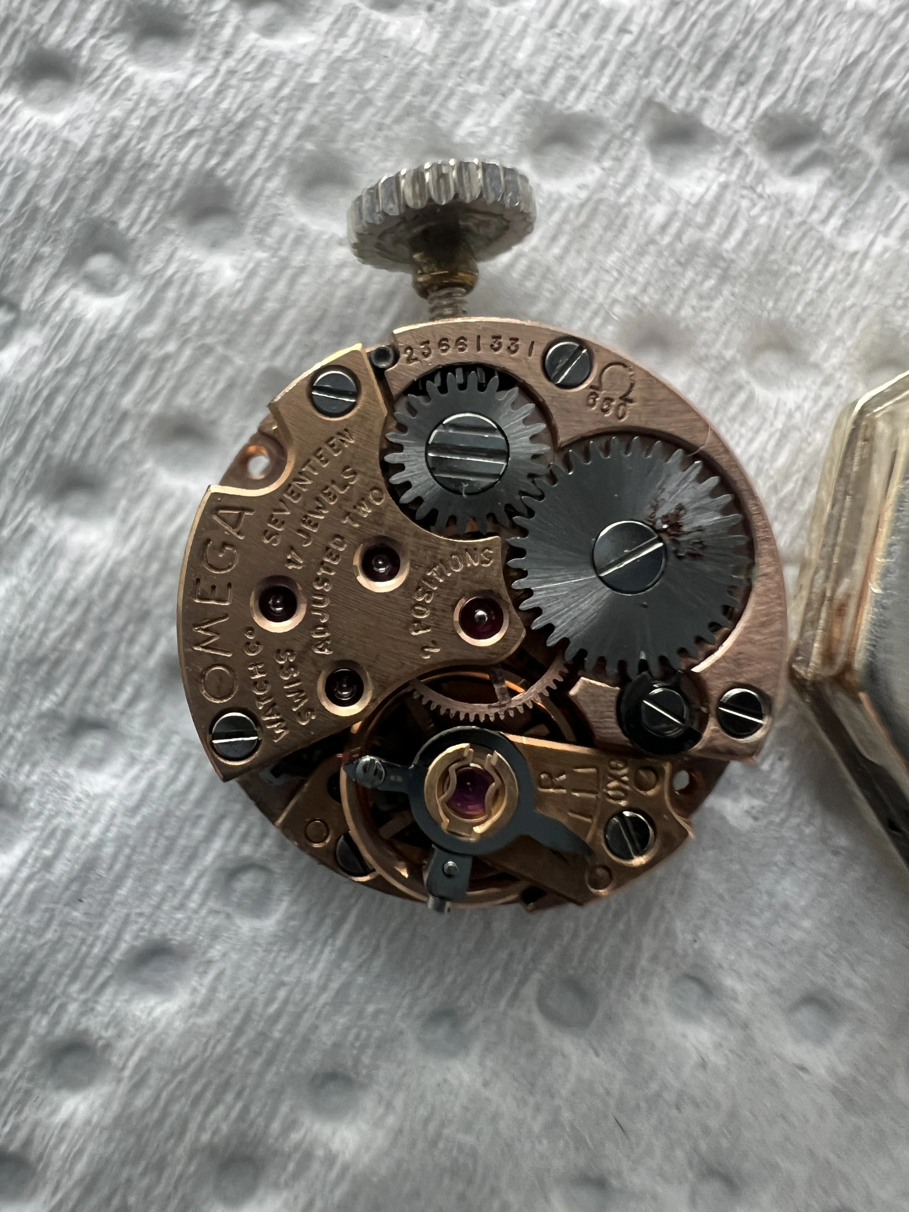

Thank you for the replies guys

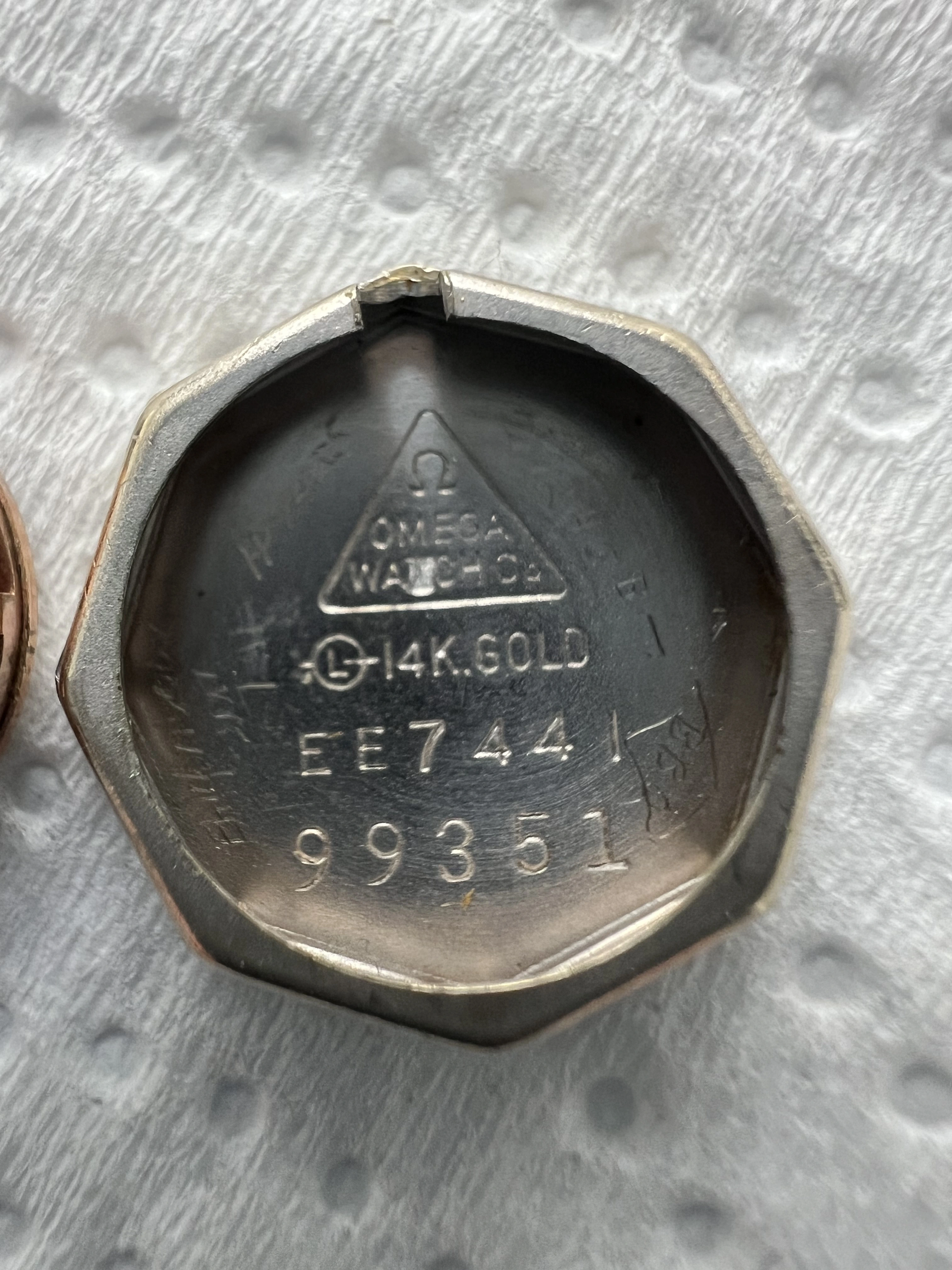

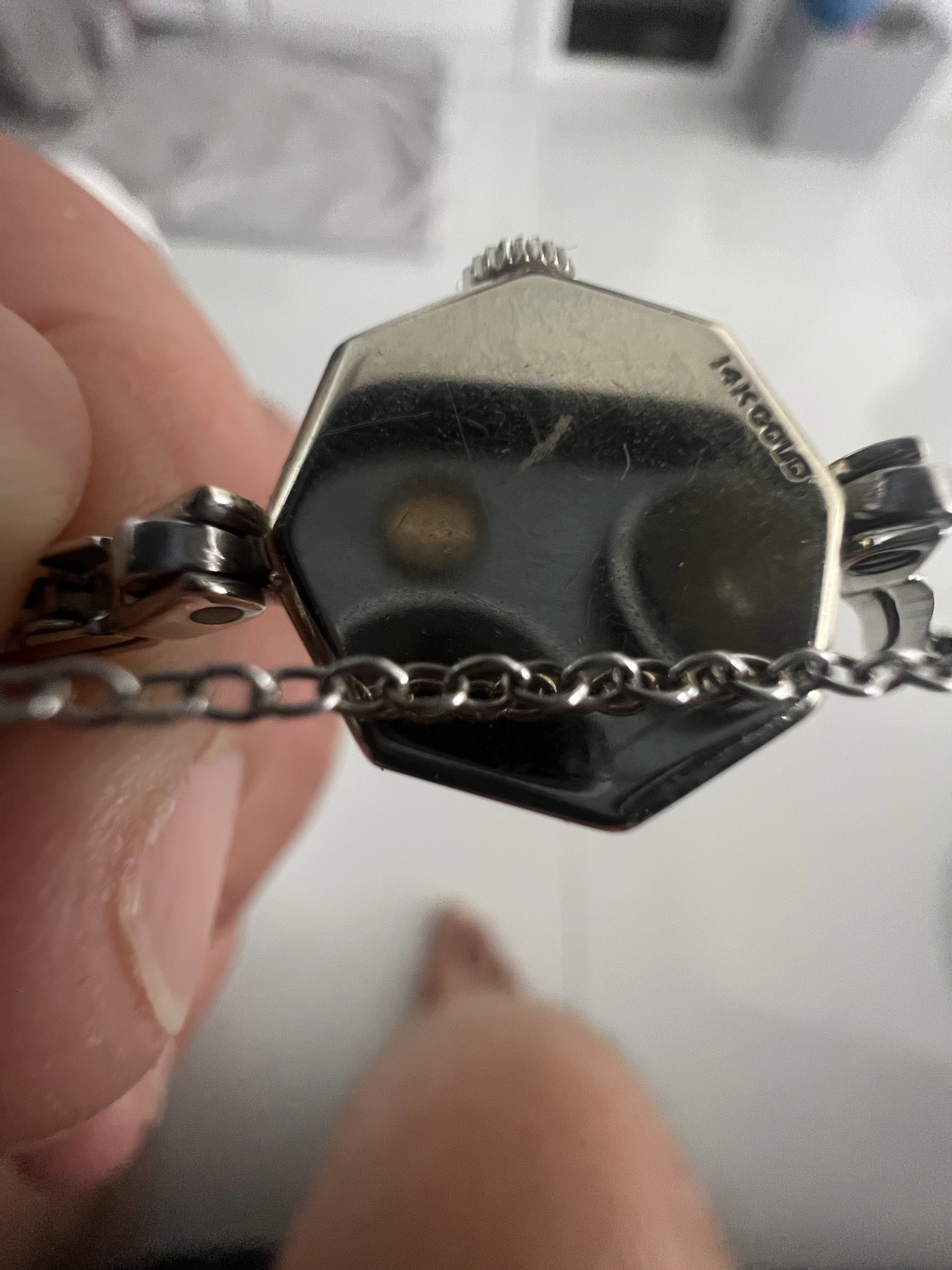

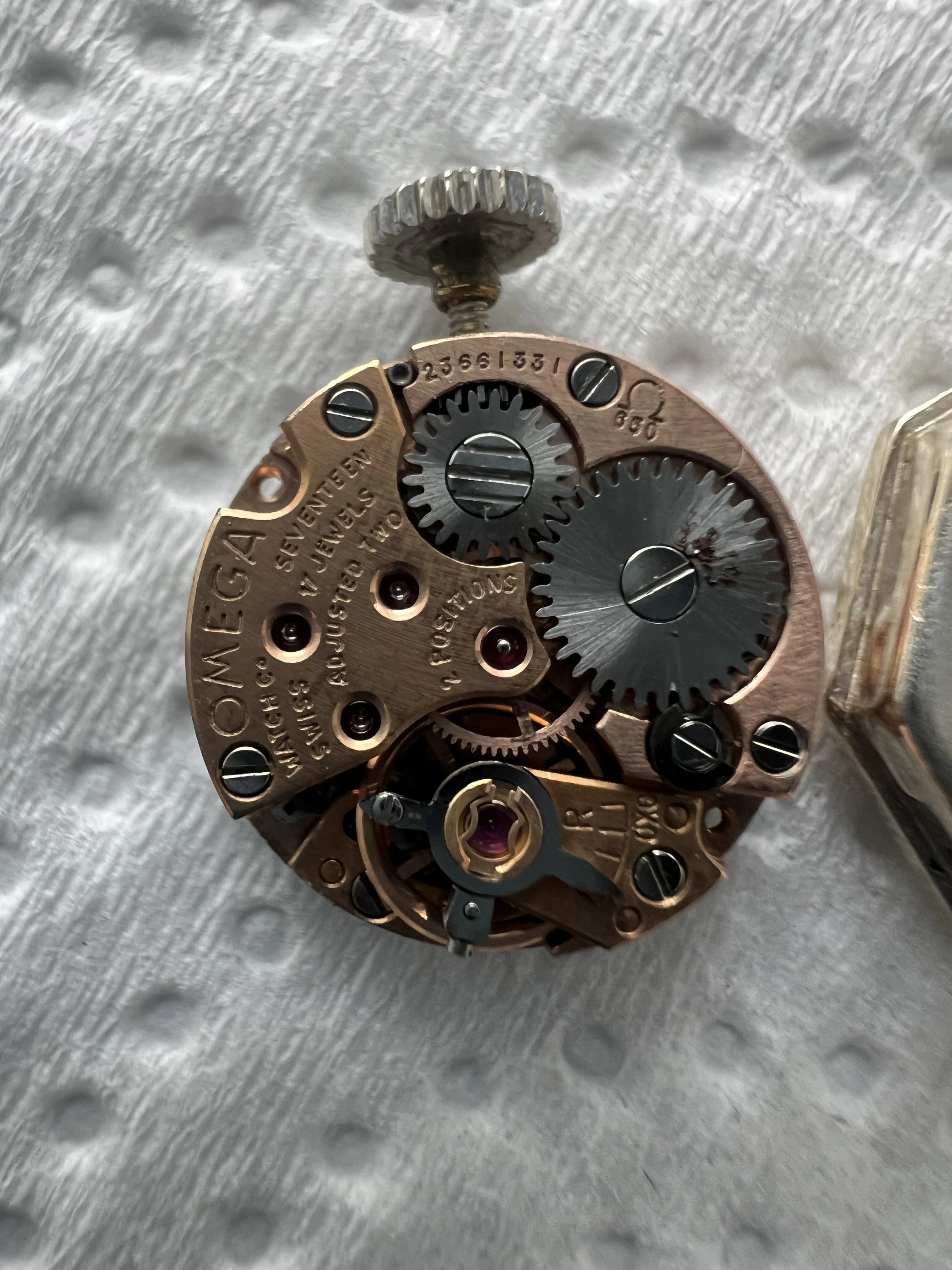

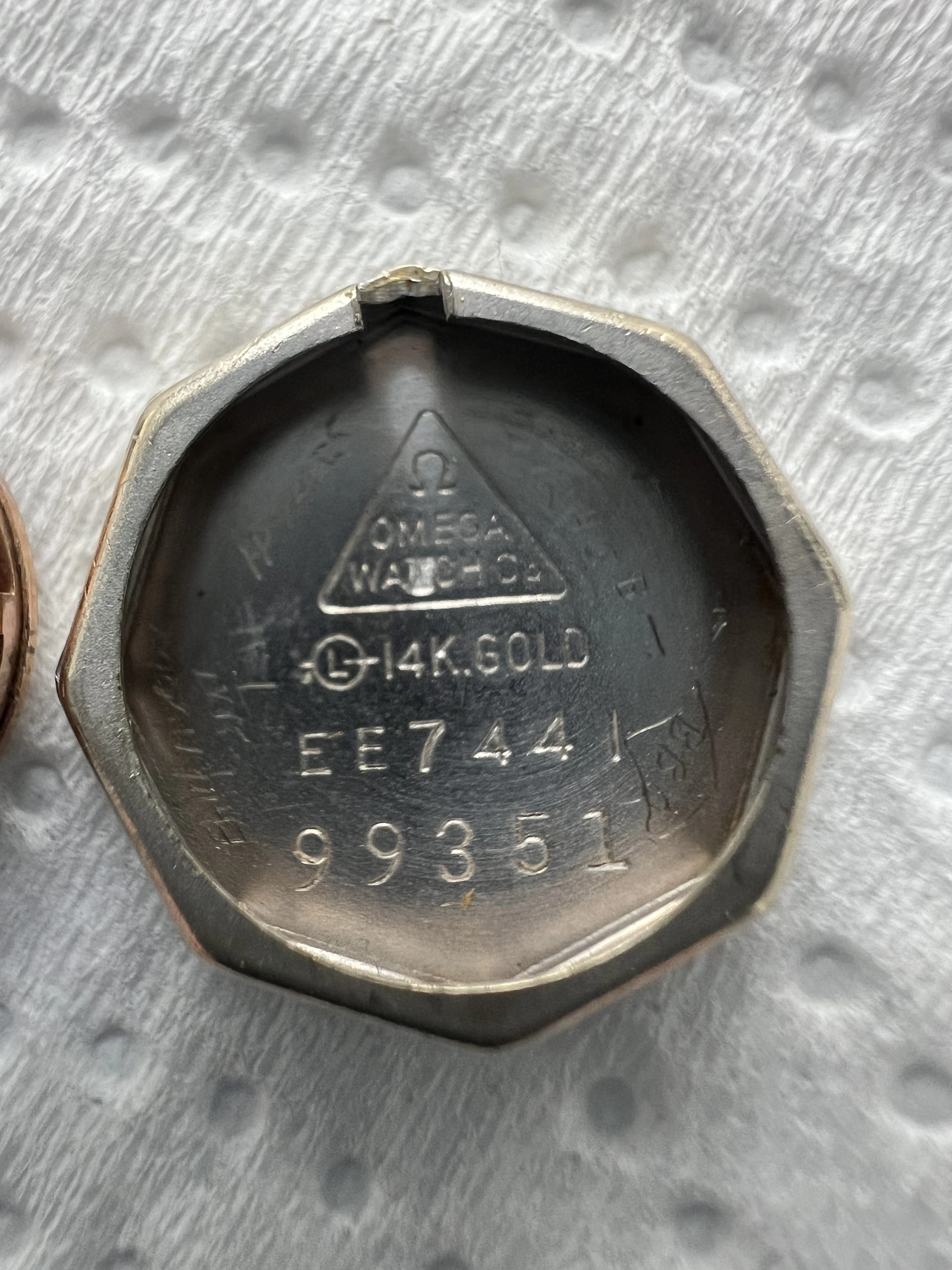

Here are photos of imechanism and case back
Any info is most welcome👍
18,840
39,182
The marks on the movement show it's a US cased watch (OXG = Omega Import stamp) and the serial nuber dates the movement to about 1966 or so, so the watch would have been assembled around that time for Norman Morris Corp, the Omega US agent.
One of our US mambers may be able to identify the reference number and case maker.
@gatorcpa and @X350 XJR are particularly good at US references.

Reference number is EE7441, but that is not going to help you very much. Omega made dozens of different references in those years, usually in very small batches. I don’t know the name of the case maker. Again, Omega used several of them in the U.S.
The way it worked back then is that Omega shipped raw movements to its U.S. distributor Norman Morris, Inc. This was done to save on customs duties. Then NM solicited designs from several watch case companies, usually in 14K gold or gold-filled made to fit these movements. The final assembly of dials, hands, bracelets, etc. was done at their NYC factory.
That’s all I can tell you.

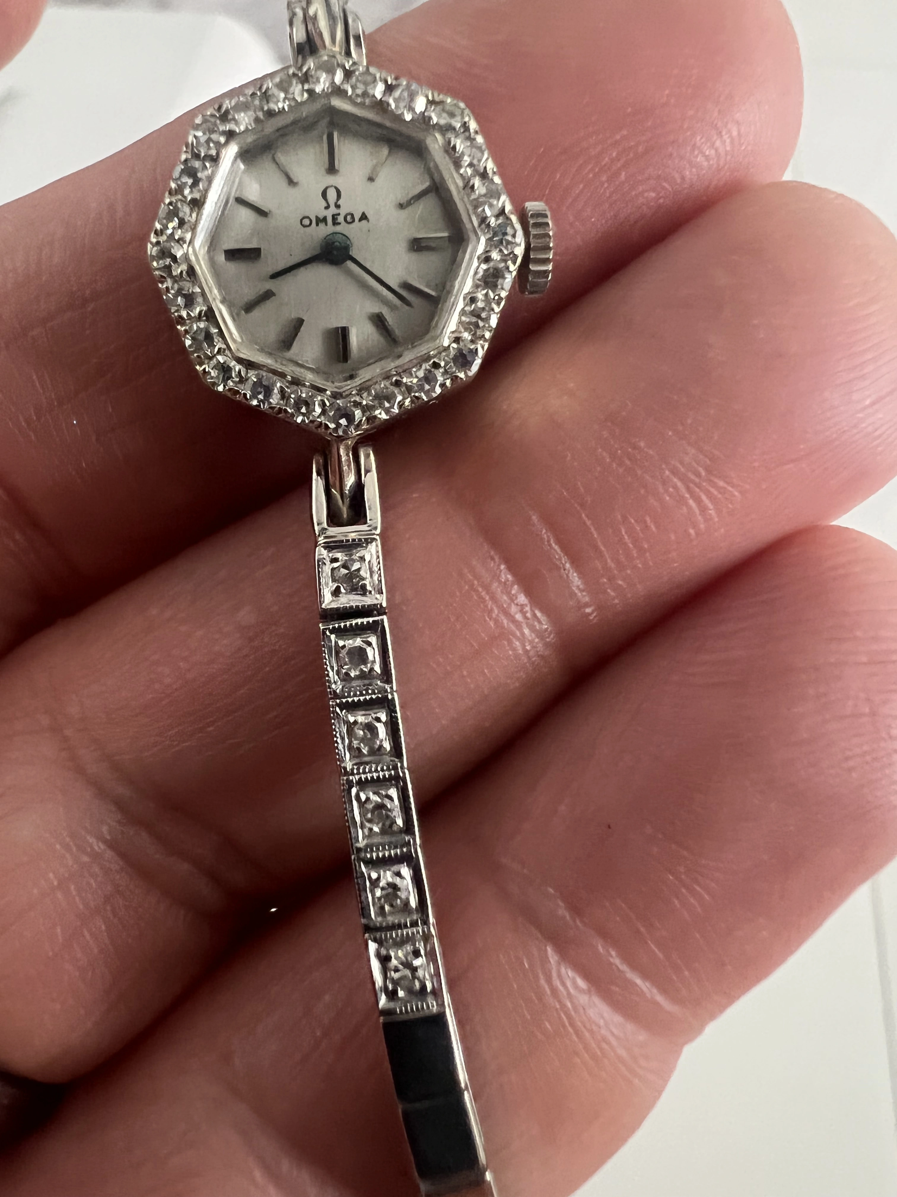

Diamond set watches like yours were very fashionable in the 1960s:
