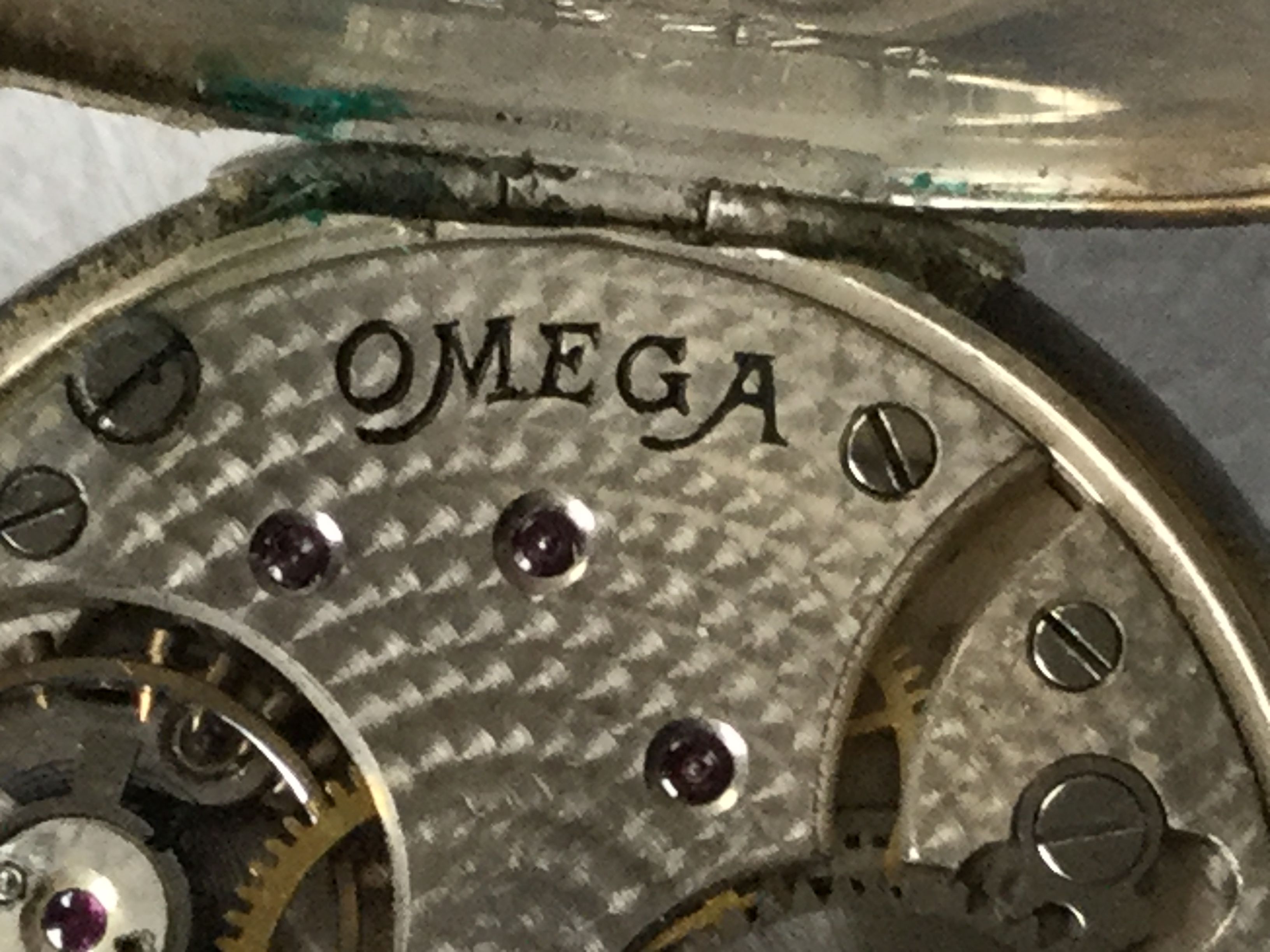

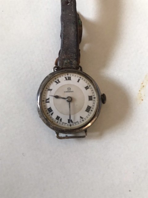

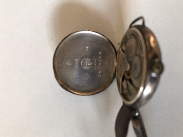

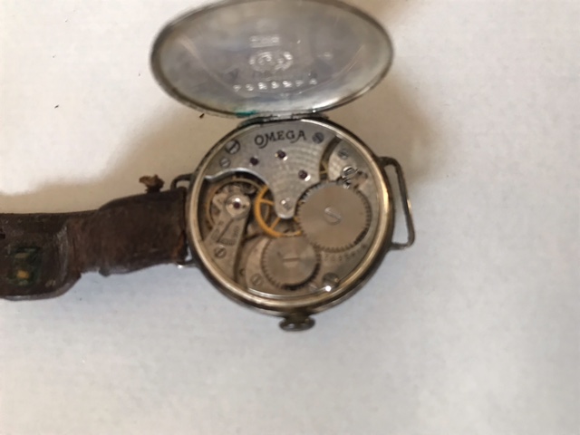

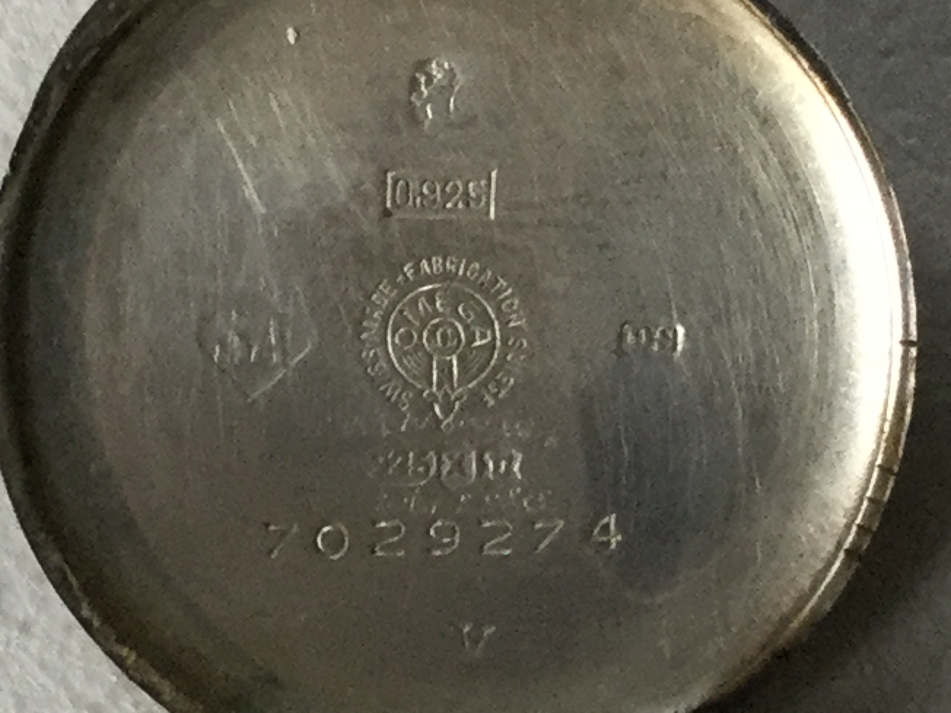

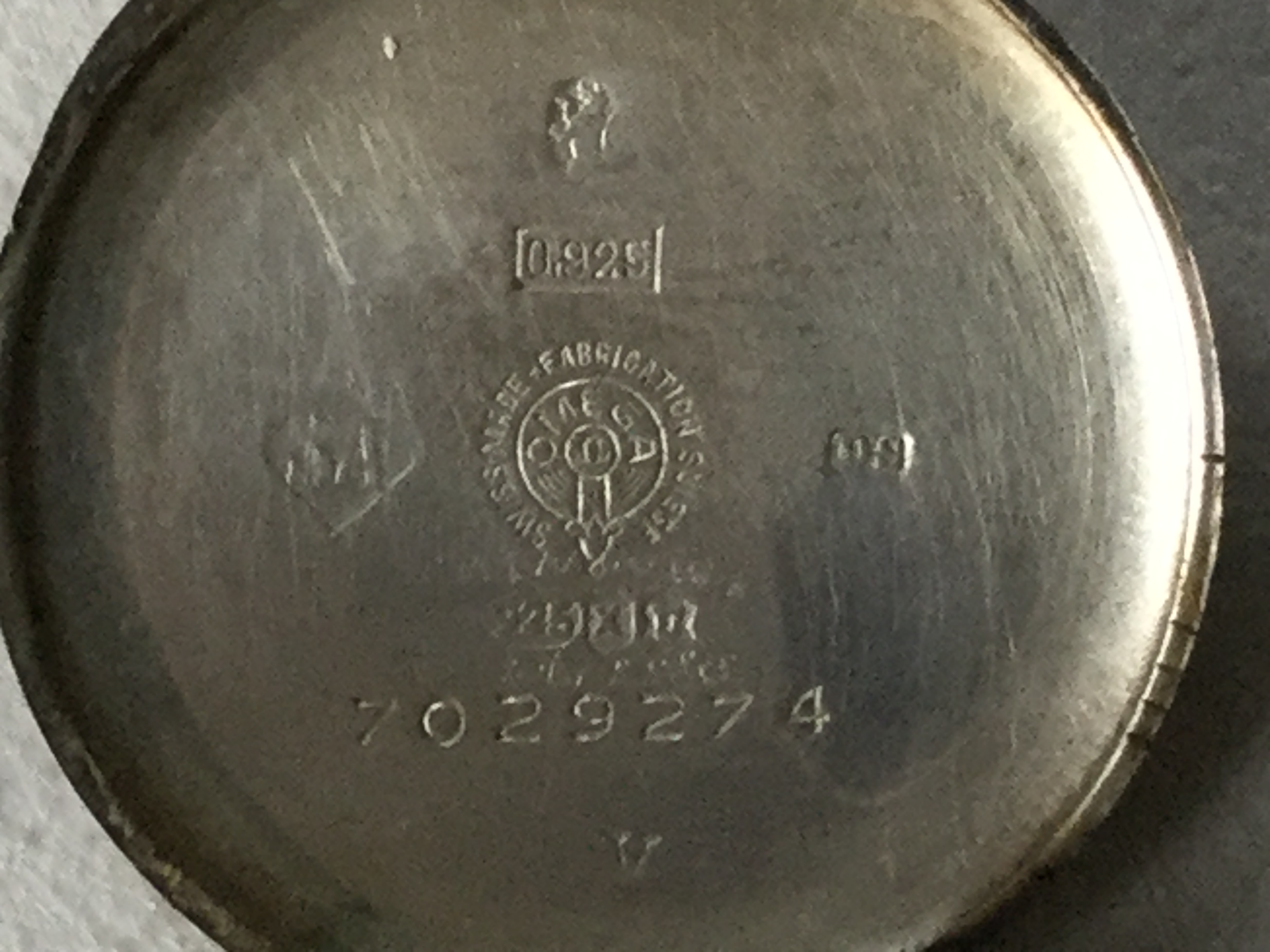

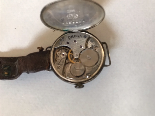

Hi I'm a new member, I need help to identify an old ladies Omega watch. I found it while clearing out my parents house. They were in their 90's and I dont recall ever having seen my mother wearing it.
I have had a look on the Omega vintage site and the closest style I can see is dated around 1906-1916.
I will attach some photos but to aid it is in a silver 0.925 case with a hinged rear case which is inscribed with the Omega logo, the silver marks and a serial number 7029274. There are a couple of other marks either side of the Omega logo which appear to be a capital SA in a diamond stamp and a small square stamp with what looks like DS in it.

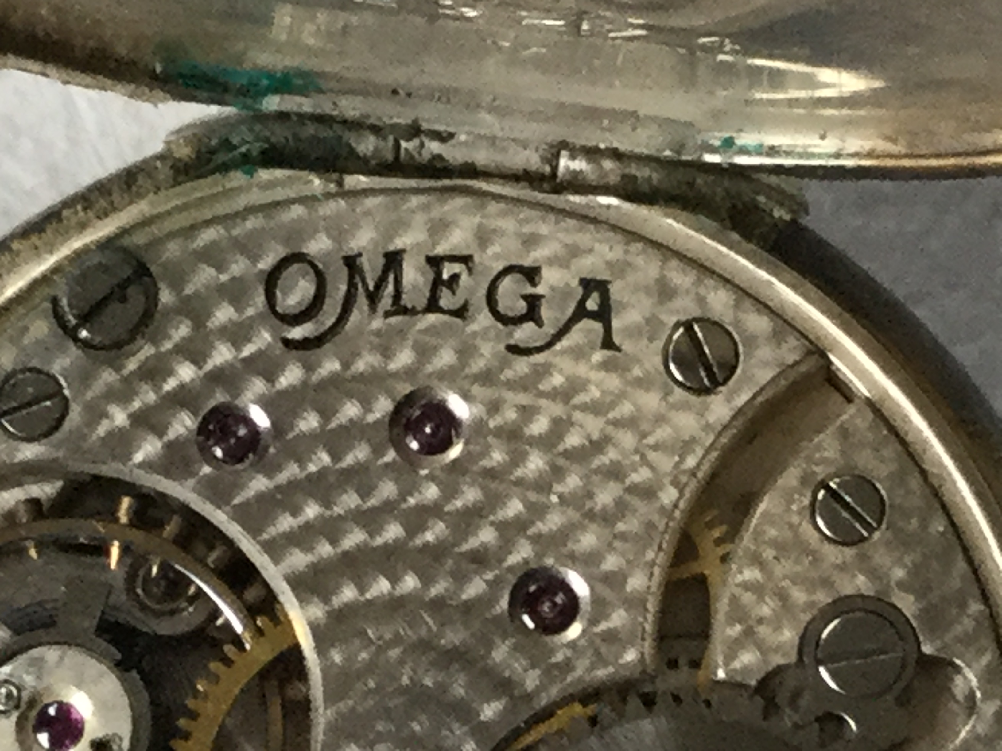

On the watch movement I can only see another serial number 7035474 and the Omega logo very stylised with long tails on the letters M and A. Cant find anything else like a calibre number though.
Does anyone have any ideas on age or details please.

So, ladies Omega watch. Movement serial dates it to 1929.
Possibly people here could say a lot more with a proper picture of the caseback engravings. You might try to get decent shots of the dial and movement?

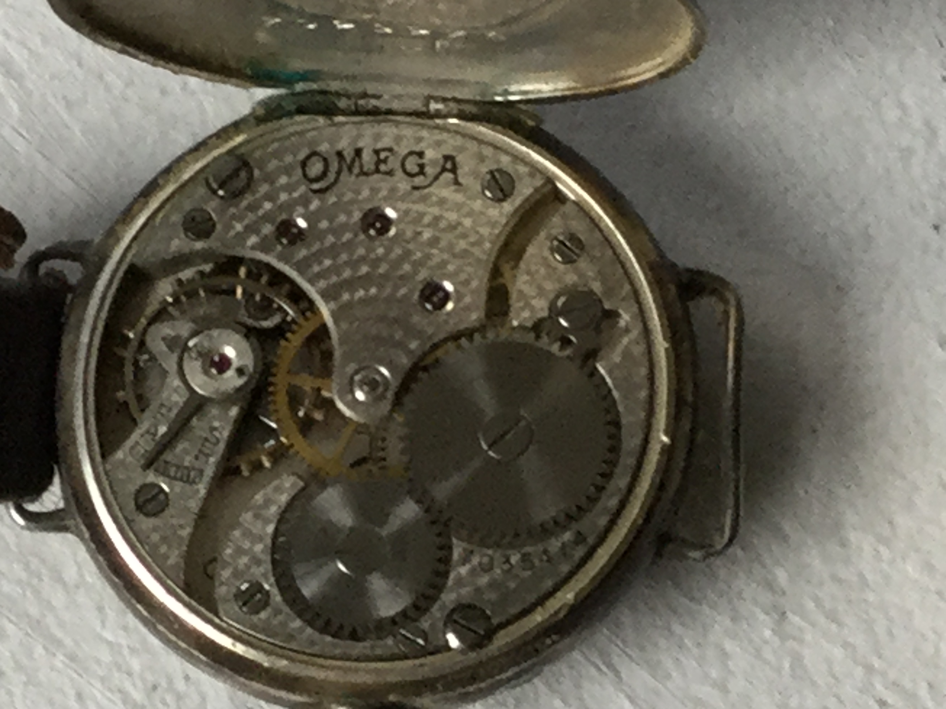

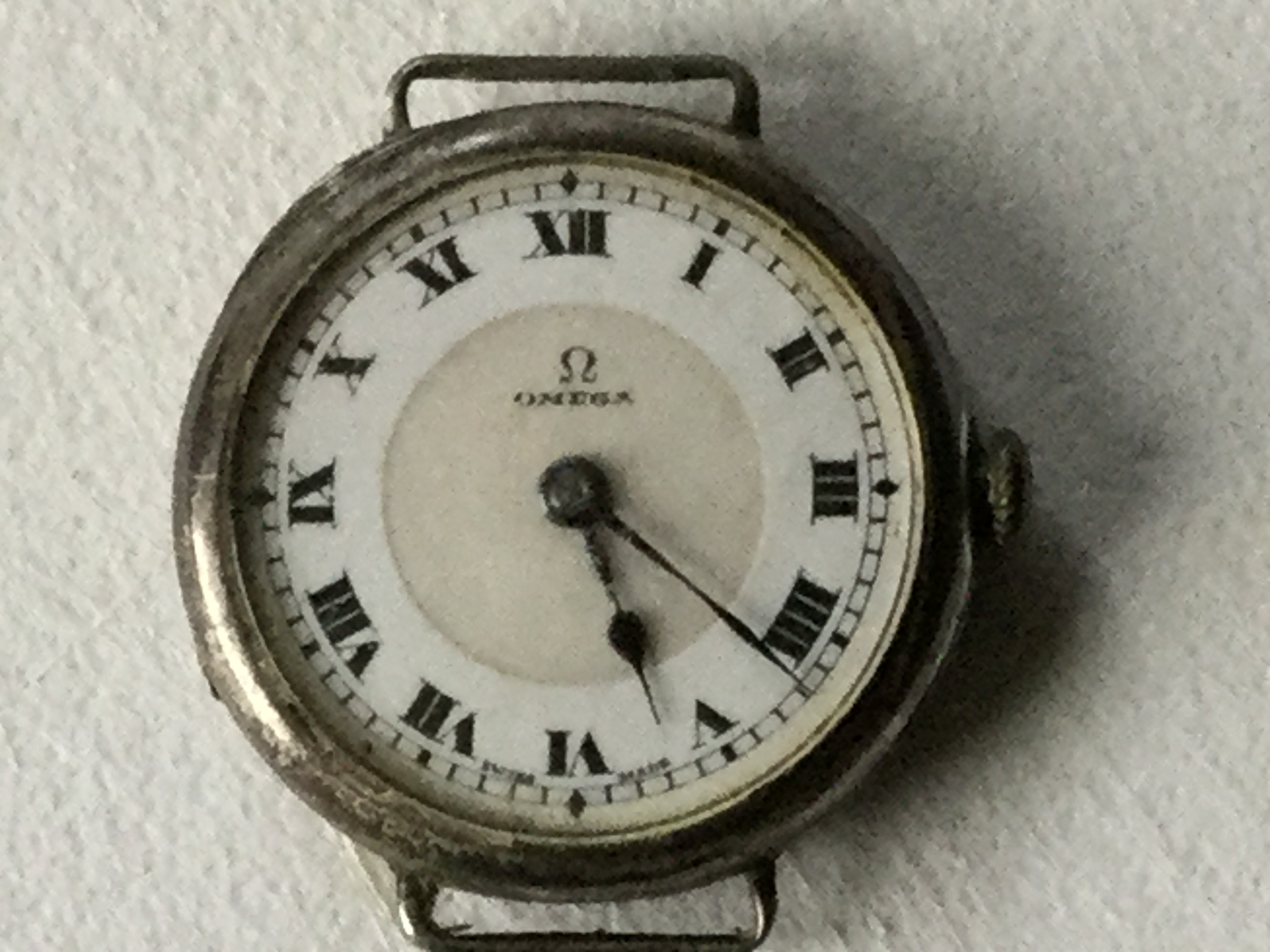

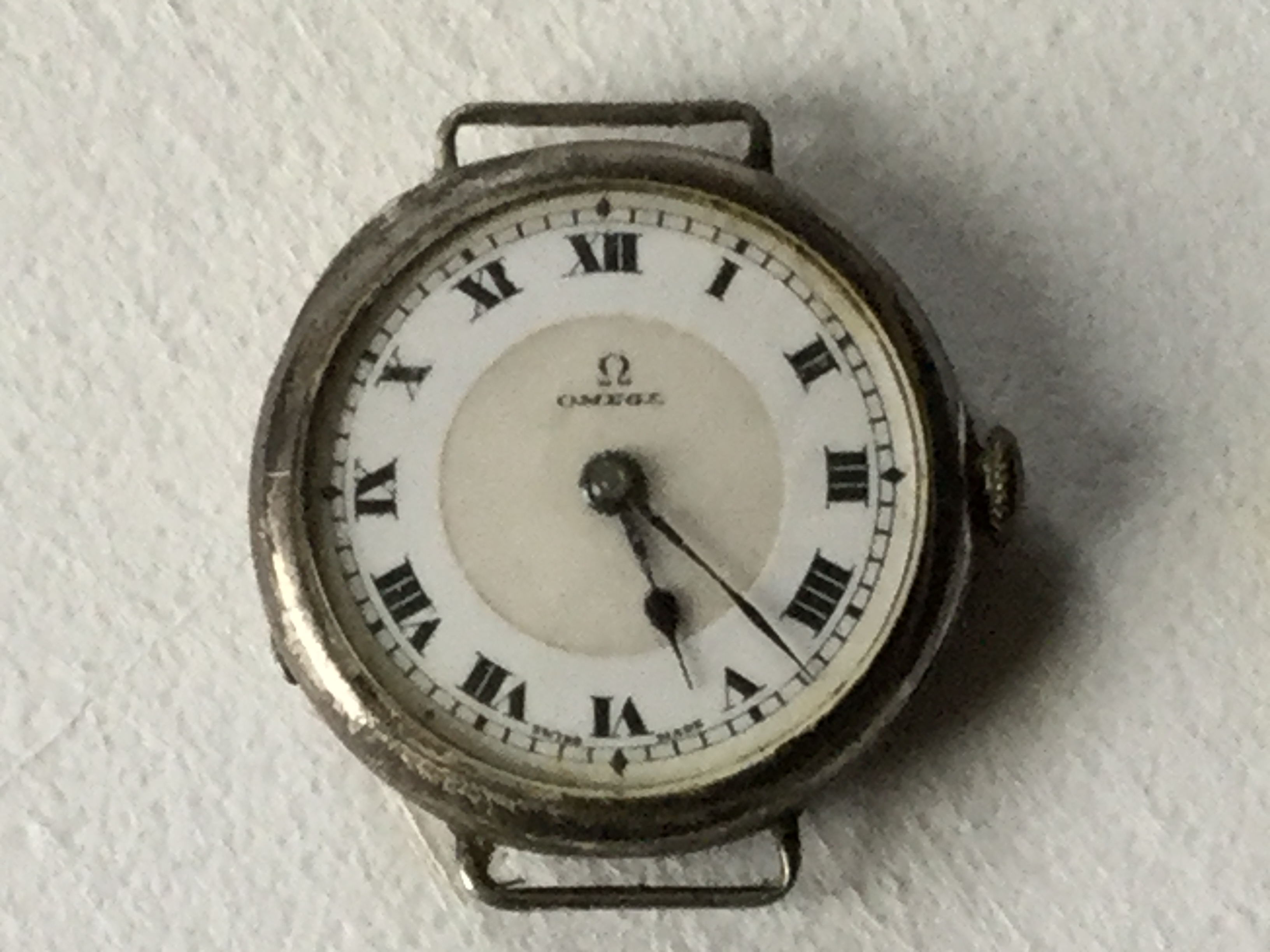

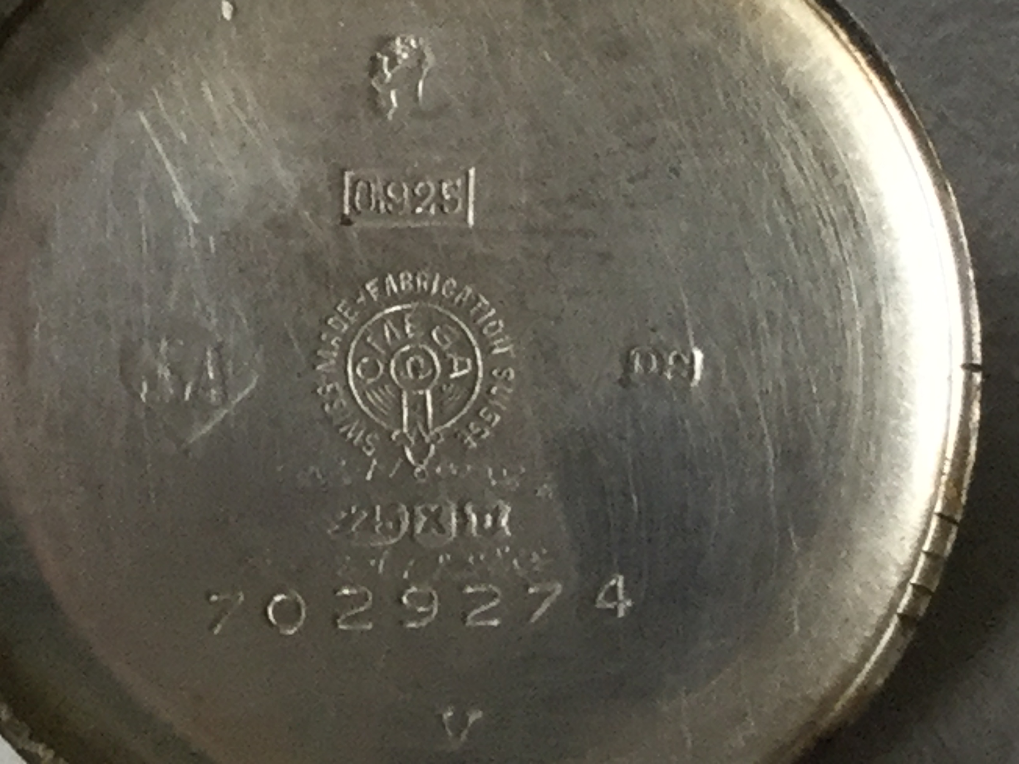

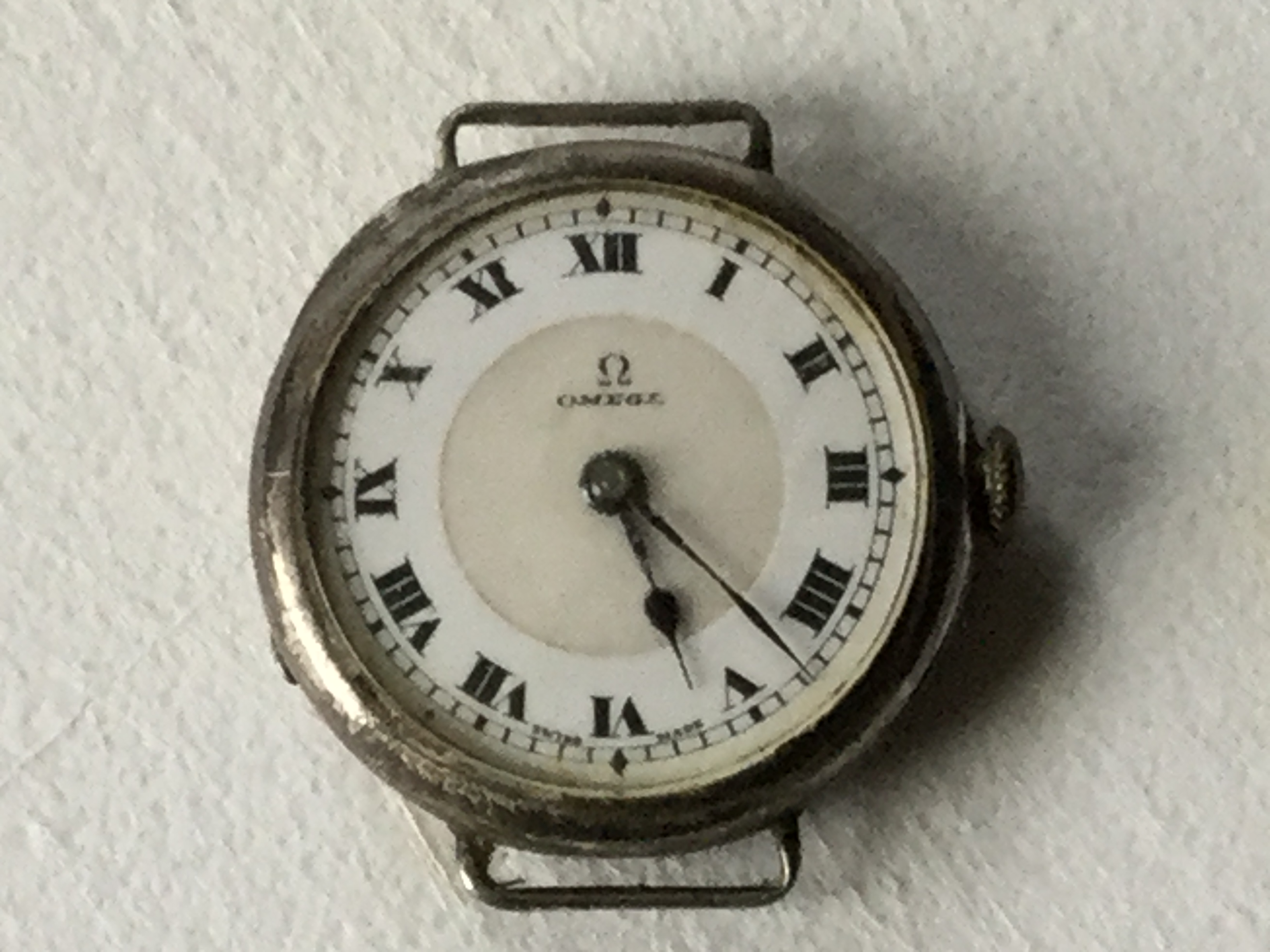

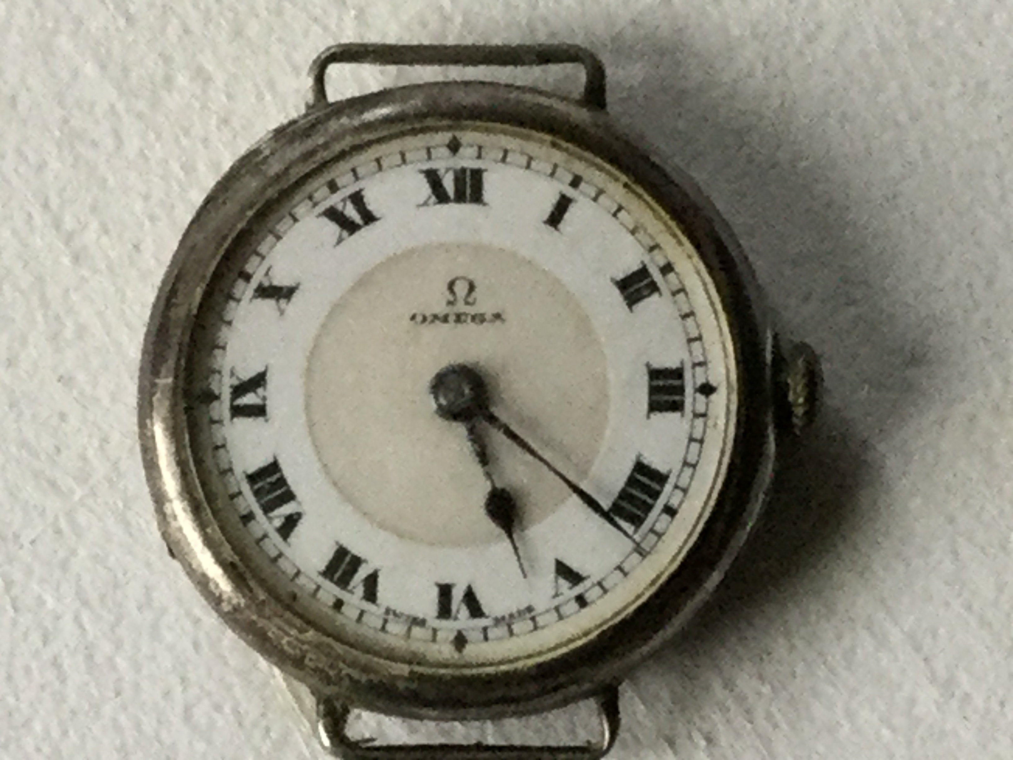

Hi I’ve taken some more photos which might help identification and does it have any value do you think
1,372
2,001
Lovely watch. I'm afraid I don't have much to add beyond my bemusement at how close the case a movement serial numbers are.

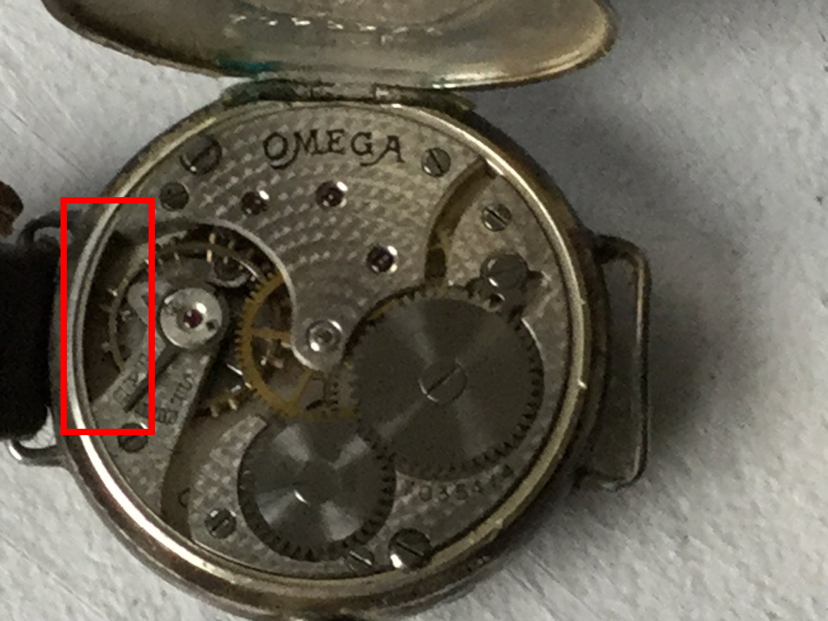

The movement is a 23.7S. This movement was used in this period for both men’s and ladies’ watches - it really could be either. I would guess that the watch dates about 1925. To confirm the movement, I attach OP’s image marked with a red box that shows where it may show ‘23.7S’ (hard to see in this image), under the balance.
The list of (approximate!) dates shown by @aleksejeremeev above is for movements (because there were no 2-million Omega cases). Dating of Omega watches until the mid-1930s was by case number. The movement number can be very confusing - and here is a good example: the 23.7 was one of the movements made both in Biel/Bienne and in Geneva and this was a Geneva production. The numbers allocated to Geneva movements were in batches and quite separate from the Biel/Bienne numbers - so this 703- movement number could have been produced at the same time as a Biel/Bienne 633- movement.
As we see, the Omega case is 925 silver and it all looks original. The strap may not be original - but it is certainly very old! Charming. The watch will have some value - but surely the value is greater to the OP, having come from his own family? As always, it would make sense to have the watch serviced - whereupon it could well keep good time.
