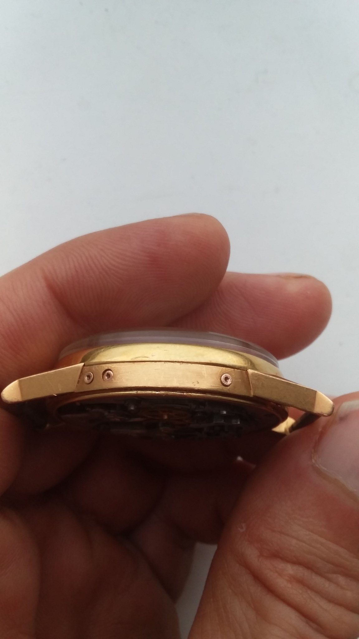

I have never really seen another UG Tri-Compax with this style of case. Can anyone lead me to a set of correct hands ? What do collectors here on OF think of the case ? The third picture I'm trying to show the two facets on the top of the lugs. Sorry for the low quality of my pictures !

It would be quite hard to modify the HJ case to fit the date, month, moonphase buttons perfectly. However the case back I am not sure, they are probably interchangeable. But still why would someone do that?

I was going to say, if it's not a tri case, someone would have to do some impressive work with the 3 correctors

They do look good, although the photo is not in sharp focus. For the sake of argument, though, what would be required? Would it not be possible for a watchmaker to put three holes of correct diameter in a gold case with acceptable tolerances?

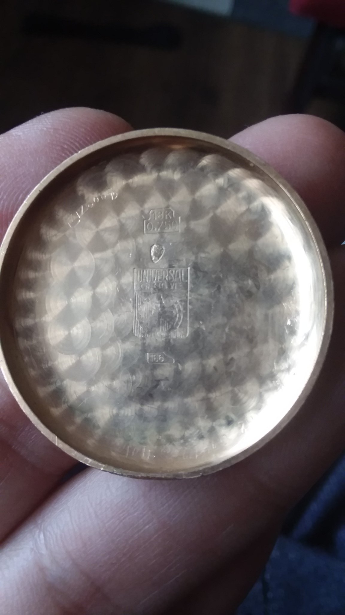

Pictures of the movement and inside of case.

Oh I'm not saying it can't be done, for sure, it's just the unbelievable trouble I go through trying to get even the most basic things done for my UG watches, if it was a MOD, I would love to hire this person to work for me. I've been waiting like 3 months just to try and get some very basic plating work done.
You would need the donor correctors, both internal and external (I suppose those could have come with the mvmt). Seems like a lot of trouble to go through?

A look at the database shows five examples of ref 12420, all of them Compurs, serial numbers spanning 729449 to 815369. There are no Tri-Compaxes.
The earliest Tri-Compax case number I have is 946808. I find no Tri-Compaxes in Henri Jeanneret cases
The database is a personal venture of mine comprised of data from observed examples, and thus utterly incomplete.
