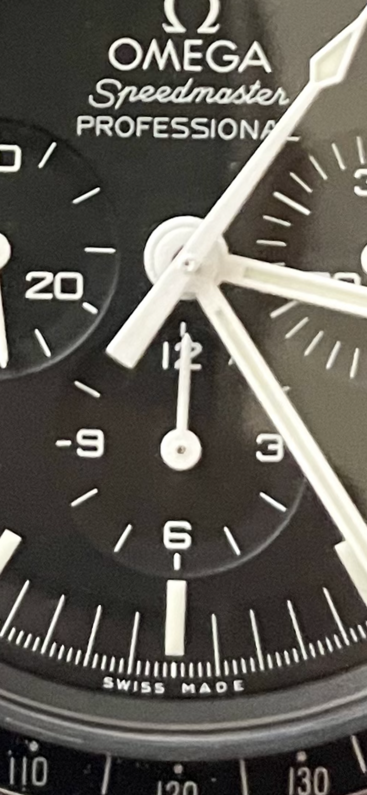

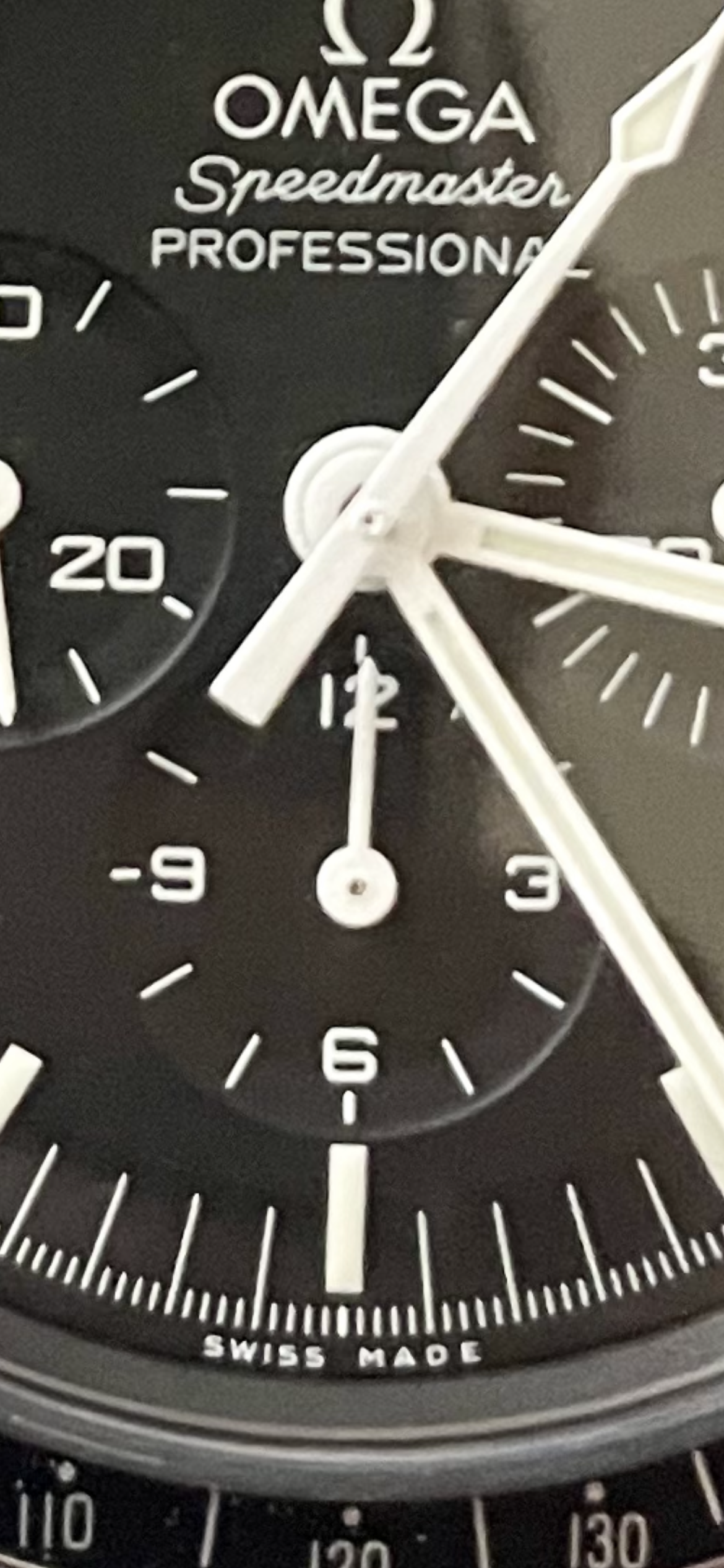

Hello Everyone!
I would love to get everyones advice on what I should do. I just bought a brand new 1861 Speedmaster from an AD last week. I notice that the hand on the hour subdial does not align perfectly at the 12 o clock marker. As you can see in the photos it sits slightly to the right. There is a service center that is about 20 minutes from me. Since this is a new watch I could very easily go and drop it off to have it aligned. However, this watch is CRAZY accurate. Over the past two days it has only lost 2 seconds. This speedy keeps better time than any rolex i have ever had. Im scared that if they open it up I might be creating a cascade of other problems. Should I just leave it as is or is this an easy enough fix to have the service center do?

Take it back, under warranty. It should gain a bit, not be slow.

That's an easy fix for a watchmaker, and it should have no effect on timekeeping. I wouldn't have it serviced for running a second slow each day. Instead, just try leaving it in different positions overnight. Many watches run faster if left with dial facing up.

What happens to the misaligned hand when the chrono is reset?
Since they're in there anyways, might as well have it adjusted for wear.

Adjusted for wear? Sorry i dont understand
People's habits affect how a watch keeps time. If you're consistently losing two seconds a day, a minor tweak to the watch's regulator can bring it closer to better timekeeping.

Thank you! Yes I agree, A watch that is running faster would be more ideal. Honestly loses less than a second everyday is pretty awesome in my eyes. But since Speedys are +11 -1 then maybe this might be worth having a service center taking a look. The Swatch service center is literally 20 minutes from me. So I could always go and drop it off for inspection
