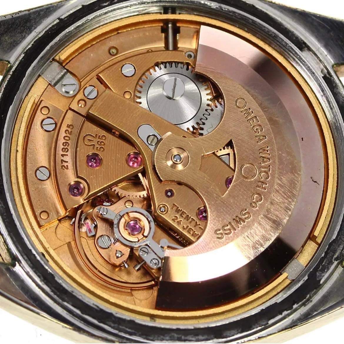

Hello everyone,

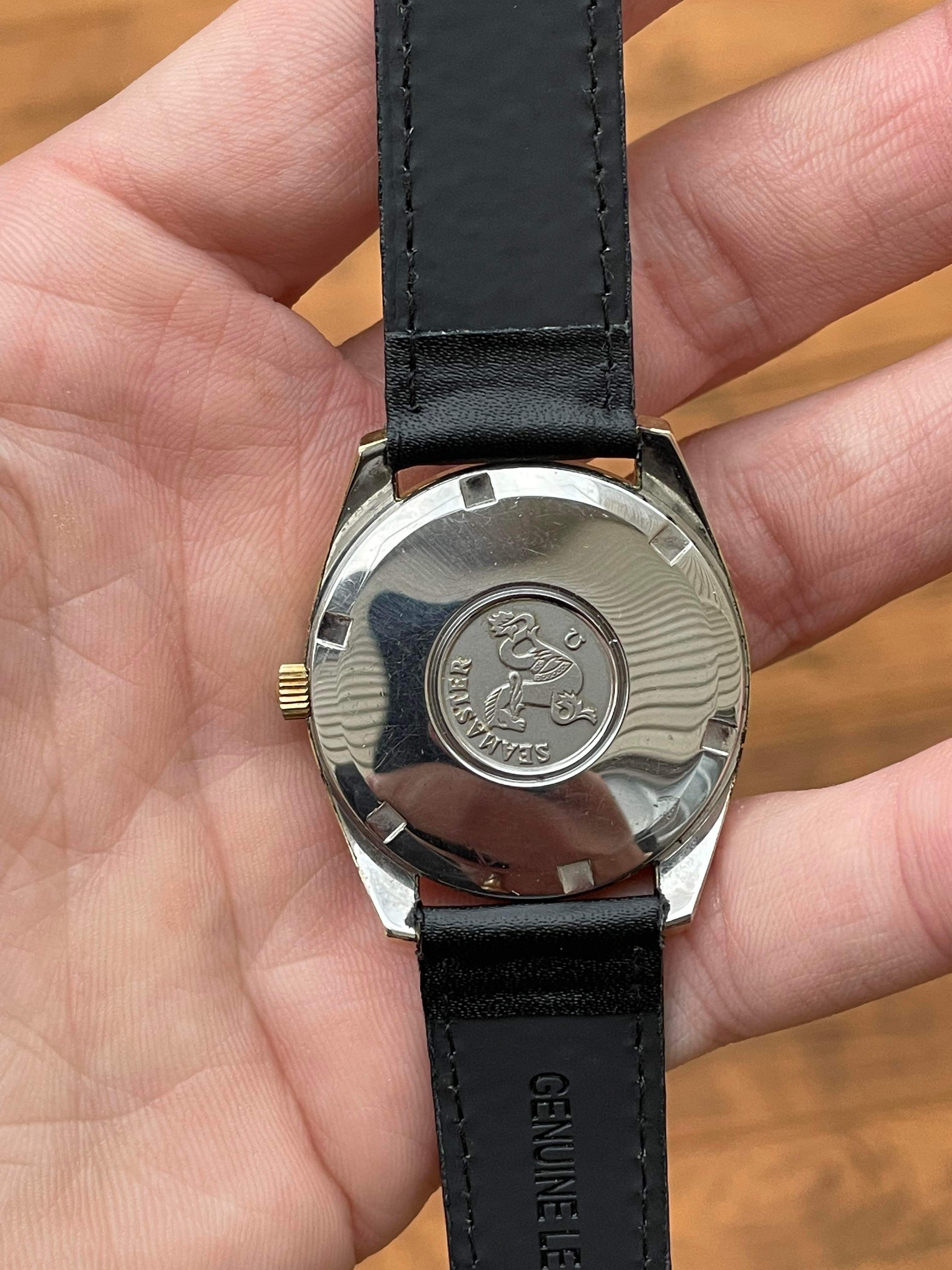

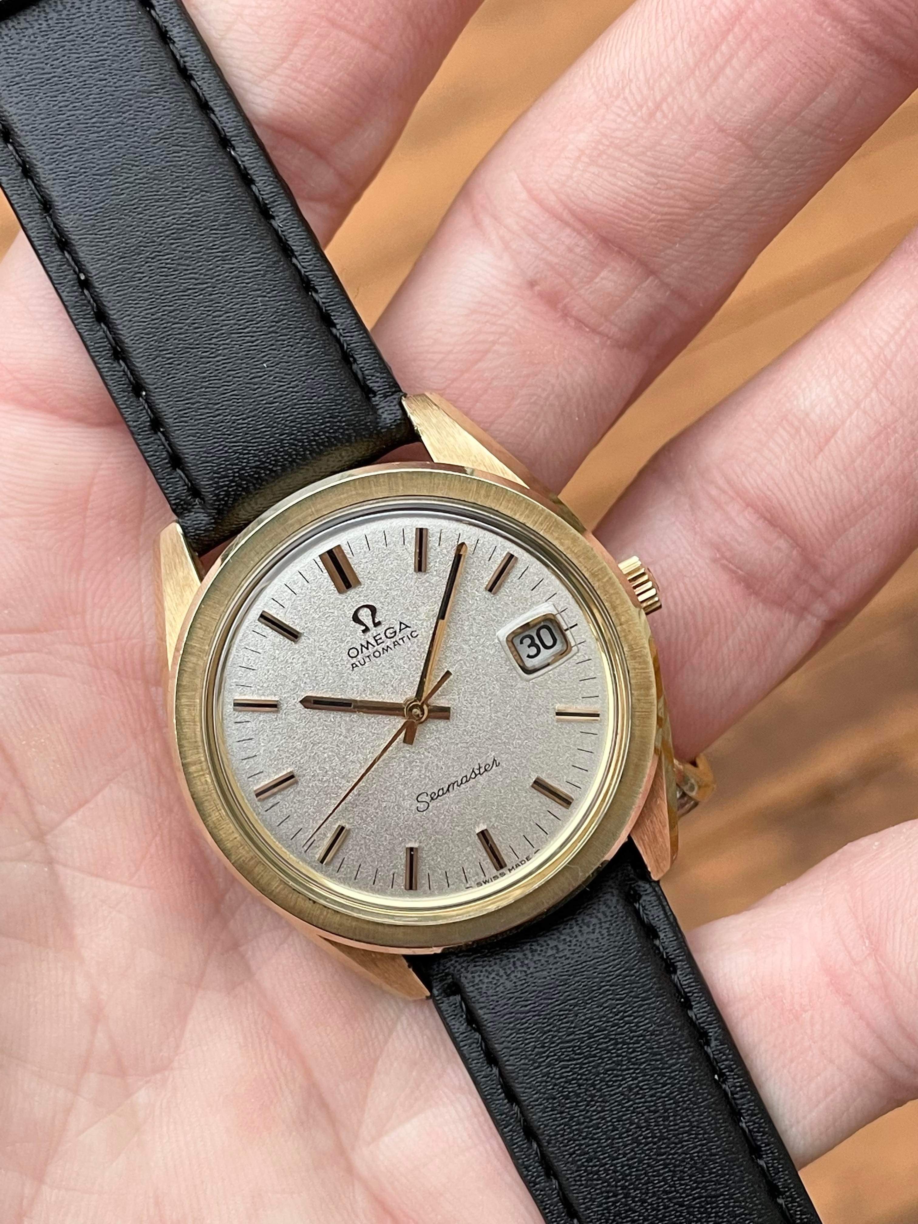

I am looking to purchase a vintage 168.022 sparkle dial Seamaster and had a question. As far as I know, this watch came with a 564 Caliber movement. While inspecting the watch, I noticed the caliber as being 565. I assume this watch was pieced together as this doesn't appear, based upon my research, to be the original movement. Here are some pics of the watch. Seller states the watch was serviced and keeping time +/- 20 seconds, with the watch not being polished to his knowledge. The seller is asking a reasonable price, but what would you say this is worth if it fact this was pieced together and not all original? Worth buying?

Isn't cal 565 just the non-chronometer version? Maybe it's ok since the dial doesn't say chronometer. If it were a chronometer version of the reference with a cal 565, then I would be more concerned.
The condition looks very nice as far as I can see, but keep in mind that the non-chronometer examples don't bring quite as much as the chronometer version, if you are comparing prices.

Ref 168.022 564, 166.028 565, dual reference case.

I would then assume the seller listed the incorrect reference. This watch then appears to be a 166.028?

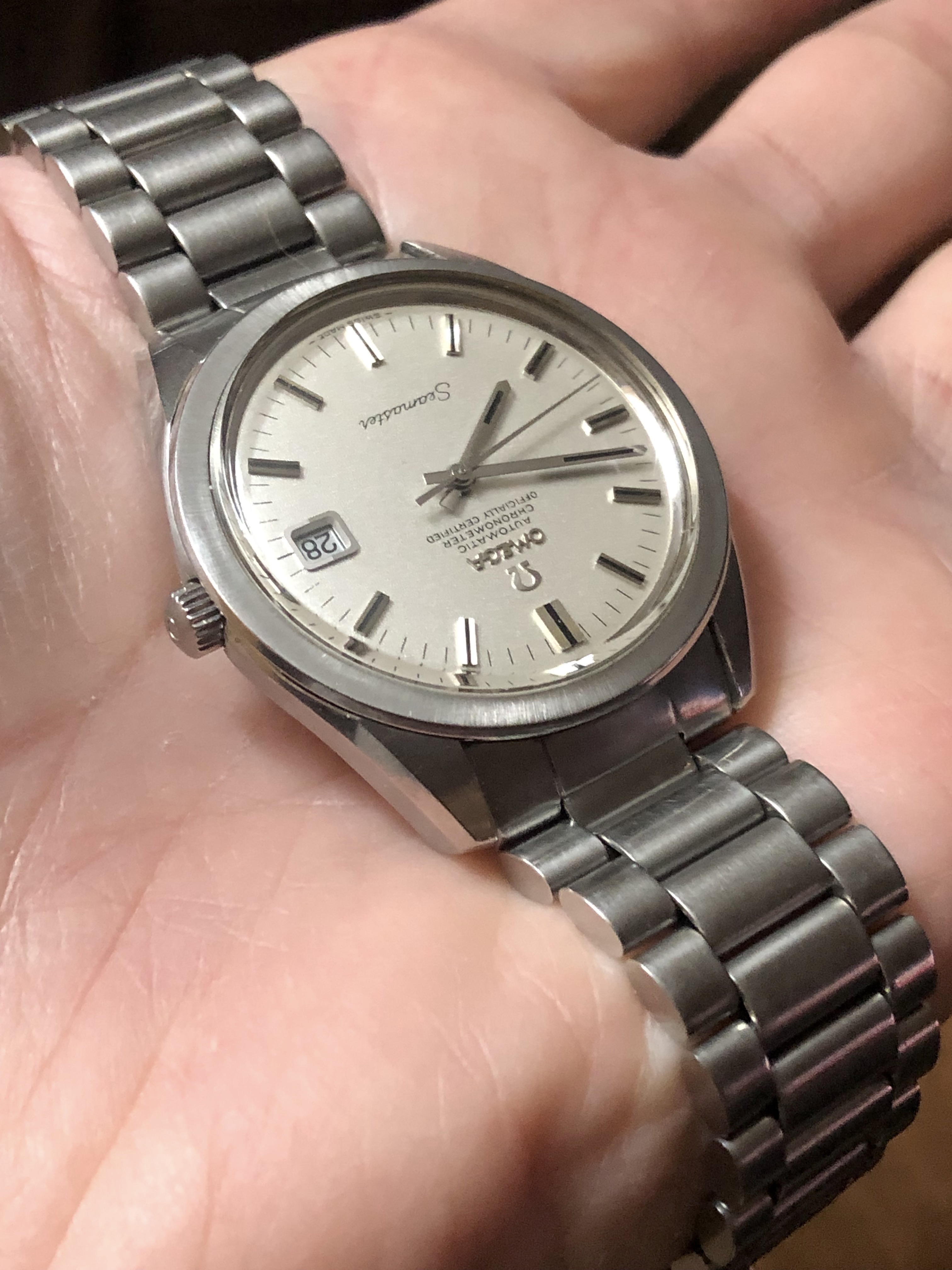

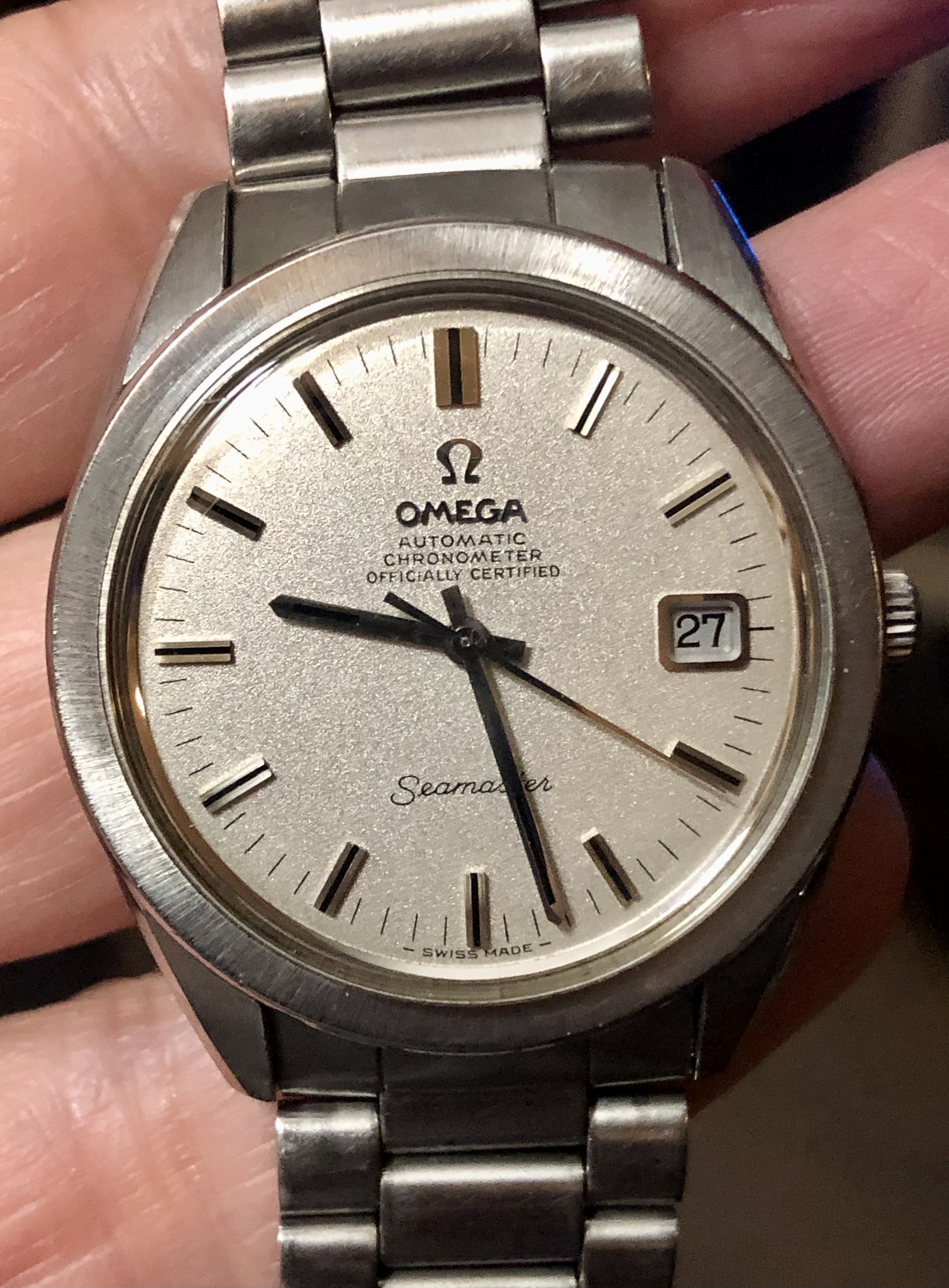

I'm more familiar with SS models, but I think that gold-capped is fairly similar. I think that the prices you are giving are almost 2x what I would pay. I recently bought a very nice chronometer version for about $550. I later added a 1125 bracelet which cost me about $200. If I were to sell the package, I would be happy to get $1250.

I'm more familiar with SS models, but I think that gold-capped is fairly similar. I think that the prices you are giving are almost 2x what I would pay. I recently bought a very nice chronometer version for about $500. I later added a bracelet which cost me about $200.

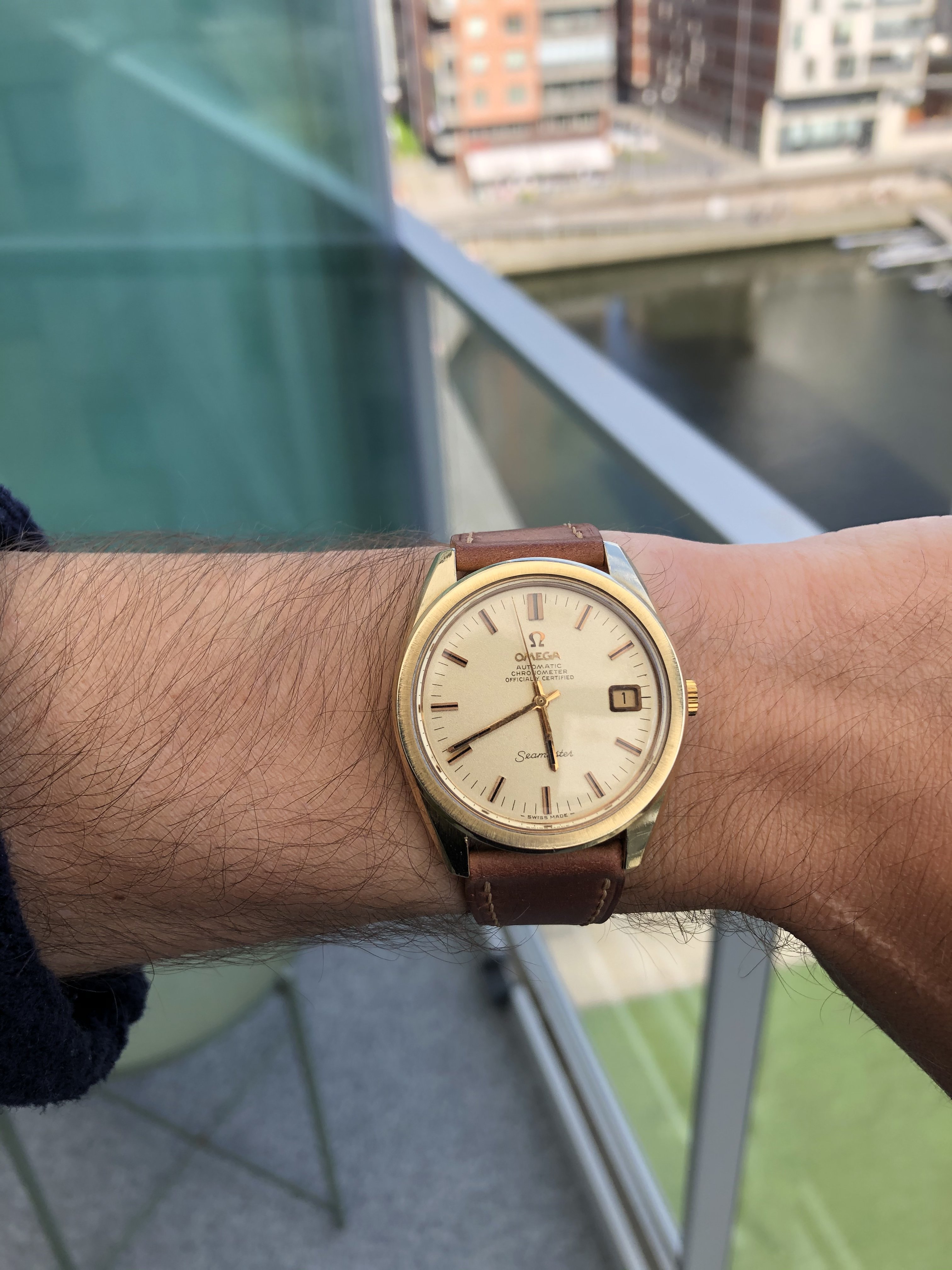

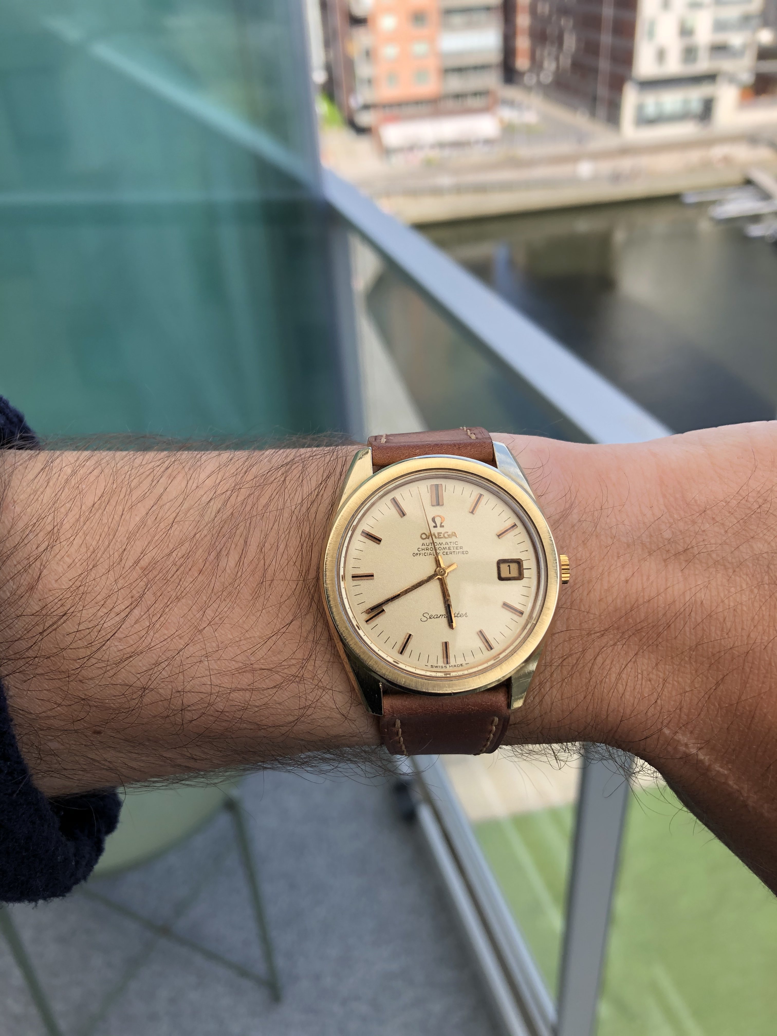

It's possible that the gold-capped is more valuable for this reference. Certainly I don't see them very often.
Your watch looks amazing! Sweet piece. That was my thought on the gold-capped with a rarer sparkle dial in such good condition.

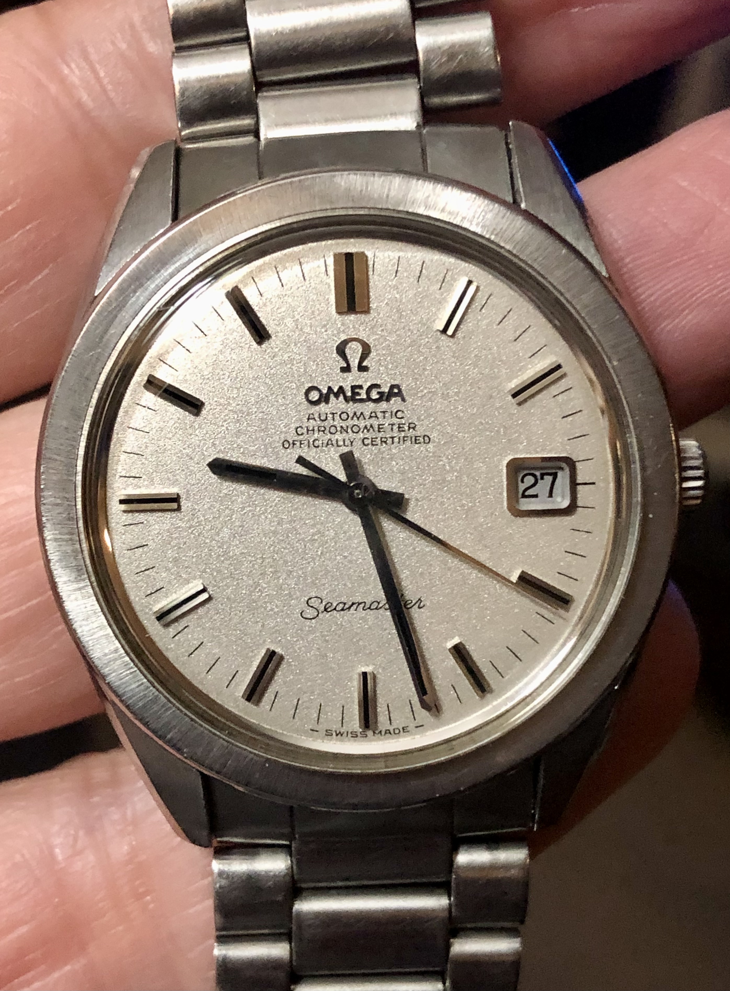

I agree that the gold-capped seems uncommon. Mine does have a sparkle dial, just a little hard to see in that photo. The one you showed is very sharp.
Oh def. see it! Looks great. Such a nice watch. I'm going to offer the seller a little less and see what happens. Fingers crossed.
Yes. The OP watch is a Ref 166.028 because it is not a chronometer, and the 565 movement, which is not a chronometer, would be correct for the 166.028. The 564 movement is chronometer grade and would be found in the Ref 168.022. As @X350 XJR noted, the same case is used for both the 166.028 and 168.022. So it does appear that the seller listed the wrong reference.
The OP watch is very sharp and in great condition for a gold-capped sparkle-dial Seamaster. The gold-plated cases tended to go very soft and less sharp even after only minor use. You'll be looking a long time to find as sharp as that one. Good luck!

The OP watch is very sharp and in great condition for a gold-plated sparkle-dial Seamaster. The gold-plated cases tended to go very soft and less sharp even after only minor use. You'll be looking a long time to find as sharp as that one. Good luck!
The watch appears to be gold-capped, not gold-plated IMO.
