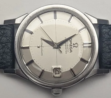

Gents,

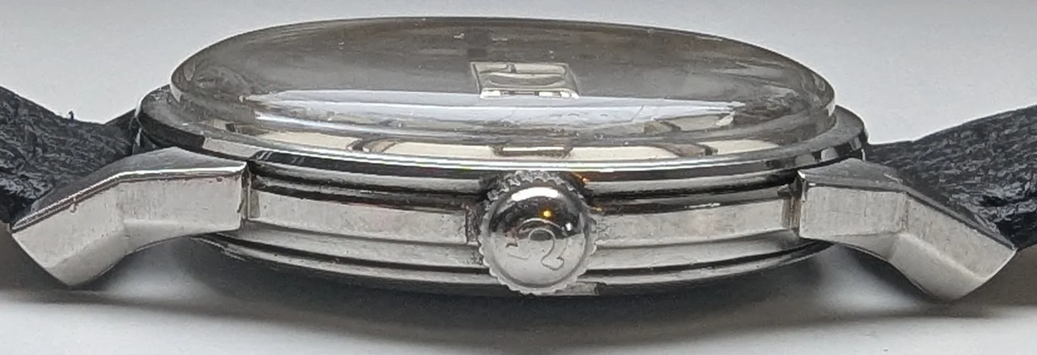

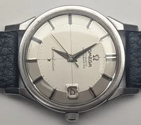

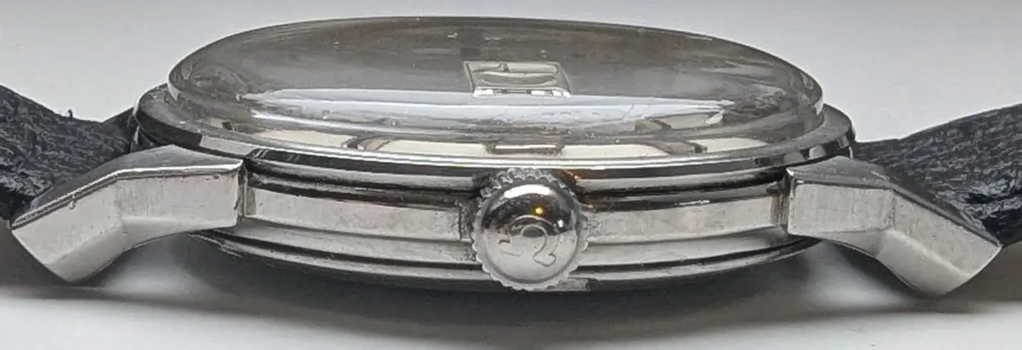

What do you think of this 168.005 please?
To my rookie eye it looks OK.I'm slightly worried that the minute markers aren't precisely hitting the crease of the pie-pan dial, but I don't think it's a redial. I'm aware that it doesn't have the correct crown.
The cyclops appears to be on the inside of the crystal. Are those onyx hour markers?

Some details make me want to say redial :
  • tilted star below the “constellation“
  • bold painted indices unevenly placed - the space between the index and the black dashes are uneven
There’s also something about the whole case and crown that look unauthentic.
I’ll let the more experts member tune in but this watch looks suspicious to my eye.

I would expect a 168.005 to have "Officially Certified" on the dial. Something doesn't add up.
13,392
18,584
Some very early Ref. 168.005’s might not have that on the dial.
However, I believe this particular watch is a redial.
Crown is also not correct.
I would move on here.

One more vote for the dial not being kosher; just look at the applied omega logo and the alignment to the cross hair. Or rather, the total lack of alignment.

Thank you gents. I shall pass.

The search is part of the fun right? The Omega sign and crosshairs are out of whack sadly.
