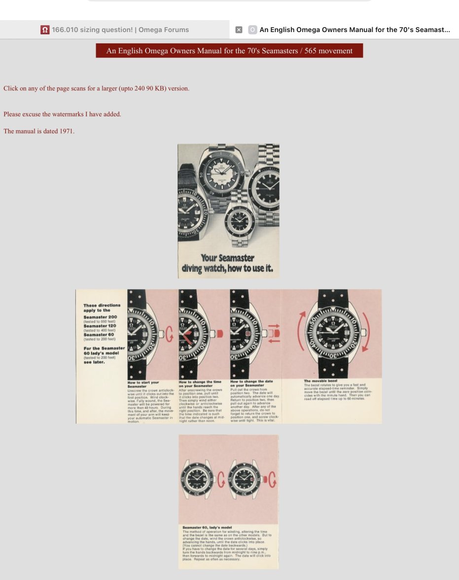

My wrist isn’t much bigger than yours; there should be plenty of room to choke up the 12 o’clock side by moving the pin a few holes closer to the terminus of the 6 o’clock side. Then again, I favor a louche, dangly bracelet style on my watches. I’m thinking of growing a mustache.
Assuming it has a 565 movement, it is a quickset. You pull the crown out two clicks and push it in fully to advance each date.
I believe you also need to take care to engage the quickset only when the hands are not between the 10 and 2 or thereabouts; the mechanism is prone to jamming otherwise. When you set the watch, roll the hands to about 3:30AM the next day, use the quickset to get to the right date, then set the time. If you’re as obsessive as I am, the first step is to gingerly hold the watch as still as possible until your phone’s seconds hand is synced with the watch’s, then wind it up before rolling the hands out of the way, setting the date, and finally setting the time.
It may just be that I’ve been extremely lucky but that’s never happened to me with my 565s.
I’ve looked online for a movement manual. This is the first manual I came across.
http://www.old-omegas.com/sea71-565.html

I would say you pull it one click to the setting position and then once more to advance the date by one day. You won’t push the crown all the way back in, but rather advance one day at a time with each additional pull while the crown is in the time-set mode. In other words, the crown returns to the pulled-out-one-position setting mode after each tug to advance the date.
9,256
77,115
Oh--that's really interesting! I've never heard of that system. Do you mean: when you push it back in, it automatically advances the date, or do you mean: after you push the crown in, you can advance the date?
If that latter, how do you get it back in winding mode?
I hope all this makes sense!
Thank you!
Chris
This is the link I posted earlier. “A picture is worth a thousand words” 😉
