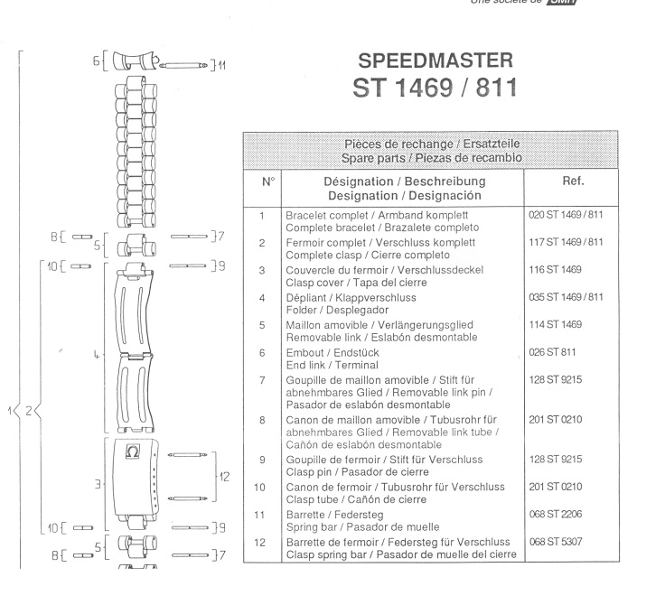

Hi
Need pins&tubes for 1469 links.
Can somebody tell me what are correct ref numbers for pins&tubes
I need 10 of each and I am trying to find Omega set package x10pcs but I wish to be sure about reference number.
If anybody here have them for sale, or can point me in right direction, let me know
Thank you

Removable link tube 201ST0210
Removable link pin 128ST0915
Note the pins and tubes for joining the clasp are not the same.

excellent, thank you!!
edit: according yours ref numbers I have find this one:
