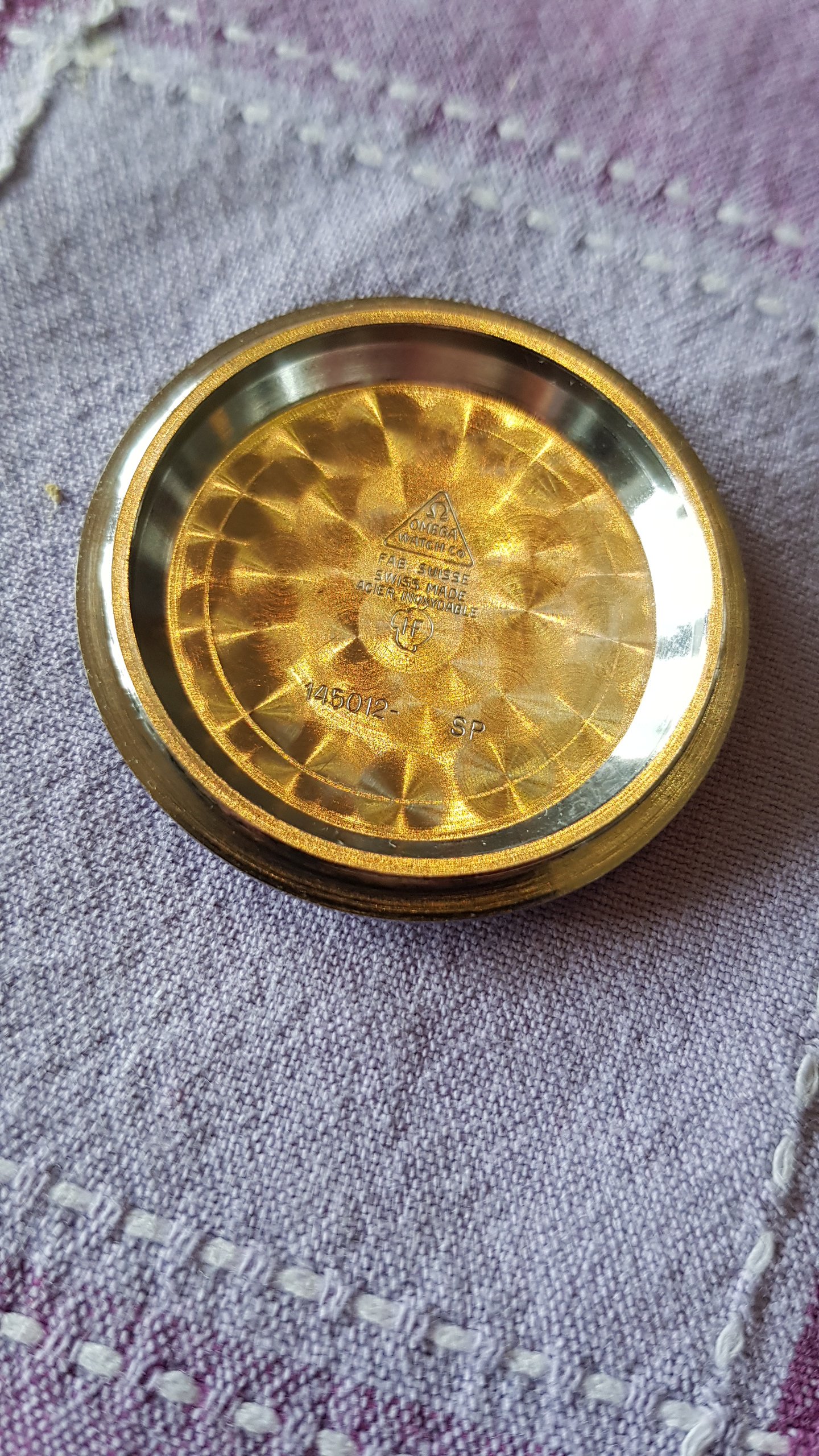

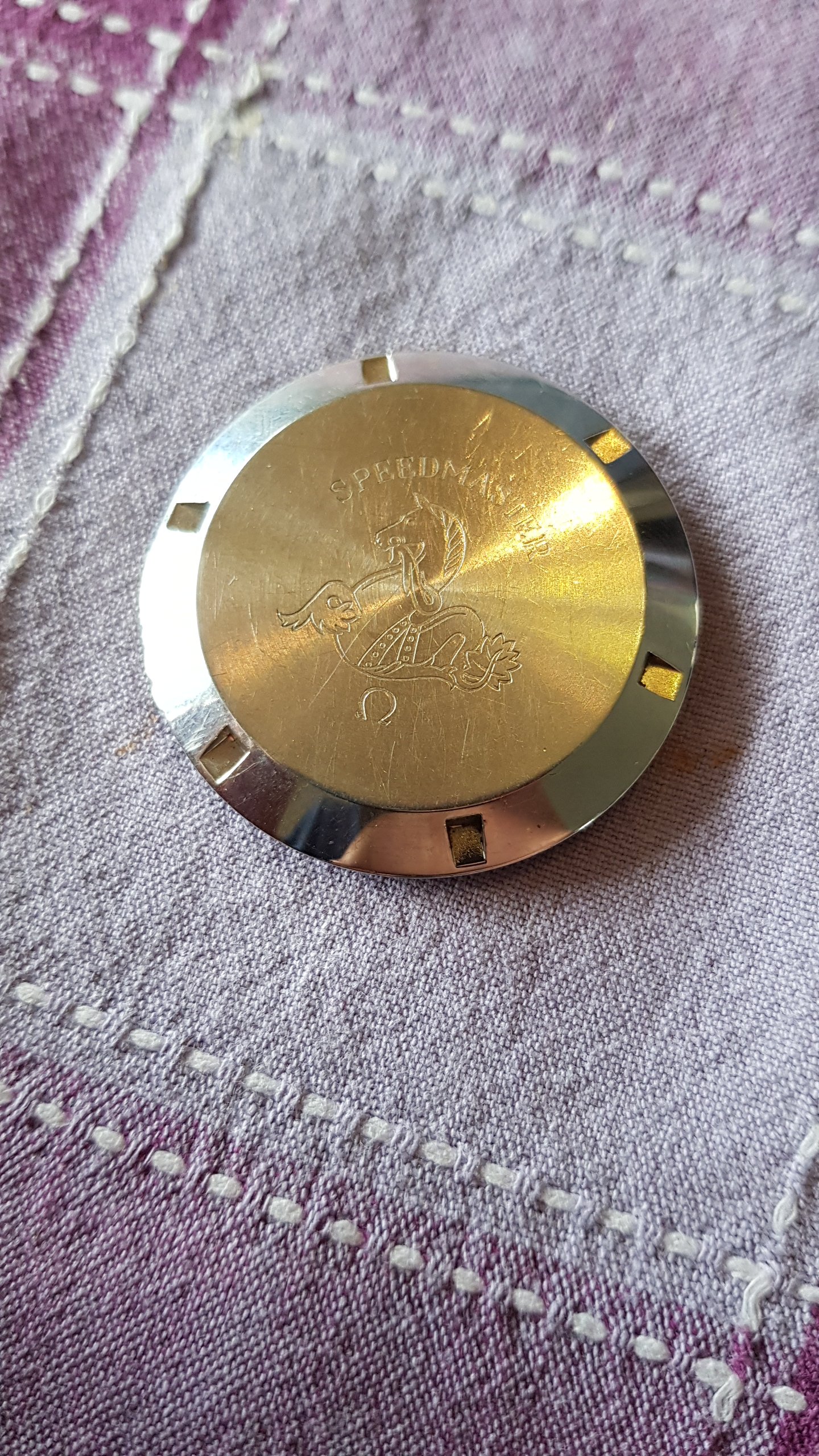

    Hi
    Can someone tell me why this caseback doesnt have no 67 (or 68) stamped on the caseback?
    I was looking on the forum but cant find any thread.

    I believe you have yourself a service back. It’s authentic but not original to the watch.

  4. Varnado Mar 19, 2019
    388
    565
    I would second the service caseback opinion. I have seen similar but, I cannot be certain if they were identical.
    Notice the elongated notches on back used to remove the caseback. Much longer than the originals, in addition to the different engravings.

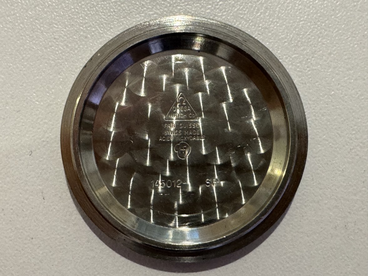

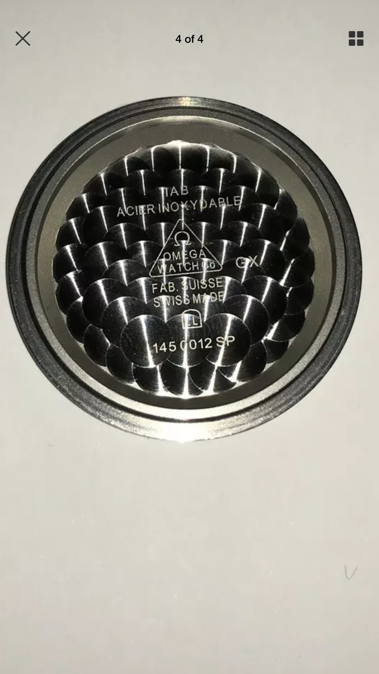

  5. SpeedyPhill Founder Of Aussie Cricket Blog Mark Waugh Universe Mar 20, 2019
    5,844
    10,883
    I happen to be at a friend, checking out a few things while Omegaforums.net is on his computer... so we couldn't help to check his large collection of old & service casebacks and the only similar Hippocamus he has , contains as a last line on the inside 145 0012 SP

  10. WYO_Watch Mar 21, 2019
    1,219
    3,766
    I guess “similar” was too strong. Does it remain a service caseback?
    I can imagine some backs didn’t get stamped with a date, but have a hard time imagining they found their way on to a watch leaving the factory.
    @Igora You could always shoot the seller a message on the piece you found and see if he has any info on the back?
