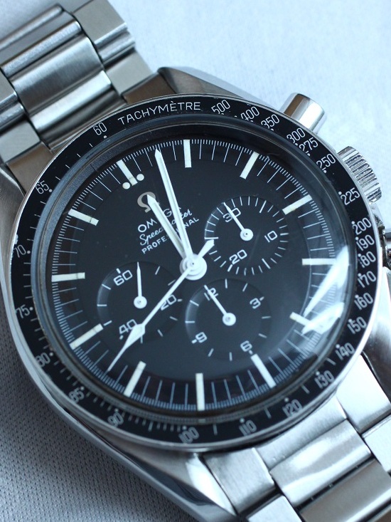

    I recently have gotten the opportunity to purchase a ref. 145.012 – pictures to follow below..
    While the asking price is very high, I have been told that this watch is “all original”. This claim seems generally consistent with my own assessment based on my research from online sources.
    Would anyone be able to point out where there are possibly replaced / unoriginal parts?
    My concerns in particular:

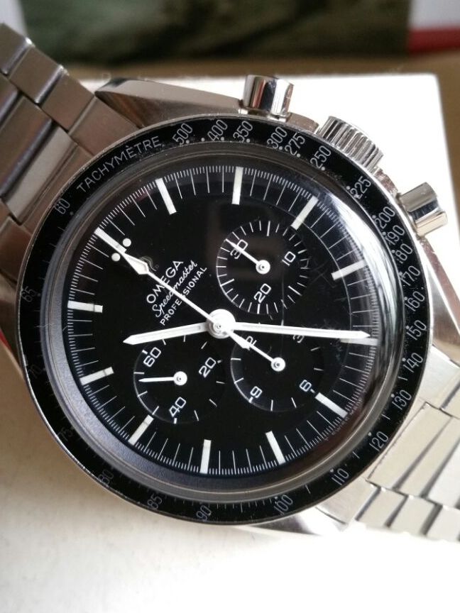

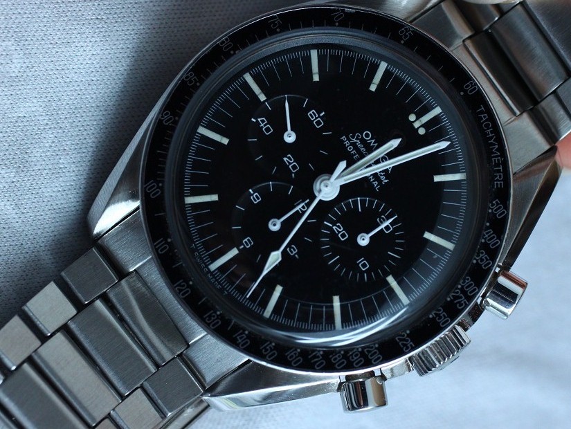

    1. Hands Seems correct for this reference (or am I wrong?) although the hands are really, really white – which leads me to suspect that the hands have been replace – any opinion on this?
    2. Crystal – I understand the original crystal would have the Omega etching under the crystal – will this be true? I am unable to tell from current pictures

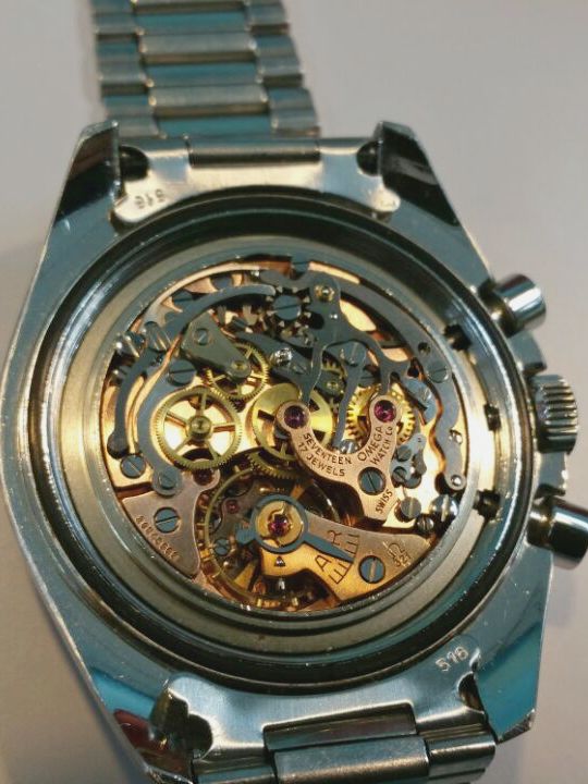

    3. Movement – Inconclusive with current photos
    Any opinion and other general advice would be much appreciated!

    I will comment on hands only: I have never seen hands on a 145.012 as white as bleeched teeth and original!
    richardew and Spacefruit like this.

    Dial must be a replacement! It's shining like a star;)
    Movement looks good.
    Check the movement number if it's fits with manufacture date of the watch.
  4. powerfunk Jan 7, 2015
    10
    Yeah those hands look just like the fresh new luminova service hands on my Speedy. I actually like the crisp white look, but all- original? Seems doubtful...

    What is the moveement number, can't read it.
    Looks like it's in the 30's
    and that's not good

    Now see it 145.022, so 30's is OK

    Looks like 26mil to me. It's cal. 321 so can't be 145.022.

    Hands are definitely too new to be original. Dial does not look as new as hands, but still quite new and is possibly earlier replacement. Bracelet has been brushed up recently also. May be a good wearer, but price should reflect the non-original parts.

    When it's a 145.022, then should be a cal. 861 in there and should be another second hand (a flat one)

    Yes I guess my suspicions on the hands are correct.. I've never seen such gleaming white hands myself either!
    On the dial, would you mind elaborating more on how it may not be original? I take your points that the dial looks too clean and new. Anything else wouod point to a replacement dial?
    On a seperate note, would a NOS dial look as clean as in my pictures?
    Thanks!

    I would say the dial has lost all its lume and there is just the white paint of the 5min markers left.
    Hands are service replacement.
    Bezel looks great thou.

    I think the dial's lumes are still there. It could be the picture's exposure and white balance that caused them to look white-out. I'd lean toward the dial is either good shape original or early, not recent, replacement.

    Replacement or NOS....
    I think on a NOS dial, the lume would be more a kind of crystals and a little bit yellow..
    The lume on this dial looks like glue....so i think it's a replacement....

    Still believe its just the white paint you see, the lines are too sharp, the only lume that is left is the one on the dots at 12 o´clock.
    They still look a bit more "3-dimensional" as the rest of the indices, they look flat.
    Also you can see the t swiss t at 6 o´clock

    Bit hard to be sure from the photos, but the dial lume looks two dimensional i.e. lume removed and just painted dial plots remaining

    On the 2nd picture, they look quite 3-D from 7 to 12 to my eyes. Early replacement would still have the Ts also.

    I agree the lume's been removed, my old 145.012 was like that, its just the paint on the dial underneath imo

    Thanks all....I've been staring at the pics intently for the last 15 mins trying to understand what you all mean about the lume.
    What are the implications (1) on dial originality and (2) on the watch in general, if the lume had been removed?
    Correct me if I'm wrong but the removal of the lume isn't really indicative of anything....is this the right understanding?
    On the other hand, if the lume can be clearly identified on the 5 min indices, we would then have to assess the lume application e.g. if its reapplied or aged nicely....?
    And finally, if the lume is aged nicely, I guess that will point to a possibly original dial?
    Thanks!
  20. sulaco Jan 7, 2015
    597
    405
    If the lume is still there and aged nicely, it increases the price.
    if the lume is scratched off it decreases the price.
    if it is a vintage replacement dial without lume it decreases the price.
    If it is a modern service dial it decreases the price siginficantly
