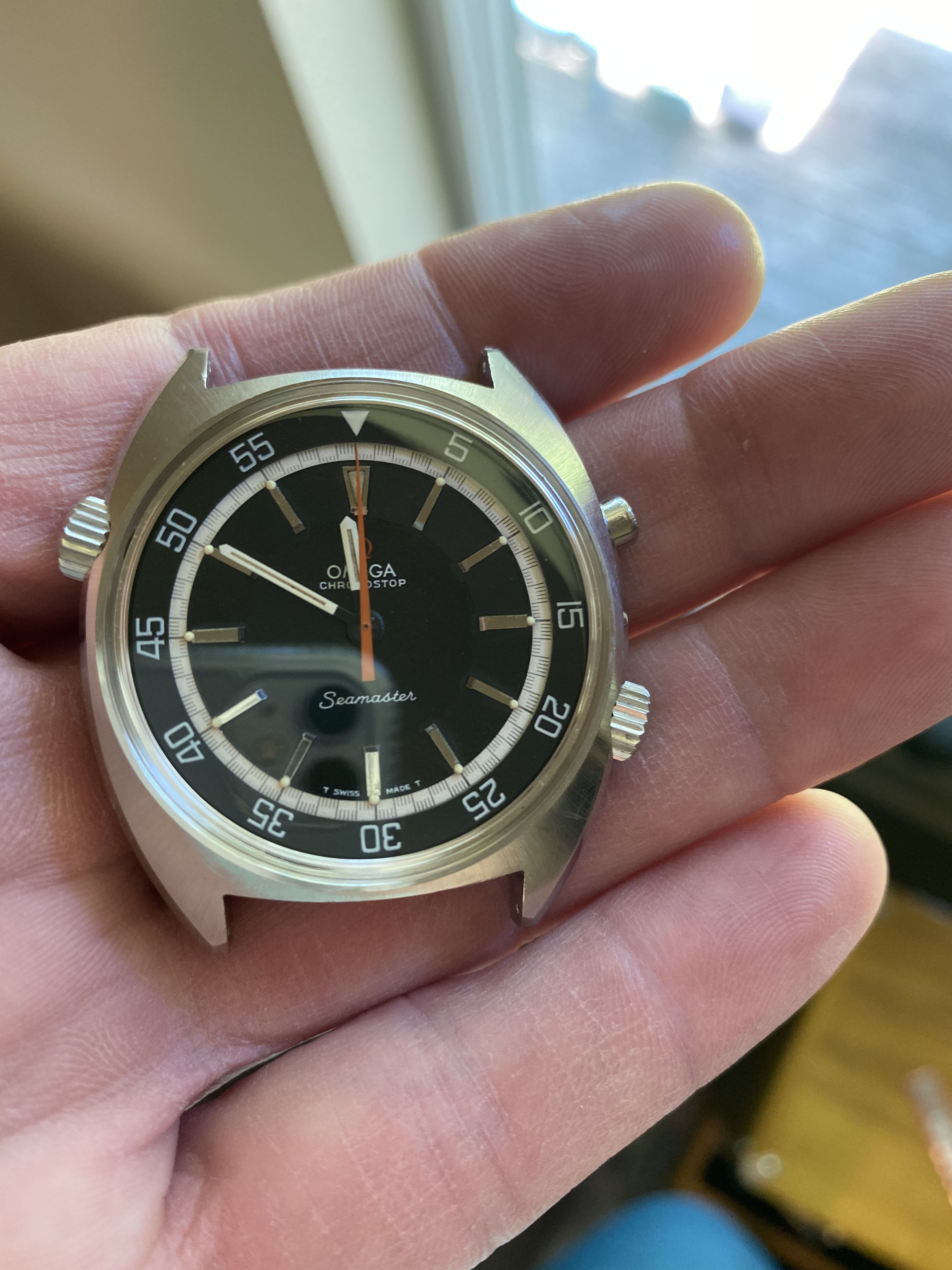

Hello,
After admiring for many years, I recently purchased a 145.008 Chonostop Caliber 865. It is a project as I knew it had a broken mainspring and needed service. Its in very nice original watch in beautiful cosmetic condition. However, it arrived with a destroyed hairspring that was not discernible in the pictures.
I am now in the hunt for a replacement. In my search it seems that a balance complete is the likely path, but I would be open to a complete assembly (balance, hairspring, bridge).
I haven’t had any luck with the usual suppliers or eBay. I am a hobbyist and have no professional accounts or affiliations. Any advice on used parts suppliers or other resources for the 860/861/865 family of parts?
Thanks in advance.
Paul

Just a follow up. After weeks of searching, I located a complete balance (balance wheel and hairspring). I was able to replace it and get the watch running well.
One complication - the hairspring had a round end on it instead of the triangular end. I was told that this was an update made over time for this series of calibers. This created the need of careful fitting to get the angle of the hairspring correct once the screw was tightened holding the spring end in the balance cock.
The good news is that the watch is running very well. It was a a challenge to source all of the parts without access to Omega, but I was eventually able to find OE crystal, mainspring, balance complete, and case gasket. I love the watch and am surprised by its overall presence. An underrated watch in my opinion.

Well done 👍
That’s one of the cleanest example I’ve seen of this reference

An absolute beauty!
I believe this is the first time I have felt that over a chronometer. Not usually a fan.
