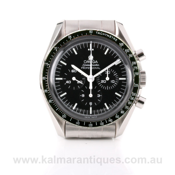

    Wth are they talking about with 864 movements.

    Ok, this is obvious, but there is so much wrong with this it's not even funny. Let's see if we can make up a list shall we?
    Modern Superluminova service dial
    Modern Bezel
    1863 movement (metal vs delrin brake)
    Modern 1171/1 w/633 endlinks
    In fact in all ways this looks exactly like a bog standard 3572.50, but without the display back and a replacement bracelet? Obviously they don't show the inside of the caseback but that's not an 864 movement, or if it is, it's in the totally wrong case/dial combo.
