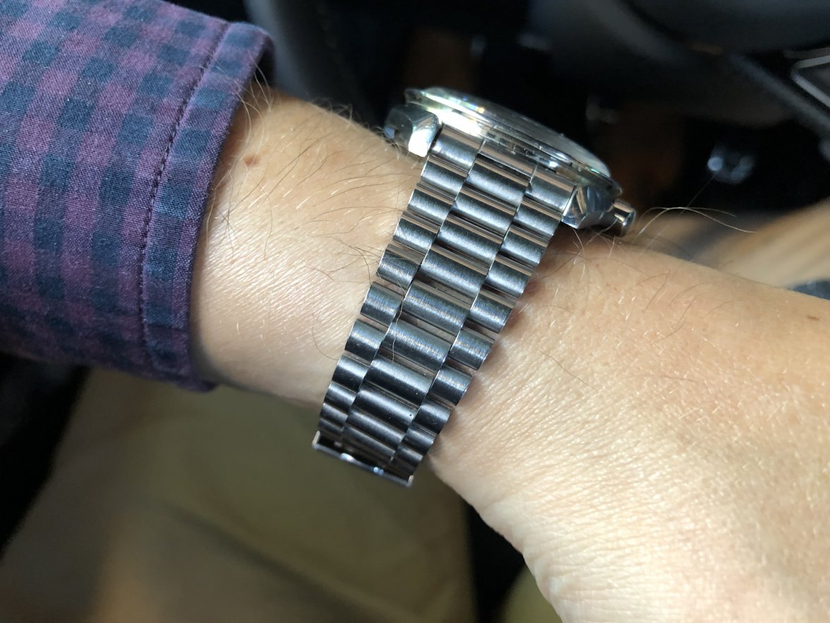

But my understanding is that the 1447 has smaller, and thus more, links, so is a bit slinkier and more comfortable.
2,078
9,718
Never wore one so can't speak of the comfort but I believe the only difference is that the 1447 tapers in at the clasp.

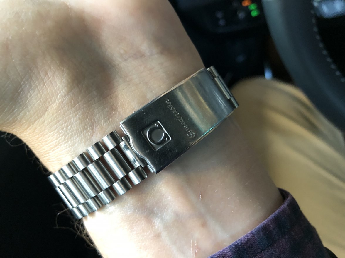

I've not been able to find any links for the 1447 in the last several years of looking, I dont think they are even available from Omega because I asked a reputable source and they were not available. I have a spare 1447 clasp though, which were available.
The 1447 has smaller links than a 1450 but I havent noticed that my 1447 is any more comfortable than say a 1171, which is not dissimilar to the 1450.

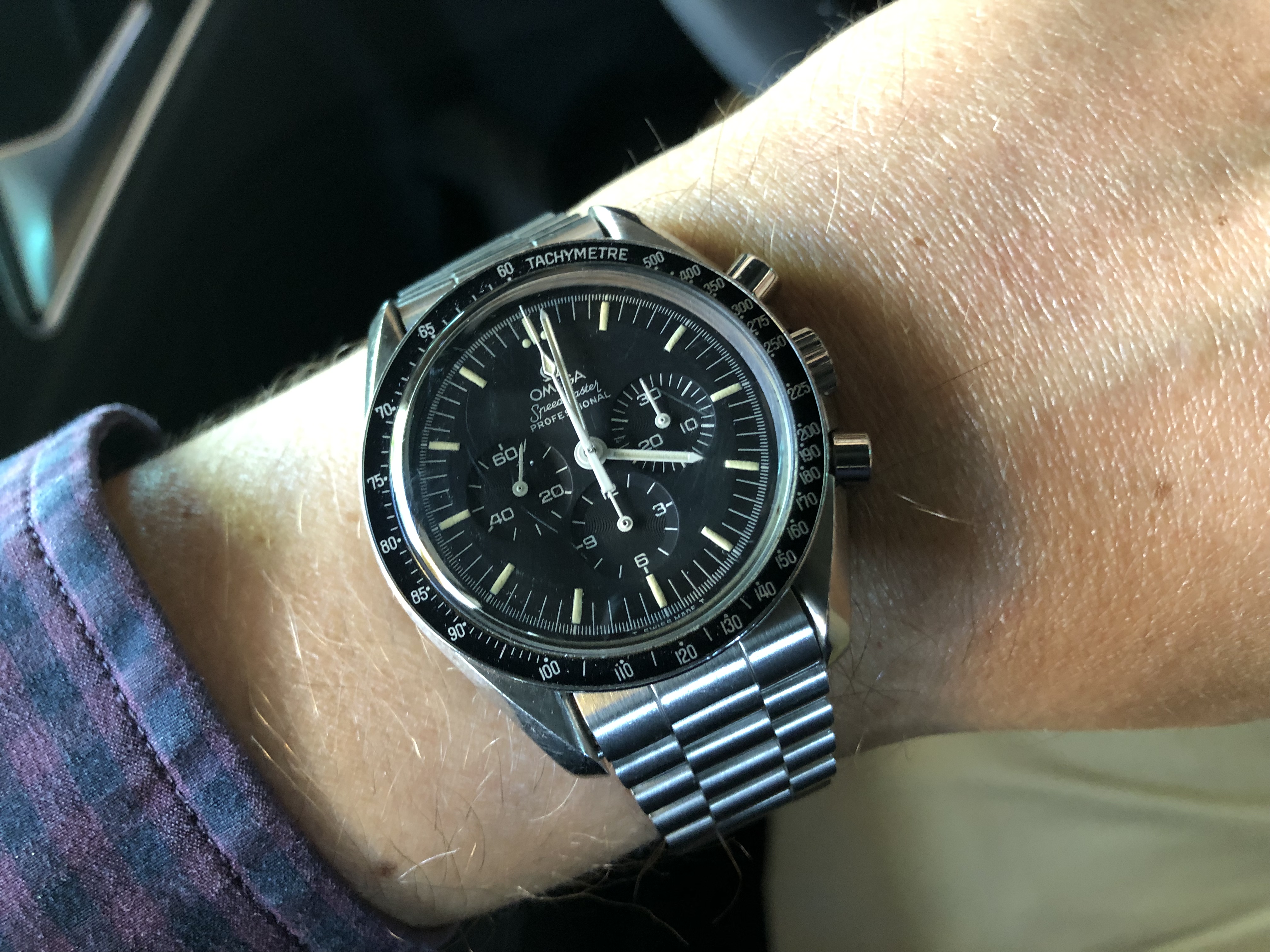

Wearing my birth year 1st gen 345.0808 on 1447 today :
They say there’s no coincidence 😀

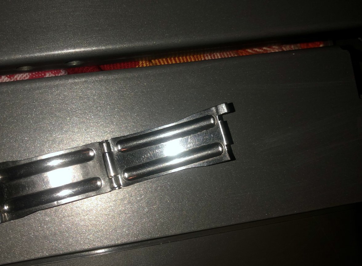

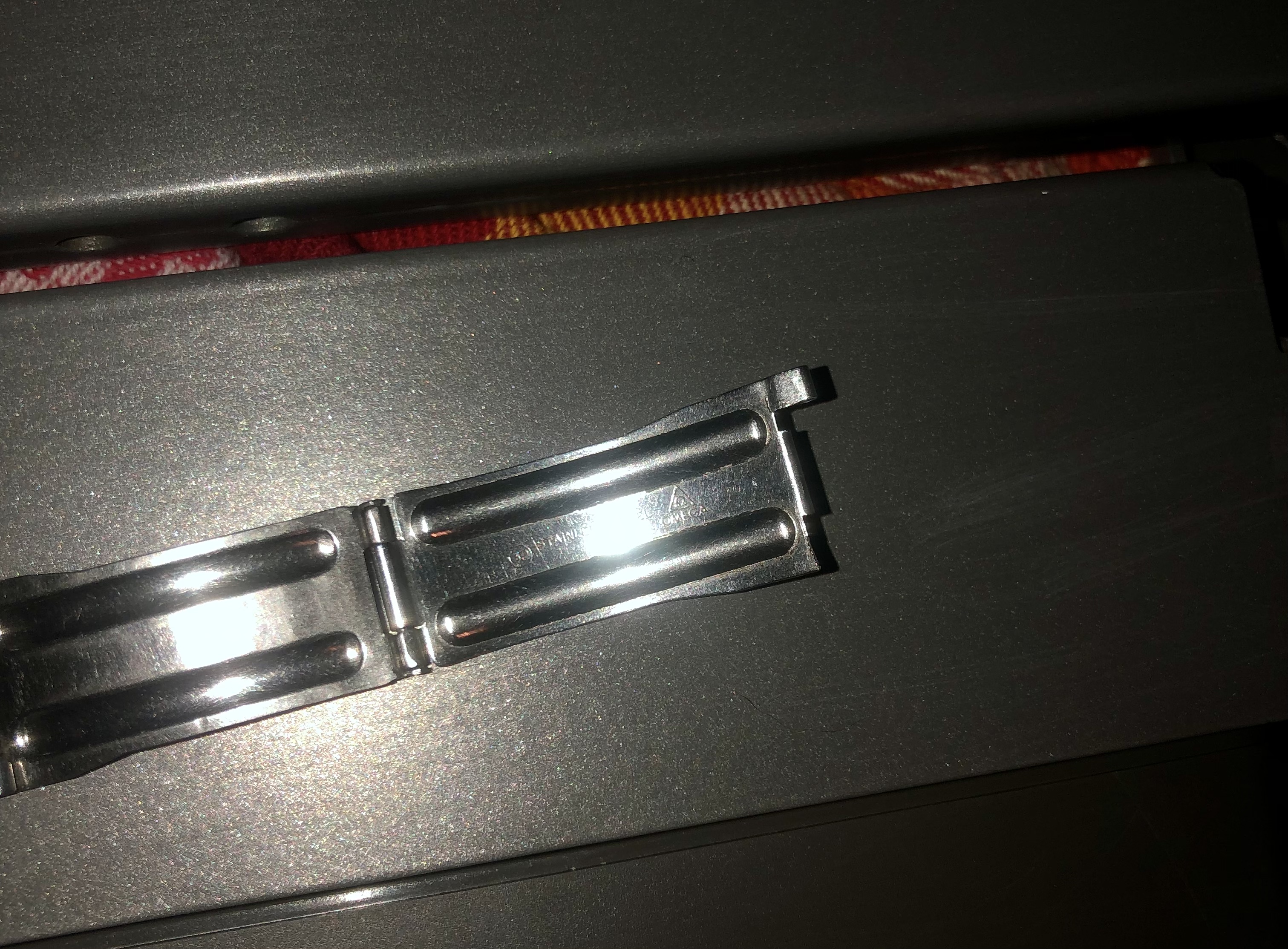

I guess this not repairable

Tell me about it
But I will think of something

Thank you for your reply
I understand !
You could try having that laser welded. I've had this done on a few things - here's a clasp that is about to fail...
After the repair...
It's a strong as it was when it was new. Now yours is a little more difficult already being broken, but if you have the two corresponding parts, I would take it to someone with a laser welder (goldsmith is most likely) and let them take a look. Here's anopther repair...battery spring on this watch had come off the cap, and someone had tried to glue it on...
Had the clip laser welded back on...
Worked great...
Cheers, Al
