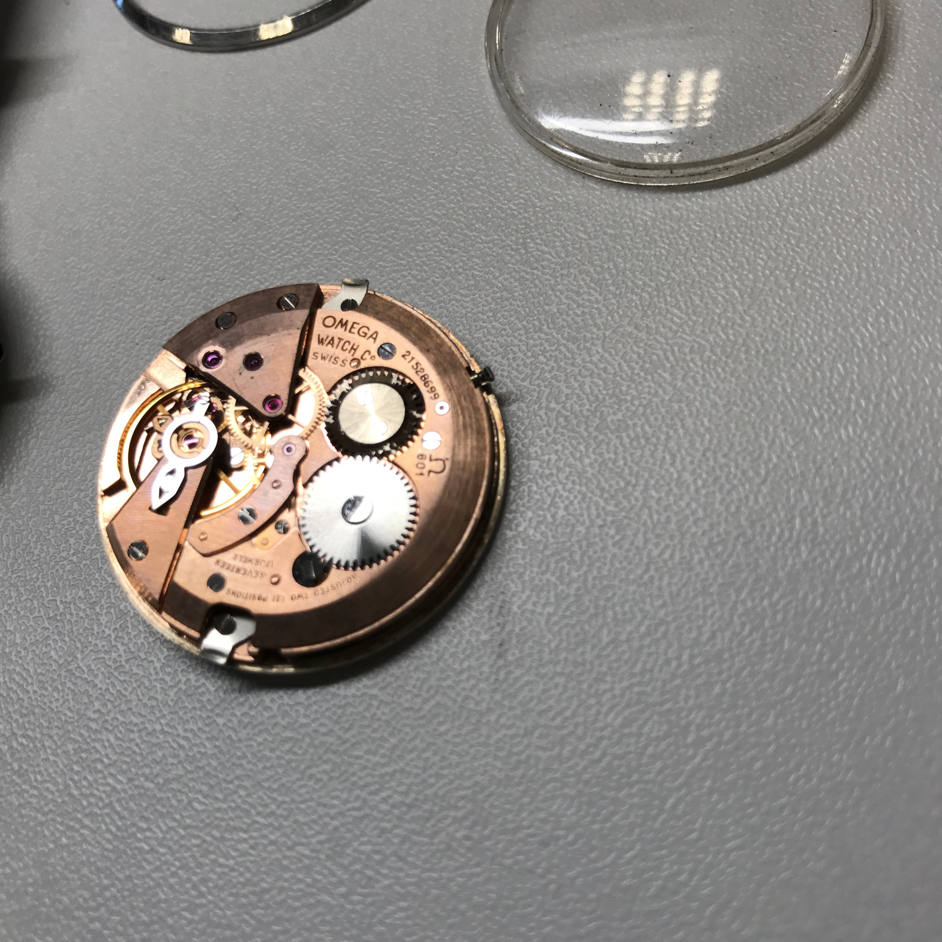

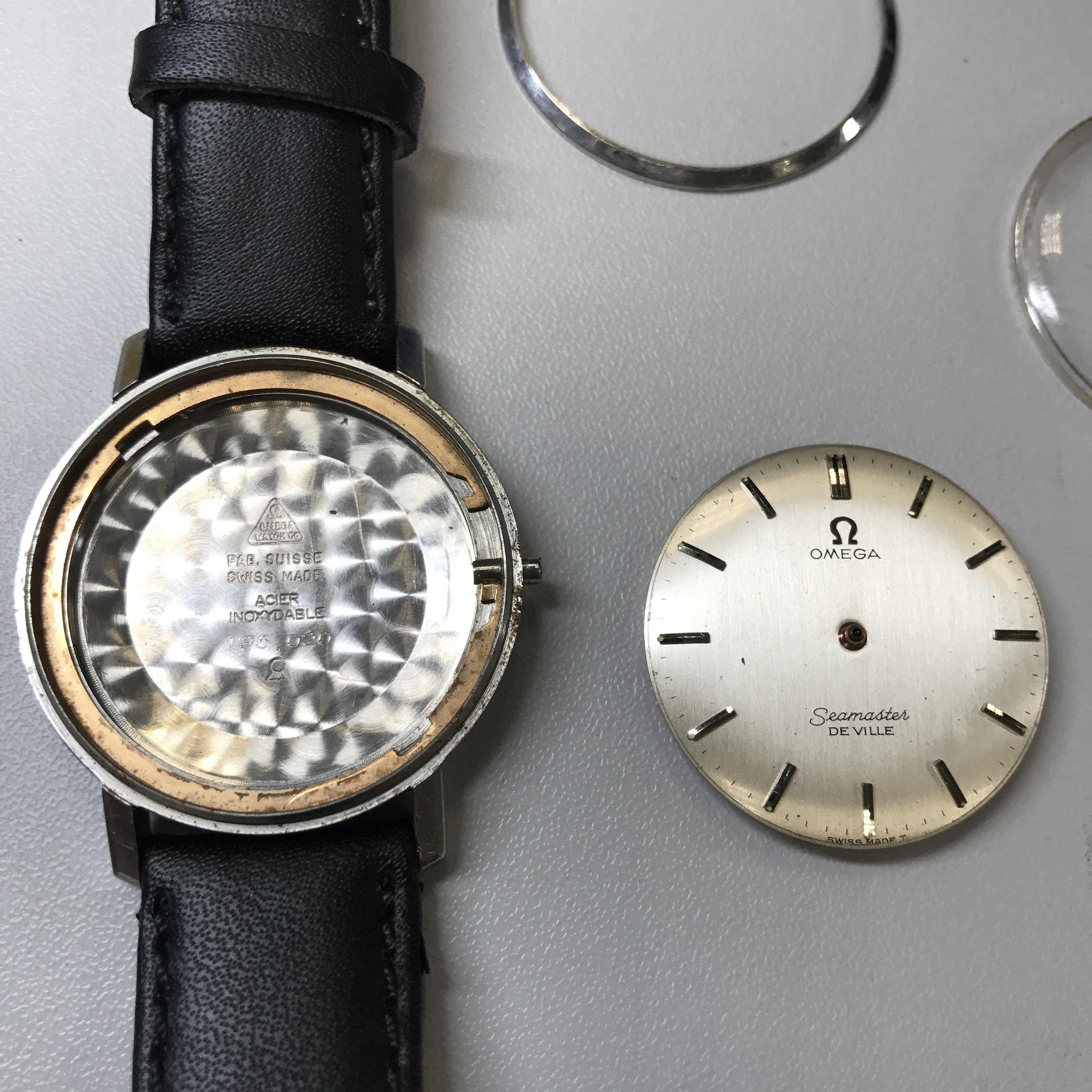

  3. Bigbnl Nov 29, 2016
    Sorry i thought the model number in the title should do it, but you are right.
    let me know if you need anything else
  4. JimInOz Melbourne Australia Nov 30, 2016
    15,491
    32,381
    :oops:
    My fault for not reading your post.
    The crystal you need has a silver tension ring and it's pressed into the bezel which is then pressed on to the case.
    The Omega Part Number is PZ5072.
  5. Archer Omega Qualified Watchmaker Nov 30, 2016
    26,463
    65,604
    063PZ5072
