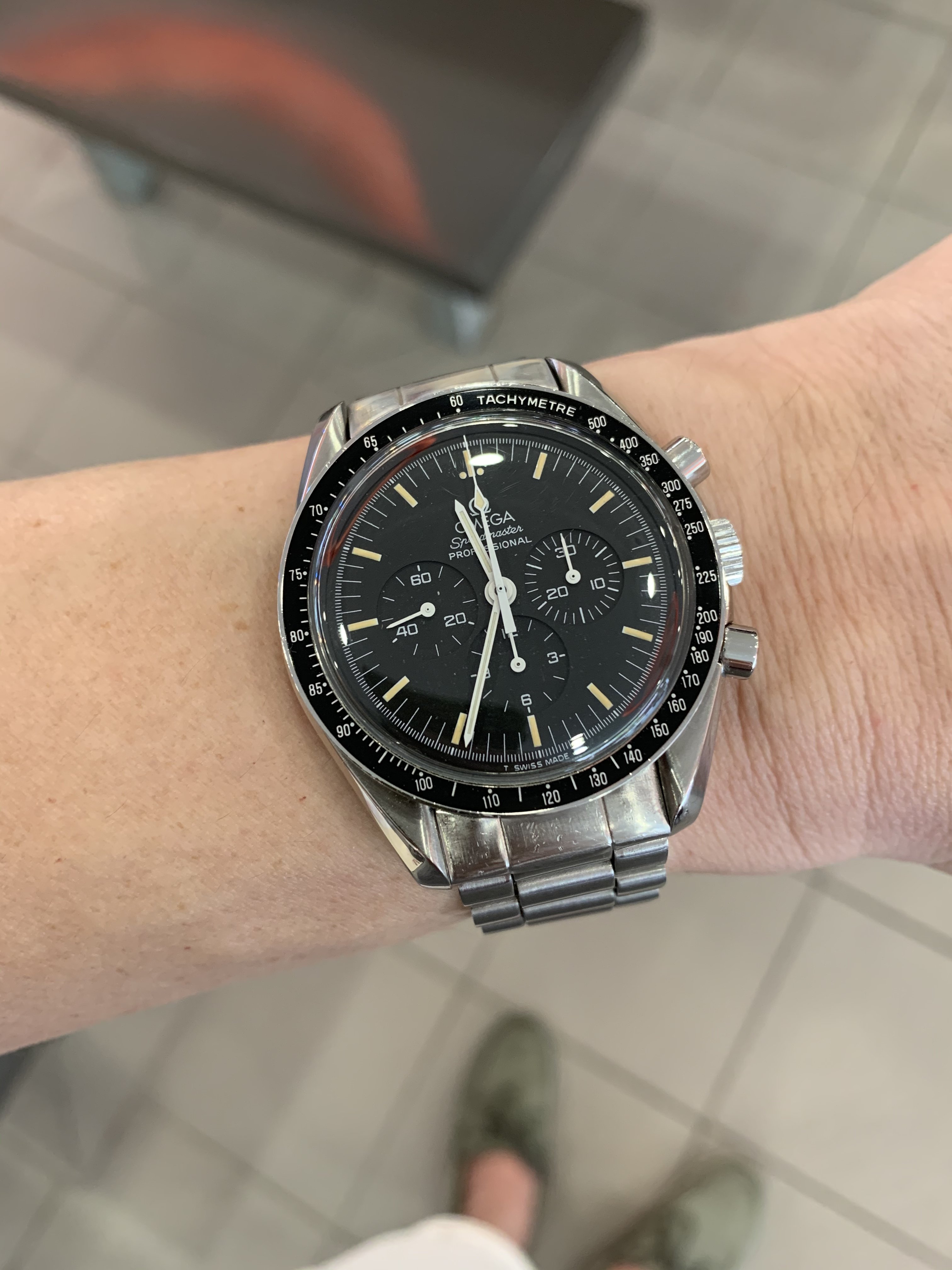

·This is more of a reference for anyone looking to fit this:
Found a nice original 1171 (11), trapezoid logo, with 676 endlinks (these are specific to I guess 166.128 and 166.129). I hummed and hawed but being in canada it's hard to find a 1171 and I really wanted a nice original bracelet so I said sure, assuming i might have to buy endlinks.
Reading on here and elsewhere, the consensus was that these do NOT fit, I found they fit nicely enough for me, and offer a neat aesthetic. I'll be sourcing a set of 633's to compare but I do like it! They fit the case of the 3570.50 very well. Note, these were all NOS items so I'm unsure if these have ever been bent, but under the loupe it did not appear that they were filed. The two endlinks I got were not exactly identical so I'm assuming there are some variations.
So for anyone on here looking these are a nice option, required a touch of filing (just to make the ends easier to fit) with no changes in contour). The difference from my perspective is that the top of the end link isn't flat, and it sits taller than a 633 on average thanks to this. I like the effect.
