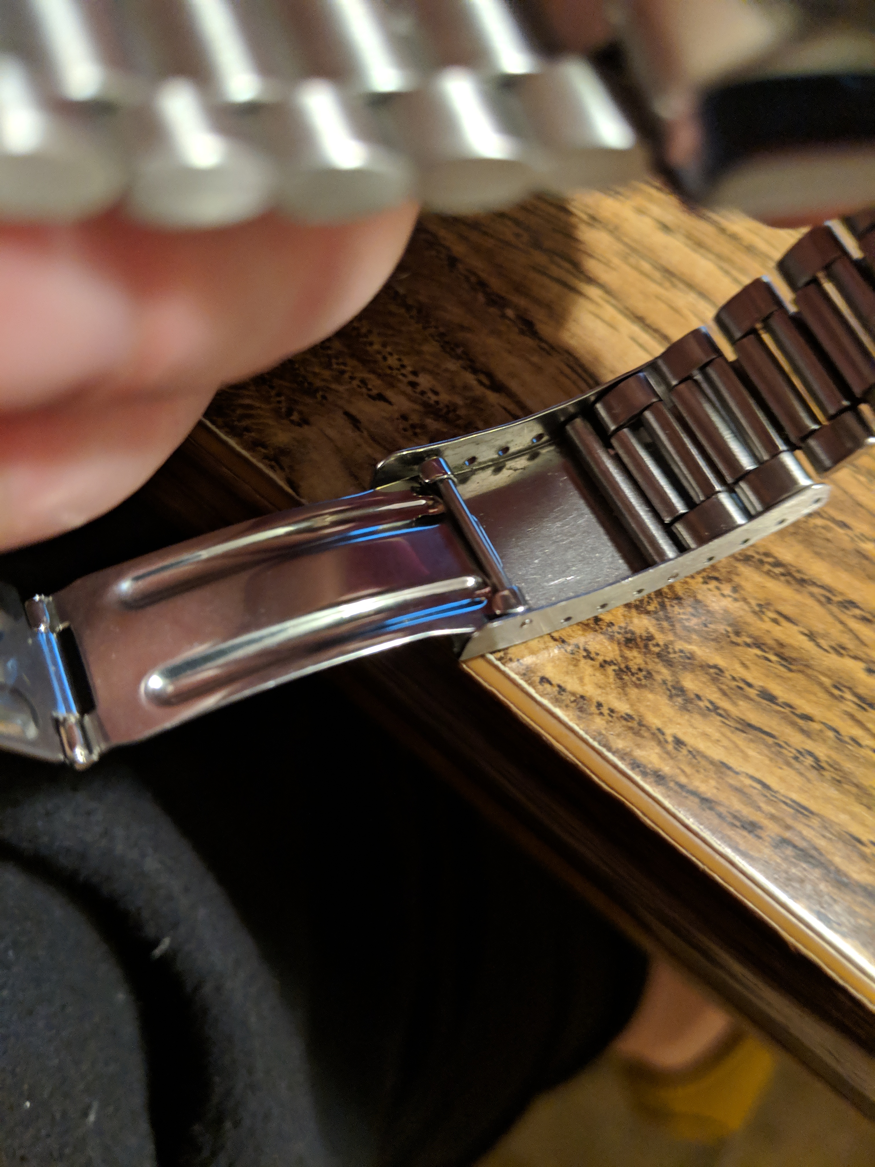

    i got this bracelet for my 3570 speedy. i think it looks better and is more comfortable than the 1998 style. however this f'er has popped apart twice on me now. once when i bent my wrist awkwardly to hit my garage door opener, causing speedy to fall to the concrete dinging the lug. and again just now i was sitting on the floor and pushed myself up flexing my wrist.
    its coming undone where the stamped part of the clasp hooks to the bar, right next to and underneath where you'd use your fingernail to undo the clasp. idk if i can wear this bracelet with confidence anymore. thought about taking a pliers to it and squashing down the little hooks that go over the spring bar.
    anyone else have this problem? would really like to keep wearing it but im afraid the next time it pops could be really bad. i feel like im wearing it right not too loose or tight. unacceptable from omega.
  2. bigwalleye Dec 16, 2018
    9
    9
    heres a pic where its coming apart if i wasnt clear. where the bracelet hooks to the clasp

    thanks for the comments, i can try bending it like it suggests in the video. dont really want to wear it any looser but if i must...
    anyway again... maybe i wasnt clear enough. its not the clasp popping open, the whole bracelet is coming apart in two. the piece with the 2 little hooks its coming off the springbar
  6. Archer Omega Qualified Watchmaker Dec 17, 2018
    26,342
    65,045
    No that wasn't clear - then yes you need to close up the loops.
