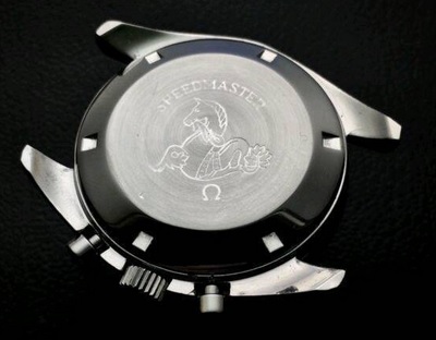

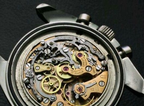

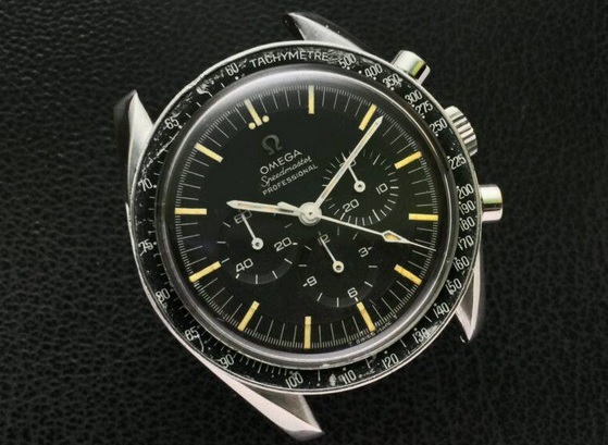

    This 105.012 is for sale for EUR 3500... (not by me)
    case looks heavily polished ...
    Movement not clean though stated as working properly.
    I yet have to get the movement number.

    The bezel on it is probably worth almost half the asking price by itself
  3. Puma Feb 10, 2017
    74
    213
    the bezel is not quite as nice, but the dial gets me though it could be a relume...
  4. fibonacci086 Feb 10, 2017
    779
    3,598
    Dial is nice and looks like to be an early one with higher Ts.
    Not sure if this is possible with a 66
    No lug facets which is a big downside for me

    im only concerned on the supposed faceted lugs w/c might have been heavily buffed to smoothen the edges. otherwise, the engine just needs a little tlc.

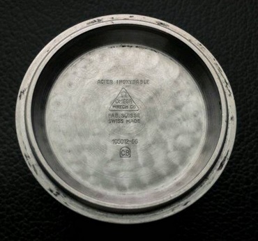

    Might be a 105.012-66HF with a CB caseback. What is the movement number?
    marturx likes this.
  7. Puma Feb 10, 2017
    74
    213
    ok, got the movement number 254... seems correct for that case number

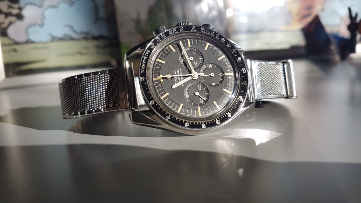

    this babe 20170128_111256.jpg was "cheap", but not like 3,5 or 800 cheap. I think that's just :)
