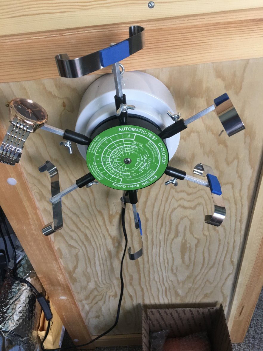

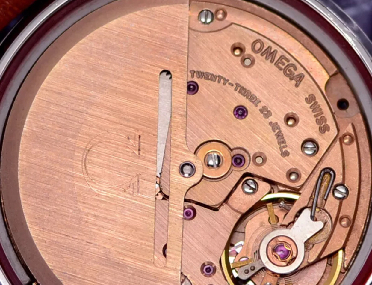

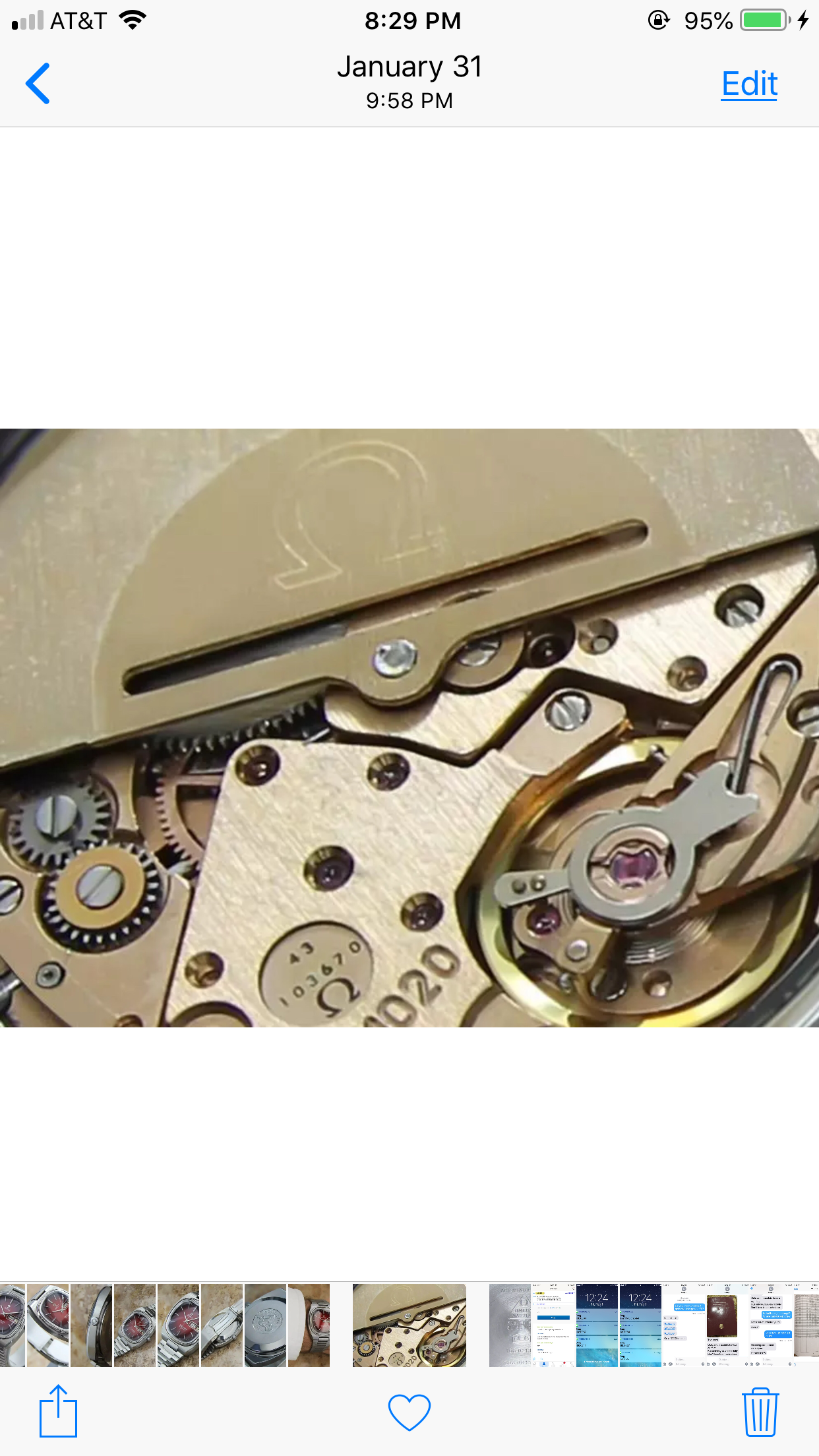

    Is there anything other then the rotor not turning freely in case that could cause it not to auto wind. I’ve tried two types of winder BD17F80A-1CD2-4B14-A053-0125A50F7754.jpeg
    E343FC13-CCE1-4365-9644-EFDF6BE77CFF.jpeg 39BFB8F8-11B4-45E2-8D7E-C6802ECCED3C.jpeg

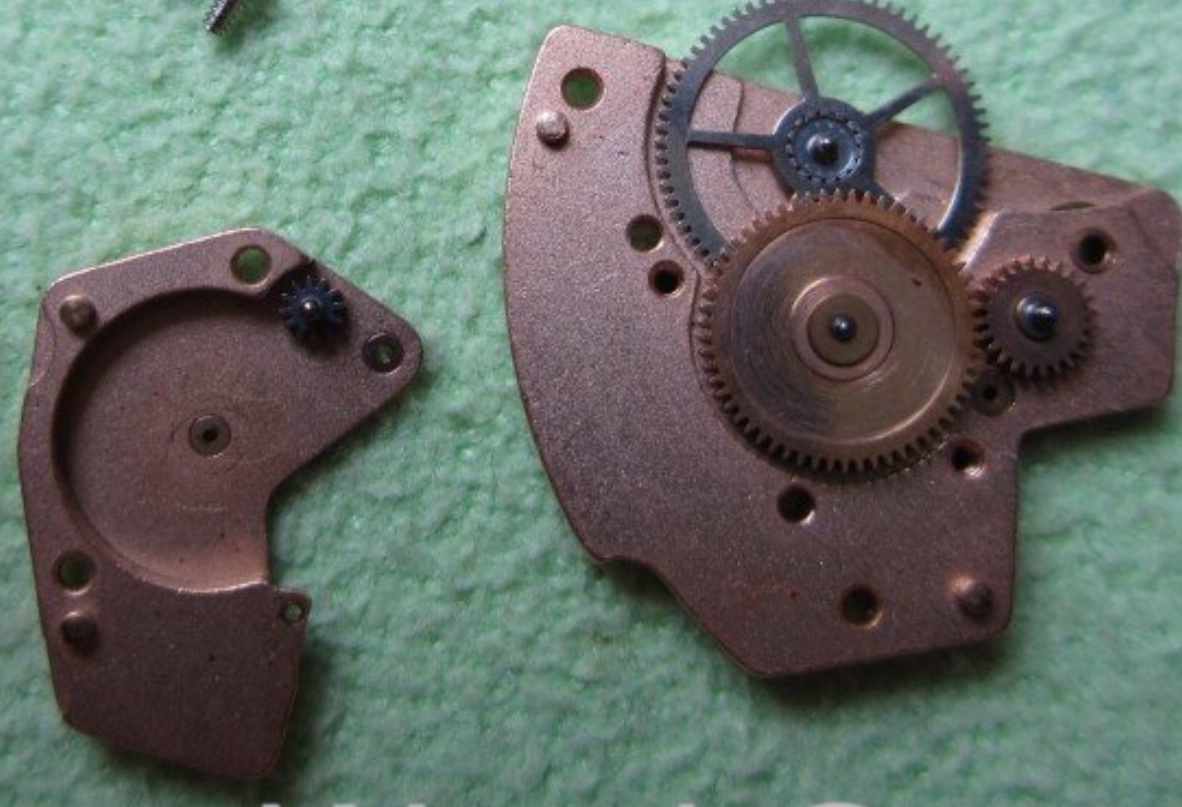

    A NOT completely restored piece, sounds like. Two options. Take it somewhere and get someone to fix it, or return it to the guy who supposedly fixed it. On this movement, the ratchet wheel fits beneath the wheel that drives it. Someone who is not familiar with this movement might well have positioned the auto wind unit so that the ratchet wheel is ON TOP of the gear that drives it, and buttoned it down. Worth a look.

    I took the rotor off, center bearing, auto bridge and just took a tiny bit off the two screws that hold the auto wks together. If this doesn’t wk I’ll strip clean and reassemble it. I was mindful to slip the gear inbeteeen the others when putting the bridge back on. The rotor seems to be free now . I’ll give it a try before taking the gears apart
