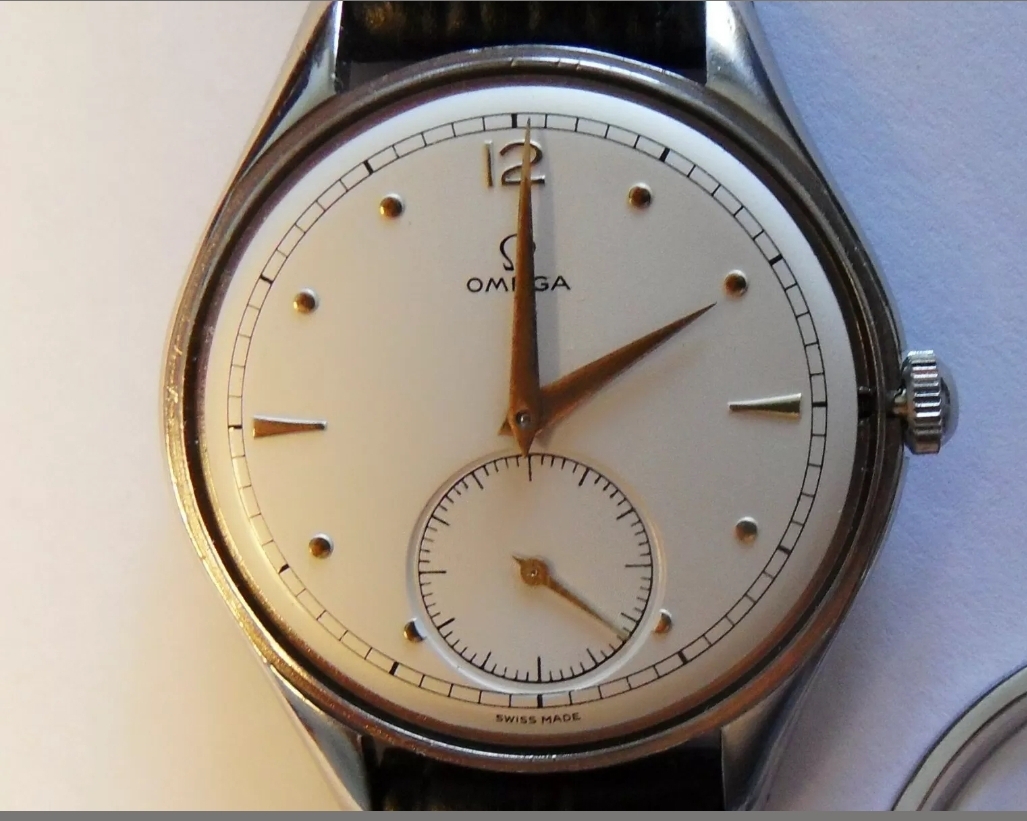

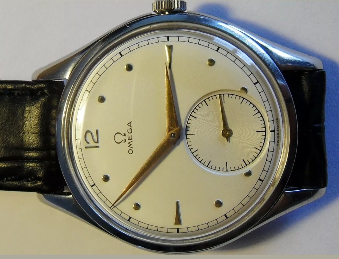

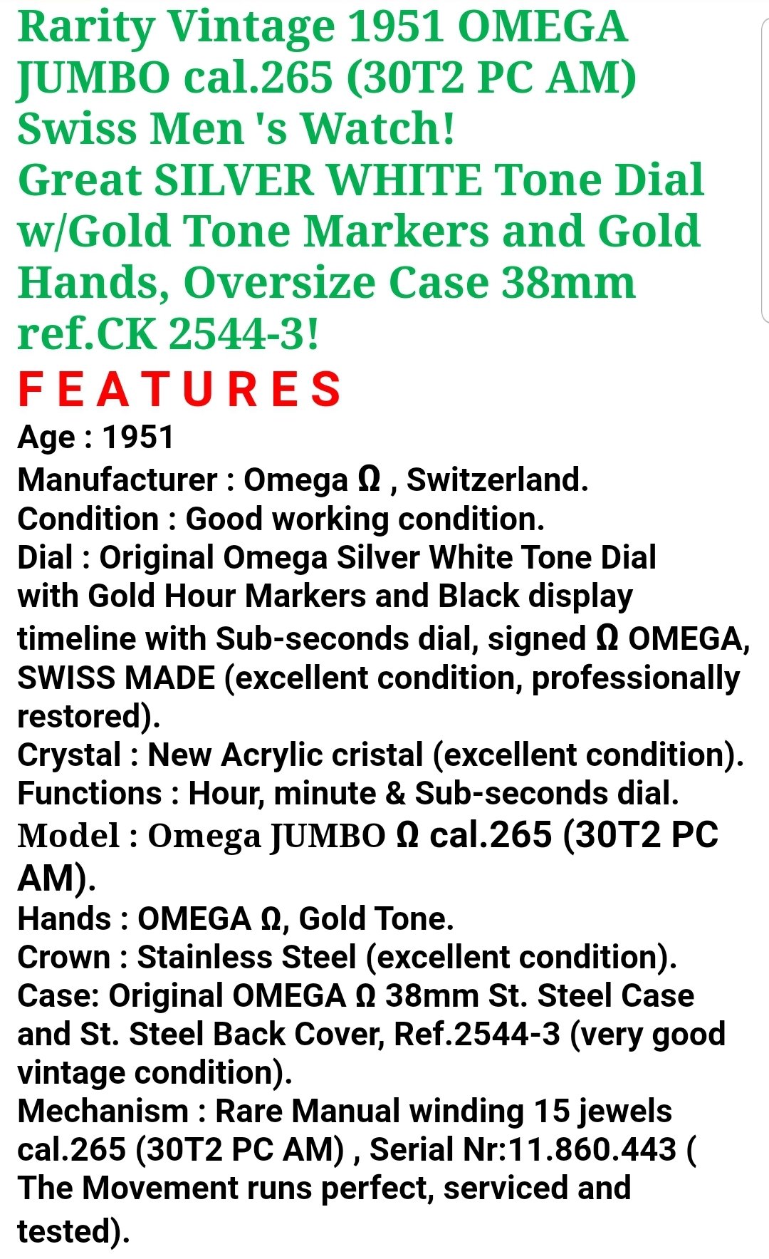

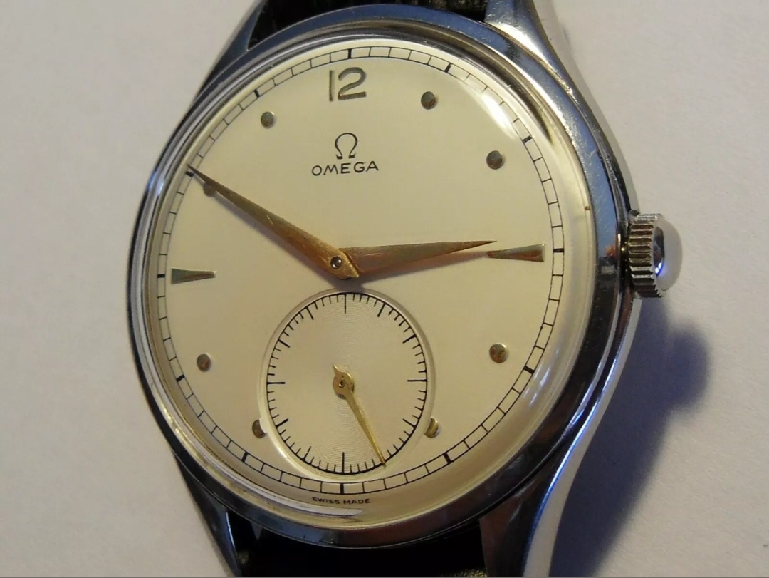

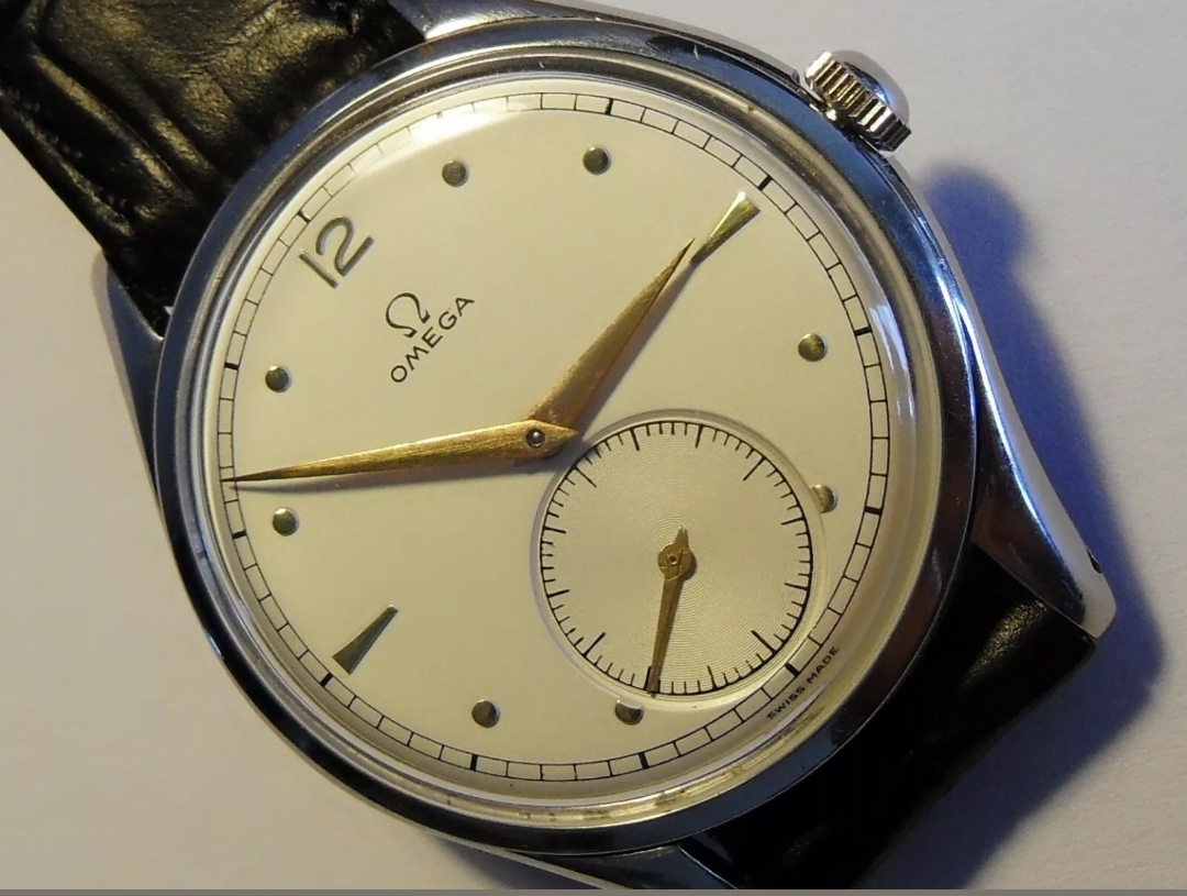

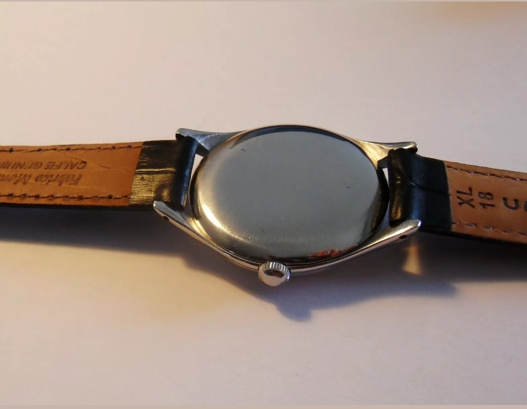

    Hello, I would like seek input on the purchase of this watch listed @ USD$909 which is also opened to offer.

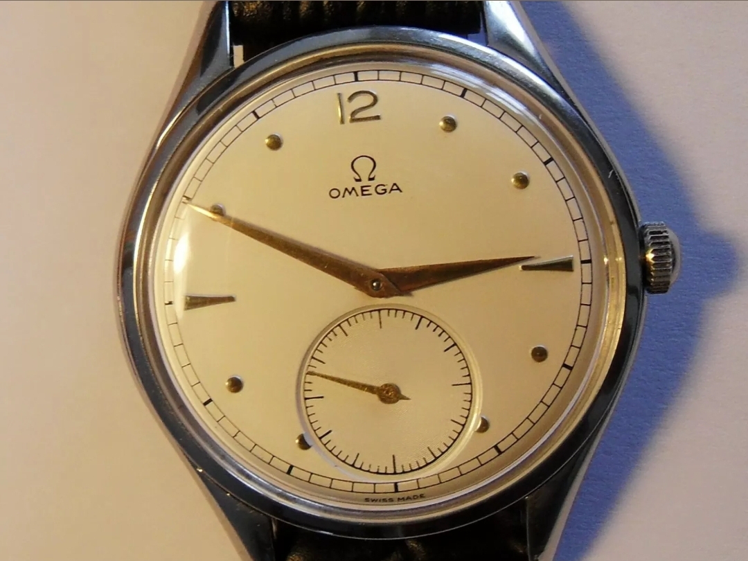

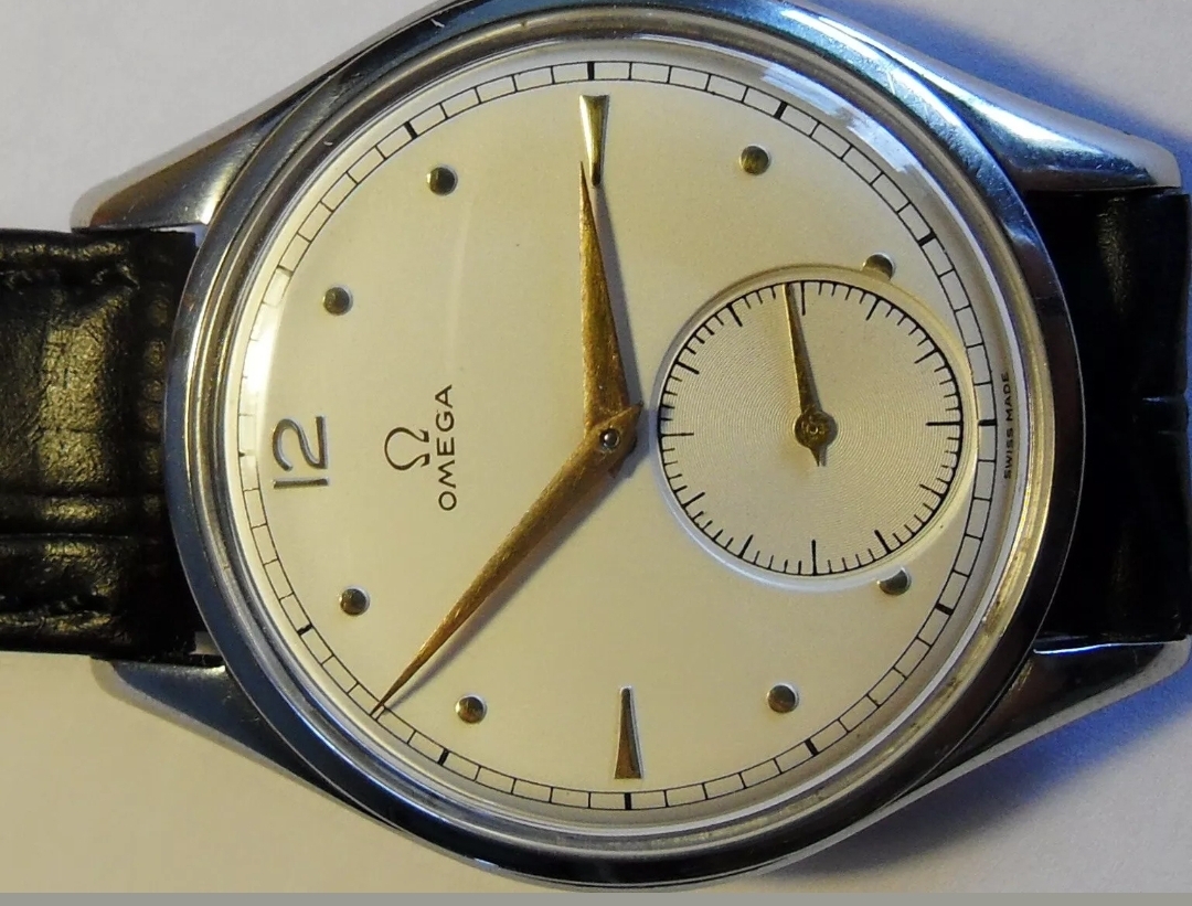

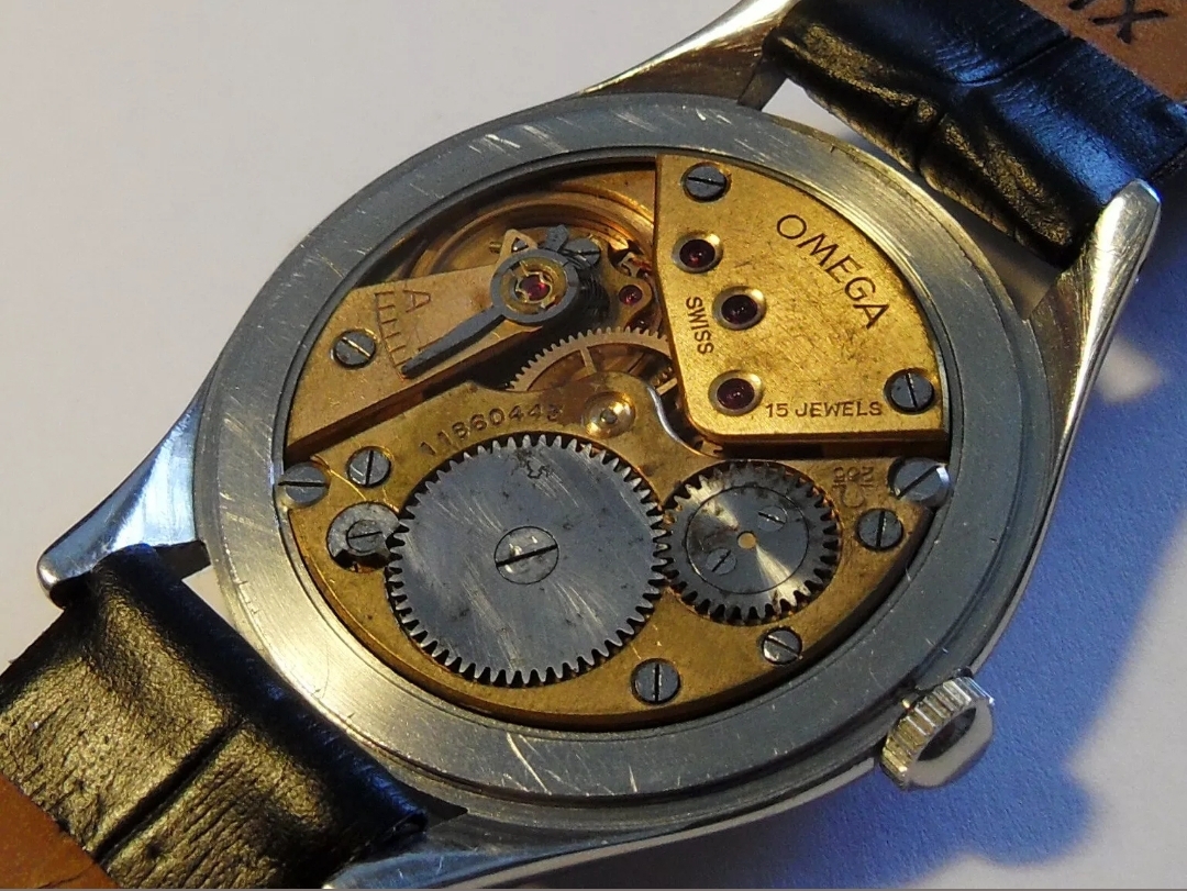

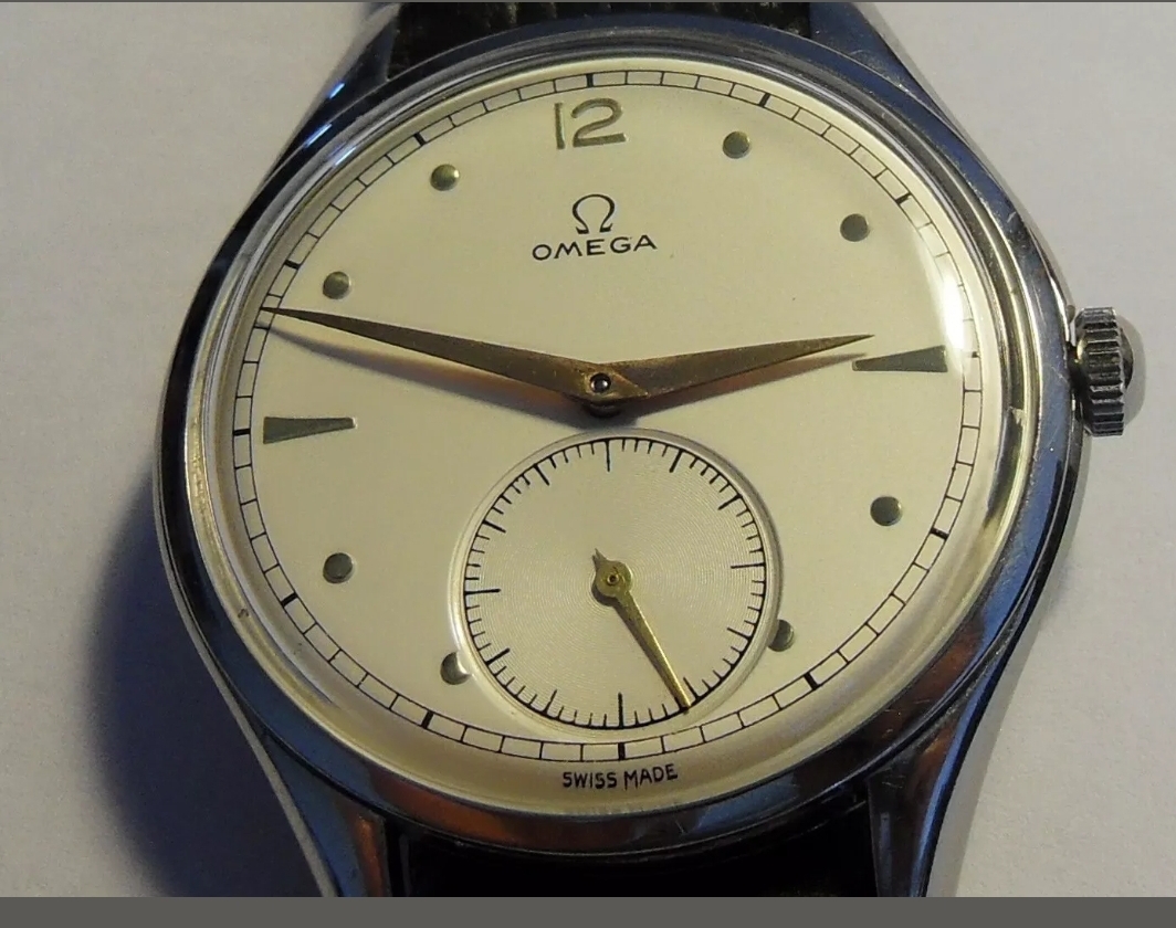

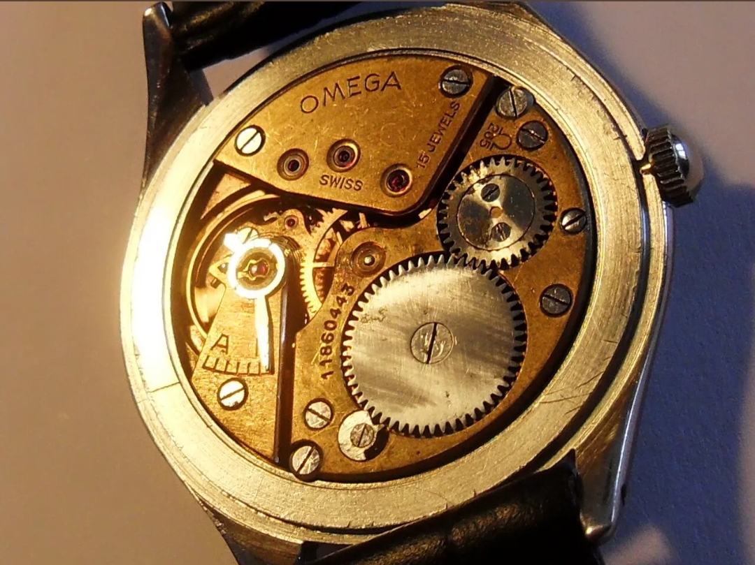

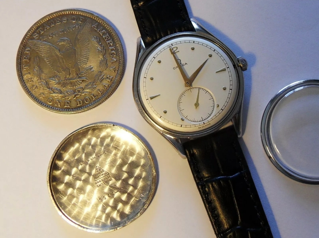

    Seller admits that it is a redial. The movement is in a sorry state, it can't have been serviced recently, look at the grime and the position of the regulator. Also the shape of the case, especially the lugs, of the 2544s I get with a quick google search is different. So it might be a franken but I don't know that reference.
    My bottom line: Avoid.

    Just start by avoiding redials. Easy hint: if a dial looks off compared to the 25 you'll find on google it is a redial.

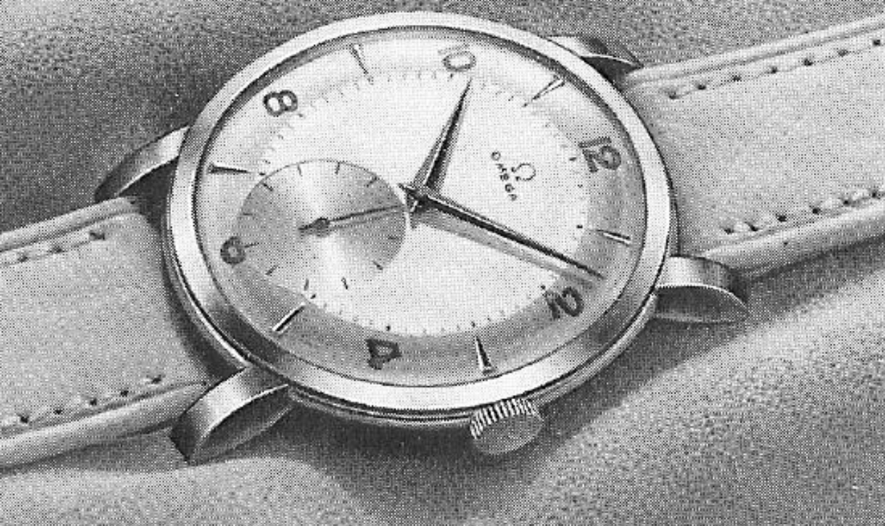

    I’ll add that this is not a 2544 case it’s a 2505/2506 case with a different caseback
    AKA Dr Frankenstein
    K K BULLET TAN and hoipolloi like this.
  7. Rman Aug 26, 2019
    2,412
    9,540
    6F4E1CA9-B2A1-4403-A1C3-B837AE273E01.jpeg Google is your friend.
    K K BULLET TAN likes this.
