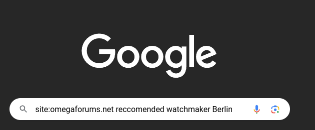

Since it is a 1991 and out of warranty, it would be more cost effective to take it to an independent reputable watchmaker. You can find recommendations for your city by using Google's site search. Something like this:
