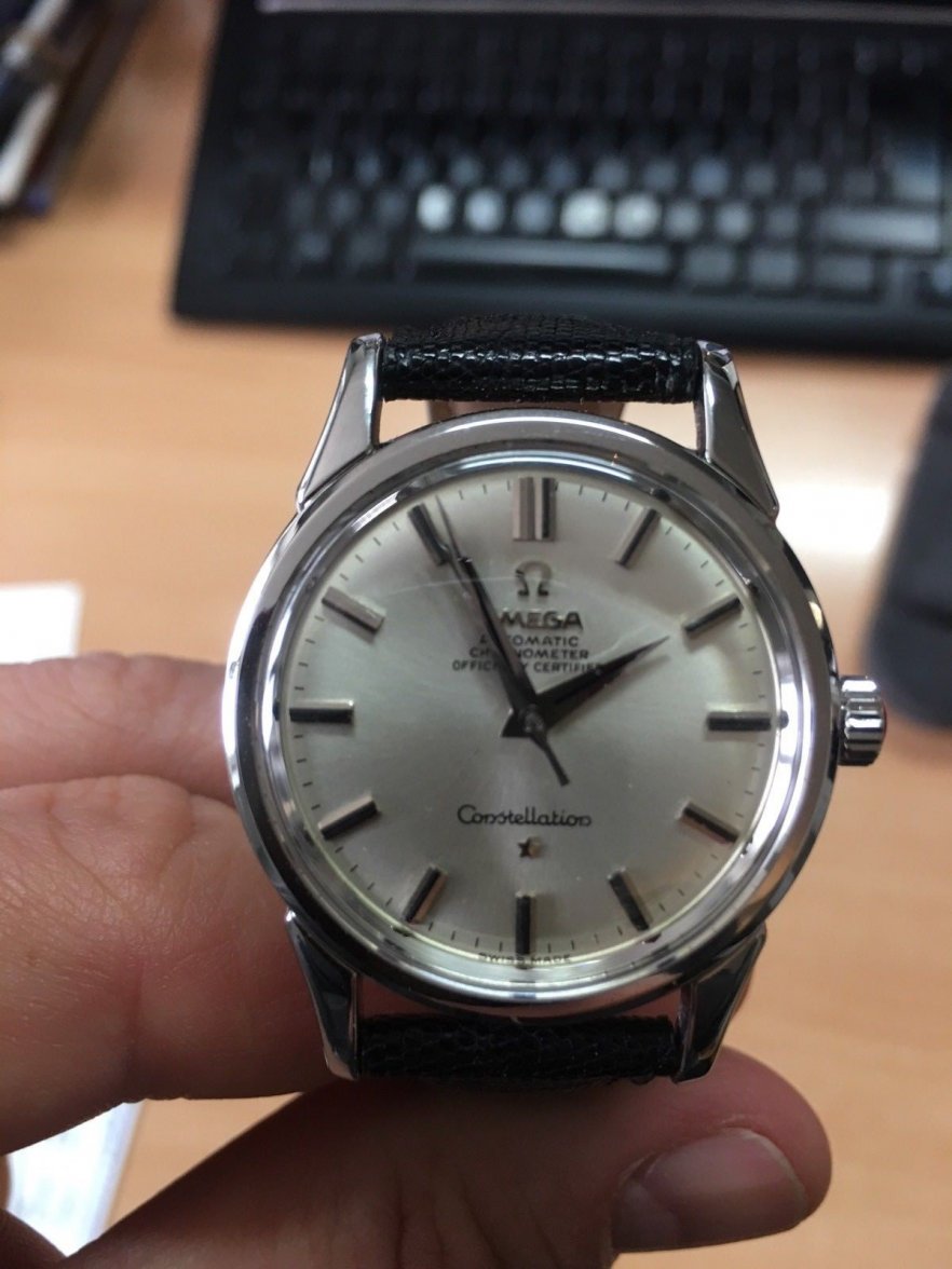

    A great lesson for the Constellation collector as to why you should never send your vintage piece to Omega for (very expensive) servicing. It will come back very shiny and having zero collector's value if you're not careful...
    Looks like a service dial with a lop-sided star, horribly polished to death case, wrong Omega crown and to top it off a nice £800 bill ::facepalm2::

    Oh wow, so sorry to see this! Not even the South Korean polished/refinished specials on eBay look that shiny.
    Omega really needs to finally step up their vintage service game. This is just sad.
    Edit: the Caseback! Oh the horror!
    This belongs into the „Polished POS of the week“ thread.

    And now it's worth less than the service cost.......

    I noticed this one earlier and initially thought the £500 starting price was a buy-it-now.
    After frantically pressing keys I soon realised it was an auction and not even worth the starting price.
    Seller probably thinks it looks great and doesn't realise its been ruined.

    They call that "Finish case as best possible"!! I really wonder what that watch looked like before polishing..Who knows, maybe the case wasn't even Omega :D..
