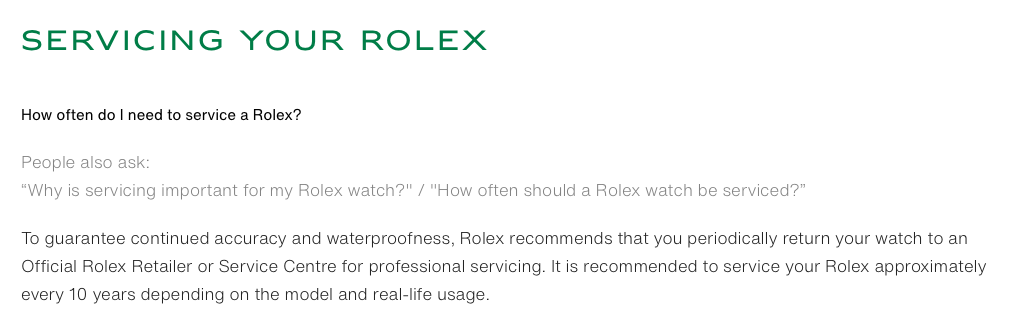

    Where does Rolex indicate a 5-7 year service interval? I was unable to find this on their web site with a quick look, so please let me know the source of this information. I have never seen any official Rolex communication say a watch can go 7 years before regular service, so not sure where these quoted service intervals come from, and I'm not sure they are what the factories really say.
    With the 7 year Rolex thing being very dubious in my mind if it's a real recommended interval from the company, and not just something picked up on a forum, then there's not really a lot of difference between the 3 companies you cite. I honestly think this question is really a non-issue. Per the quoted numbers, the top end of PP is 5 years, as is the top end of Omega, and the lower end of Rolex.

    I guess it depends on how much legitimacy you put into a comment made on a forum with the Rolex example. Is this is really something the company states as their official policy as a standard service interval, or is this the result of a casual conversation with a Rolex tech at the counter? Those are 2 very different things in my view.
    The 7 years could easily be a conversation about a watch worn in rotation with others, where the owner is not particularly hard on the watch, so the tech says "Yeah, you could probably go 7 years before your next service." This gets repeated on a forum, and now this is what everyone says is the Rolex standard service interval. This is not a strange thing - it happens every day on watch forums. I fight/correct this sort of misinformation all the time on forums, so I would take these numbers with a big grain of salt.
    For the Omega example, again what someone says to you verbally in a boutique is suspect IMO in terms of being the official company line. If this is the new "standard" which I very much doubt, then they would be updating it on the web site. Remember Omega have backed off the service interval claims on co-axials that they once made, because they found they were really no going to last as long as they thought they would. I think they would be pretty gun shy about bumping them back up given the problems they have had with various movements.
