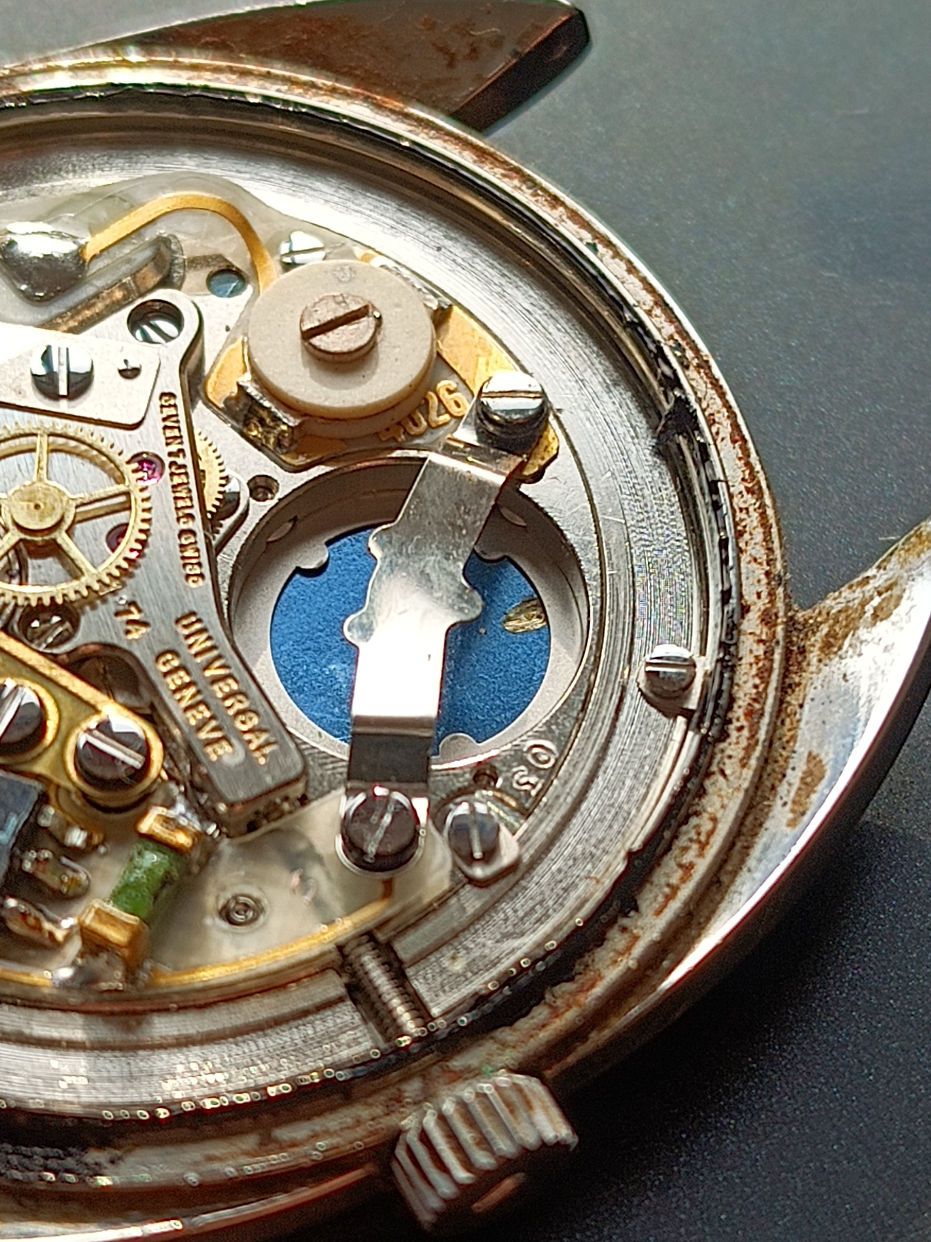

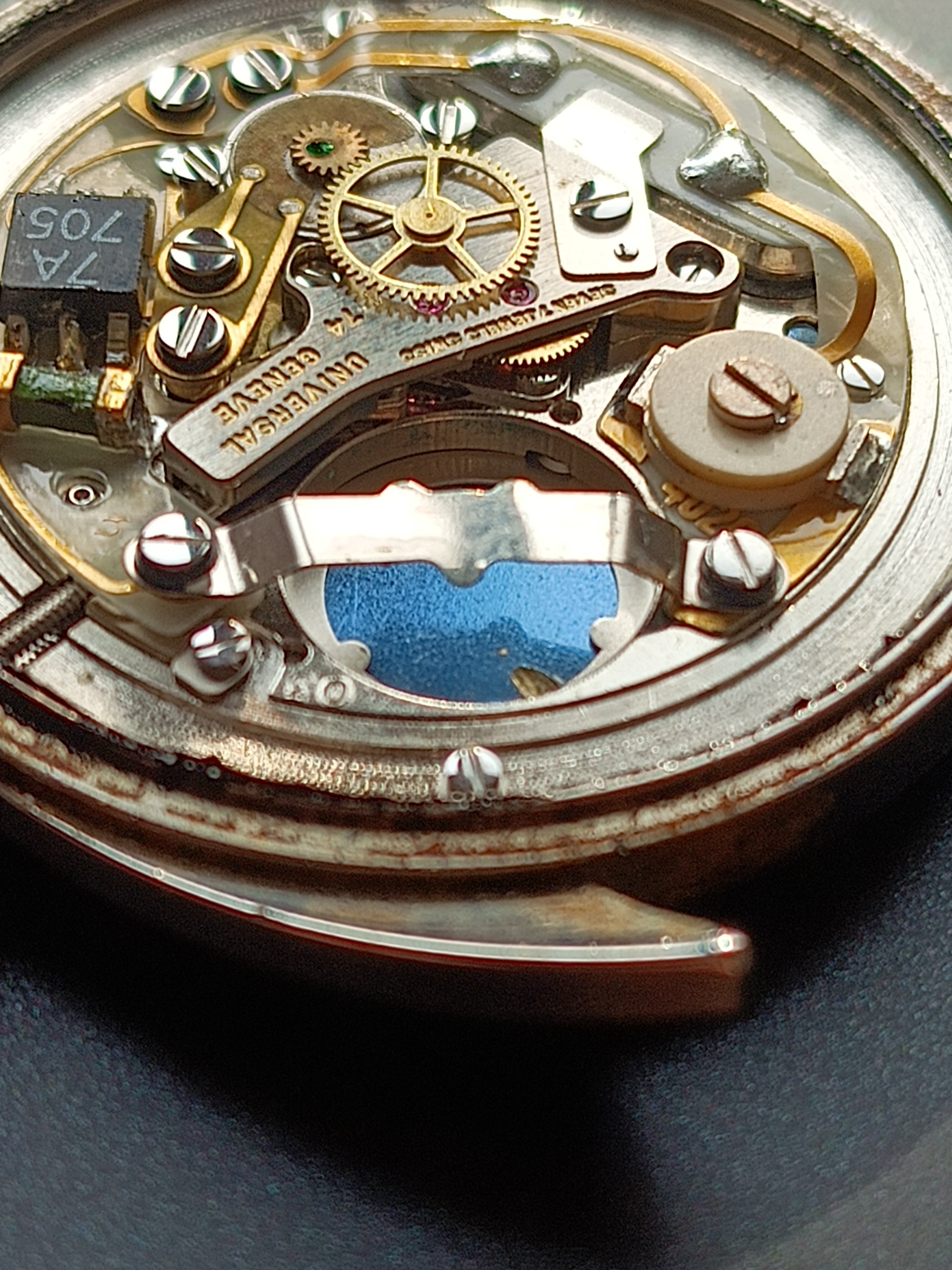

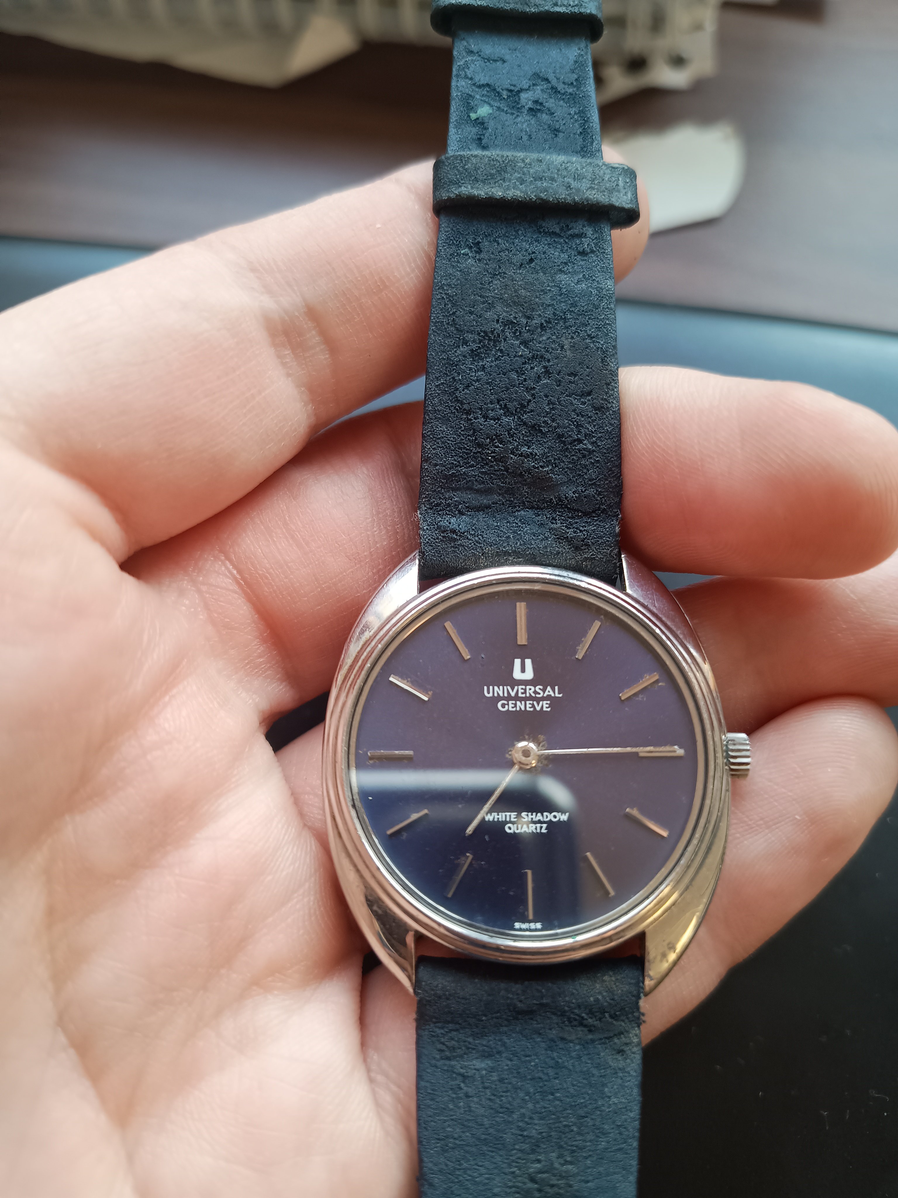

    I took a gamble on this one on Ebay last month and I think it's sort of paid off. Listed as not working and with an unfortunate blemish on the dial, the auction topped out at $36.01 (I was hit with a modest customs bill so this wasn't the total cost). The original seller's photos completely missed the shimmer of the blue dial and, mercifully, the mark at 6 is not really noticeable to the naked eye as the glimmer of light off the batons is far more obvious. It went off to a chap on TZ-UK called keitht (otherwise known as the patron saint of lost early electrical causes) and the reason for it not working was the fact that the battery had been inserted the wrong way around and one end of the battery strap needed insulating. Keith has a theory that the combination of these two factors caused a short circuit and thus the mark on the dial - very lucky that it didn't fry the electronics as I'm not going to find too many loose spare movements.
    The Calibre 74 is a bit of a mystery as well. Released in 1975 as the world's thinnest quartz this makes this watch a fitting brother to my Genta-designed Golden Shadow which was the world's thinnest auto for such a long time. While it has a lot of resemblance to a Bulova 242 it is, apparently, not the same movement in the same way the the Unisonics used just a better decorated Bulova calibre. This site has the most information on the Cal. 74 - it didn't even get a mention in passing in the Pieter Doensen early quartz book.

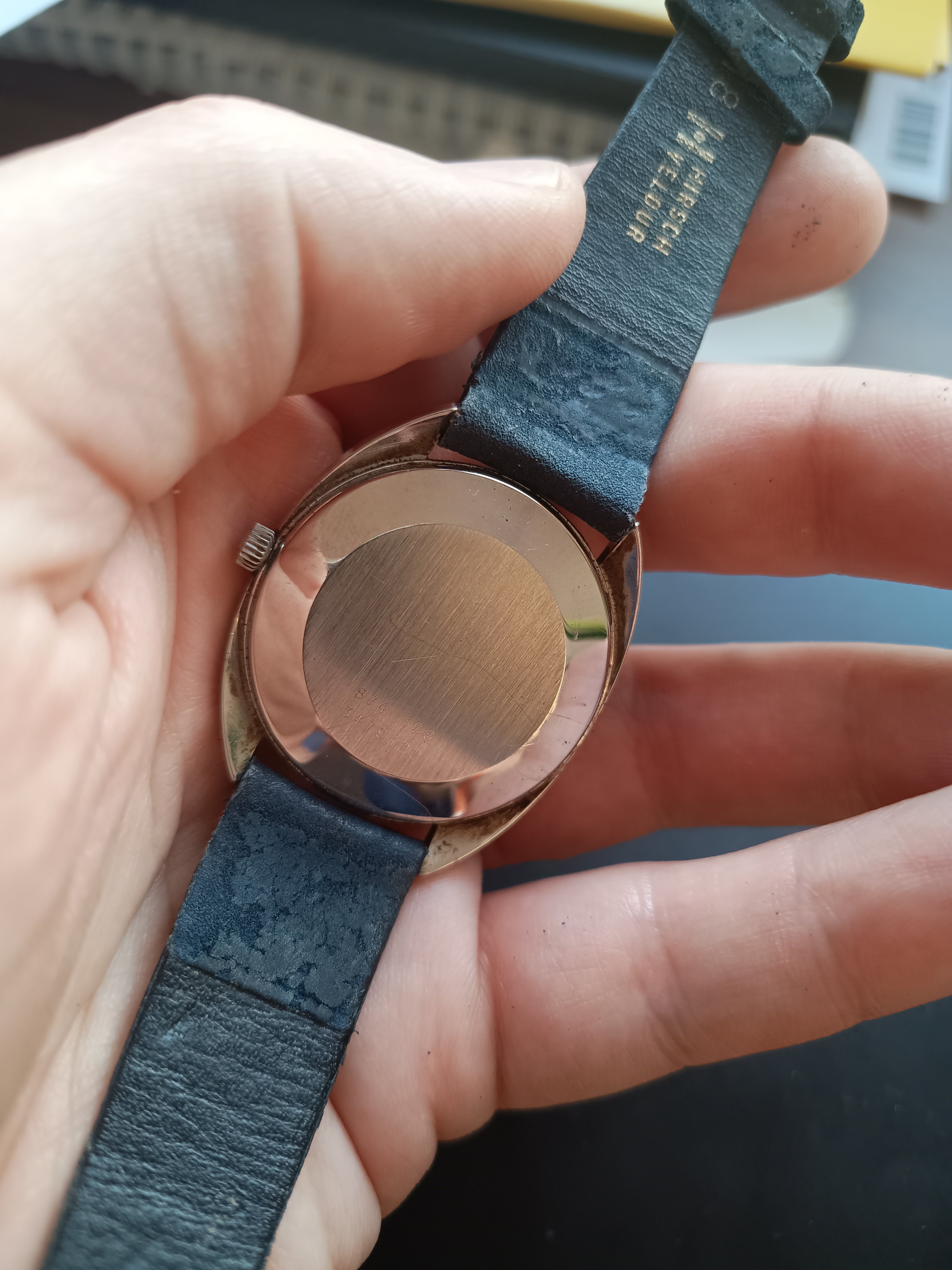

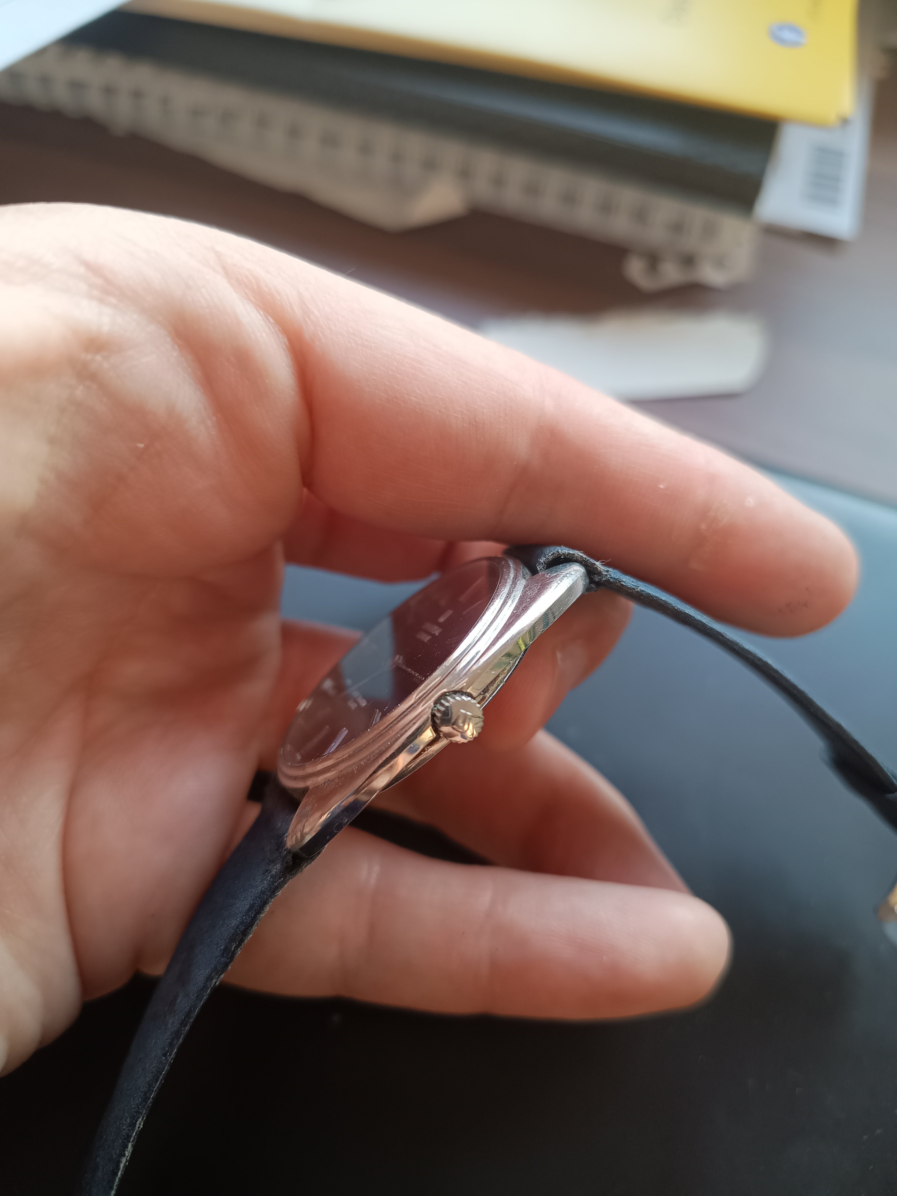

    And some pictures
    [​IMG]
    [​IMG]
    [​IMG]
    [​IMG]
    It's quite thin - I'll take a comparison shot with the Golden Shadow when I get the chance.
    [​IMG]

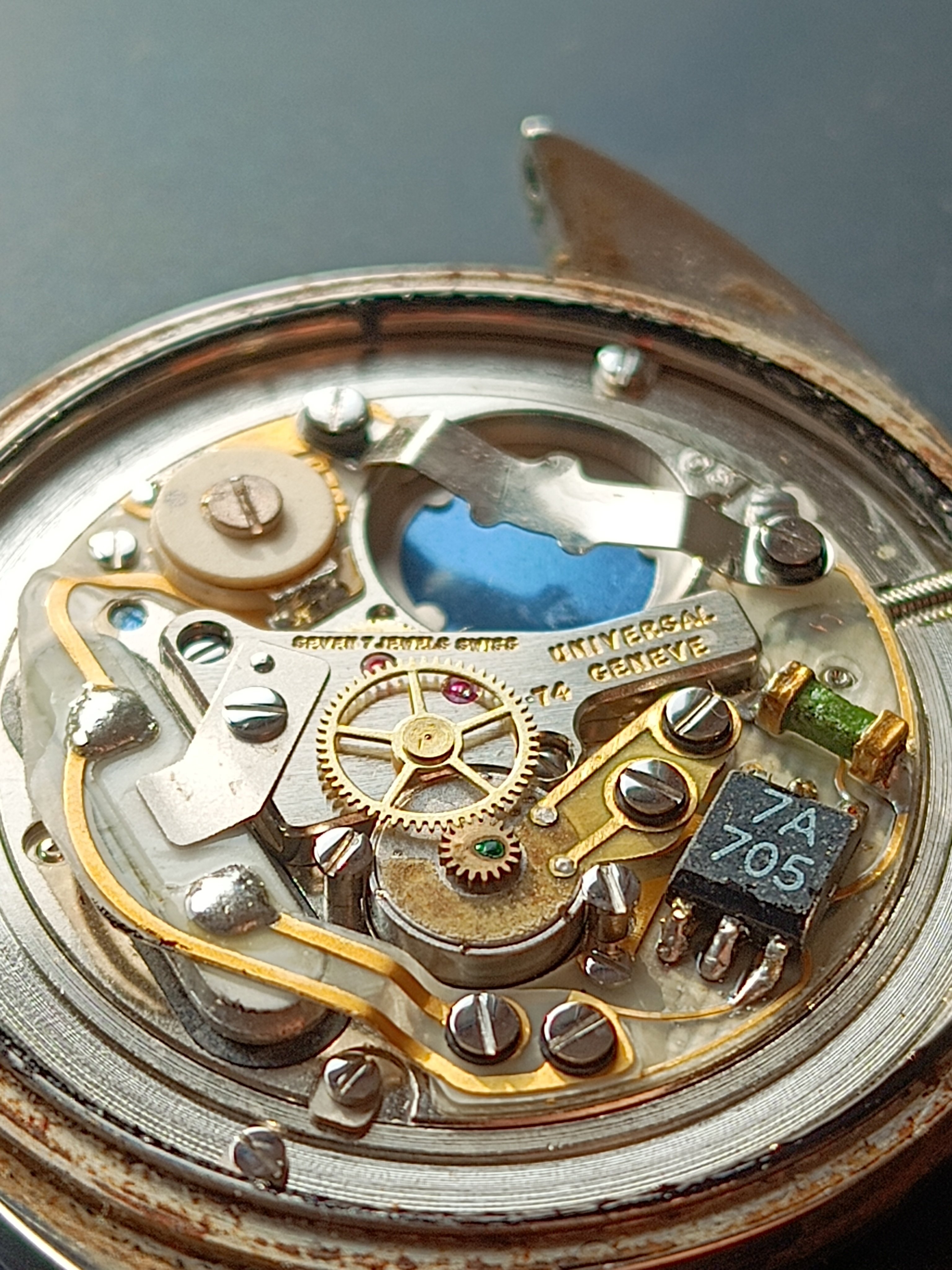

    Edit: I suppose a movement shot might be in order.
    [​IMG]

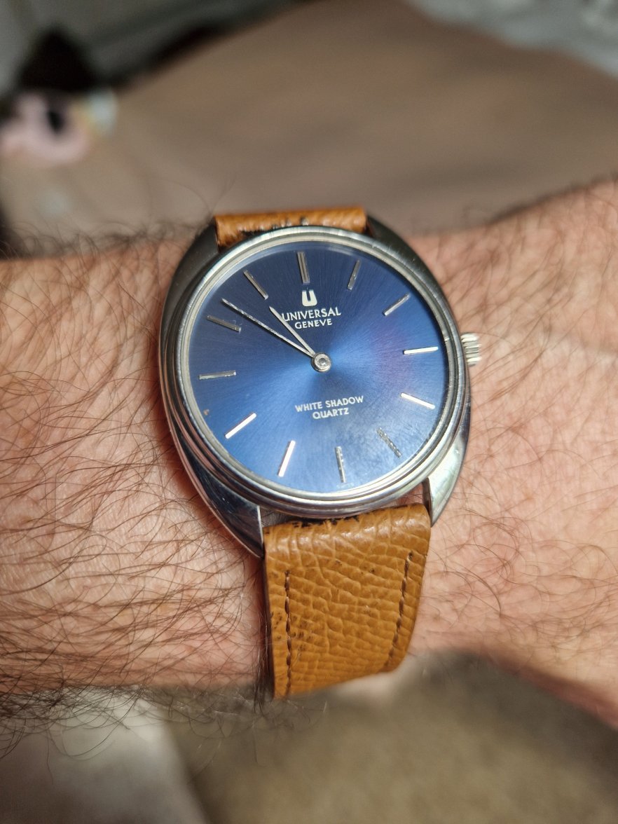

    I've just had the blue alligator made by Peter Watch Acc.
    [​IMG]
