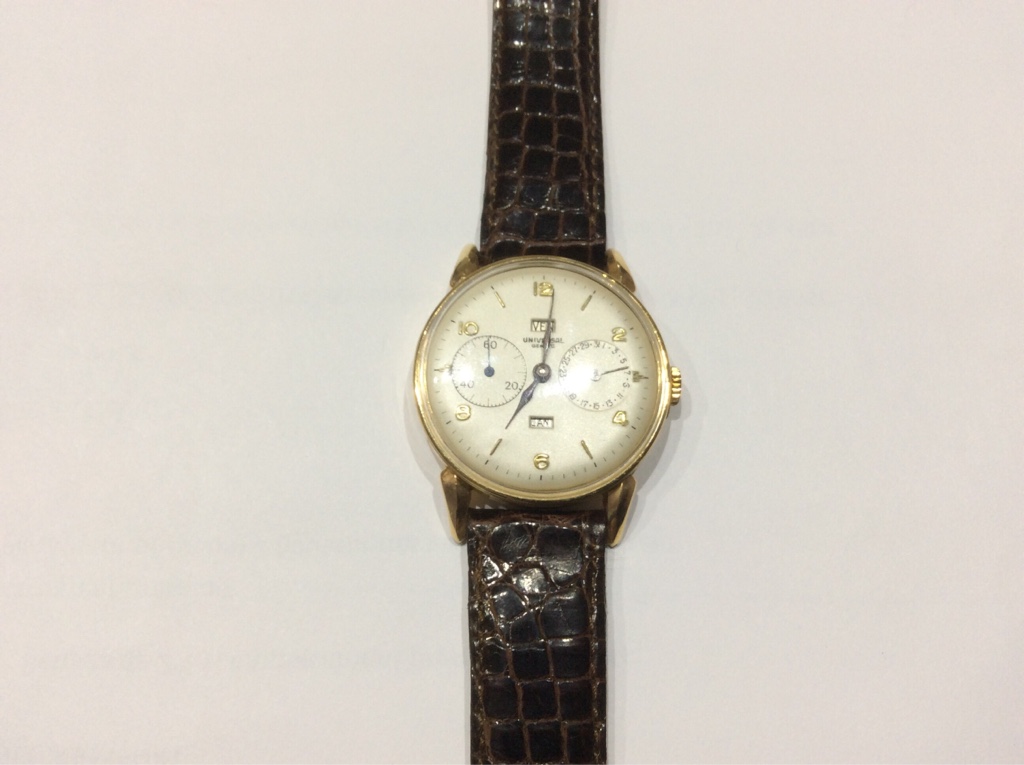

Universal Geneve cal 291. Redial?
  1. MarcelGuinchard Feb 28, 2015
    212
    567
    Edited Feb 28, 2015
  2. MarcelGuinchard Feb 28, 2015
    212
    567

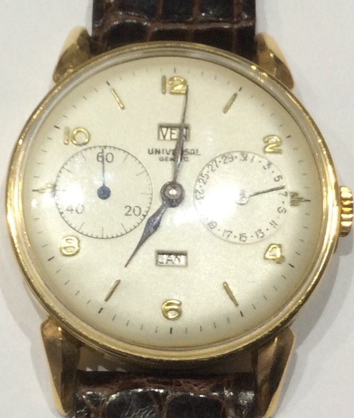

    Based on the higher quality photo, I guess the lack of "Swiss" signature is strange...
    As well as the "Universal" font quality.
    What do you think?
  3. LouS Mrs Nataf's Other Son Staff Member Feb 28, 2015
    6,713
    18,259
    Could use a more closeup image, but looks like a redial from here.
  4. MarcelGuinchard Feb 28, 2015
    212
    567
    Those are unfortunately the only pictures I have. Below is a zoom if that helps.
    Let's check if I learned well to track redials here at OF. I'd say:
    - lack of "Swiss" signature
    - the "10" "30" and "60" seem to miss compared to other cal 291 I saw.
    - "universal Genève" not very crisp and the two words are very close to each other.
    Well, I more or less answered to myself but would love to hear confirmation / information from you :).
    Edited Mar 1, 2015
  5. MarcelGuinchard Feb 28, 2015
    212
    567
    Thanks @LouS. Sorry about the pictures I don't have any better from the seller.
  6. rolokr Mar 1, 2015
    1,195
    1,918
    Redial !!!!!
  7. Modest_Proposal Trying too hard to be one of the cool kids Mar 1, 2015
    2,890
    5,960
    Redial
  8. MarcelGuinchard Mar 1, 2015
    212
    567
  9. woodwkr2 Mar 1, 2015
    1,366
    819
    I'll pile on... redial.
