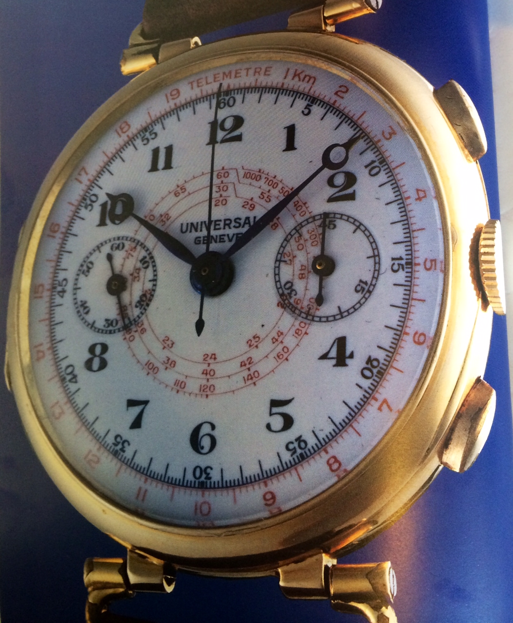

    Above we see examples of the Flat pusher (#76 and #73), Large Mushroom pusher (#75 and #77), and Small Mushroom pusher (#74).
    These pictures come from the Antiquorum Universal brand auction. Interestingly, the auction note for #74 (and other small mushroom pushers on this style case) states: "This model bears small round push-buttons and was made in few examples".

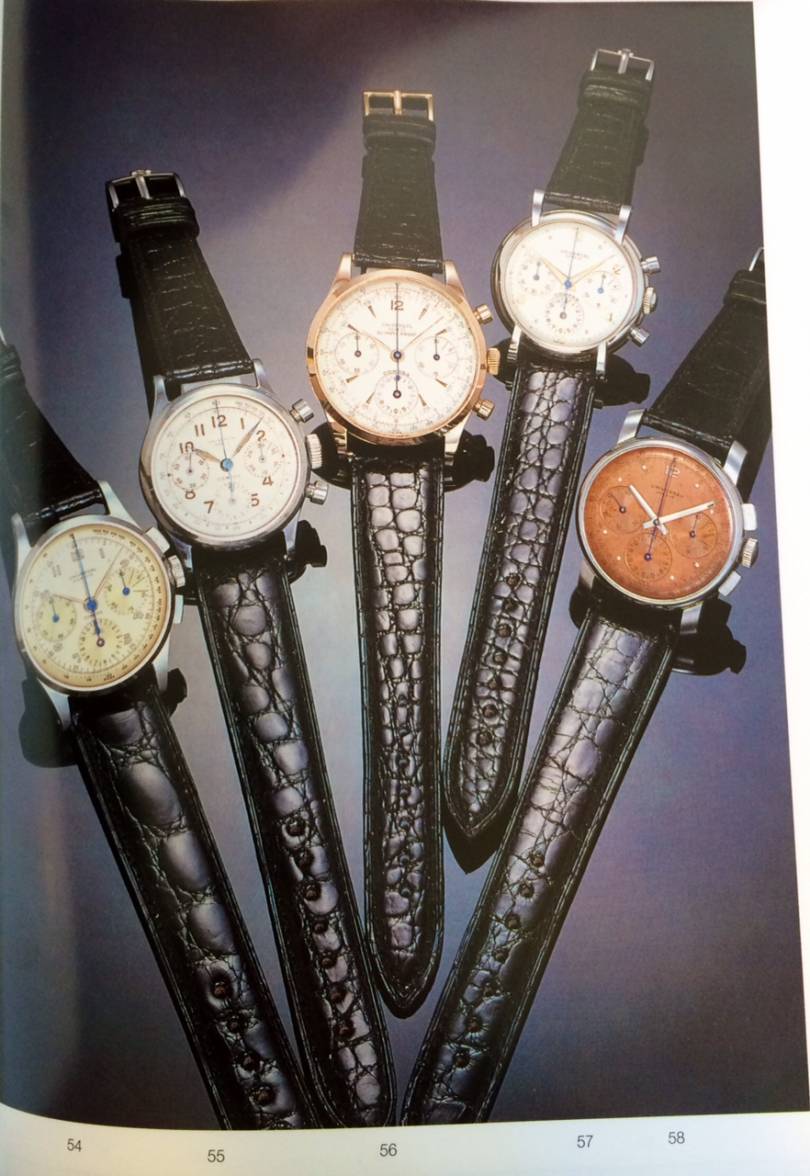

    Here I'll ask you to note a very subtle distinction: the Sharp edged mushroom pushers in #55 and #57 (and presumably in #56 too, before the edges were rounded with use in the softer, gold metal).

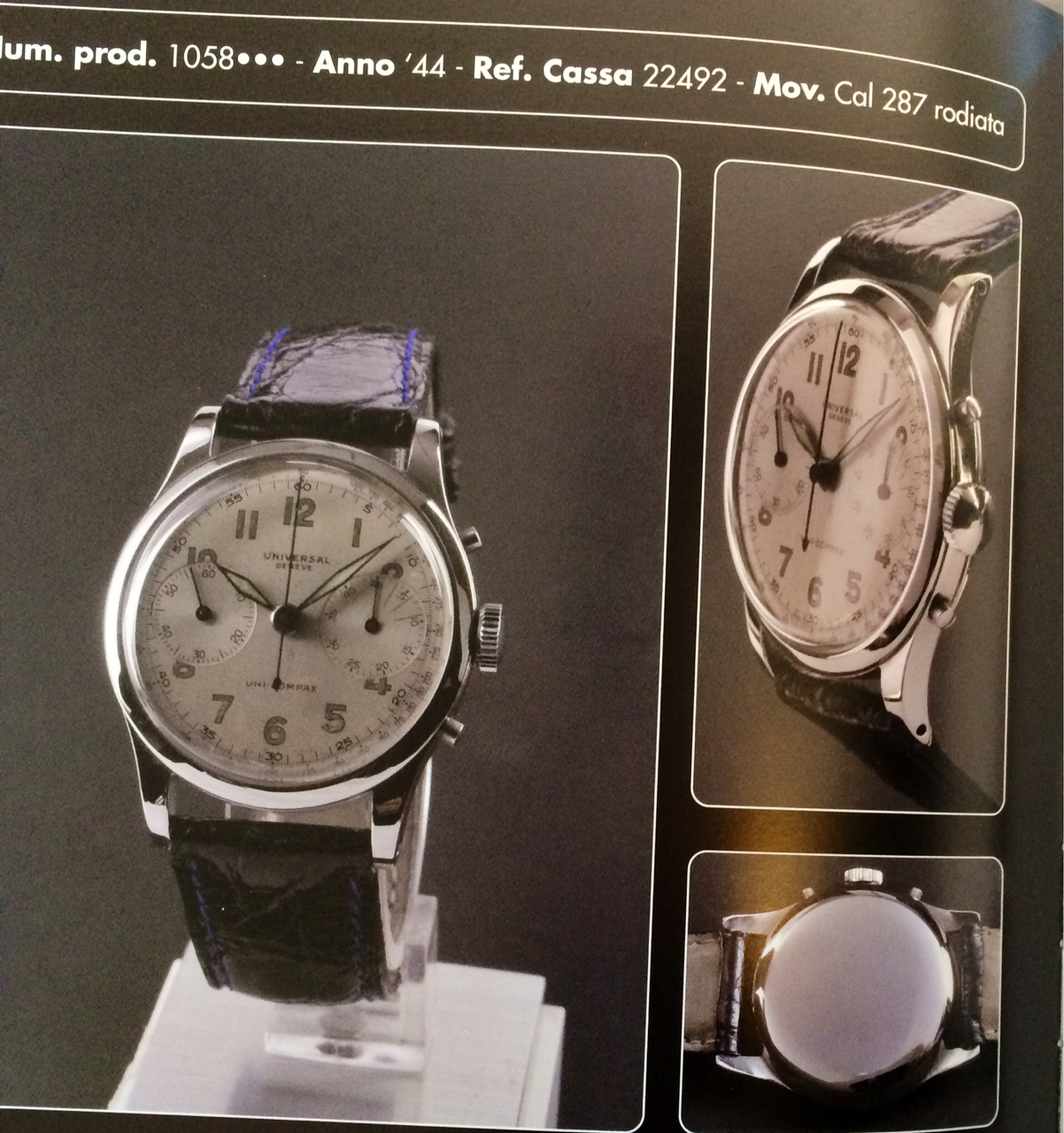

    Here's an example of the oval pusher, which is typically seen on earlier period chronographs.

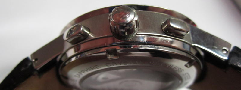

    Here we have a Flat, rounded pusher that is sometimes seen beginning with the very recent Universals from the 1990s to present.

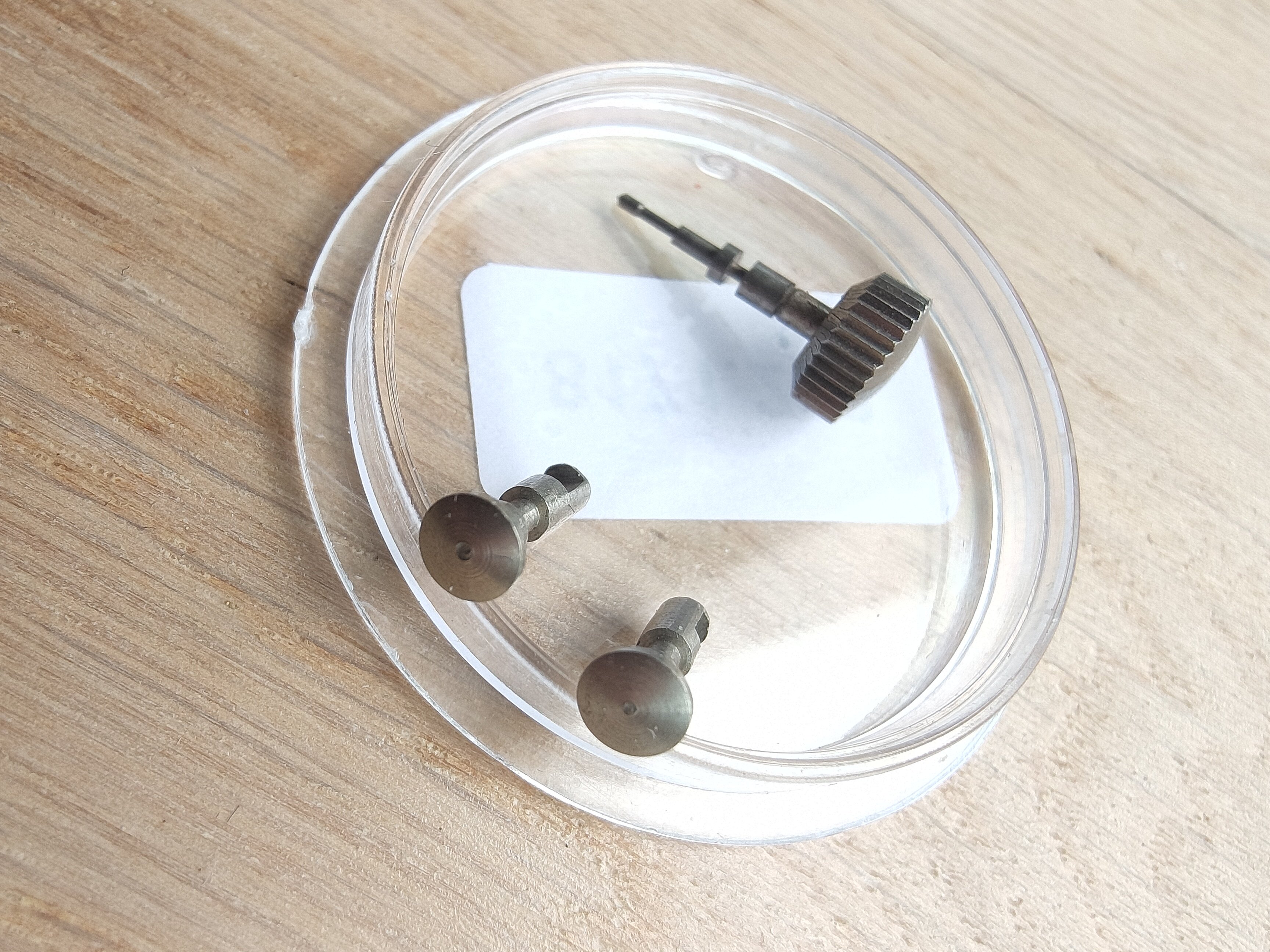

    We have this example from Sala, showing the Small, Non-Waterproof Mushroom pushers. This style is seldom seen and appears as a transitional variation between the flat pushers with snap backs (both were non-waterproof) to the waterproof mushroom pushers with screw down case backs.

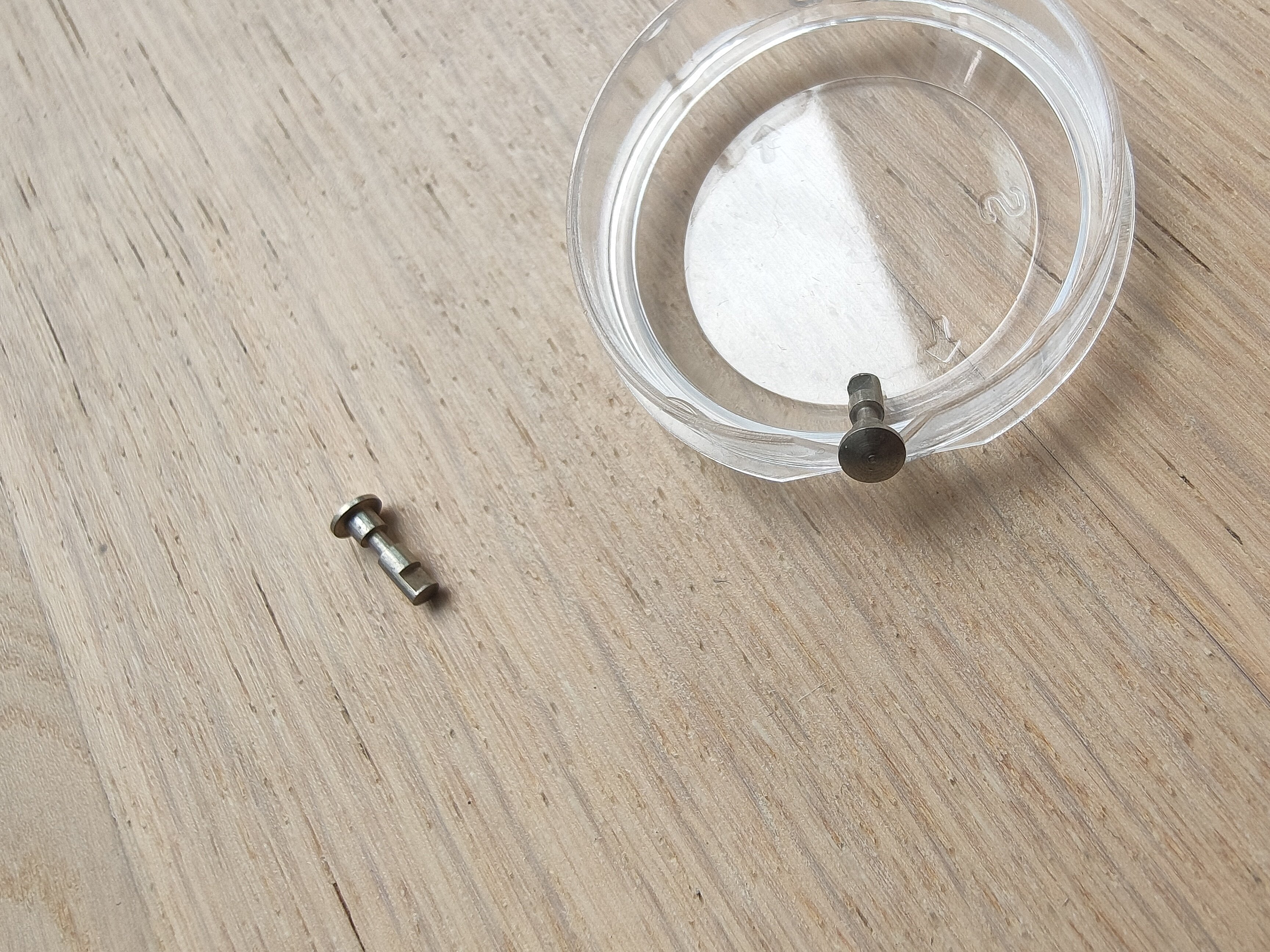

    Finally, we have this example of the Large, Pointed Mushroom Pushers, here seen on the rare, non-screw down waterproof caseback models.

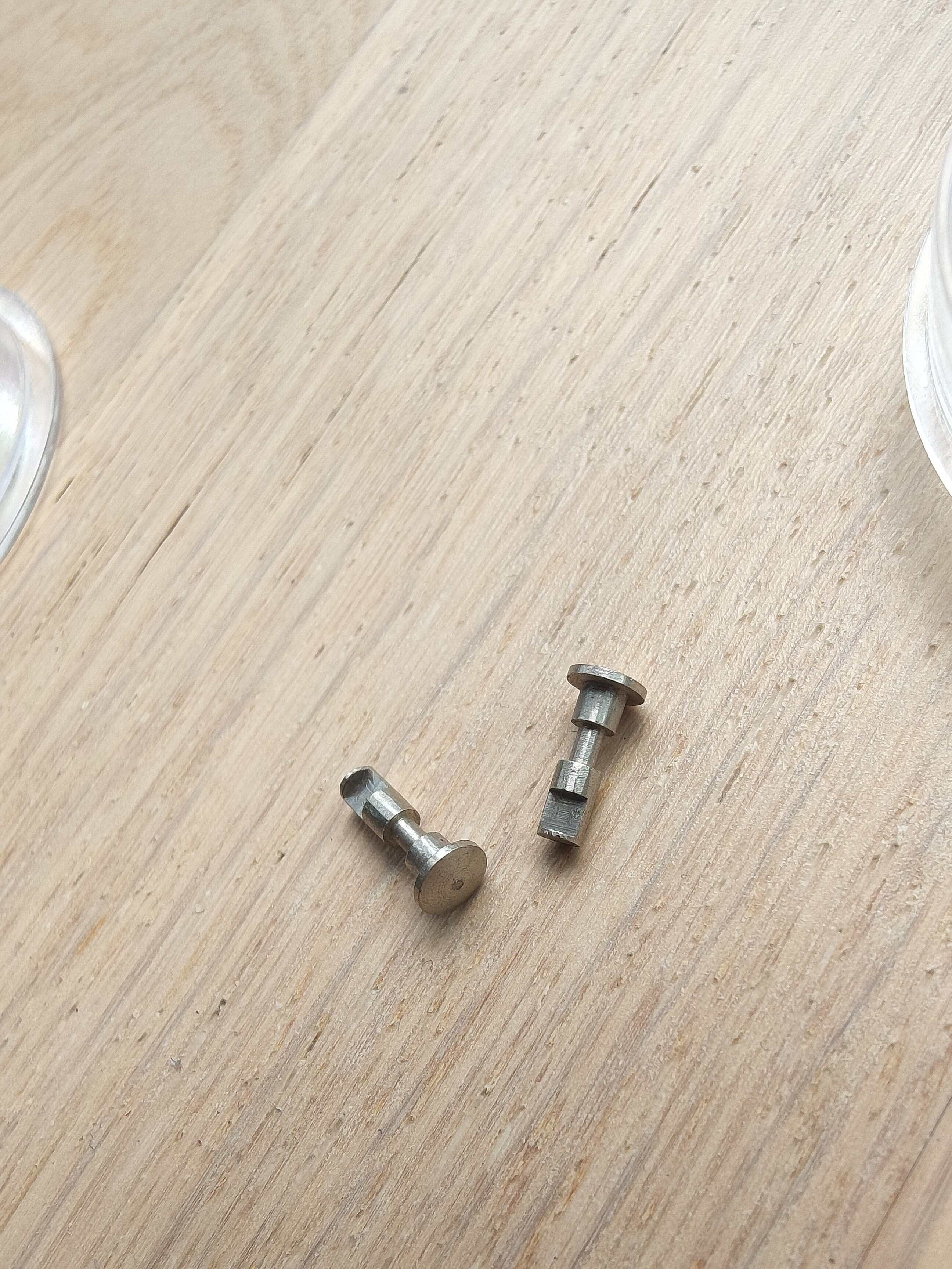

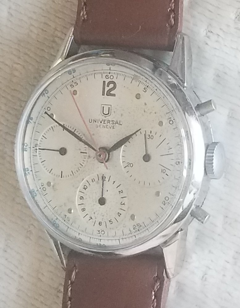

    I had thought someone had mauled the pushers of this watch trying to get them out of the case and had damaged the end caps getting them off these stalks.
    Now it appears they are just rare transitional pushers that never had the end caps

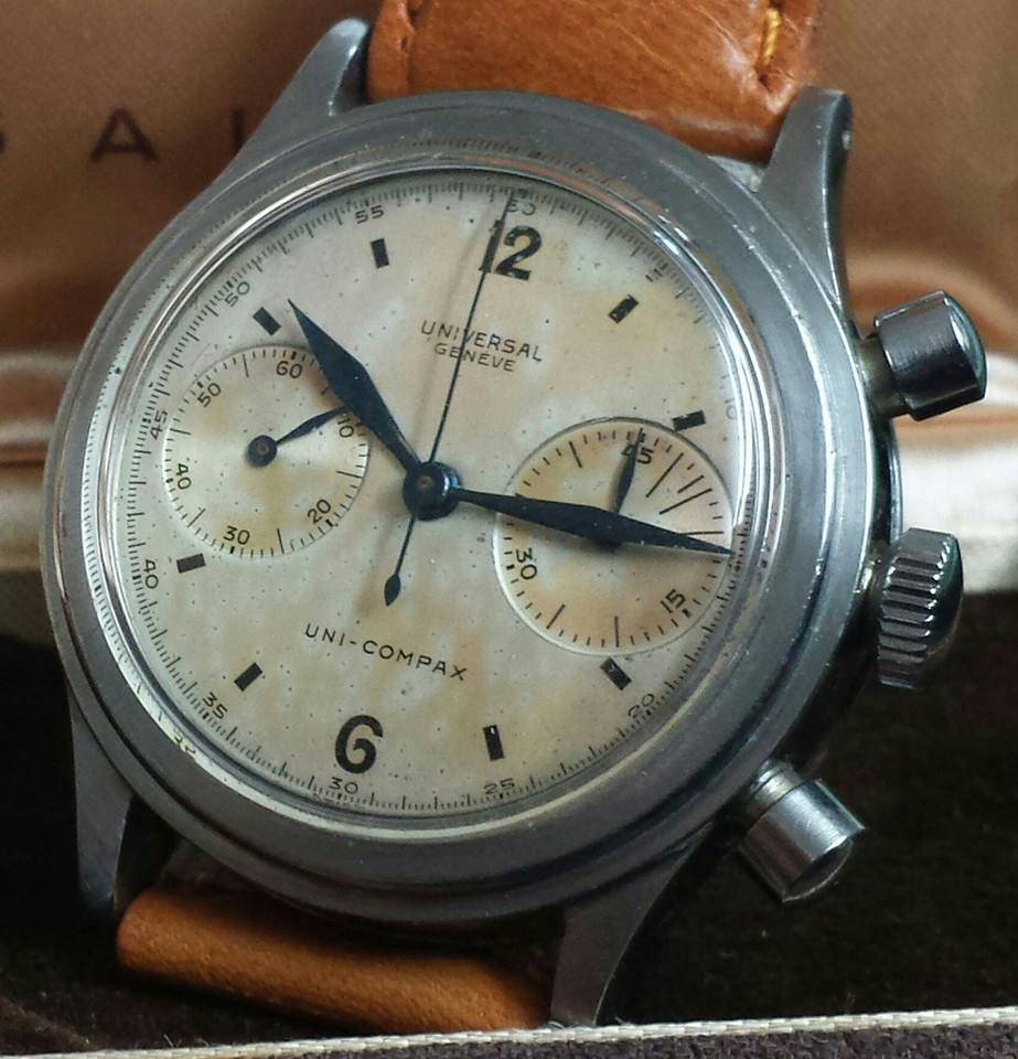

    cool case. what about the dial ?
  11. DManzaluni May 30, 2019
    386
    165
    Completely not sure what to do about the dial. It looks nice but seems to have beginnings of verdigris advancing from the lower right towards the upper left. I did try asking whether anything could be done to clean anything off but no one seemed sure; and I didn't want to appear naive for seriously suggesting that anything on a dial could be cleaned!
  12. bgrisso May 30, 2019
    3,125
    6,882
    Sorry I was not more clear, it's a redial. I'm not sure about some of the hands either.
