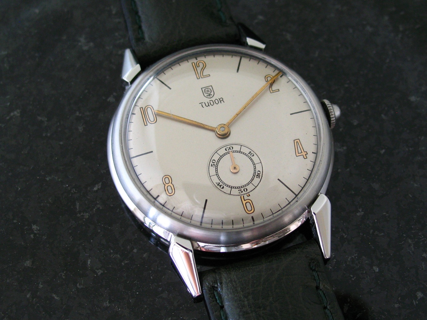

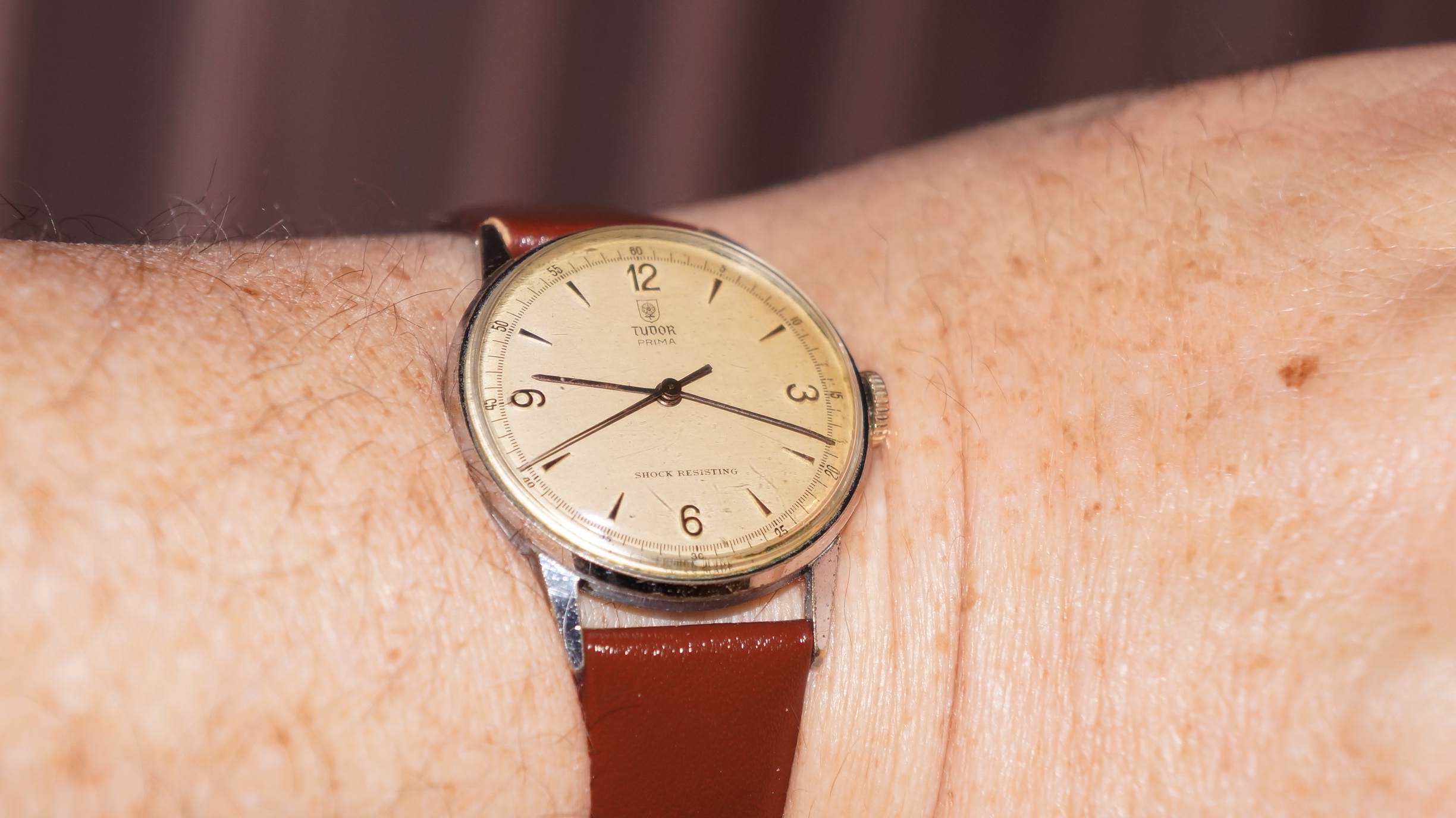

  4. X350 XJR Vintage Omega Aficionado Apr 18, 2013
    12,584
    29,828
    A couple non-oyster Tudors.
  5. Superpacker Apr 18, 2013
    83
    16
    XJ50 XJR, those are great. Being new, can you or someone else explain the difference with non-oyster. If I understand correctly, Oyster is Rolex's waterproof casing technology, and as such is on the more sport oriented models. Is that correct? How much could a watch like these be expected to go for?
  6. X350 XJR Vintage Omega Aficionado Apr 18, 2013
    12,584
    29,828
    Yes, the oyster case, typified by a screw down back and crown, is usually the style associated with the sporty type Rolex and Tudor watches. The two I posted are snap back cases with non screw-down crowns.
    Value, perhaps $500-$700.

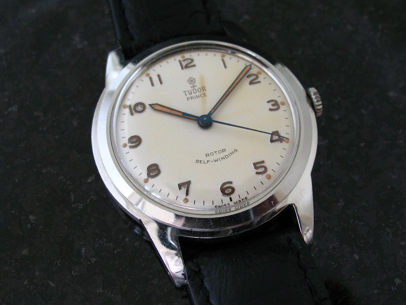

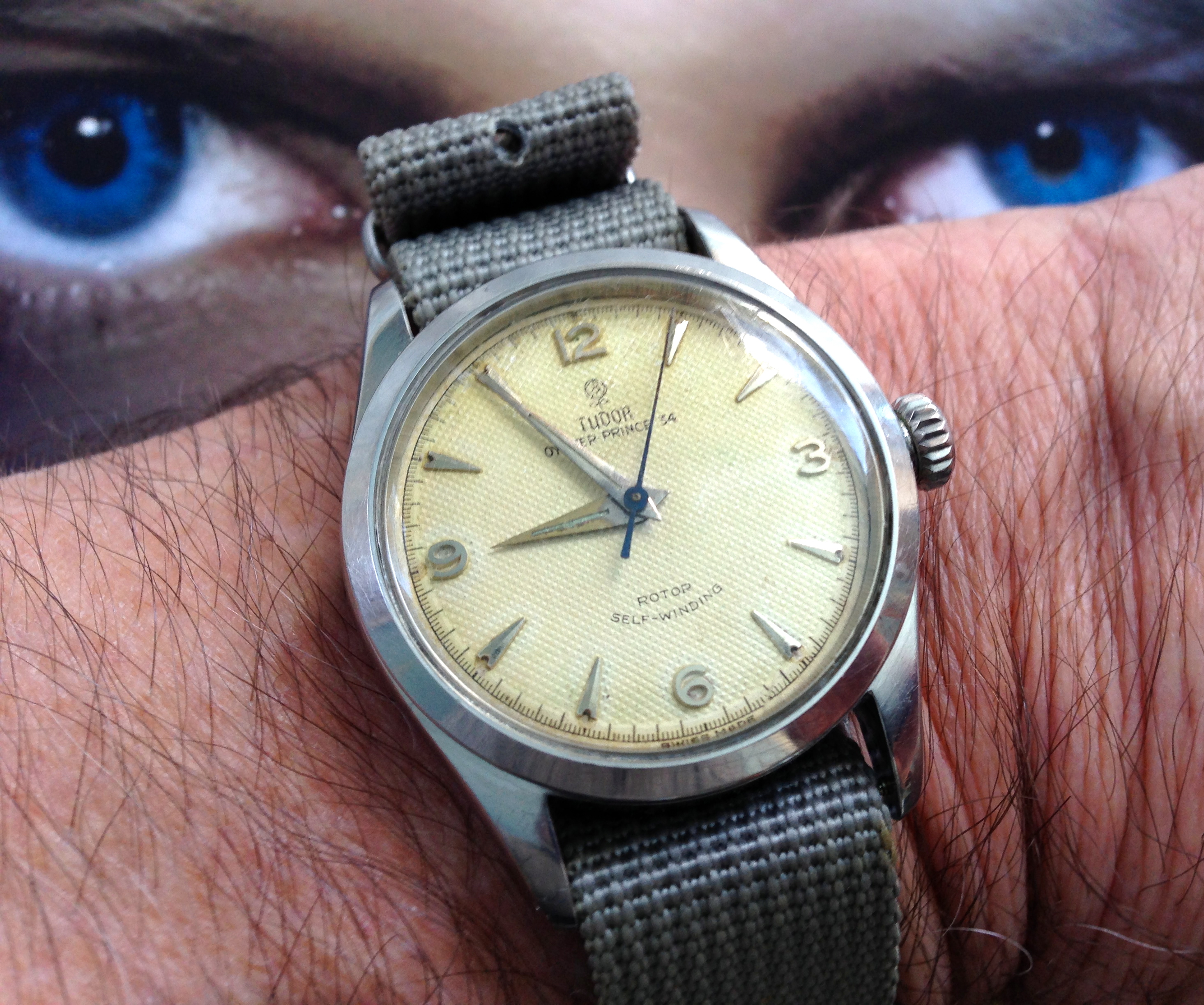

  10. Alpha Kilt Owner, Beagle Parent, Omega Collector Apr 20, 2013
    16,074
    141,935
    You will find quite a few watches with textured dials, this is one of mine
    Is this the effect you are describing?

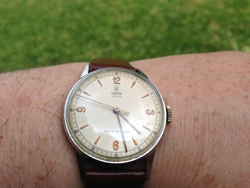

  11. TXOMEGA Aug 17, 2013
    4
    4
    Here is my dress Tudor with band.JPG vintage Tudor from about 1946-47. 18kt gold numerals and markers.
    Still looking for a vintage strap.
  12. TXOMEGA Aug 17, 2013
    4
    4
    and out in the sun
    SeanO and kyle L like this.
