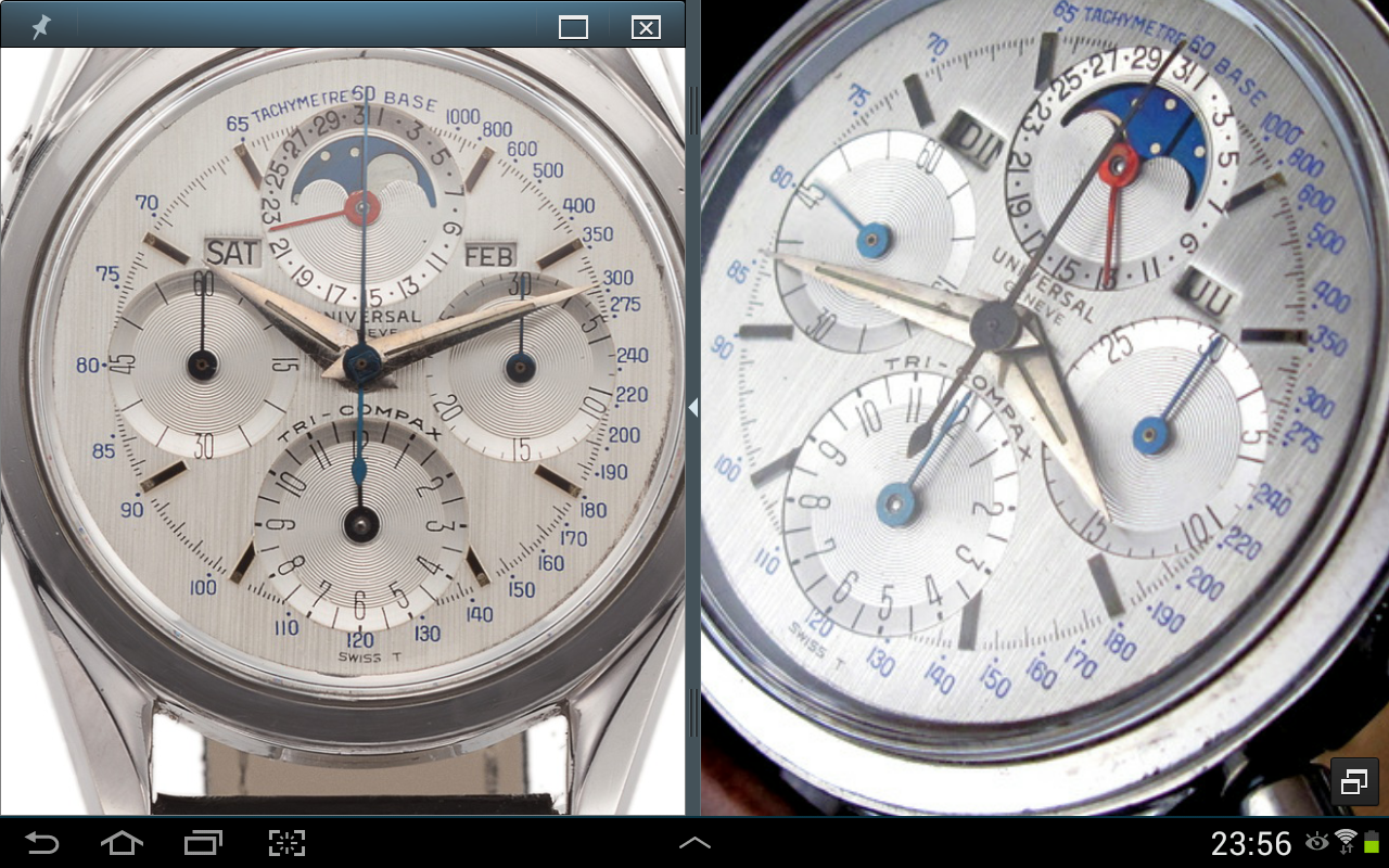

    Hi guys, new here though I spent the last week or two trying to read every post in this forum. Trying to learn as much as I can before pulling the trigger on something ...
    What's the verdict on this one coming up next week? What's a fair price for it?
    http://www.antiquorum.com/catalog/lots/universal-ref-22297-3-lot-280-42
    [​IMG]
  2. ulackfocus Feb 14, 2014
    25,983
    26,974
    I'd vote redial, but wait for more informed opinions.
  3. mbirtch Feb 14, 2014
    58
    5
    the "tachymetre" section looks out to me-would be suspect I think.-------------------------
  4. Gavin It's the quiet ones you have to 'watch' out for. Feb 14, 2014
    2,399
    4,466
    I am going for original but I am still learning. Comparing to one from member, Noodia.
  5. woodwkr2 Feb 14, 2014
    1,366
    819
    That looks like one beautiful, original dial!
    For what it's worth, this particular dial layout with the deep set subdials would be extremely difficult to re-dial. Indeed, it was extremely difficult to get right in the factory. Notice that the numerals extend slightly over the edge of the subdials on Noodia's example. I'm looking at my own example and it's just the same... though notably, my dial is simply marked "SWISS" at six oclock, omitting the T. Perhaps mine (or theirs) is a service dial.

  6. ulackfocus Feb 14, 2014
    25,983
    26,974
    Which is what threw me off. Never seen a tachymeter inset so far - usually they're closer to the rehaut / edge. Thanks for the lesson!

    Yep, original. I've got the version without the tachy, and the subdial sinks are slightly different, but you can compare the fonts at least. I can't imagine the vertical grain finish is easy to get right either.

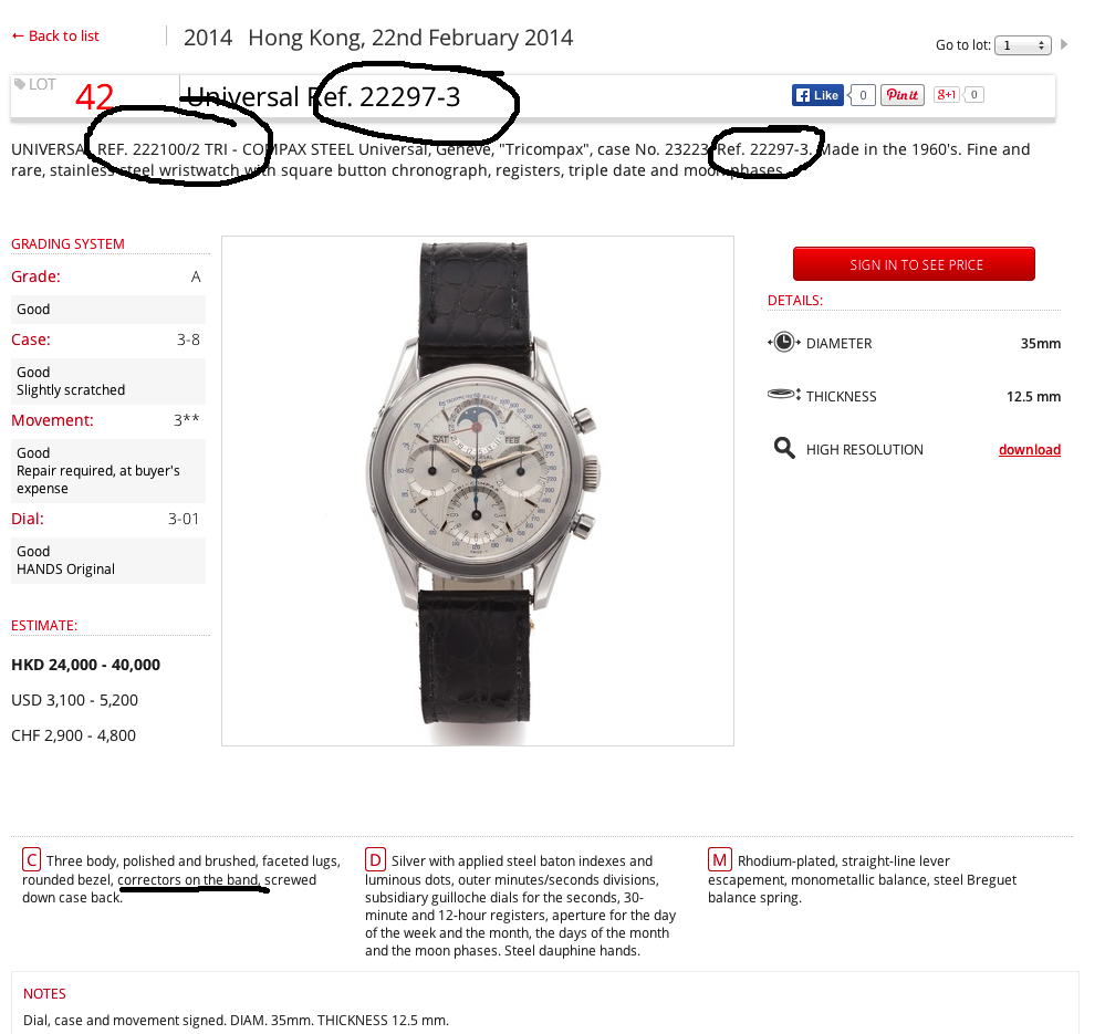

    Upon furtherrrrrr review:
  14. LouS Mrs Nataf's Other Son Staff Member Apr 5, 2014
    6,713
    18,260
    And what they call a case number (23223) appears to be yet a third reference. It certainly makes no sense as a case number.
  15. woodwkr2 Apr 5, 2014
    1,366
    819
    So it looks like AQ is guilty of sloppy copy writing; they've copy and pasted auction descriptions from a wholly unrelated lot. In this case, they apparently got the reference correct: 222100, but then copied over all the incorrect reference numbers (22297) from an old lot.
    As I was not in HK that day, nor tuned into their auction feed, I have no idea which reference number was referred to by the auctioneer. Though, based on the fact that the entire URL is based on the incorrect reference number, I guess that it was called as 22297.
    And BTW, has anyone ever seen a watch with "correctors on the band." These people were having a bad day (best case) or are total morons.
    For the buyer of this lot, I have to think that he went home with a correct ref 222100, even though his paper work is likely wrong. Hope he didn't insure the piece based on the wrong reference numbers. That could be an expensive mistake if there was ever a problem.
