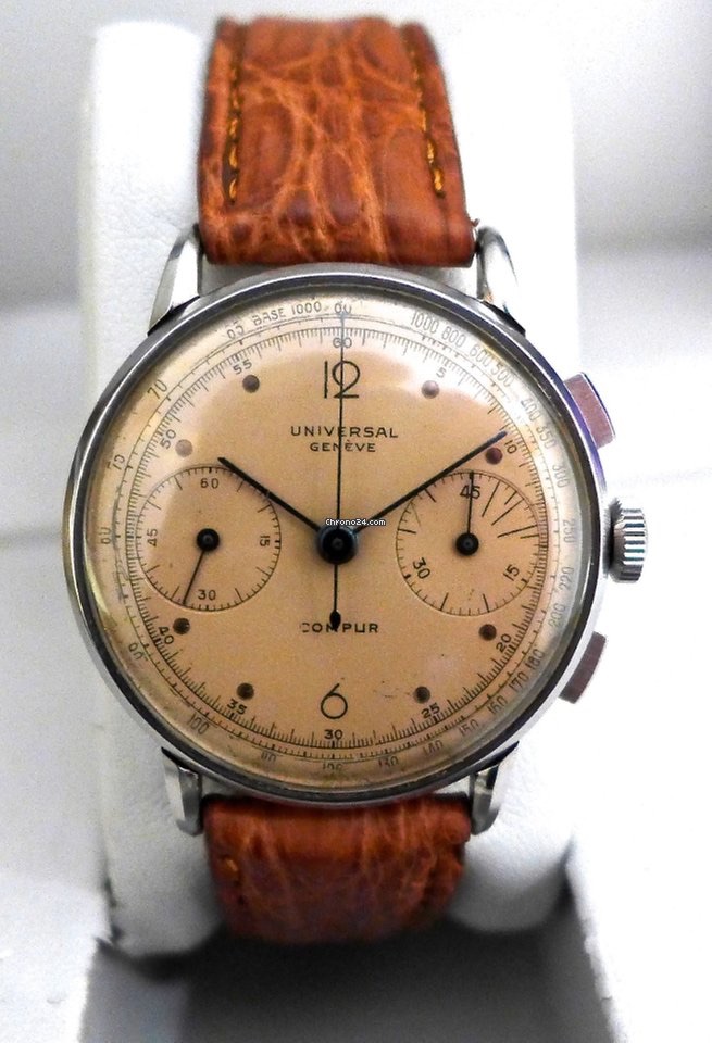

    hey everyone I was wondering what your thoughts on this UG are. Do you think the dial is original? Also did Universal do copper colored dials with stainless cases?

    I vote redial. Both subdials are flat (no guilloche) and the right one is ever so slightly pulled down and left.
  3. rolokr Mar 4, 2015
    1,195
    1,918
    Redial !

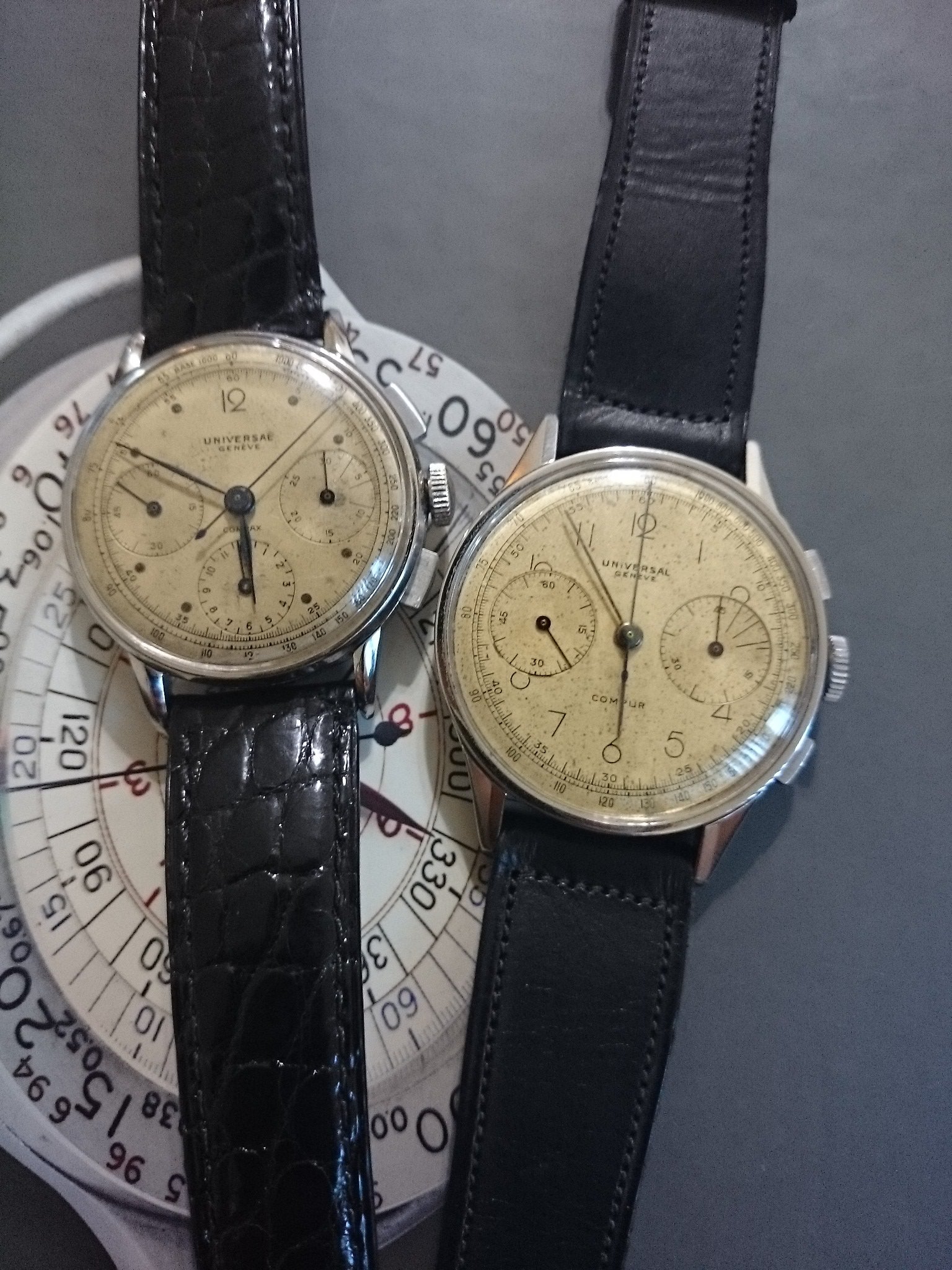

    I've had similar colour dials and fonts.

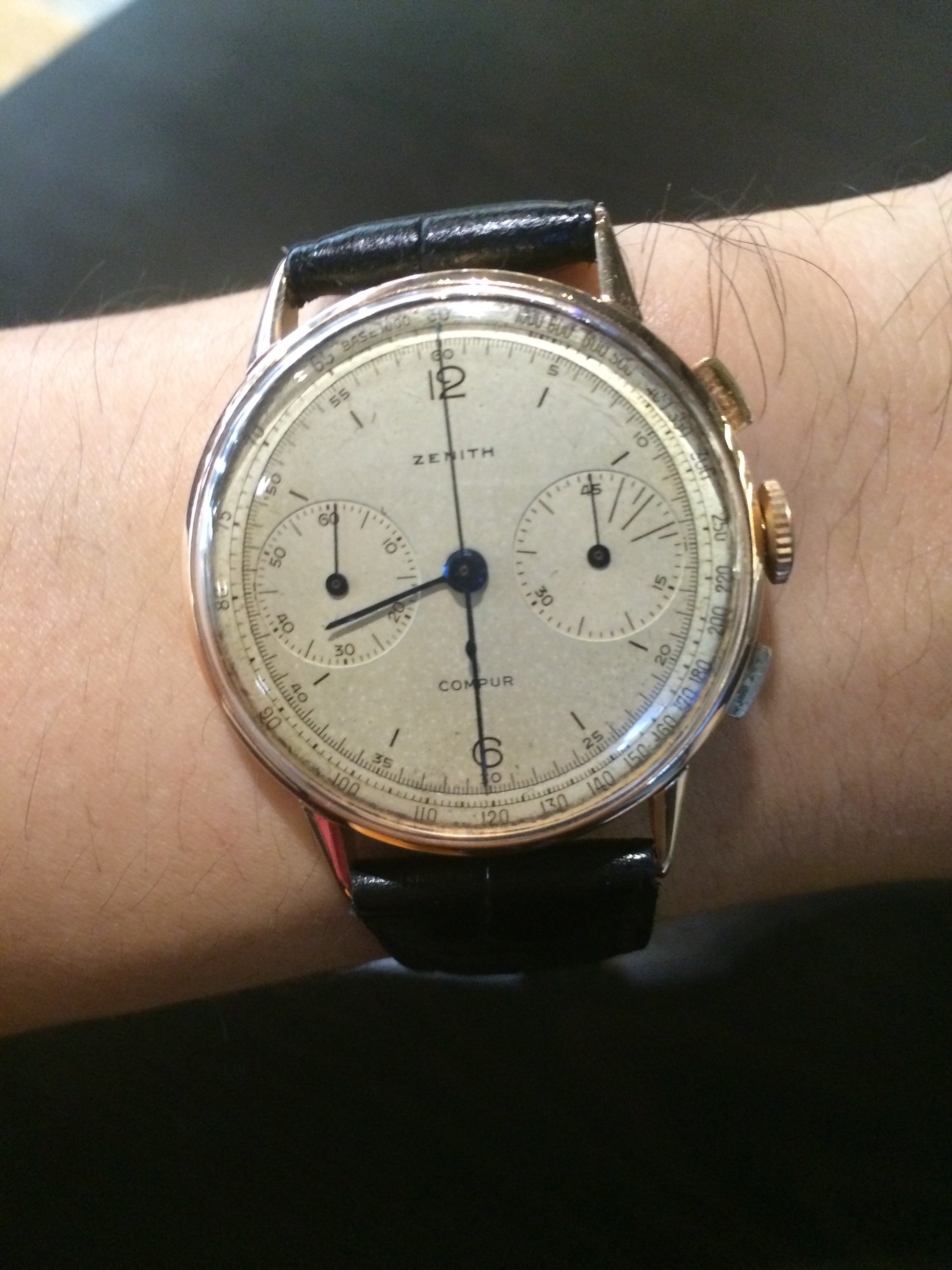

  6. ELV web Mar 5, 2015
    2,668
    24,651
    But I think the OP's look like a redial though (ink evenness and thickness) the zenith and 88cut's watch kind of just verify that the subdial doesn't need to be machined.
  7. LouS Mrs Nataf's Other Son Staff Member Mar 5, 2015
    6,713
    18,260
    fully agree, particularly in the earlier models
  8. 88cut Mar 5, 2015
    423
    792
    The two I posted in the pictures were produced during WW2

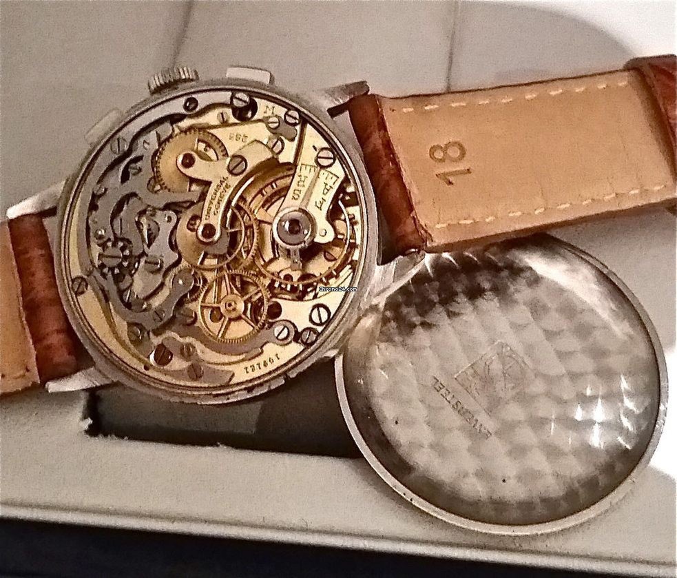

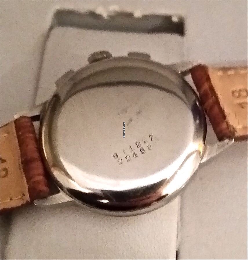

    So what do you think of this piece, redial?
