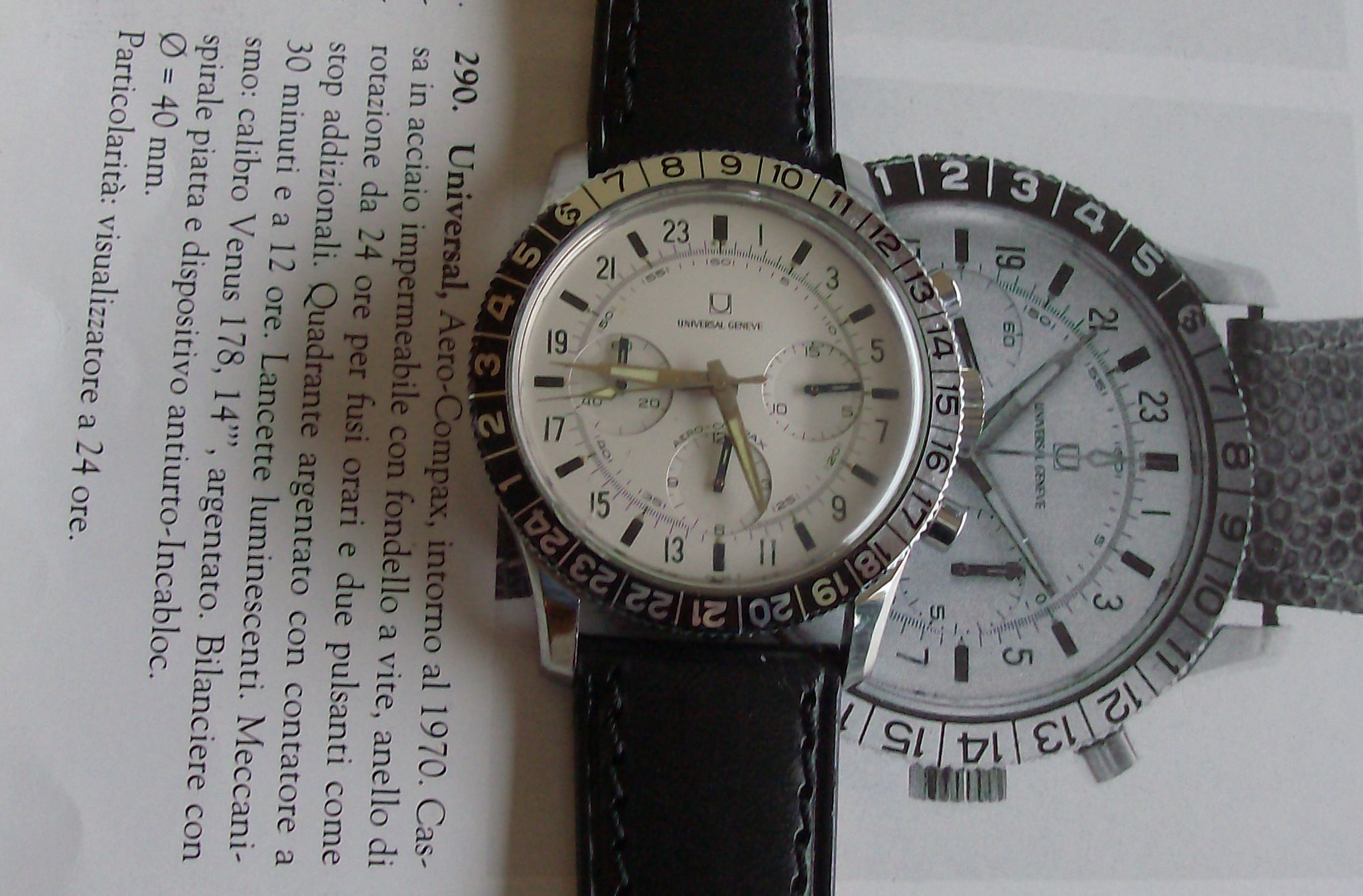

    aerocompax is second generation -dated 69-with venus 178(same as cosmonaute)..............I have first generation with odd number dial..............................great watch and interesting 15 minute counter.

    ps........................the watch looks all original with the non-black/white outer bezel(not day and night)-calibre 90 Universal(178 venus)-they reissued much later with similar looks except protected crown .There are a few for sale(Private eyes Japan) and a couple of first generation (Chrono24+Matthew Bain)-go for high prices now as very scarce..........................

    Hi Andy- had some thoughts on date of '69--mine was said to be '75 but I later serial number dated it to '65------Bonhams had one but stated '70's so maybe I am out with this one---------------of course the aerocompax name relates also to the range of four dial chronographs(top dial as "memory" dial) I think -in 35 mm and 37mm cases- also there is of course the datocompax. The only other variant I am aware of is a beautiful aerocompax with day/night bezel and red arrow I think above hour counter and divided black white dial................interesting chronographs though and they wear quite big at 41mm I think.
  16. mbirtch Aug 29, 2013
    58
    5
    ps -wrong again-the black/white divided dial aerocompax I mentioned has beautiful red arrow and "N" I think pointing down within hour counter-quite lovely-(see andre55)

    Posting for Mike
