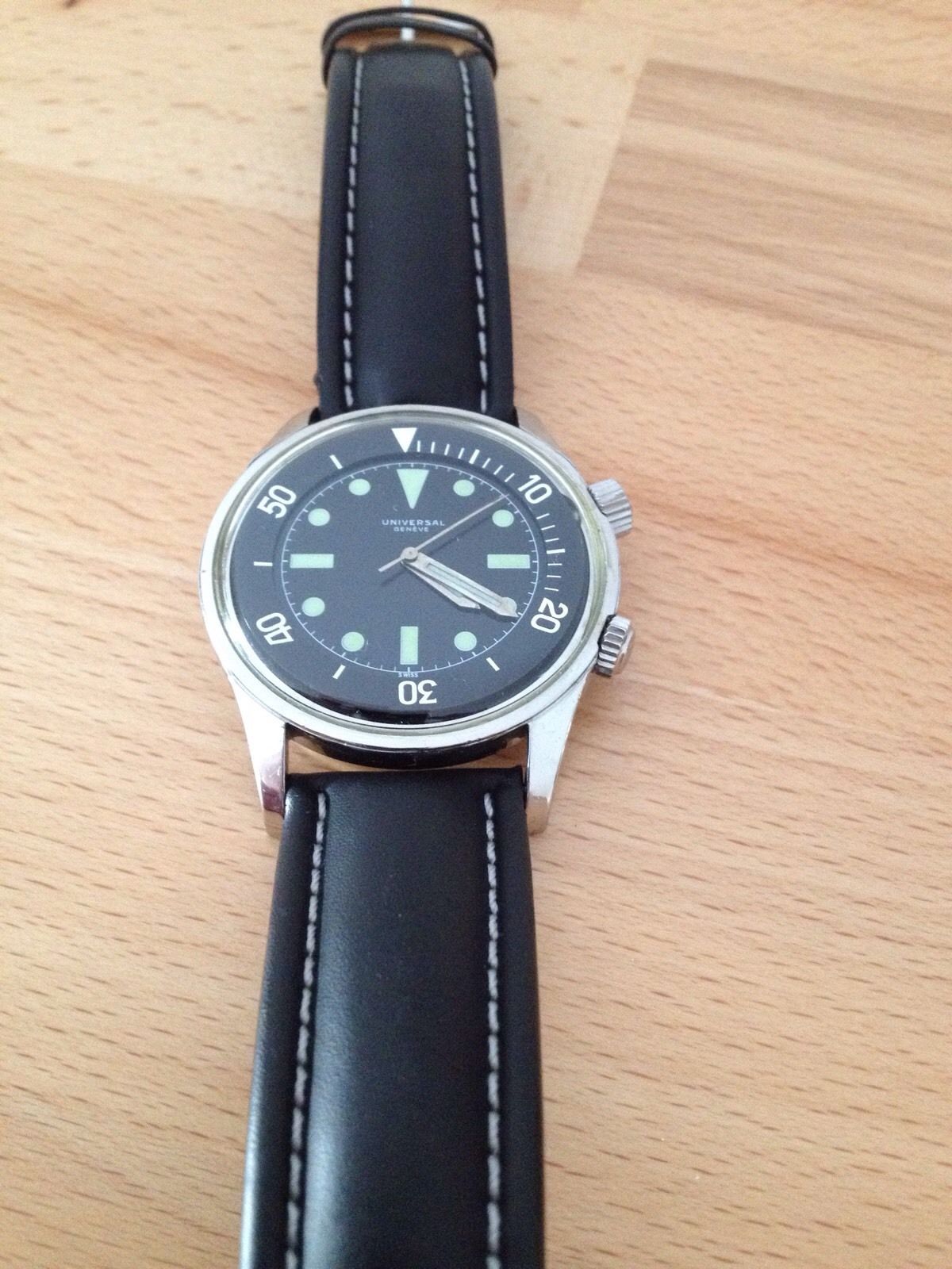

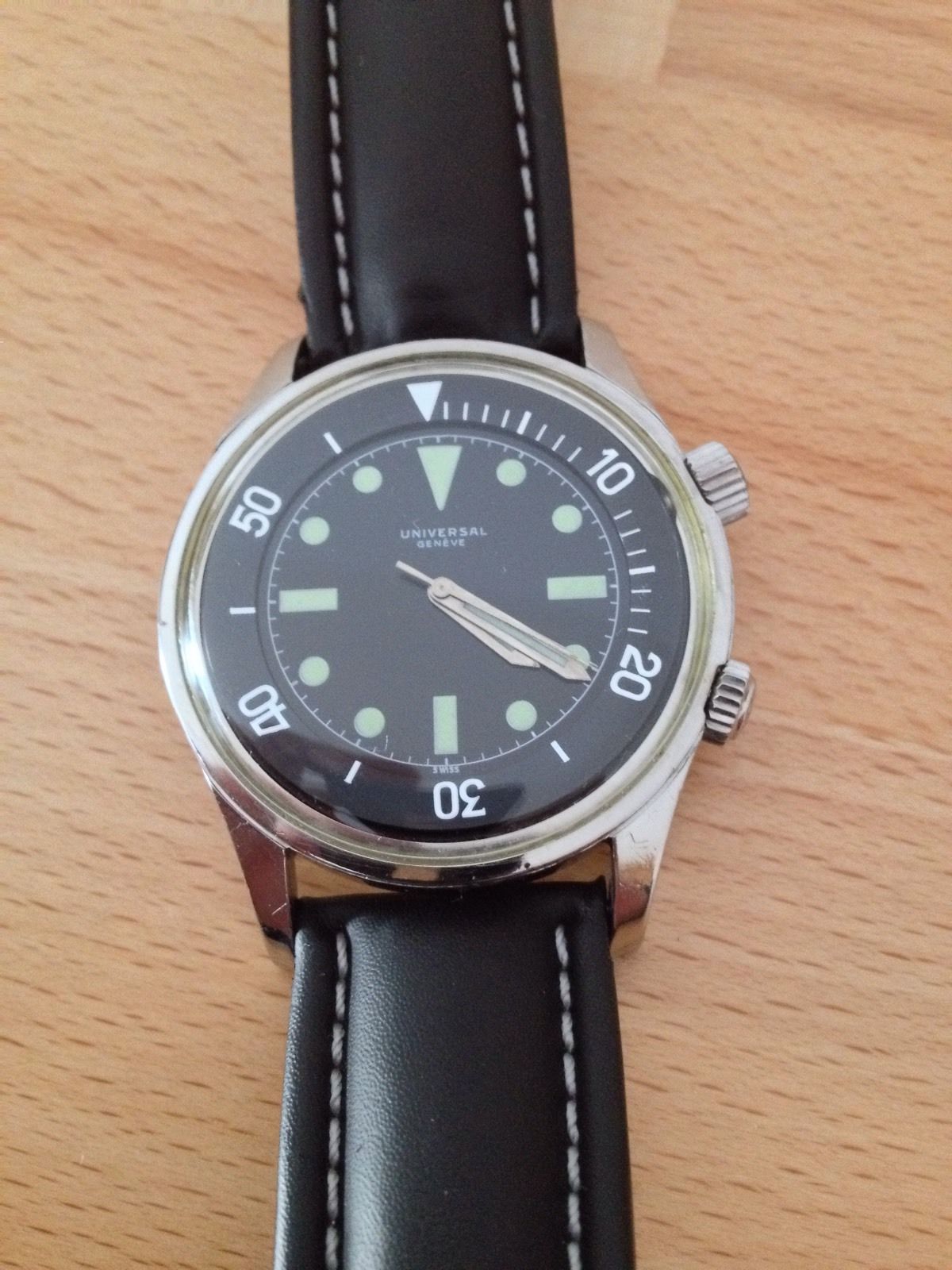

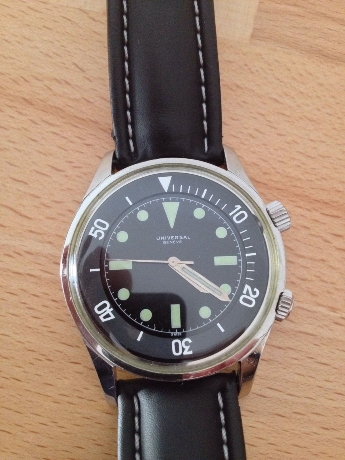

    Does this guy (typical German Ebayer - no PayPal, no shipping outside Germany) have an actual, uber-rare authentic Polerouter Sub case containing a redial three times as bad as any in the bogus Polerouter Subs, or is the whole thing fake, case and all?
    http://www.ebay.de/itm/Original-Universal-Geneve-Herrenarmbanduhr-/181668859841Purchases made through these links may earn this site a commission from the eBay Partner Network

    Prototype; worth a small fortune. :whistling:

    I have consulted my pic library on this model. I actually vote for it being a genuine first version/execution case (edit - from what I can see in the pics posted here - I can not see the auction. What is the "prototype" part of it - did it say that in the auction text?). Dial and bezel I do not care for... The gap showing at the crown, moving the bezel, is just because it lacks the proper inner ring for the glass.
    The sad thing is that I would really have wanted to buy this one - as I have a correct NOS dial and bezel for the first version case. However - I would not have paid a premium - for something with that dial and bezel. It would have been a real rescue - though - of both the watch and my parts.

    No pictures of the movement or inside of thr csse back ?????
  9. styggpyggeno1 ΩF Enforcer ....and thread killer Feb 23, 2015
    3,819
    43,714
    I came in second place... Could not justify more than 1800 Euro on that info.
  10. rolokr Feb 23, 2015
    1,195
    1,918
    I would have to see the inner markings, should be a serial number on the back !
    The real ones have a small arrow on the back of the case, it indicates where to stop screwing the case down. Hope this helps !
