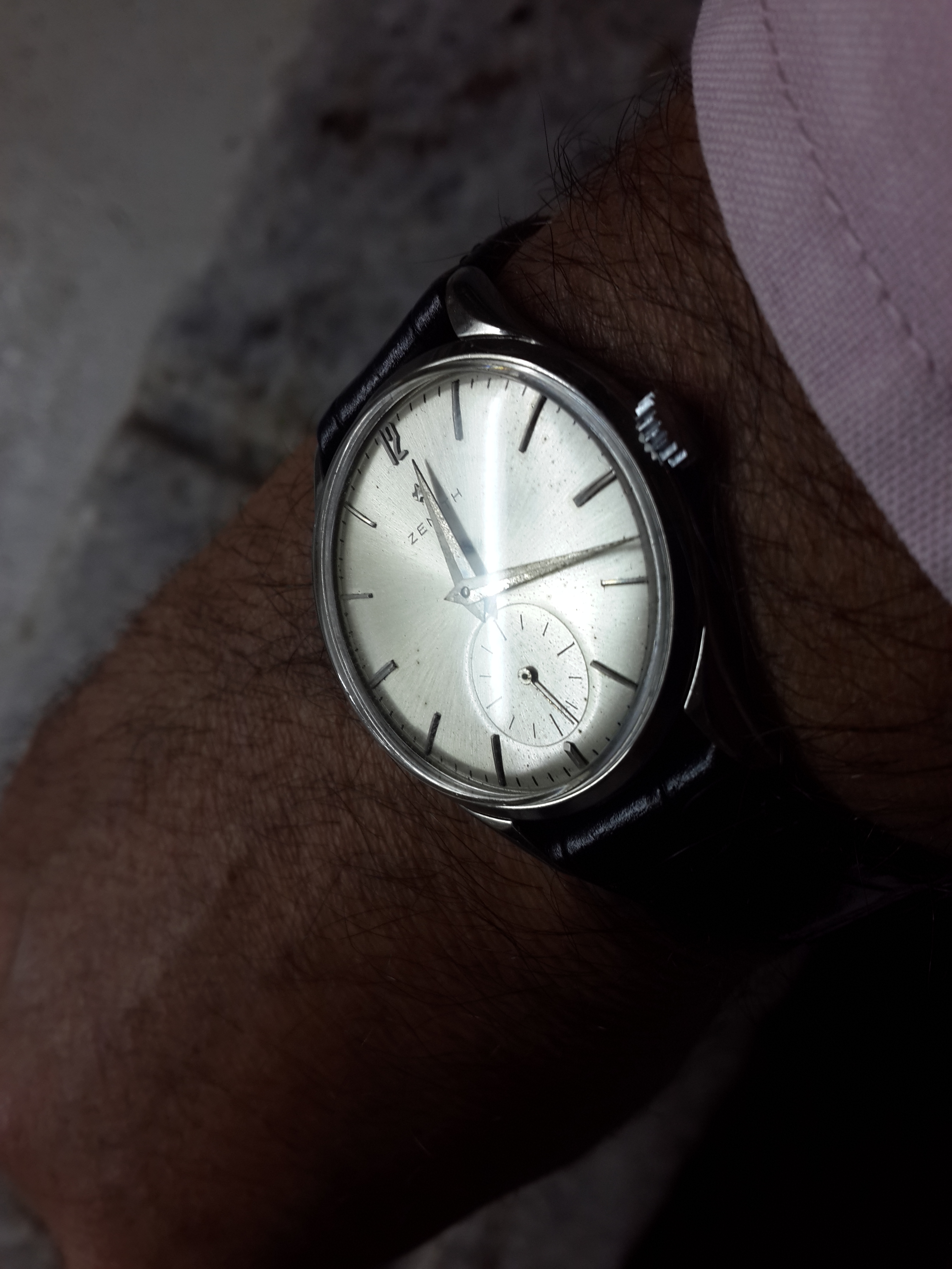

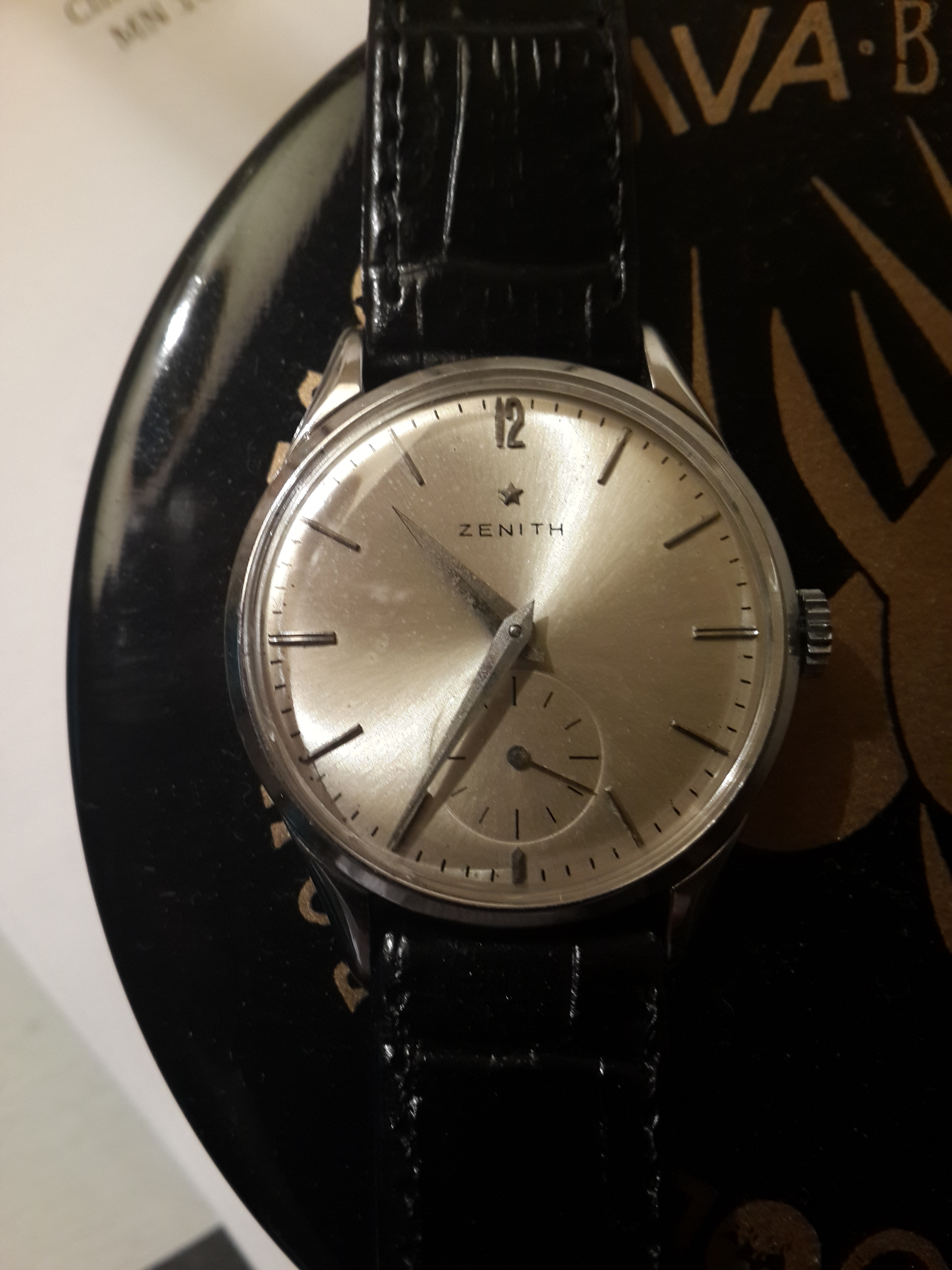

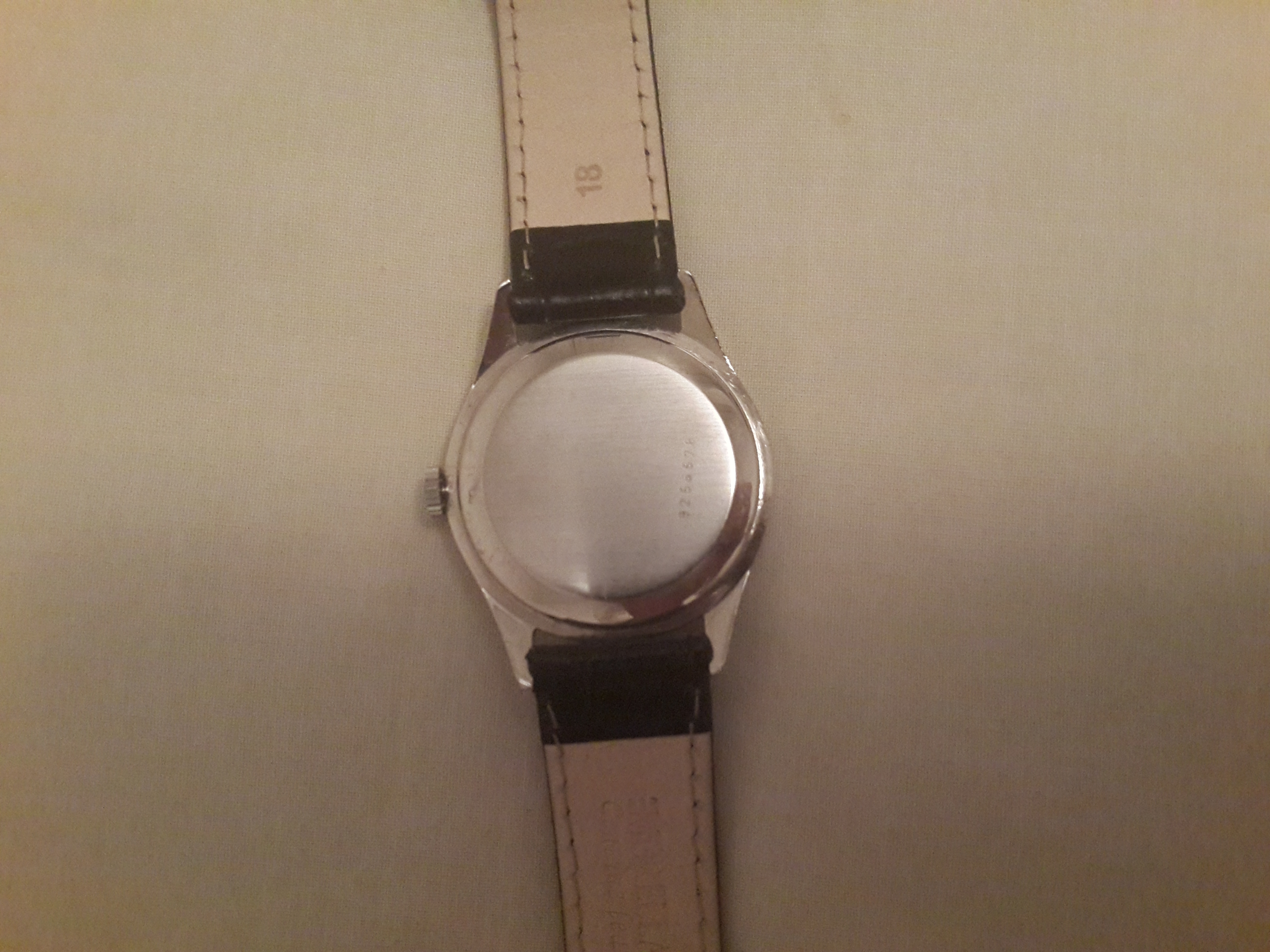

    Hello, I am new in the forum, and also new in the Zenith vintage watches world. Today, I was offered this beauty and I loved it immediately. Simple, classy, clean dial, beautiful hands, an above all, so elegant! But...I have no idea about what model / reference / movement / year is. So, if any of you can give me some information, I will be more than grateful.
    Thank you all in advance!

    I'd say late 1950s, early 1960s, but I'd also say it is a refinished dial. Season your eye a little, and you will find an more original one without much trouble.

    Thank you so much, Lou. I am surprised about the dial is refinished. I could have never suspected it. Just to learn, how did you notice it?
    Thank you again!

    The silvered sunray pattern in the finish is atypical for the period, the printing of the logo strikes me as too light, and the markers of the subdial are poorly centered. Zenith also tends to put a little different-pattern finish in the subdial - this one is homogenous with the rest of the dial. Also, no "Swiss Made" that I can see.

    Thank you again. I could not see what you see, but now I can see it, specially the markers and the similar patern finish in the sub dial. Thank you again!
