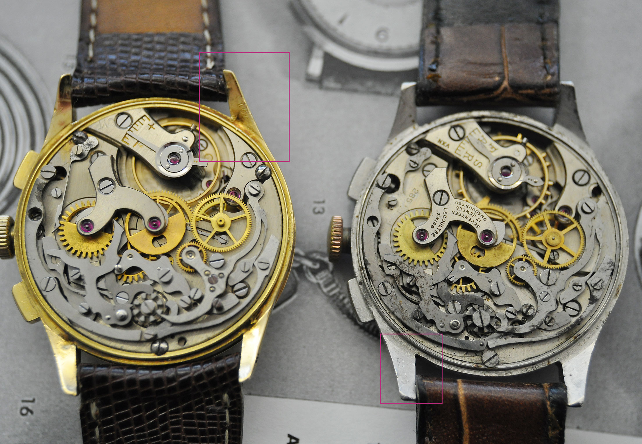

    there is everything you can imagine: pateks, omegas, or acutrons made by/for cartier. schwab, luxor, ...! every quality manufacturer worked for the king of jewelers. some were branded later, some produced for cartier.
    i have two of this cartier chronos. both with the vxn 285 movment. one is signed OVP instead of vxn and the 285 is missing. bridge unsigned, no "made in" present. nothing! completely unbranded movement by jäger lecoultre.
    the military steel watch is a 1938/39 if i remember right. it is marked inside the back lecoultre and two rows of numbers.
    the gold chrono is newer and inside only gold stamps, etc. cartier inc. engraved (may be later - after polisihing away that number on back).
    both watches had personal engravings on the back. on the steel it is pesent. on the gold one the engraving was removed -
    and the number stamped on the caseback too. clearly to see where both was - but who needs a number ??!!
    both of my chronos carry a number on a lug. that is the cartier register number. even without any other number they can
    find out a lot about this item.
    there was watches with three stamped lugs (i own a cartier by piaget) that has a unsigned case too - and
    has this three digit groups. or a omega that is stamped on two lugs. have much more of this branded cartier watches - more than 20 pieces. i collect them for decades! on my pic i put the red outline to the place where the number is stamped.
    the problem is always that great jewelers or goldsmiths buff and polish that tiniy numbers out. they look a little bit like
    scratches from removing the strap (as it looks if theses professionals do strap changes with teeth and hammer) - watchlovers will care about their watches and do not scratch lugs or cases !
    your pictures does not show the lug clearly. the number should be right top or left bottom - see picture attached. if nothing present the chance it is true is very smal. this double branded watches were usual in the 60ties and early 70ties. the military chronos were made in the 30ties and 40ties. my gold chrono is from 52 on. don´t know exactly.

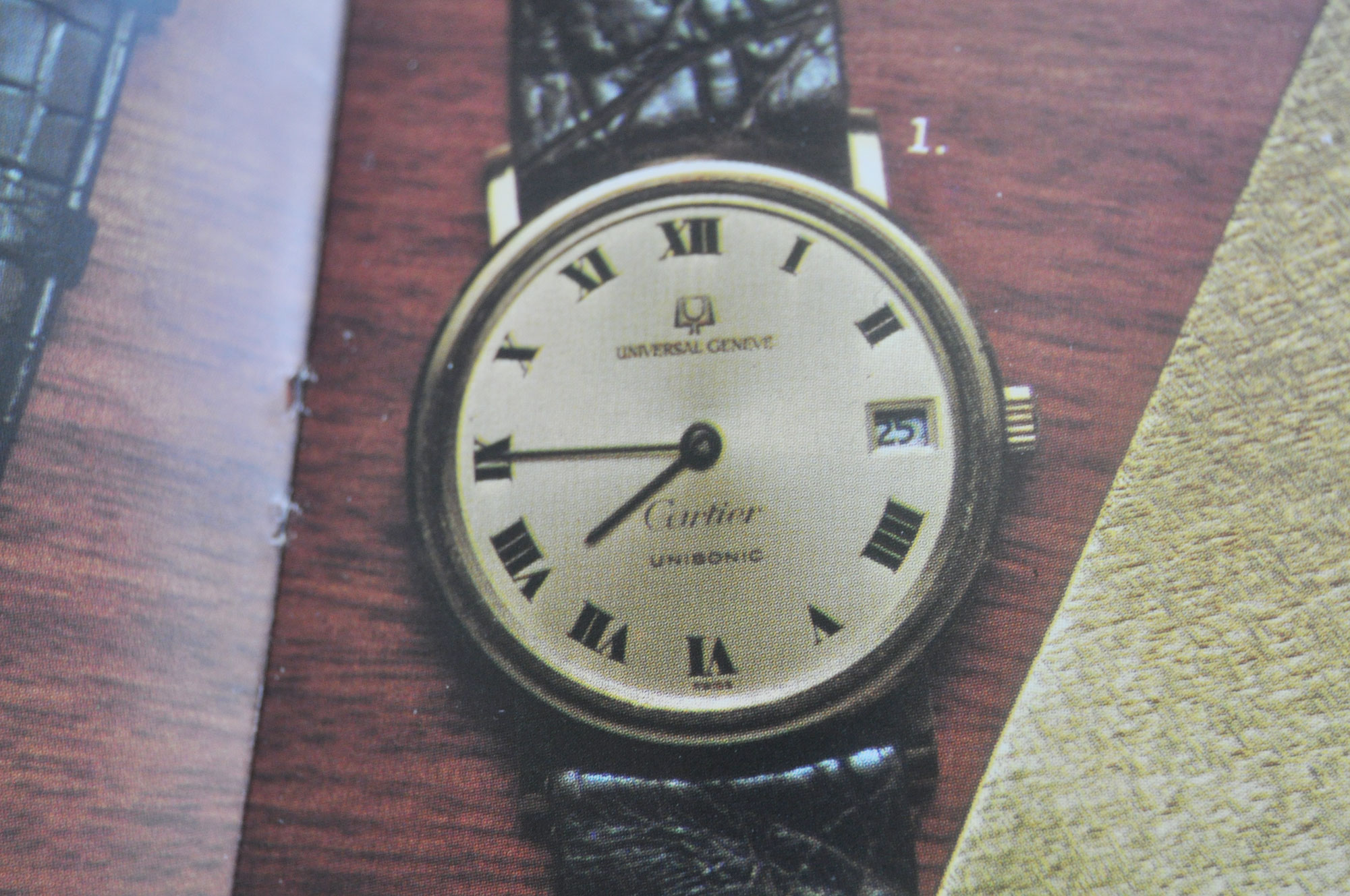

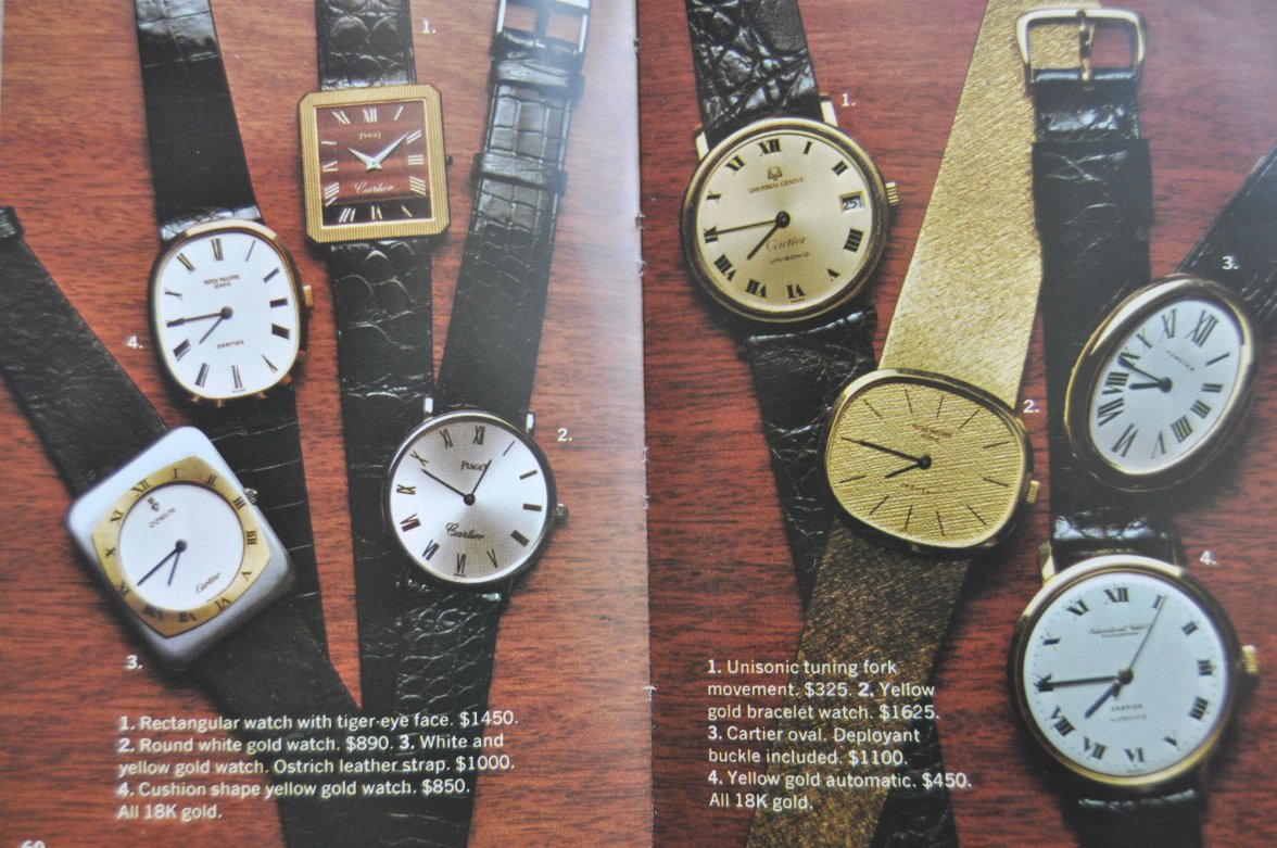

    1) There are well known co-signed dials, the most famous being signed by Hermes. However, I have never seen a legitimate Cartier co-signed dial on a Universal, period. Nor have I seen any period advertising featuring a Universal watch, as exists for the Hermes examples. Doesn't mean it couldn't have happened, but I'm extremely skeptical. And given the premium that collectors place on the Hermes co-signed pieces, there would certainly be incentive to 'manufacture' such a co-signed dial. (See also, this).
    i attached a picture of a 196xties cartier catalogue. made for cartier new york. as you can see they printed their signature on lots
    of different brands. including iwc, patek, universal, eterna, piaget, etc.
