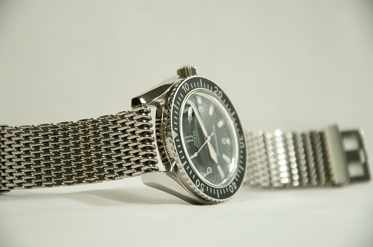

    Case:
    The case of the Seamaster 300 is 41mm in diameter excluding the rather large protruding crown, however it wears smaller than that due to the lack of crown guards compared to the 40mm Rolex Submariner. The case features unusually thin, curved, twisted, and form fitting lugs, which concave under the watch to match the contours of the wrist, resulting in a design that sits very low and comfortably, flush with your arm rather than sitting up like many divers of similar thickness.
    The ratcheting bezel turns 60 clicks per rotation, and is very easy to grip, thanks to its coin edge design, which is almost identical to the current Planet Ocean series, moving firmly and very precisely. The bezel features a unique acrylic insert, with very bright, Super-Luminova lit markers for the triangle, 10, 20, 30 40, and 50 markers, a feature limited to this watch and the current Omega PloProf 1200 re-issue in Omega's lineup.
    The crown is large, easy to grip, easy to pull out, and screws in neatly but firmly. The lack of crown guards does not seem to be much of a concern, as the strength and build quality in the case and crown assembly is very apparent, this is not a fragile watch by any means.

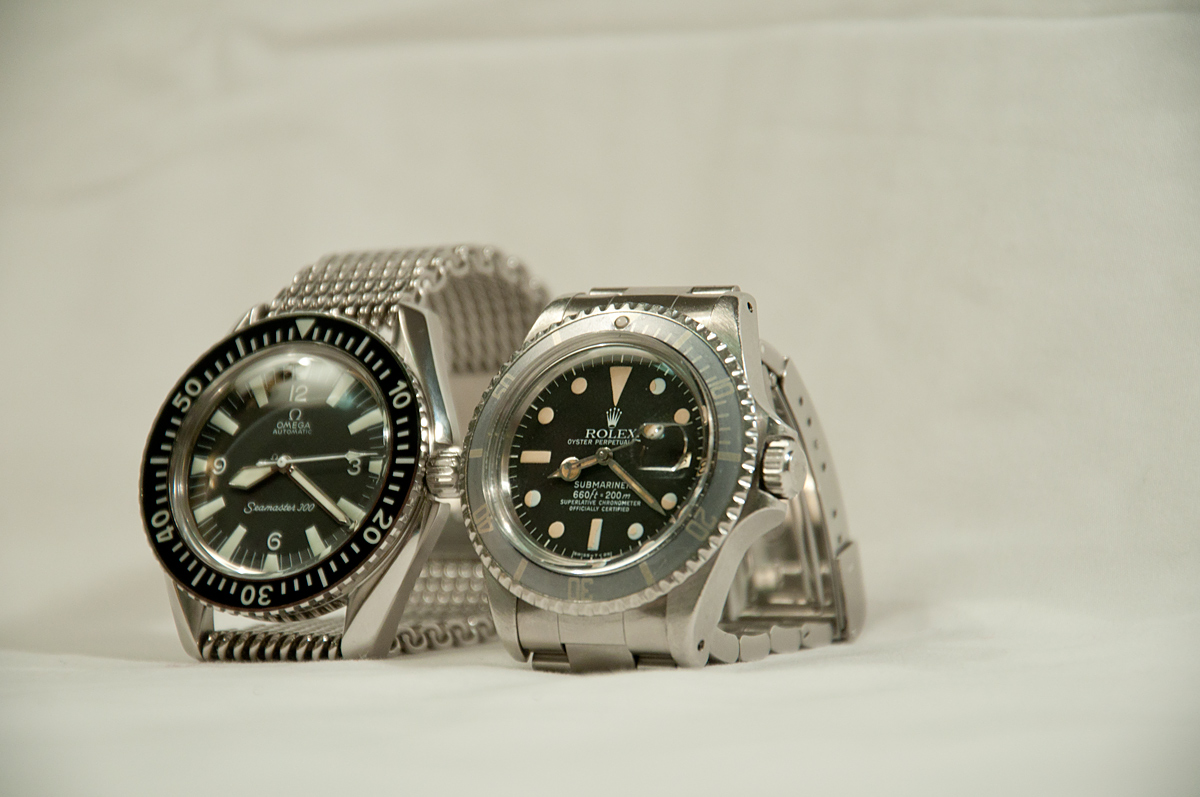

    The weight of this watch is fairly modest, being a touch lighter than a comparable Rolex Submariner:
    • Omega Seamaster 300 (Omega Vintage Mesh Bracelet): 114g
    • Rolex Submariner 1680 (Rolex 93150 Oyster Bracelet): 116g
    That said, the Seamaster 300’s head is probably somewhat lighter than the Submariner’s with most of the weight in the heavy mesh bracelet. The result is that the watch sits closer to your hand, with less head-flopping, and a great deal of balance.

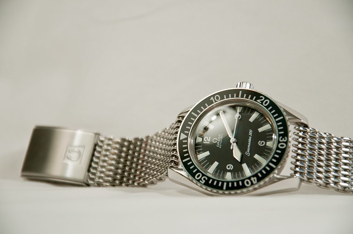

    Dial, Hands and Crystal:
    The dial will be immediately familiar to Planet Ocean owners, with very generous sized Super-Luminova indices, and the well known "3, 6, 9, 12" arabic numbering arrangement, with even the same font used as on Planet Oceans. A minute track is visible on the outer edge, and dial writing is kept to an absolute minimum, with nothing more than "Seamaster 300" and "Automatic" printed on the dial aside from the Omega brand.
    The hands are equally generous in their use of luminous material, with a thick sword hand used for hours, a long minute hand, and a seconds hand with a large segment of lume in the head touching the minute track. Readability is absolutely superb, and nighttime visibility is one of the most impressive aspects of the SM300, with nothing short of a Seiko Monster outdoing this modern made 60's designed Omega for brightness.
    The thick, domed plexiglass crystal, signed with an Omega symbol in the center has a remarkable warmth and vintage feel about it, which any Speedmaster Professional owner will immediately appreciate. From less than a 30 degree angle, the domed crystal “warps” the dial as if peering through a magnifying glass, and reflections are created on the surface from many angles. In most watch reviews this would be marked down as a negative, but in the case of the Seamaster 300, this is what a vintage enthusiast loves about plexiglass, and I would not swap it for all the anti-reflective coated Sapphire in Switzerland.

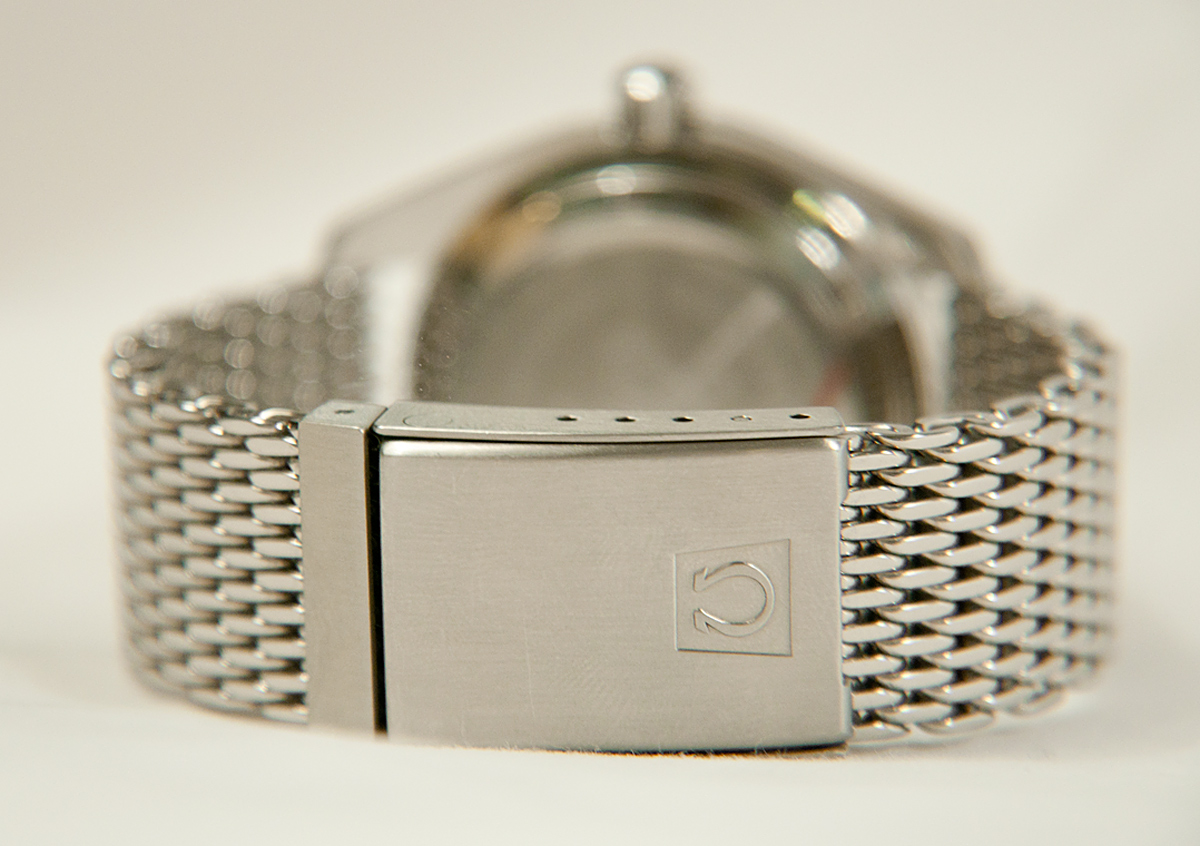

    The Bracelet:
    Omega’s Vintage Mesh bracelet is considered one of the best mesh bracelets ever produced, so good in fact that it is commonly seen attached to Seiko, IWC, Breitling, and even Rolex sports watches, in spite of the fact that it carries a very visible Omega symbol on its clasp. The mesh is several millimeters thick, strong, effortlessly flexible, and as smooth as glass, while carrying a not insignificant heft to it. The way it fits puts it above the Omega Bond bracelet, and Speedmaster bracelets in terms of comfort, and explains why PloProf owners consider their watch with all its size to be so comfortable.
    The clasp is an odd duck, it uses an airline seat-buckle style tongue and catch type system, which takes some practice to use. After clipping it and unfastening it about 50 times, it got to the point where I could do it without looking and without fear of losing it, but when practicing I would strongly recommend doing so over a pillow or soft surface.
    The bracelet opens up fully, like a strap would, which is different, and makes installing and removing the strap from the watch much less of a hassle.
    Sizing is very convenient, with a micro-adjust spring-bar inside the clasp, and due to the design of the mesh and clasp, there is no fiddling trying to get the spring-bar into the next hole, it simply slides forward and back as if on rails and slots into the next hole.
    The standard bracelet length allows about an inch of adjustment and fits medium to small sized wrists quite well. Larger wrists can be accommodated with the use of an extension link which joins by spring-bars and can be chained together for even greater length.
    The only gripe with the Omega Vintage mesh is that when opening the clasp, it can have a tendency to flip one side of the watch over the top, possibly causing damage if there is anything hard nearby.
    Wrist Presence:
    The Seamaster 300 was designed from the beginning not as a fashion watch, but as a tool watch. It was in fact issued to British Royal Navy divers for operational use from the mid 60s to late 70s and the utilitarian nature of the piece is apparent from all angles.
    At 42mm, its size is still very modern, slightly larger than a Submariner, and slightly smaller than the current Planet Ocean, but the design of the dial and particularly the bezel insert make it seem larger than it is, and really stand out.
    On top of this, the mesh bracelet takes it to the next level. There is something truly special about being able to tell someone that your dive watch has a “shark-proof” bracelet, and it transforms an already aggressive looking watch into something worthy of a Bond villain, and possibly more evil than a Panerai. This piece genuinely looks like the type of timepiece an Israeli Mossad agent would wear while dumping the body of a murdered dictator in a deserted swamp.
    The most effective description would be bad-ass.
