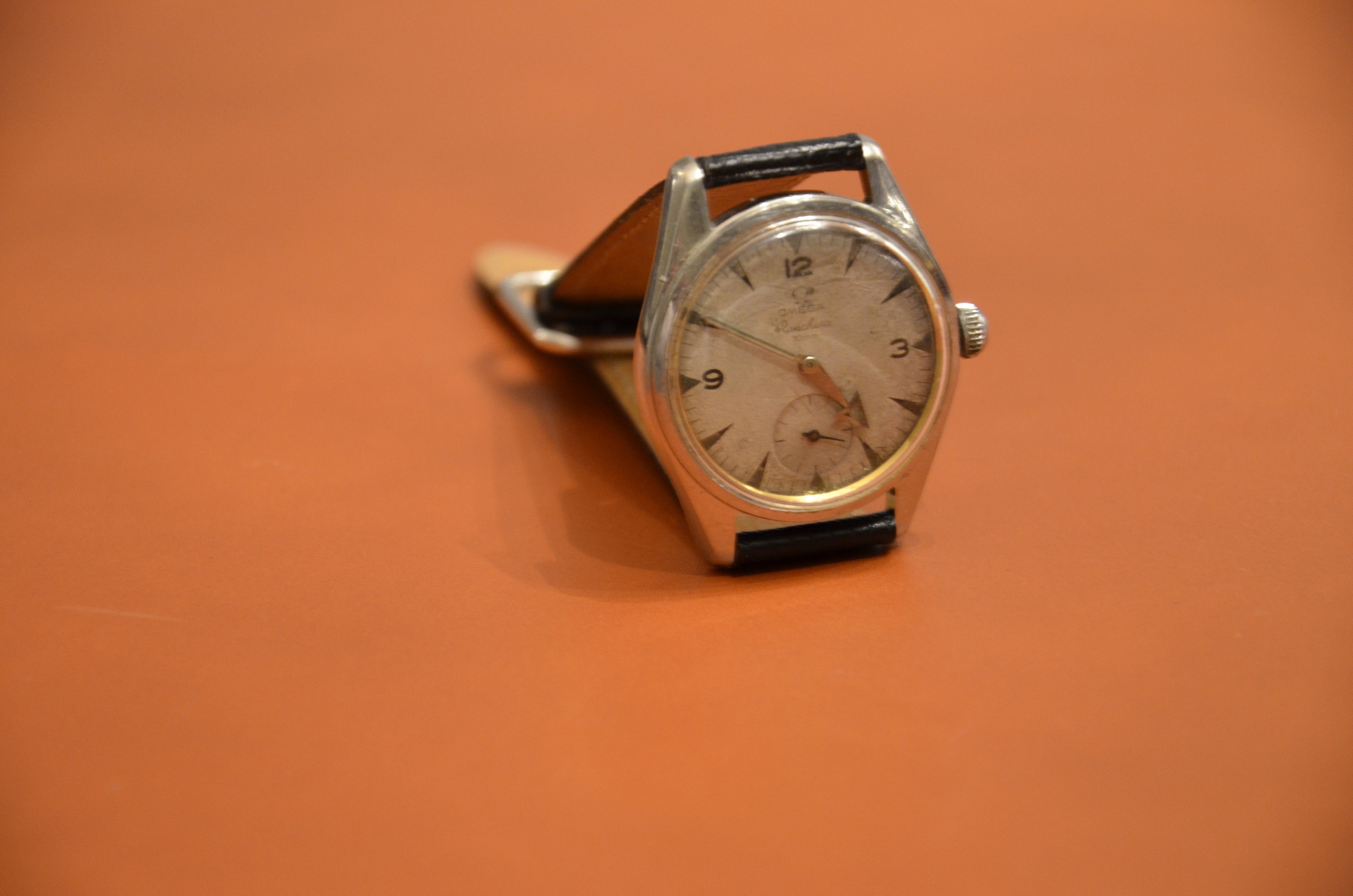

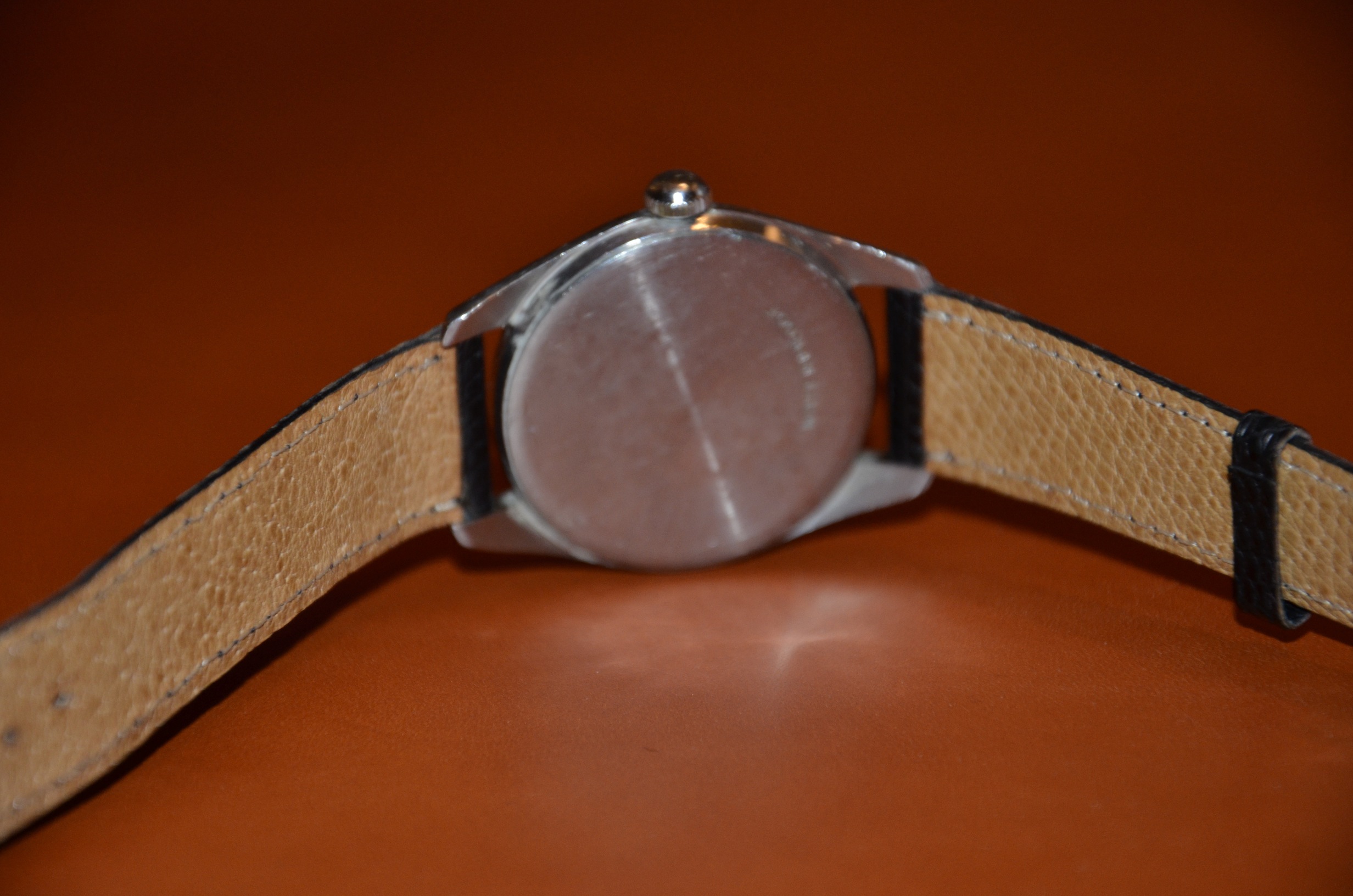

    Could anybody tell me if this is a genuine Ranchero. The minutehand was replaced before I found it. But it is still keeping time.
    Thanks in advance,

    Wow, a white dialed 2990. That's even the correct crown for it. Should have a caliber 267 inside.
    To be sure we need much better pics - especially of the dial, inside of the caseback, and movement. Lookin' good so far though.

    There it is - a 267 inside a 2990. The dial picture isn't quite good enough to say 100% but it's passing muster from what I see.
    How much are they asking?
