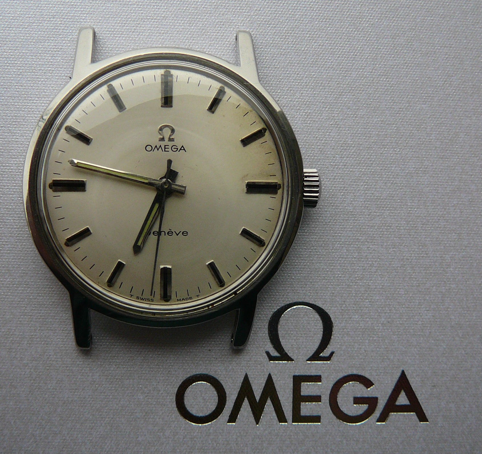

Hoi, there's a thread on WUS (that I can't access) talking about some of the late 60's Seamasters where we talked about the difference between having one T and two T's alongside the SWISS MADE. Desmond made a comment about it being the amount of lume used. A couple of the examples shown had lume on the hands but not on the dial and had only T.

A novice in omega collecting should know it. (I read that too many times Gator)
What I need to see is a dial with no lume but there is one (or two) T on it, next to Swiss Made because the hands were lumed .
Dennis--Well, not necessarily - I've seen original watches with lume on one but not the other. If I recall correctly, some mid 60's De Villes had lumed hands without lume on the dial.
Let me see what I can dig up. I could swear some of the regular Seamasters also had lume on the hands but not the dial (or vice versa). Check back later.
Pretty sure it was one T.
Hoi_You mean no lume on the dial but there was one T next to Swiss Made ? (Swiss Made T ?)
Dennis_ I think that's it. Can't really check right now at work.

English is my second language and when I read this sentence
"In order for timepieces to be read in the dark, a luminescent material is laid on the dial indexes and hands"
http://www.fhs.ch/en/faq.php#swiss
I understand that hands and indexes will have some luminescent on them to help people tell time in the dark.
There is no possibility that the indexes are lumed and the hands are not, because you cannot tell time in the dark if you can't see the hands. (well, some idiots frankened their watches that way but no watch has come out of the factories like that).
The thing to consider here is "is it possible that a watch that has lumed hands and no lume on indexes ? " and that is what I am waiting to see.
Anybody who has something looks like that, please share your pics..
Thank you and best regards.

Hoi -
I believe that dials with one "T" were made prior to the 1963 ISO standardization mentioned in the above article. I've actually seen a dial (Elgin) with an "Ra Swiss Ra" designation for Radium.
I had to think about this for awhile and I do have a watch with lume on the dial and none on the hands. Not an Omega, but a Universal Geneve Polerouter.
I agree with you that logically it makes no sense to have a watch like this. Totally useless in the dark. However, given the rarity of replacement parts for this model, I tend to think that the hands are correct, if not original (they are very well aged, like the dial). Length, width and style are similar to other Ref. 204610/1 examples, both with and without lume on the dial. Yes, I know the crystal is not original. I had the signed original crystal replaced as it was cracked. This may have caused the interesting patina on the dial.
Also agree that I've never seen an Omega with original luminous hands without lume on the dial.
Sorry for the confusion,
gatorcpa

Gents....found this one. Picture is not that good but the hands look pretty much the same as my first photo.

Hi Janbart.
omega8a-jpg.2168
Do you see the lume dots at the ends of the indexes ? The other one doesn't count because it's a redial.

Yeah I can see the dots. You guys made it clear. Thanks. So I may conclude the hands on my watch (first pic) are not genuine. Thanks a lot.
