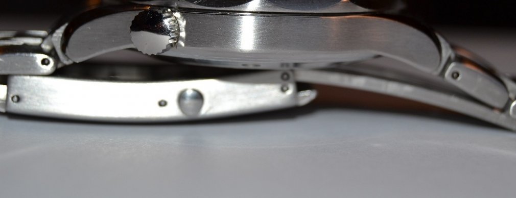

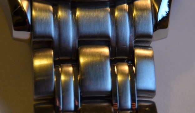

    I need some advice here this is an omega smp quartz the very first modell i suspect that the end links is fake or not original aftermarket parts ? You can se clearly that the end links dosent have the shiny finish that the braclet has. Also i suspect that the Helium Crown is not Original because it doesent have the omega logo also the end links does not fit proper. I need some expert help please.

    You're right on both counts... I wouldn't even touch that watch

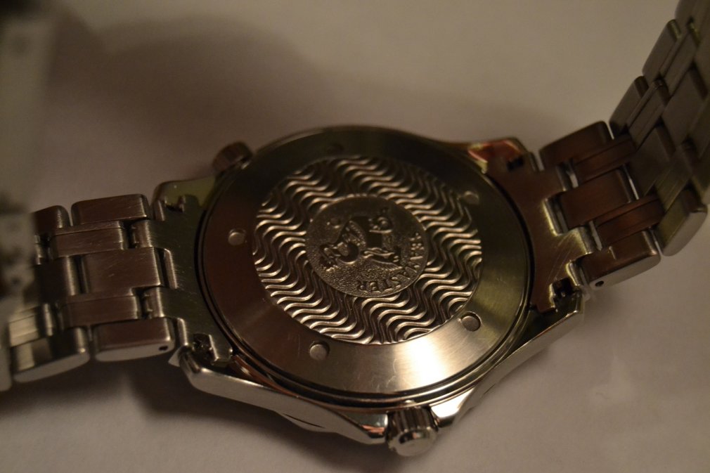

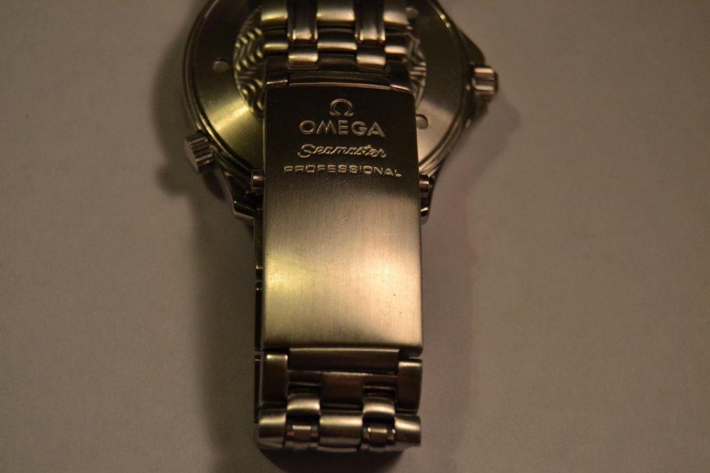

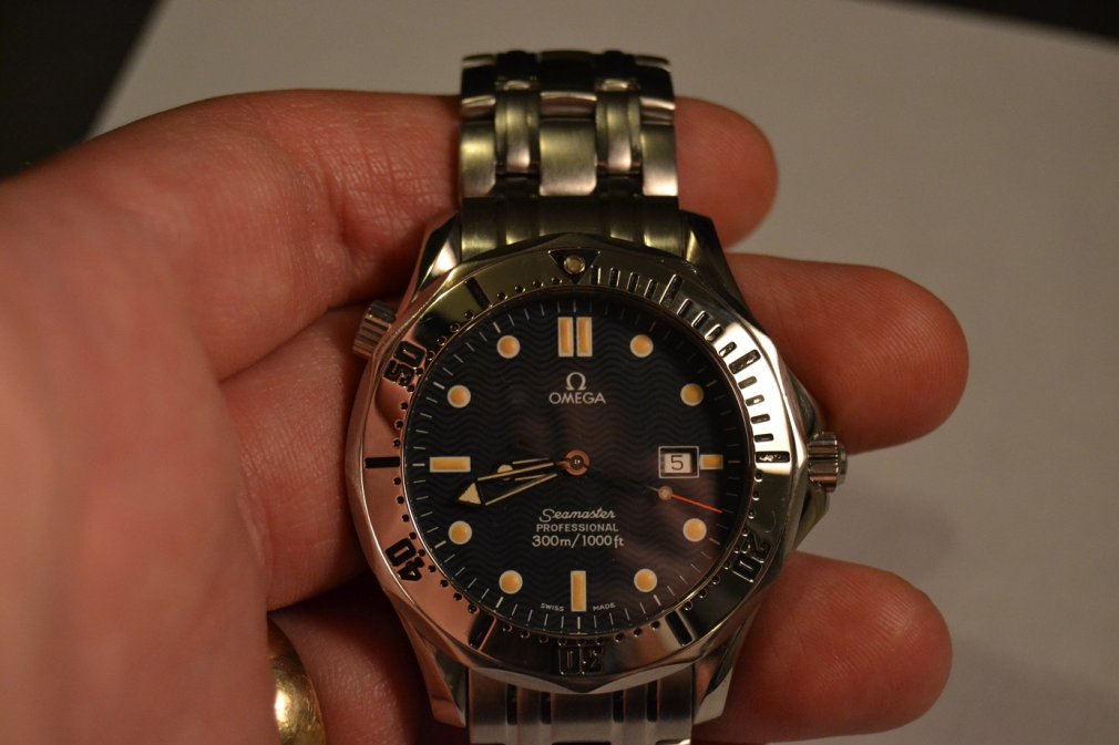

    Here you go, Im in a dispute with the seller should i send it back for a refund or stick with it ? The colour on the bezel seams very bad and fade away just by turning it...T_T DSC_0003.JPG DSC_0004.JPG DSC_0007.JPG

    Send it back, there are fake parts on the watch, you deserve better than that.

    I was actually at an Omega AD yesterday he took a quick look on the watch and said that the end links seams fake and he also said that the colour on the lume dot dosent match the colour on the dial lume, also suspicious about the colour on the bezel fade very easy might be a repaint. Also the watch had wrong battery inside so he replaced that one to the right one. He also said that the HE crown should have Omega logo on it. The watch has the Omega Eta 1438 movment. I am so happy i went otherwise the time would have gone and i might have to stuck with this...
