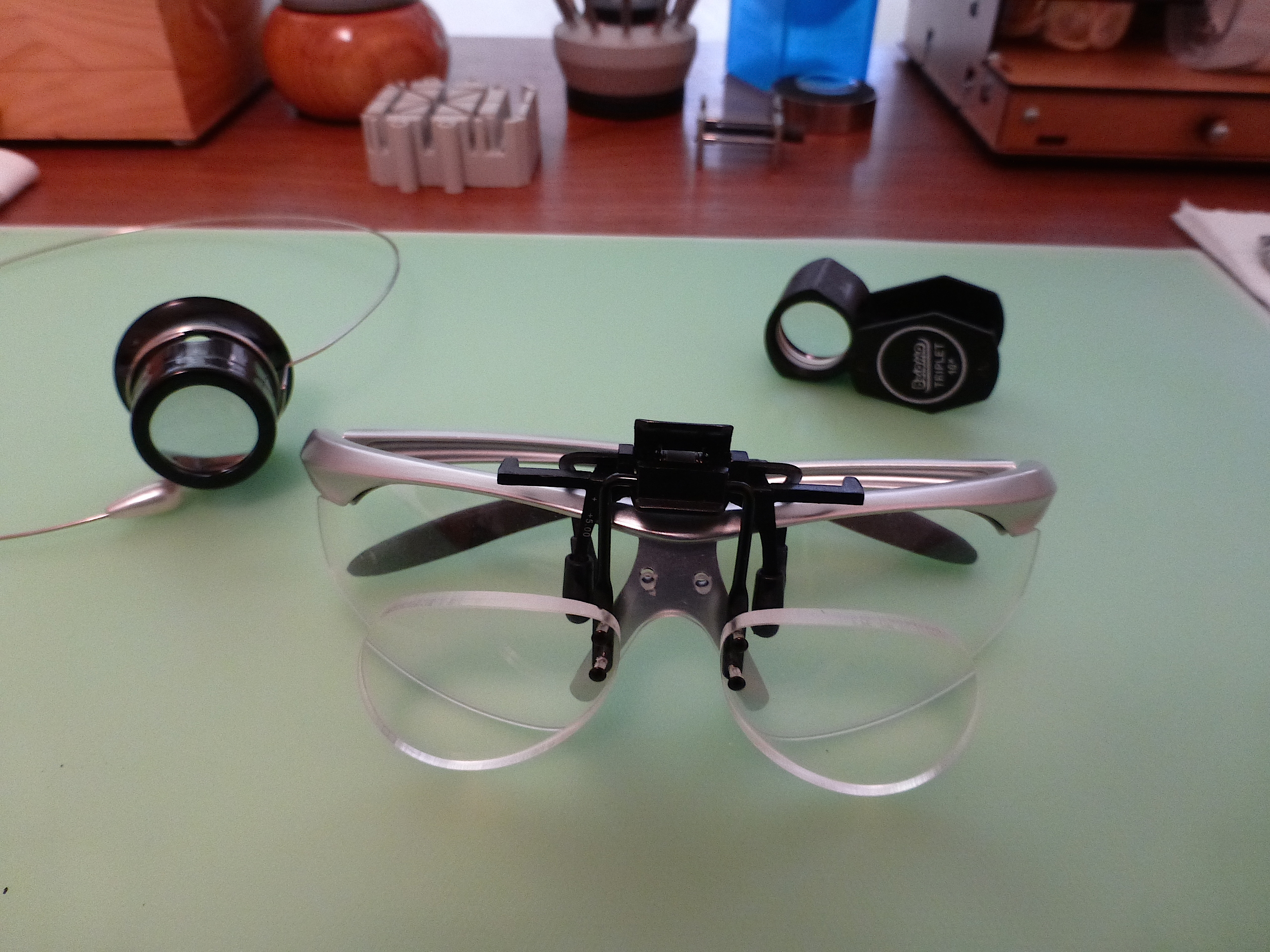

    For general work, I use a pair of 5x flip-down lenses mounted on an old pair of safety specs.
    I use a 4x loupe with springy loop for detailed work and a 10x Belomo triplet for quick checks or when I'm out and about.

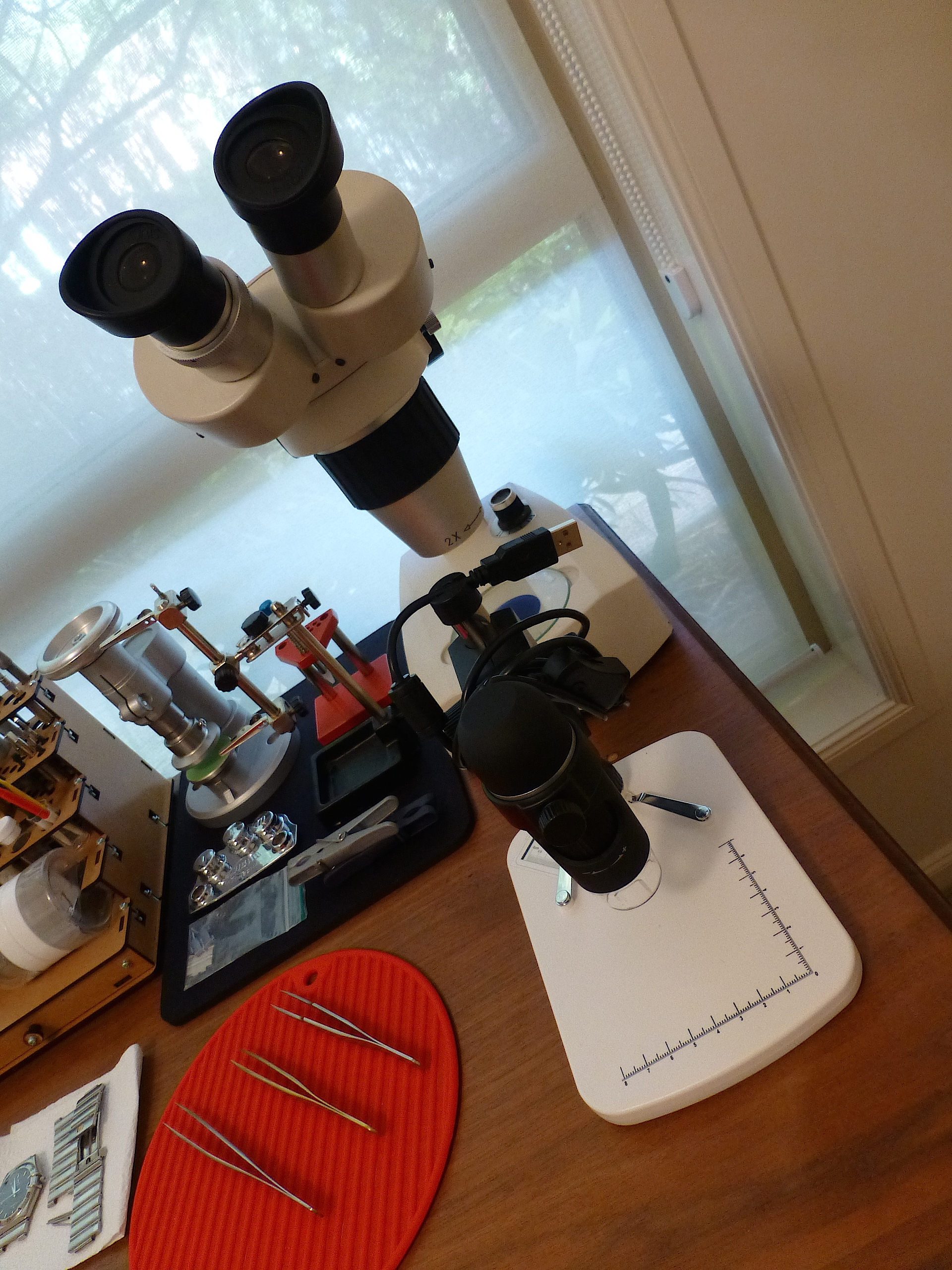

    If I have to get really close to the action, I use one of two microscopes. One is a variable binocular lab scope I got off eBay for the cost of a good loupe, the other is a generic USB one that plugs into my Mac.

    I'd suggest a good quality loupe (or two) and a springy holder, trying to hold a loupe in your eye socket can be a strain after a while if you haven't been doing it all your life.
