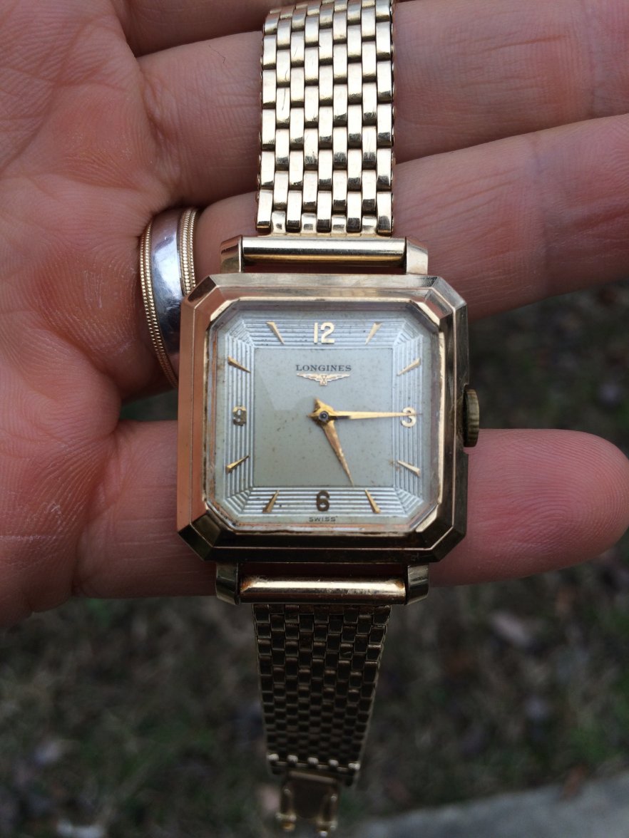

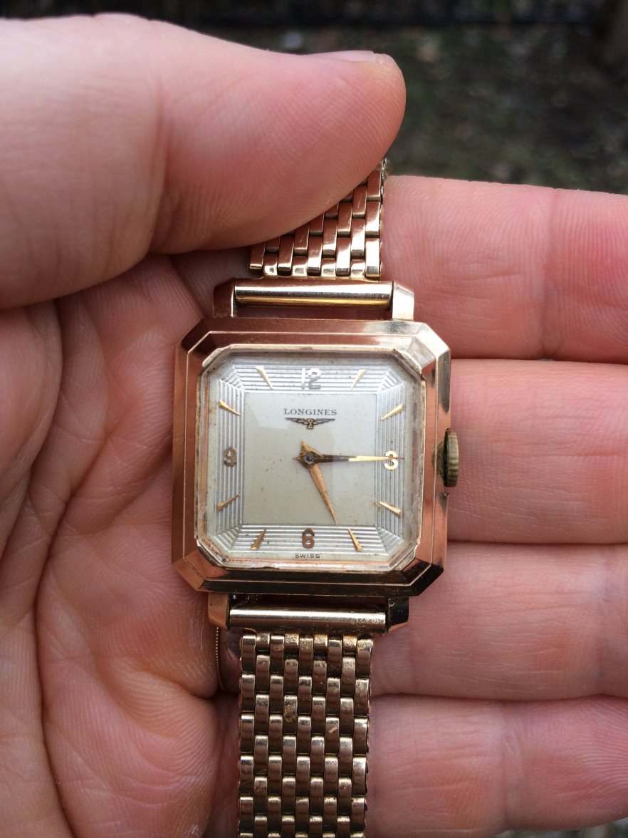

    A good friend of mine inherited this watch last week after his Grandfather passed away. His grandfather had worn it regularly for a very long time, but besides that, nothing about the watch is known. I took a couple pics of it, and was able to remove the movement and dial from the case (when I thought I was just opening a case back) but didn't want to mess with anything further. I'm not even sure if it's a mechanical watch for sure.
    Any information about this watch would be greatly appreciated - model, likely time-frame, material, originality etc...
    Thanks in advance!

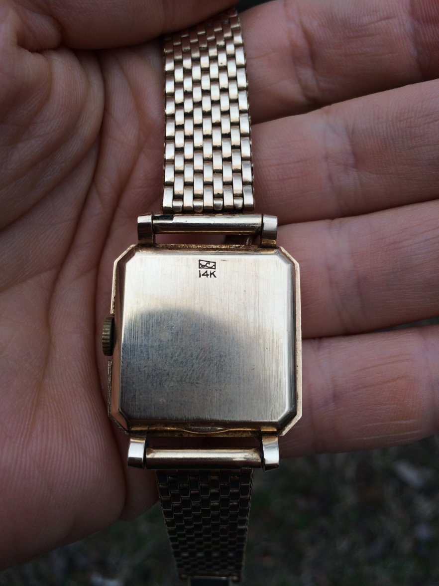

    There is a 14 karat gold hallmark on the back of the case, so it is 58.5% (14/24) gold.
    Definitely a U.S. model, but without the movement serial number there is little else I can tell you.

    Show us a clear picture of the movement and the inside of the caseback and we can tell you a ton more information.

    President Lincoln II, ca 1950.

    When I opened the case back, it came off in one piece with the movement, dial, crown etc. Is it supposed to come apart in order for me to get a glimpse of the inside of the caseback?
    Thanks for all the info so far!
  6. gatorcpa ΩF InvestiGator Staff Member Feb 2, 2015
    12,201
    15,707
    The movement is set inside the caseback. It will lift out with a lot of care. If you are not comfortable with it, get a watchmaker to do it for you.

    Finally had a chance to see my friend's watch again last night and was able to pull the following information from the inside of the case-back:
    Longines Wittnauer
    Watch Co Inc
    New York
    Geneva Montreal
    A61308
    And this info off of the movement:
    7965XXX
    Watch Co Swiss
    23Z
    Unadjusted
    LXW
    I couldn't take any pictures that were clear enough to make out any of those words but I'll try again at some point and post them.
